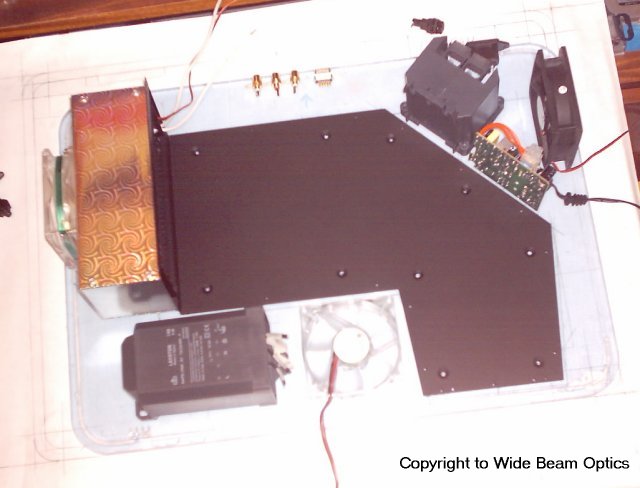

ok time to show some pics although crap ones i might add lol, ok in the first shot u see where things are staing to go, i didnt finnish the new base plate today as i had to make up another template for the new radious wich u can see the difference to the far bottom left against the old radious on the plan, the ballast is up front, that is going to have a box made for it to cover the crappy look of it and ive also split it in 2 away from the ignitor unit wich is the same coloured thing up the top back right, that will also have a box made for it, im hoping to cover the ballast and ignitor box with a gold covering, the thing up next to the ignitor is 1 of the psu's ill be using to power the lcd and fans, if i have enough power left over wich i hope, ill be putting in 2 neon wires to suround the top and bottom inside of the side peice so it will look like 2 blue strips, the black fan up the back will be replaced with a clear blue led fan that i will buy tomorrow, the light box isnt finnished as i need to get a rubber gromet for the wires to come out also ill get them tomorrow and the rubber gromets will also be coming out of the other boxes i make u for various things in there to let the cables come out with some saftey withough being cut by the cable hole in the box, the base for the lcd unit is on there in place i will be mounting that probally tomorrow in place then ill be placing the lcd in, the mirror and the part B of the light engine wich is yet to be made this week!, the inputs are up the back in the place where they will go and there will be another gold rca socket for the audio in, also up the front u see 2 clear leds if u look hard enough and thats where the power and standby leds will be.

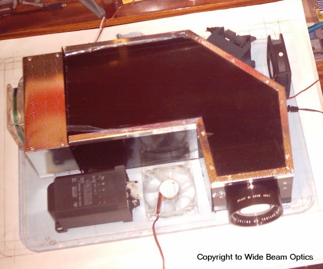

ok the next pic, in this pic its the same thing, but oooo look at that, the lens is mounted, damn ace never posted that, lol sorry guys ill post that soon, in this pic u see the lcd unit sitting on its base and yess with the lens mounted, there are also a couple of angles missing on the lcd box as im doing work to it and its not worth to put them on for just a pic, the lcd unit looks abit drab to me so im going to make up a design for it where the same silvery stuff covers some corner peices to make it look alive abit, that will come later though, the grouve u see in the front looks abit rough, but i can asure u its perfectly spot on, its just the protective covering thats abit messed up from the router cutting it, in the front of the lcd box where the fan and ballast is there will be a louver for the air to go in for the light box, where it will suck air from the air coming around from the back fan and removing some heat from the ballast and also some air from the front fan, u can see the leds in this shot but as i took it one of them kind of went spastic in the process and fell over lol

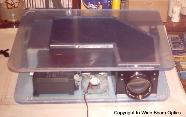

ok last pic, here the leds are happy again in the front and are sitting right, this pic is with a now scrap peice of plexi on top to give u an idea of the profile of the hieght of the projector and kind of what it will look like, it looks bigger in the pic for some reason and the front dont look too square lol thats my cam for ya, more pics to follow soon of how i mounted the projection lens.

heya dracul welcome to the thread, was wondering how long it took before u got in here lol, ok the bronze tunnel i dont know what your talking about lol anything that looks broze in there is alloy, the light box buts upto another plate that will join upto a pyramid inside, that then joins close to the frensel, all is made out of ally and there is no way the plexi can obtain any heat, the lcd and frensel is about 16cm from the light box front and the light box is made out of alloy too and in the design i made it nothing gets hot, the light box gets just warm to the touch, hope it helped

Excellent work! What is the bronze tunnel made of? Also the rentangular light box? Looks wight on the inside up to first fresnel?

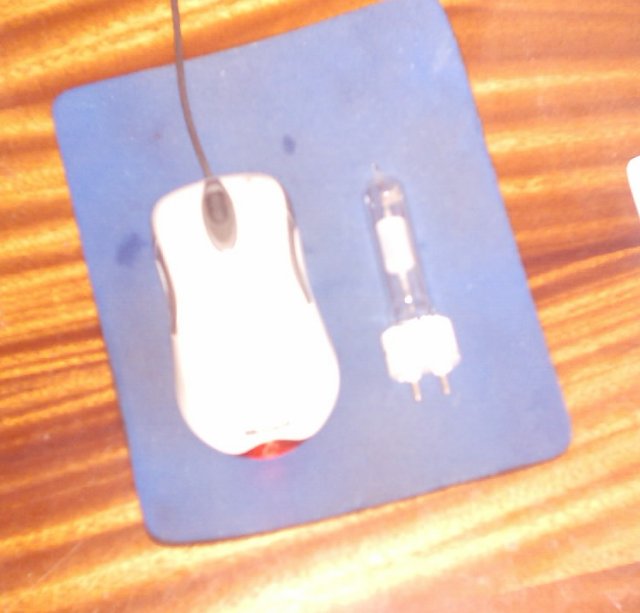

heya new, im using a cdm-t metal halaide bulb its a small bulb compared to others, getting it to work in a pro projector could be abit risky, i have a infocus lp220 here and im thinking in retrofitting it out with this lamp, it would very well be bright enough for sure, but the ballast in the infocus i have is for a 250 - 270w mh lamp, so the ballast in it would have to be taken out and retrofitted also, thats an easy modd but the psu for the computer in the projector takes +15, -15v so id have to find a small psu for the computer as the psu for the computer is with the ballast as a all in one unit, a modded comp psu will do it and it will fit no problems, im unaware of the specs for the 2 projectors u own, but if they are meant for a higher wattage bulb then the one im using dont use the bulb im using with the ballast thats in the projector as it will over drive it and it could cause it too boom boom lol, i have atached a pic of my bulb for a size comparison, as u can see the bulb is abit smaller then a computer mouse. Also i might just add i was reading up on computer psu's the other day and if u just use the 12v output and not the 5v they become unstable and the voltage on the 12v may become 18v or 22v even, aparently when u use the 5v in a comp psu the way they are meant to be run it helps to regulate the 12v to stay at 12v, i didnt save the link i should have i supose and posted it, so take care and double check everything u do to save any acidents.
my bulb spec's are:
14000lm
12000hrs
4200k colour
