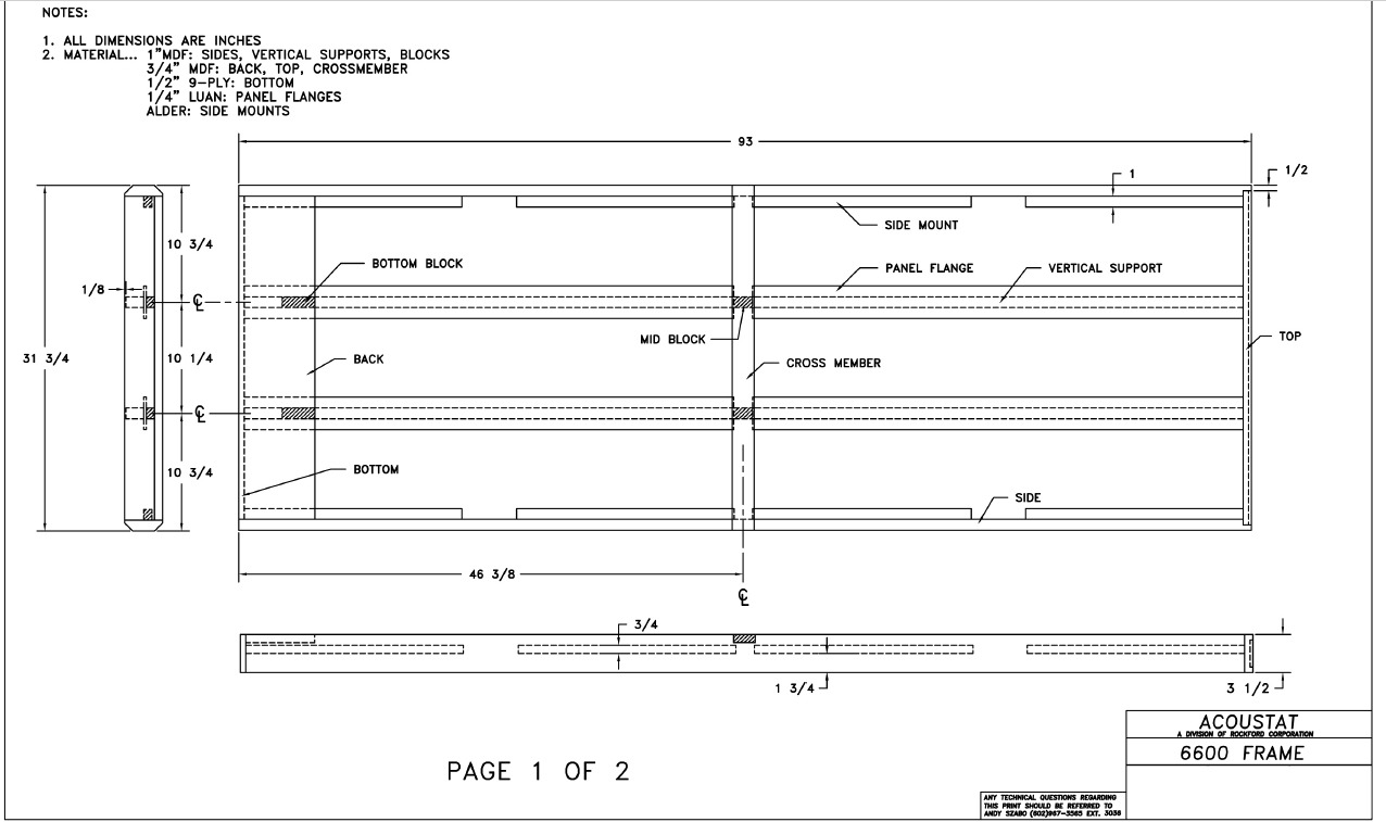

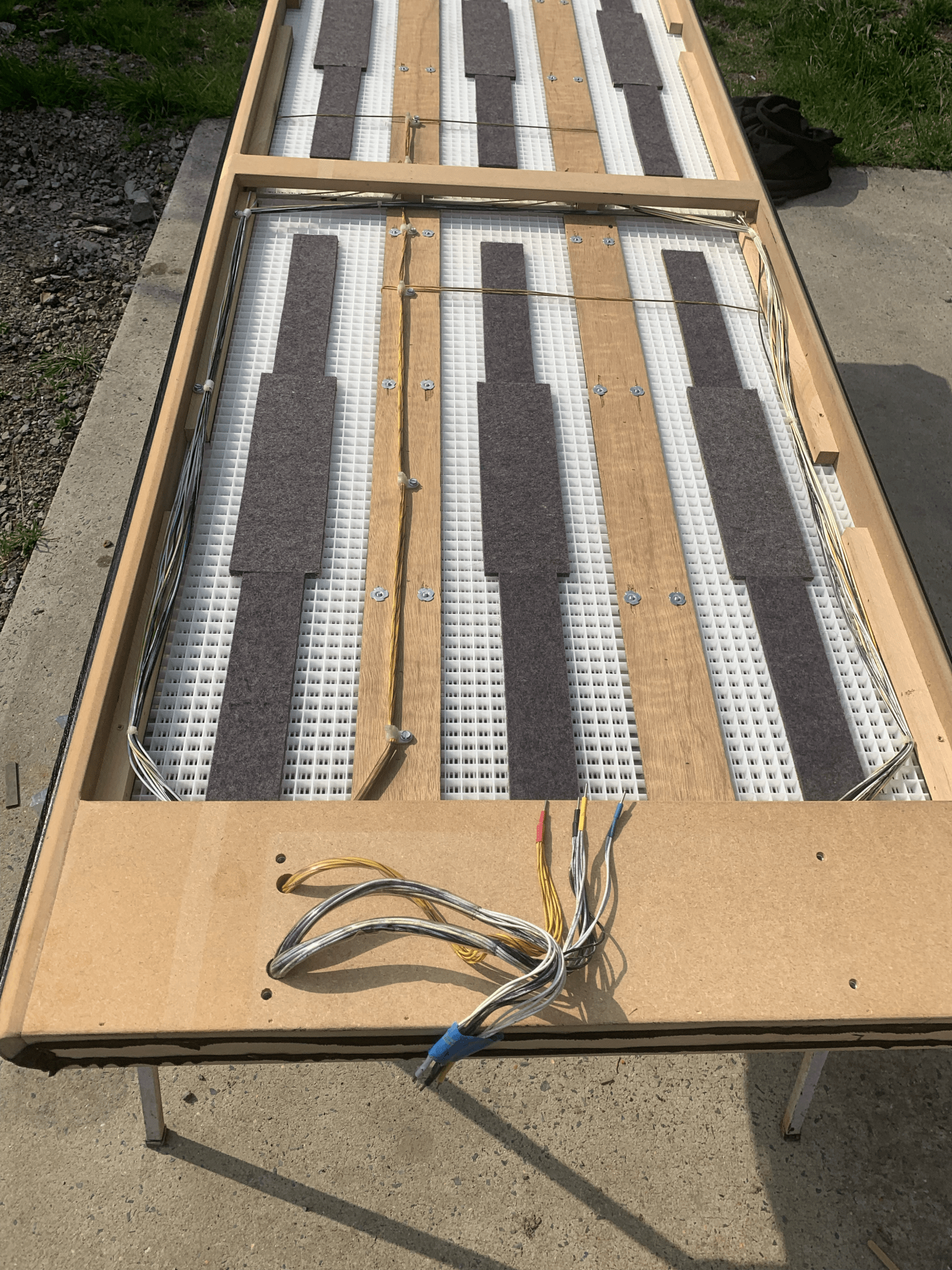

I will be remaking a set of frames for the Spectra 6600's I recently purchased and was wondering if you might have any insight into the thought process behind their design. For example, there are wooden blocks/spacers between the mid point horizontal and two vertical frame members at their intersections, instead of interlocking joints. Also, it appears that the plate at the bottom that the interface attaches to is fixed to only the outside vertical frame members and not also to the two interior vertical frame members. Looking at the frame from simply a strength perspective, neither of these construction details would seem to be preferable. Was the frame designed this way to affect resonances or ??? I would be tempted, strictly from a strength perspective, to rotate the mid point horizontal member 90 degrees, to place the two internal vertical members behind the panels, allowing the panels to be mounted next to each other without the 1" wooden member between them, and then interlock the the horizontal member with the two vertical members, getting rid of the blocks/spacers, and allowing the bottom plate to attach to the the two vertical internal members.
