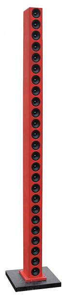

So, planning for TC9's, - can the units practically be mounted at 83.7mm centres, i.e. face plates touching, if so for Height, i could use 28 x83.7 =2343.6, if they really butt together, room is 2400, just 56 mm left, half each end, is that a benefit over the 25 or does that take the top end of the line into some reflecting mess behind the cross beam and is not worthwhile? With 25, the ends would terminate short of the floor and ceiling by a small amount.
Keep it at 84 mm to keep some wiggle room, making the array part 2100 mm tall. Personally I used a 85.5 mm c-t-c distance because of the way I wanted to create the back-chambers.
I agree with @nc535 keep it close to the ground and leave the space up top. Including my feet construction the total height of my array is about 2270 mm. Leaving me about a 75 cm gap to my ceiling from the top driver. That's making the array about 71% of my total floor to ceiling height. The ceiling used to be 20 cm lower, but due to a renovation we restored the original 3m height ceiling.
Thinking about the cabinets, i (currently!) imagine using 19mm black MDF, I am familiar with it as I used it for my 3 ways and when oiled it goes dark black, i would then put a black sock over the whole assembly as a grille. spacing of the sock and details to follow but a foam strip each side of the drivers like i saw previously probably being the answer to ensure cone clearance.

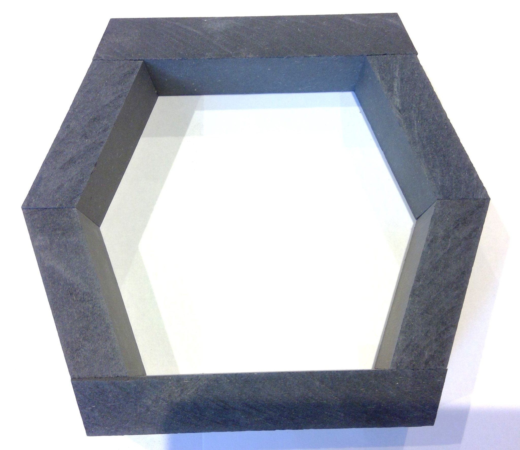

I knocked up a cabinet section to visualise how deep in the corners of the room it will go, this is 163mm baffle to back, and feels really small. It is 1 litre per chamber if i use 12mm horizontal dividers so, having visualised that, it will look fine also if i increase the front to back and side to side by 25% each, giving 1.65ltr. Is that going to be sufficient? To assemble, i can cut the vertical strips at the correct angles to fit, lay them out open and rout for the 12mm dividers and then wrap/glue the cabinet onto the dividers, keeping the baffle strip until last.
Then i can round the outside corners to a reasonable degree which will make it a somewhat non specific shape rounded hexagon section which should look OK however it is aimed.
Before all that i imagine i should start with the optimum baffle dimensions, if keeping it to a particular dimension is desirable then i can vary the back shape to a suitable volume.

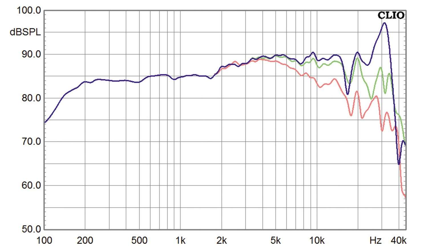

Here's all the info you need on the TC9 to judge it: https://hificompass.com/en/speakers/measurements/peerless/peerless-tc9fd18-08
For best sound it just needs a little EQ shaping as it has a rising response. Too bad some people are allergic to that kind of tweaking 😉.
The rising response actually helps make it an excellent driver for this task. Put it behind a round-over like I did and it has even better on and off axis behavior.

Hmmmmm....so if your link is to be trusted. the TC9 doesn't have a rising response.......do your own measurements differ?
My drivers were from 2011, they had slightly different specs judged by the spec sheet at the time and all information available at that point in time showed an on-axis rising response.

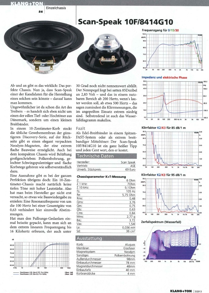

Quite similar to the Scan Speak 10F, but the TC9 is better at lower frequencies and responds better to an EQ boost down low.
The Scan 10F is cleaner up top.
I took a look at the link and the TC9 spec sheet at DigiKey has a nice (for me) interactive graph (put the cursor on the line and it reads off the values) that rises gradually above 1700 Hz on axis. is this the discussion?

I heard this line array (in a stereo pair obviously) and it was a surprising and wonderful experience. It is based on 25 Visaton FRS8M drivers, unshaded and some fairly basic passive filtering to balance the frequency response. It was crossed to a sub, but I don't remember at which frequency or what the subwoofer was. Anyway, it was at a diy-meet and I could play my own music and I chose Mahler, 5th symphony, the opening minutes with the powerful trumpet phrases. A recording of an orchestra I know well, a trumpet player I have heard many times, recorded in a concert hall with a famous and characteristic acoustic signature (Concertgebouw in Amsterdam). The scale of the sound was very good and the sort of lazy and dark dying off of the reverberation in the hall was absolutely perfect. There were many excellent loudspeakers there that day and in many ways they sounded more detailed, special, etc. But this basic line array absolutely slayed overall. So I attributed this to its dispersion characteristics and, basically, the total cone area of a 15 inch driver with the midrange and treble of a 3 inch fullrange driver.
I looked into the concept but the sheer number of driver and resulting cost were prohibitive. A bit later, I heard a 4 driver array crossed over fairly high in the midrange, which gave some of the effect. I wanted to limit vertical dispersion due to harsh reflections off the floor and ceiling of my living room, so gave the smaller line array a go. 6 drivers.
By that time, Visaton had recently released the FRS5X:
SD is a mere 12.5 cm^2, it has a beautifully extended treble, good dispersion. Too small for a sub-sat system by itself, but it worked very well in a short line array. Definitely offered enough vertical beaming to get rid of those nasty reflections. But still a limited cone area, so sounded a bit tame on dynamics.
If I ever would to a full floor to ceiling line array, I would prefer to use this driver. But because it's even smaller, I would need even more than 25. Yikes.
