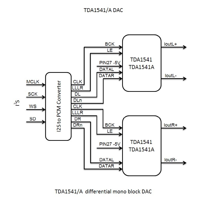

@iancanada I'd like to build a dual mono 1541 DAC like in your diagram in the doc for the is2 to pcm board. What is the best way to split the CLK and LLLR signals to the dac chips? I'd like to use the ufl connectors but I don't know if that's possible.

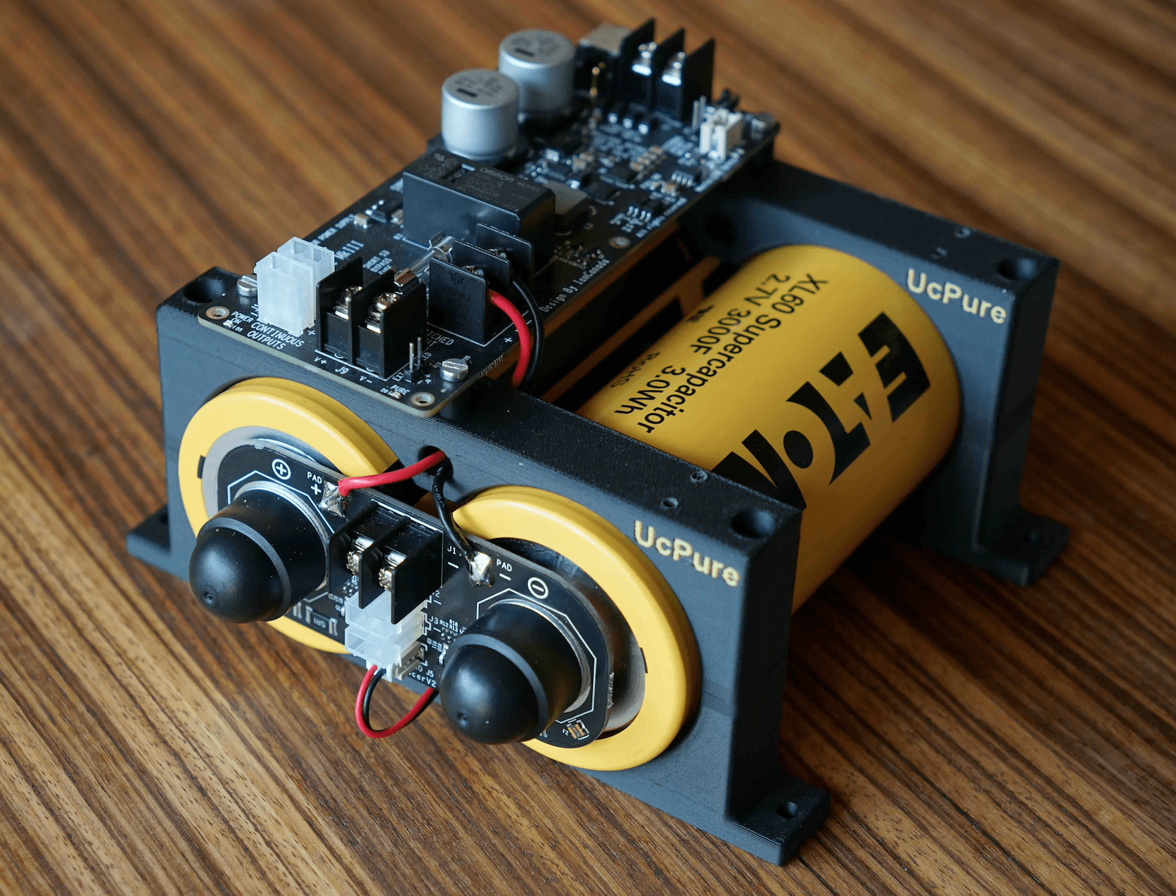

UcPure Holder V1.3 finally ready.
I have now finished the design for the UcPure holder and made the design available for free download at thingiverse.com:
https://www.thingiverse.com/thing:6578689
Some have asked to buy a set and I would consider to have a small batch made. Any interest please look here:
https://www.diyaudio.com/community/...t-holders-for-the-ucpure-by-iancanada.411614/
Regards Mikkel

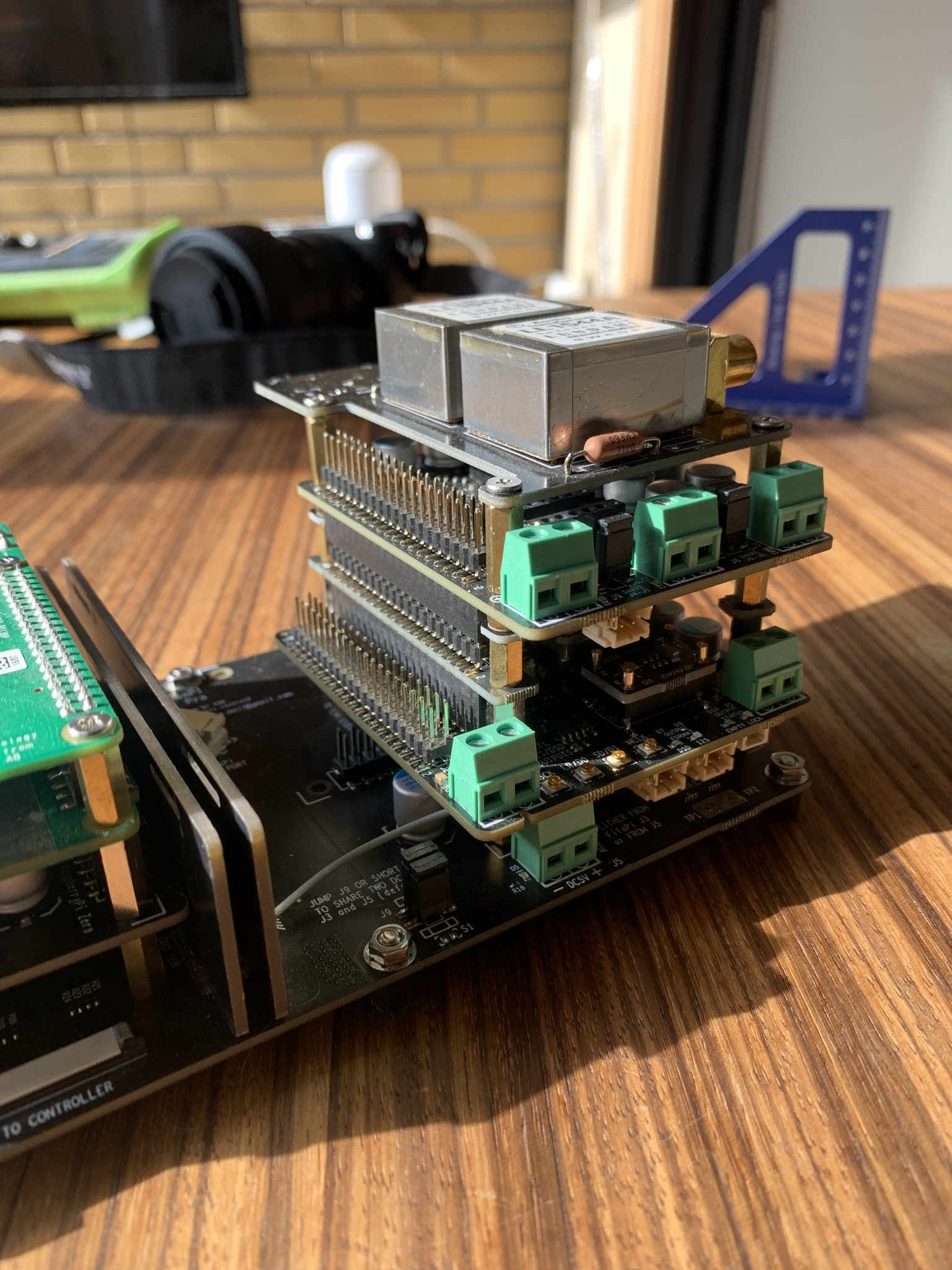

Can someone tell me the height of the StationPi stack with one of the output stages on top like the opa861 or lundahl transformer one?
After watching the video by @Gabster 2000 it got me curious. My cases will ship tomorrow and one of them might not be tall enough.
Mine measure 87 mm from the very top of a pair of Lundahl transformers to the bottom. I use 6mm standoff between the StationPi and bottom of enclosure.
I also have the gpio extension from Ian to fit a scPure clock.
It will be taller with the XLR fitted.
Reactions: 1 user
I've always found it to be a tricky process figuring out the necessary height required using the selected kit boards. You simply have to 'dry stack' the PCBs you will be using, and then look at available enclosures for necessary height clearance. Even so, there are many variables to consider. There are ways to spread things out horizontally(if room allows), by using 40-pin connectors and short ribbon cables to move PCBs off the StationPi stack. This will involve special, 40-pin connectors, and may even require pressing 50-pin connectors onto the ribbon cable ends. More time consuming in the end, but workable. With all of Ian's kits I have built, they all ended up using some creative ways to get everything mounted to suit the enclosure. I've moved to using and modding, smaller ITX computer cases(think HT formfactor) for my variety of streamer projects. Mostly, for the challenge of doing the metalwork, and 3D printing of necessary panels (both inside and outside.) Regardless of the kit PCBs I use for my projects, I can always rely on the sound to be top-tier, so it's the integration of everything I enjoy. And, the end-result is never disappointing. Apologies for being verbose.
Reactions: 2 users
Thanks Gaby🙂
Thanks... The stack will clear no problem I think. I'll have to mount the xlr's on the side and connect them with some shielded cable. No big deal. Once the cases get here I'll see what happens. I may 3D print and anti-vibration mounting pad bit I think that'll only save me 1 mm.
