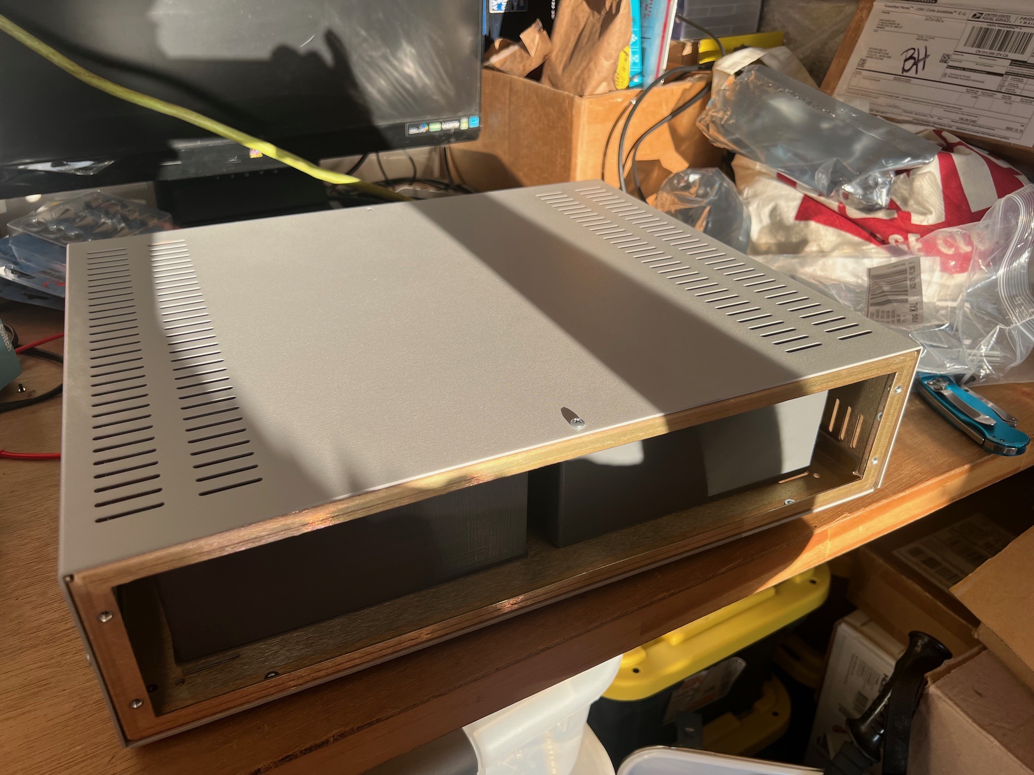

@sbelyo, Here's a link to one of my ITX build, using a PurePi and a VIML3 and Tone 2 board (DIY version). I did have some software issues that I could never resolve so I'm working on version 2, that will be based on an RPi and HDMI screen - instead of non-standard hardware. But, you can get an idea how such a DAC implementation can take shape.

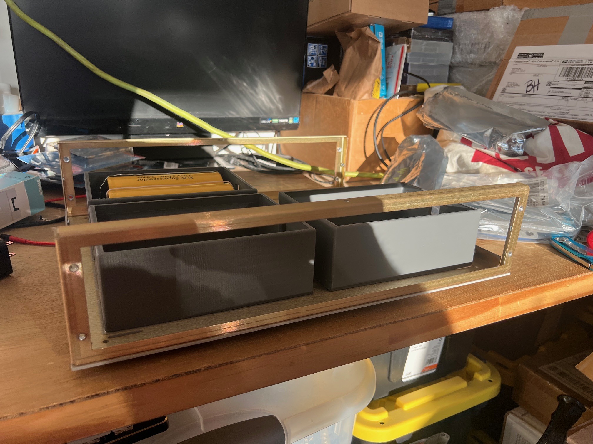

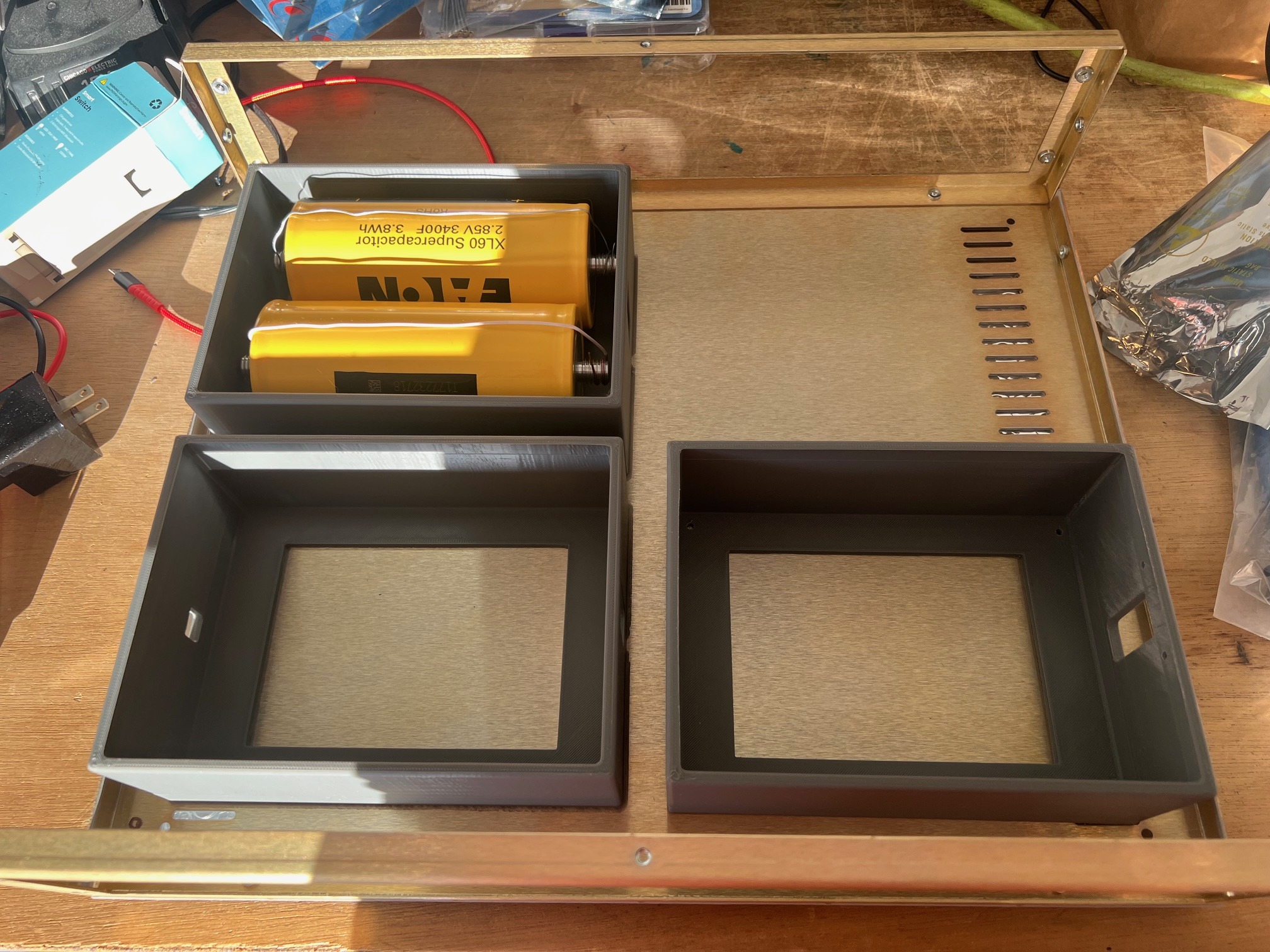

Here's the chassis pictures. I ordered two of them. The transformers will sit in an identical chassis either underneath or to the right once placed in my stack. The chassis is alodine coated for emi and corrosion protection then powder coated gray. It measures 17"x14"x4" . The gray boxes will hold a pair of super caps with UCPure's mounted on top. The empty spot in the upper right is where the StationPi will be. I have a slick idea to recess mount some speaker cabinet spikes as feet. I'll try to work on those tomorrow. This should should give you a rough idea of the layout.Mine is in pieces at the moment but a rough measurement is about 10 cm or 4 inches
The Opa861 does not need to be on top if you need to save space just run 6 short output wires
Also depends on spacing between boards and legs height …
Sounds like a great project in progress let us know what power supplies you decided to use, to fit in a case.

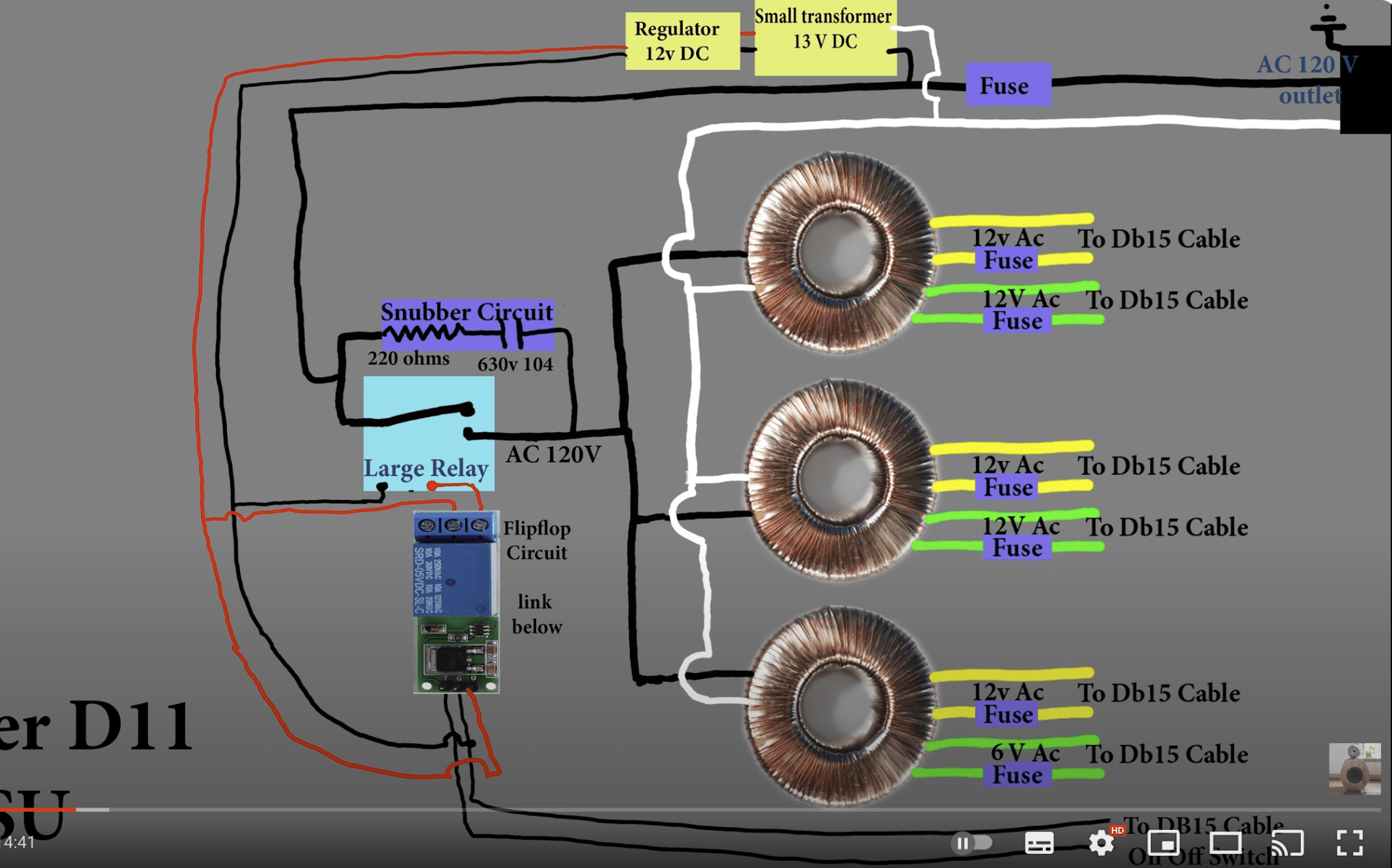

@sbelyo This a well planned project looks really good it s not easy to plan a complete closed system, but looks like you are on a good start . Checkout my power supply for the D11 I did a bit over a year ago for some ideas specially the snubber circuit that will soften the huge spark that happens when you power multiple transformers at once, and trigger in and out and timer, fuses....There are some nice helpful schematics. that you may find handy
Thanks @Gabster 2000, I was wondering about the current draw. I will have 4 9Volt 50VA transformers turning on so that's a great point. I'll take a look at what you did@sbelyo This a well planned project looks really good it s not easy to plan a complete closed system, but looks like you are on a good start . Checkout my power supply for the D11 I did a bit over a year ago for some ideas specially the snubber circuit that will soften the huge spark that happens when you power multiple transformers at once, and trigger in and out and timer, fuses....There are some nice helpful schematics. that you may find handy
Thanks, I'm going to watch it today and start figuring something out@sbelyo you are looking around 1A per 100VA Transformer so 3Amps for 3 but the hard part is the spark they create when you first turn them on so a snubber circuit helps a lot.

@sbelyo I had mine for years in a drawer anything 12v dc relay bigger then the flimsy blue ones would be better

What is the purpose of the relay here? As a noob I did some research and it seems a relay is simply another form of a switch. Is the goal here to soften the inrush current of the toroid transformers? In which case we would need a soft-start circuit?
@NeoTheOne
A relay functions like a switch that you can control using low voltage, such as 12V or 5V, to switch high voltage like 120V or 240V. Using a switch instead would mean losing the ability to use triggers, inputs, and timer functions since you’d have to physically turn it on and off. The flip-flop relay handles the switching, much like high-end commercial products with a single on/off button, while cheaper ones use a switch.
The big relay can handle more current and is more reliable it is triggered by the small flip flop relay
The simple snubber circuit reduces the spark that occurs when three transformers have a huge spark at startup, which can damage the relay or even a good switch. (I have seen a lot of burnt switches). You may have seen a spark when plugging in certain appliances. When a switch or relay is rated for 15 amps, it doesn’t take into account the initial spark, which can be far greater than that.
I have mine working for a 1.5 years reliably so it has been tested.
Hope that helps
Hope that helps
Yes its just a soft start to suppress the voltage transient at power on. Not really required in trafos this small but a nice touch. Why didn't you just put a softstart pcb with thermistors in there? Loads of them on places like eBay. I put this one in my power conditioner, that has 2400w of transformers and reliably blows switches every time you turn it on without one of these.
