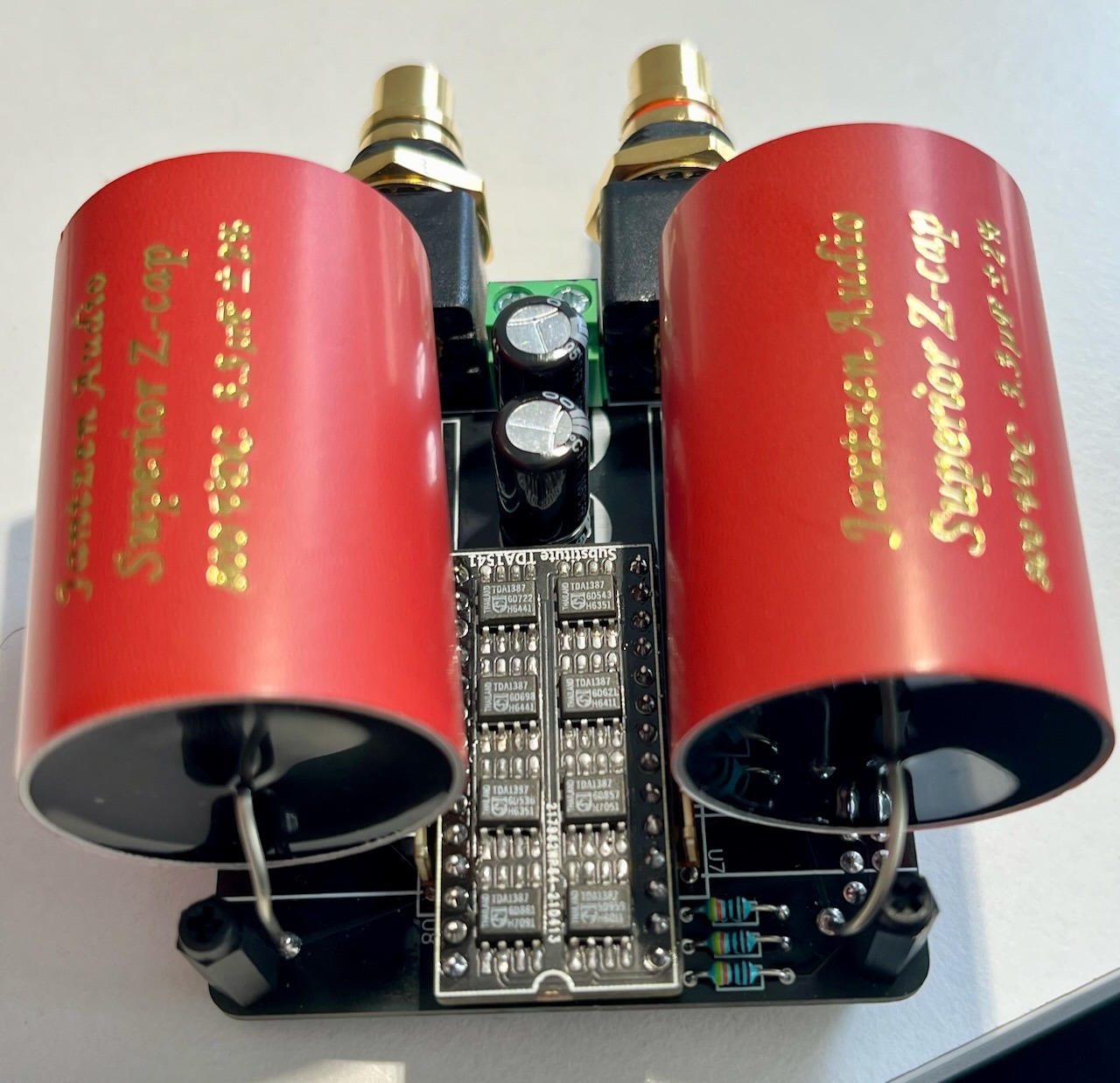

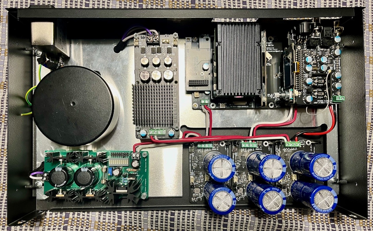

@Trebtek @Gabster 2000 I also have a pretty high tech version of Ian Canada's streamer, including PureStationPi Pro, two LinearPi, three UCconditioners, a FifoPi Q7 and TransportPi AES. It works extremely well with my R2R NOS Lab12 DAC. However, I was curious about the ProtoDAC and I am going to test it against my Lab12 DAC. I am not yet sure where I can place the ProtoDAC inside the streamer box, because it's full with components, but I will sort something out. In terms of power supply, I am thinking of using my 'middle' UCconditioner 5V (see attached photo), which is currently powering the clean side of my StationPi Pro. So, that UCconditioner will hopefully power both the clean side of the StationPi Pro and the ProtoDAC. I hope that should work. Any comments, @hifiamps @Gabster 2000 ?
I also happened to watch Gabi's recent video about using three UFL cables to connect the ProtoDAC with the FifoPi Q7.
That's something I am considering. And if can have the three UFL connections of the FifoPi Q7 connected to the ProtoDAC and the MasterClock of the FifoPi connected to the TransportPi AES, I guess I will be able to run a direct (simultaneous) A-B comparison test between my ProtoDAC and my Lab12 DAC. That would be interesting...

@pkonstantinidis
That should work. Love those Jantzen superior caps, also would love to hear you feedback on sound comparison.
Also please Note I did a correction on the order of the I2S signal thanks to Michael as the resistors and the Chip are crossed so
at 13:16 Video should say WS DATA BCK (NOT WS BCK DATA)
If connecting on the Resistor end, like in the video the Correct order is WS DATA BCK as resistors are crosslinked not as per schematic. If you are connecting on the Chip end then the order as per video is correct.
Reactions: 2 users
Ok So I checked the Grounding on the Pure PI / FifoPi (Ref Protodac Fifo PurePi combination) @pkonstantinidis
You will need to Connect the I2S wires to Ground as the ground 5v on the Pure Pi is not connected to the Fifo UFL ground because that ground comes from the 3.3v side. (Also remember we are no longer connect to any GPIO pins)
The 2 power supplies are galvanically isolated and do not share ground I think Mark's concerns are valid but only if you are sharing the ground from the same PSU, but not in this case.
I wonder if that also contributed to the better sound.
It is nice to see concerns as that helps us further understand and double check our steps.
hope that helps demystify this always complicated ground subject :)

Thanks for the clarification about the soldering sequence of the i2S cables, @Gabster 2000 . Duly noted. And based on your comments and also those of Mark (@hifiamps ), who is the designer of the ProtoDAC, if I have not misinterpreted anything, I should solder the sheath of the three i2S cables on pin 6 of the ProtoDAC and then connect that pin with the respective pin on the GPIO of the FifoPi Q7. I can use a Dupont cable for that. Can you confirm, please?
Here is a recent photo of my streamer, having added a MonitorPi Pro (with an extension flat band) and a push-on switch on the semi-transparent front face.
I will probably put the ProtoDAC in a separate, external small metal box, to keep the ProtoDAC shielded. Unfortuantely it cannot fit in my streamer box. At the same time, I suppose I should keep both the I2S cables and the power cables from the (middle) UCconditioner 5V as short as possible.
