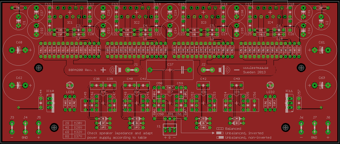

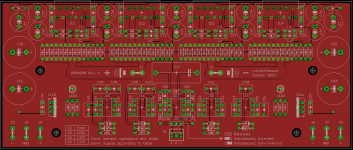

I attached a PDF-file of a schematic that I have made. Now, there is some notes you must now. I have not tested it nor built this specific version. I have double-checked it but there might still be some errors. Grounds are not separated and it uses a groundplane. This is not liked by many members on this forum, it have worked well for me in other designs but it might not work for you if you build it. To be honest its impossible to use a star-ground on a two layer design of this size. Also, component values might have to be changed. I will not explain that further, all information about why and how is available in the PDF previously linked and in basic audio design around the web.
EDIT: Ground are in fact somewhat separated.
You get the best performance by using a ground plane. If you want to get fancy, you connect the feedback ground and input ground to the output ground by a separate plane. The reason ground planes work is that they minimize the inductance, hence, the impedance of the ground connections. This is the only way to ensure that you get the published performance of the LM3886. Anything else will cause a rise in THD at higher frequencies (sometimes starting as low as 1-2 kHz). I have a stack of measurements to back this up...

First, have you not read the data sheet for the LF412? Supply voltage is no more than +/- 22V. Connecting it to 35V will fry the LF412 and a result of that is that it will fry the rest of your amp.
Also, your schematic does not show a bridged/parallel amp. It shows an (unfinished) paralleled amp. What is it that you want to build?

That schematic will not work. Do your homework. And it's still a paralleled amp only, not a bridged/parallel.
Honestly? Did you not read the data sheets for the voltage regulators? How much mAh can the 78 and 79 L provide? How much does every OP draw in worst case scenario? How much mAh does 4 of that add up to? Come on, your not even trying.
