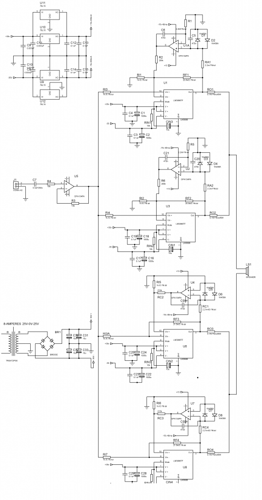

No that's not what I meant. I understood that it's not complete and I saw that the 2 on the bottom is connected to Vin-.I know it's not working because is not complete
as you can see the input of the last 2 lm3886 at the bottom is on (pin 9 Vin -) unlike to the two LM3886 at the top of the diagram is on Pin 10 (vin +).
I just need partial assistment of the schematic.
But it is still faulty. The speaker is not connected as it should be. Also, your Rf and Ri-resistors are not correctly connected. And Ri has not a good value.
Incorrect polarity of the negative rail bypass caps (C2.....) and the mute caps.
Thank for comment
-the MUTE caps is 10uF Caps Part Reference in schematic CIN1,CIN2,CIN3,CIN4 is connected to pin 8, and 7 of LM3886TF, Pin7(GND).
-C2,C16,C22,C26 Filter caps value 1000uF/50v is connected to -35V input of LM3886TF Pin(4) V-
I can't see any Incorrect polarity.
I know, sir but I believe that the polarity of the capacitor you mentioned earlier that wrong, is correct; that's why I need the opinion of others, I accept it if someone also say that the polarity of my capacitor is wrong, but again I review it again.and what is the purpose of forum if I the only one who answer my questions;
here my another recap of my schematic; I never change the polarity of the capacitor in mute and in-35v bcoz I believe the polarity is correct; but I made some change of the resistor value

There are numerous errors on the schematic. The most obvious one is that half the local decoupling caps are polarized the wrong way. You can't just put two LM78L15/LM79L15 in parallel to get twice the current. At least use ballasting resistors. Or ... just use the 500 mA or 1 A version of the regulator.
My suggestion:
1) Build the power supply first. Get it to work. Test it with a load resistor.
2) Build one (1) channel of the amp without DC servo. Get it to work. Test it.
3) Add DC servo. Get it to work. Test it.
4) Build a second channel with DC servo. Get it to work. Test it.
5) Connect the two channels together either bridged or parallel. Test the resulting amp.
6) Etc.
Build in blocks, test the blocks, then combine them to form larger circuits. All experienced designers do this - either in the simulator or on the bench.
There. I've led the horse to water. It's up to him to drink it.
~Tom

Once you start laying out the board you will find that using a Quad opamp won't save you any board space at all.
Maybe when using the LM4780's a dual opamp type might work Okay.
But then there is also the issue of finding a dual or quad type that has the voltage offsets (Vos) perfectly matched as per section.
I have not had good luck with some of the common dual types I have tested so far.
This increases the cost of having to use some more expensive precision types that are guarantied very low Vos per section.

I am not trying to deter you from your goals.
But, It is much more complicated than just copying a schematic from the data sheet and making mistakes doing so along the way doesn't help in any way either.
One of the biggest issues I have had watching these threads is trying to follow revision after revision of finally getting one to work properly with much satisfaction in the final design, mostly do to typo's or missing parts in their design!!
But, Ya gotta love R&D besides!!
I completely agree with the guys when they say build one section and then add the servo or composite opamp or whatever technique you chose to use, First!!
Then start paralleling the working sections while working out the issues everytime you add one.
Then draw up the board as a whole.
In fact this is how I design a lot of my stuff,
I First make the circuit and work out the issues using my protoboard.

But Please, Don't take these guys advice (and mine included) just as a grain of salt.
I have made my share of mistakes as well and it is just very frustrating and can be very costly when a project goes wrong over something very simple.
Learn to work with the chips and learn what there limitations are before jumping into a higher powered version that can cause some real damage should anything go wrong!!!
Aside from that note, I really like the servo design, But I am more and more thinking that the composite amp design may be even better as it kills two birds with one stone!
It lowers the THD and it keeps the Vos in check as well and that is where I am at in my design stage of this type of amplifier.
So, I am going to start venturing in some simple designs myself as suggested, before I start paralleling and BTL a bunch of stages.
Speakers are much too expensive to replace these days over a faulty amp design.
Good luck with your Project and I hope to see you accomplish your design goals.
