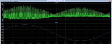

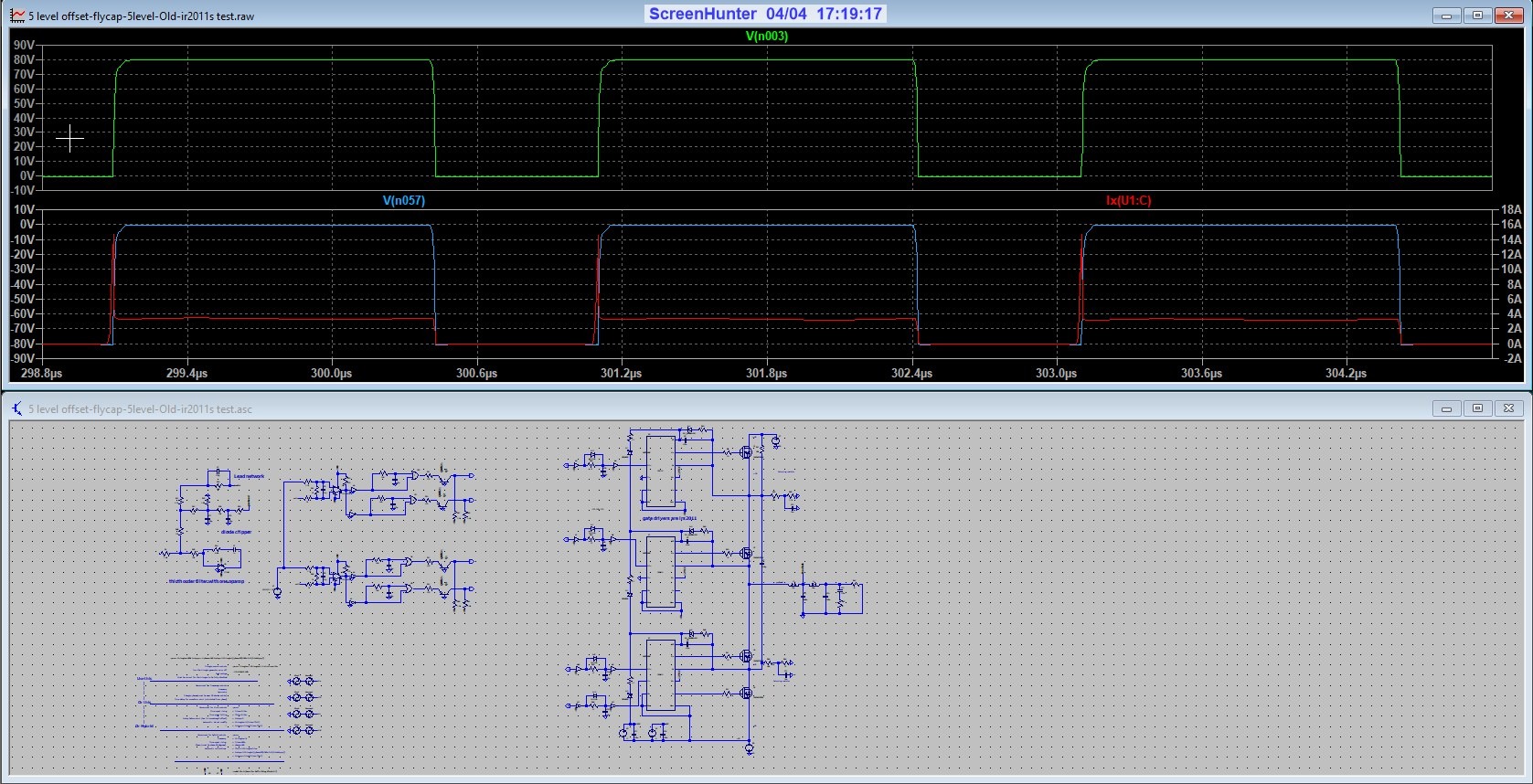

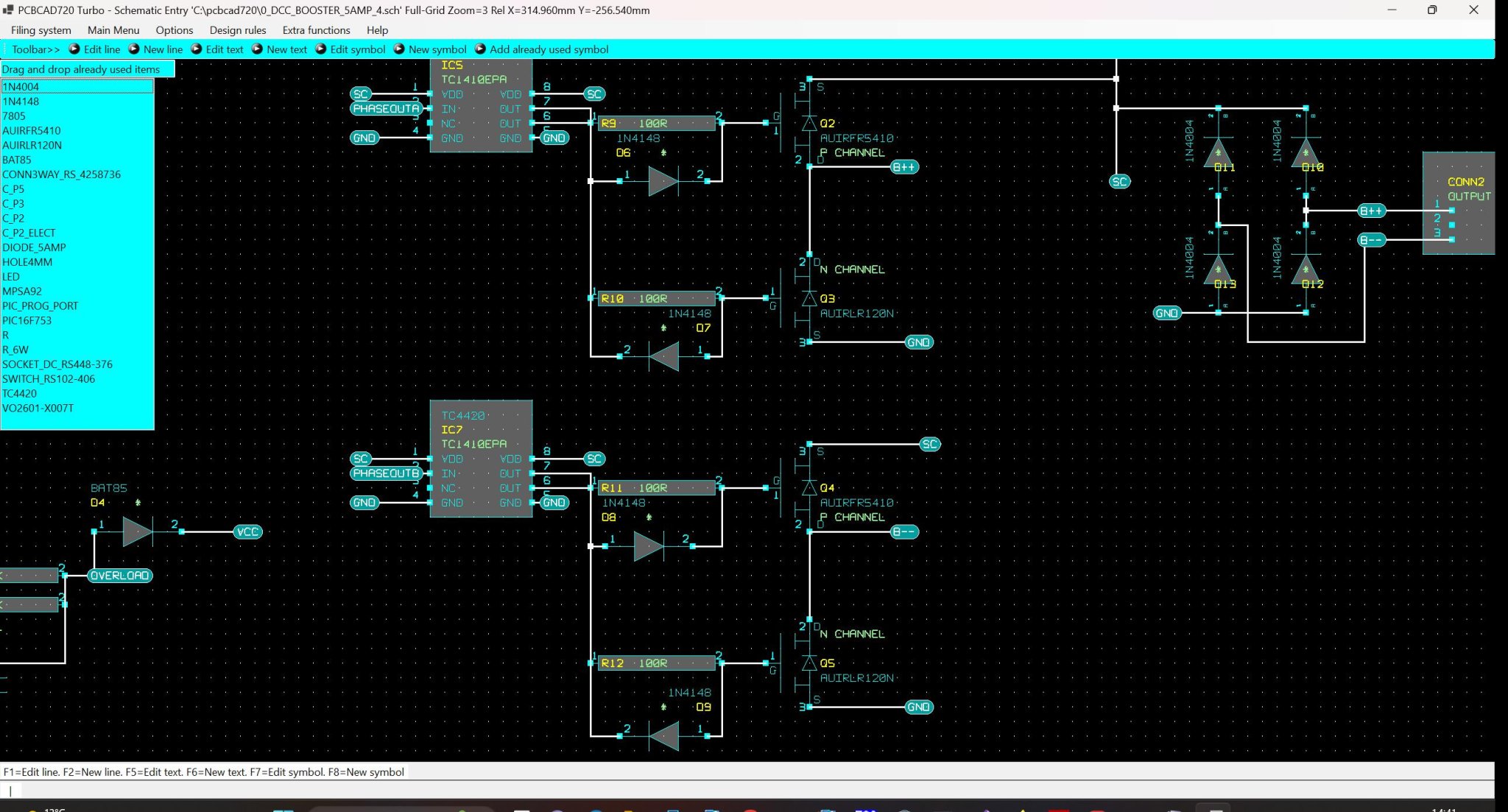

Hi there all.
I need a different deadtime arrangement for a 3 level converter.
The delay need te be different as for half bridge, I need delay for up and down flank of signal.
When I use a normal deadtime circuit I get delay on up flank also a delay on down flank,
I mean total signal is delayed. So I get a shoot through when drive signal get low. I need a
separate dealy for this low signal, I think I need a clocked design of so? with diodes I can
do some, but not as it has to be.
see the pics for clearance. The pic with the errors are the wrong one, need a double delaying
on both up and down signal to keep capacitor balance oke.
thanks in advance.

You mean a resistor and a diode?
I did try just now, it do work but make not signal of Gan mosfet better, I use the classic delay circuit
before the mosfet driver however these just delay the whole signal, so the off signal is also delayed but to the wrong direction
causing unbalance in the capacitors. Maybe I need clocked version for every separate mosfet. Read some about that.
regards

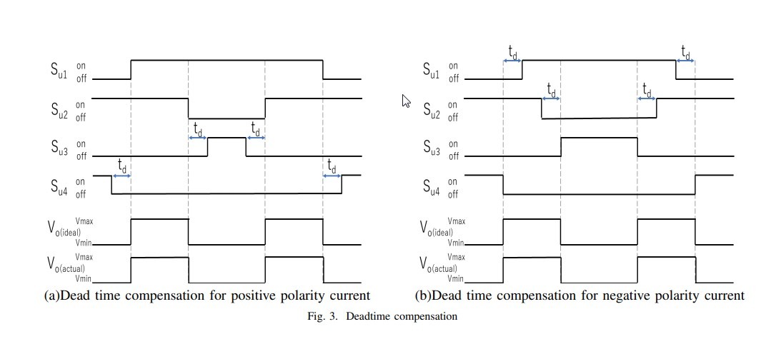

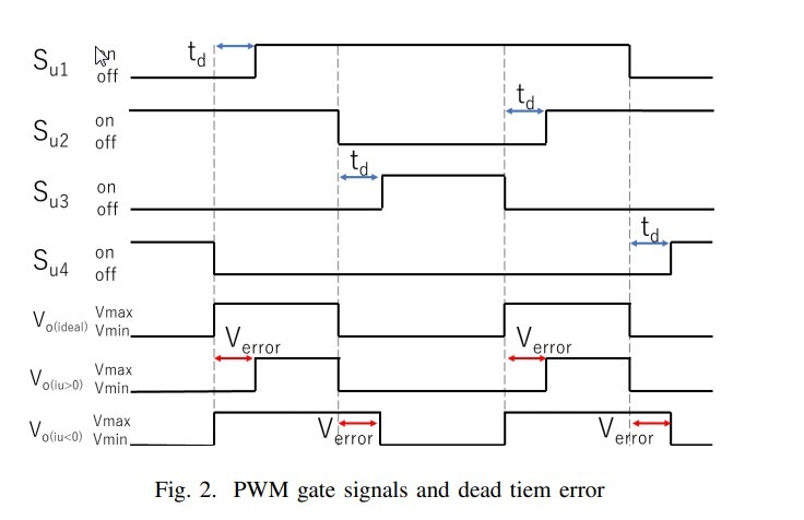

I have a flying cap version of class d multilevel, and these have a different deadtime, mean, it need not a delay but a pauze in both
signals, this pauze is deadtime width who means then mosfets are off. this way I get not trouble with voltage error.
It is aso done with current feedback compensate the deadtime, current feedback does much better here.
regards

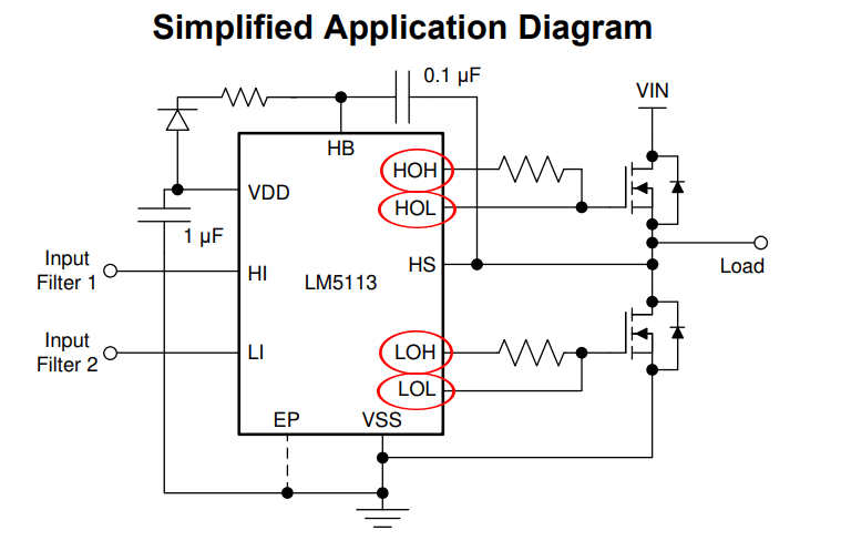

For GaN mosfets, it may be better to use separate charging and discharging (below), as opposed to using resistor-diode drive. Irrespective of topology the complementary switches are the ones that experience the dead-time. For the flying capacitor inverter, these are the outer and inner switch pairs.
Reactions: 1 user
The LM5113 does work like a resistor and a diode does, the resistor on one side of the driver do turn on mosfet slower and fast turnoff.
Yes, the operation is similar but the diode doesn't equal the internal MOSFET when it comes to discharging.
for flying cap i need both ends of signal delayed. otherwise i get a voltage error.
Proper dead-time insertion introduces volt-seconds loss. This value is Vcc*td / (2*Ts) where td, ts and Vcc are deadtime and PWM period and bus voltage respectively. You may feedforward compensate for this error if you know the direction of the load current.
Yes, correct, But I have read here that there are solutions for that.
It is a kind of deadtime correction.
Maybe you can read and then explaine me, much thanks.
https://ynu.repo.nii.ac.jp/record/9838/files/8_AMC_Takahashi-Final2.pdf
I can also use current feedback for this because current is affected, Otherwise I stay with just
the way it is done, using feedback for correction. But learing new things is always fun.

If I were you, I would use 'regular' dead-time, as already mentioned above and leave the error correction to feedback.
I'm not sure if you're doing this, but the flying capacitor voltage needs to be maintained at Vdc/2 using a closed-loop mechanism that chooses the correct redundant switching state of the inverter according to the load current polarity.
Any other 'inherent', automatic, textbook balancing would cause the flycap to gradually walk away from Vdc/2, due to non-idealities.

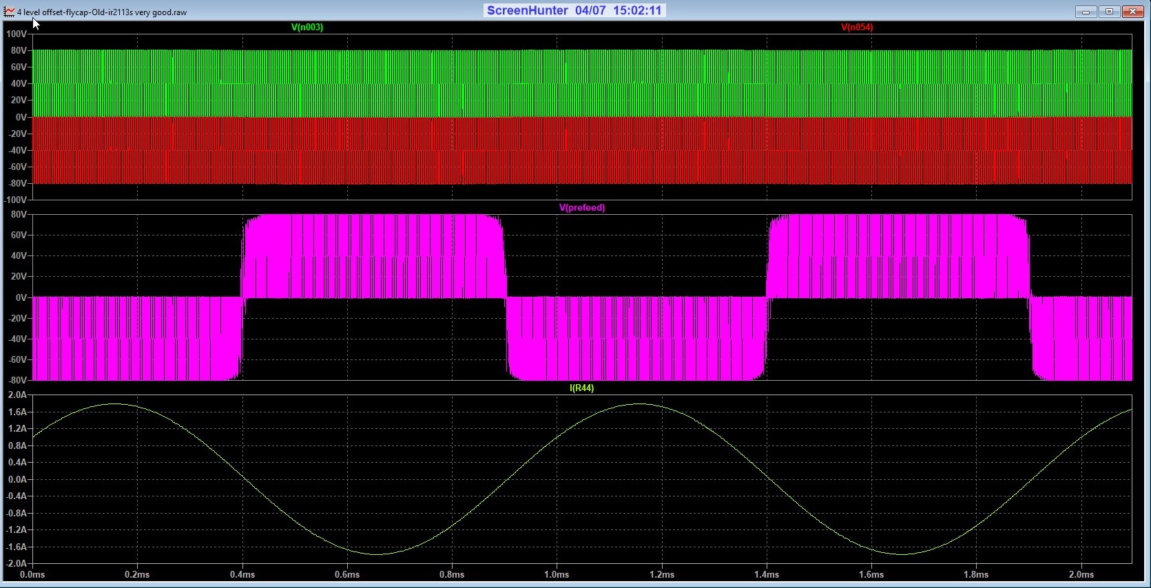

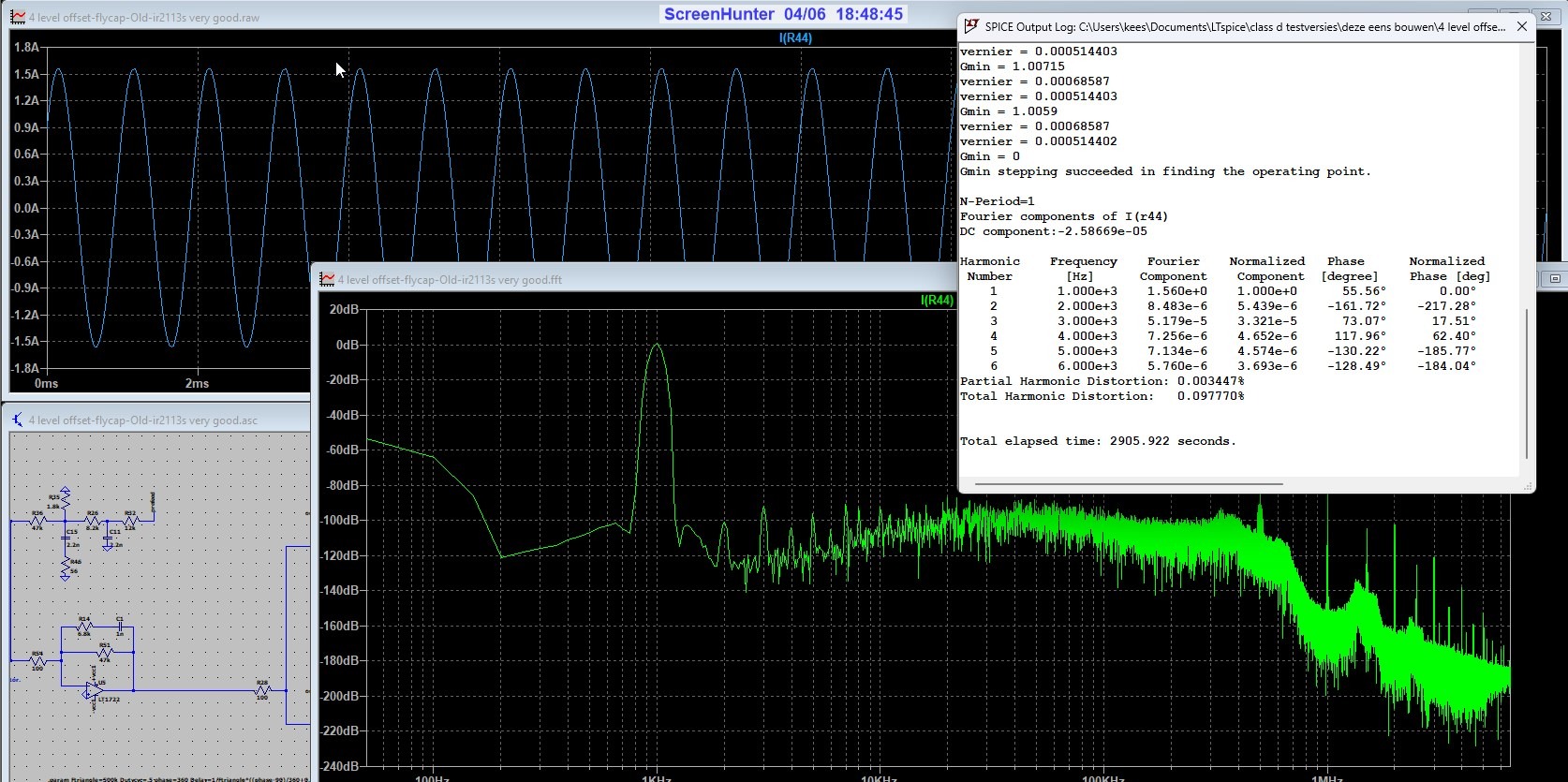

Hi
The inverter does have 90 degree shifted triangles and I use feedback now, I think I go that way as you mentioned.
The 90 degree fase shift take care for the Vdc/2 states. This way is stay automatically balanced.
A way is for dead time to do sense the gate drive voltages and use nor of so, only when one fet gate is zero the other get switched
and vica versa
Some gate drive ic do use this.

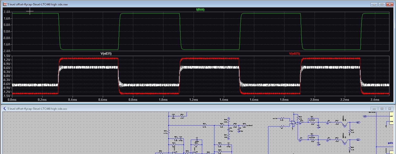

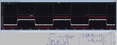

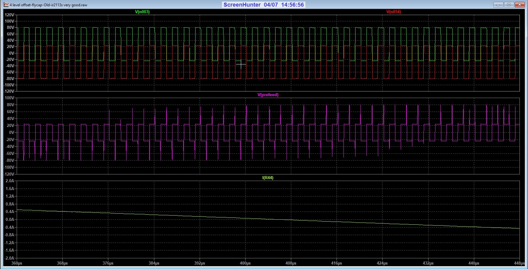

I did see when use a second order integrator the balancing and distortion is low, setting it to amplify 20 times I can insert
a postfeedback. This will be Pi controller of second order.
On second pic you see nice balance. and low distortion with quick feedback setup.
go later, when no succes, I have still fun.
No, that's the simulation only. If you need proof, try disturbing the flying capacitor from its nominal voltage and see if it 'automatically' returns to Vdc/2. I'm sure it wouldn't. This type of balancing is guaranteed to fail. It could also negatively impact the PSRR.
A way is for dead time to do sense the gate drive voltages and use nor of so, only when one fet gate is zero the other get switched and vica versa
I think that's called 'adaptive gate drive', was used by National Semiconductor few years ago.
Yes, that's probably the wisest way to cut distortion.

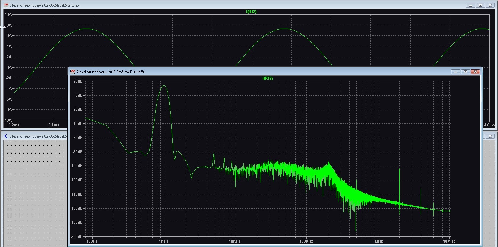

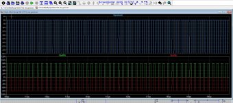

here is a pic who do with feedback from past, do well so on eye. also the square test did.

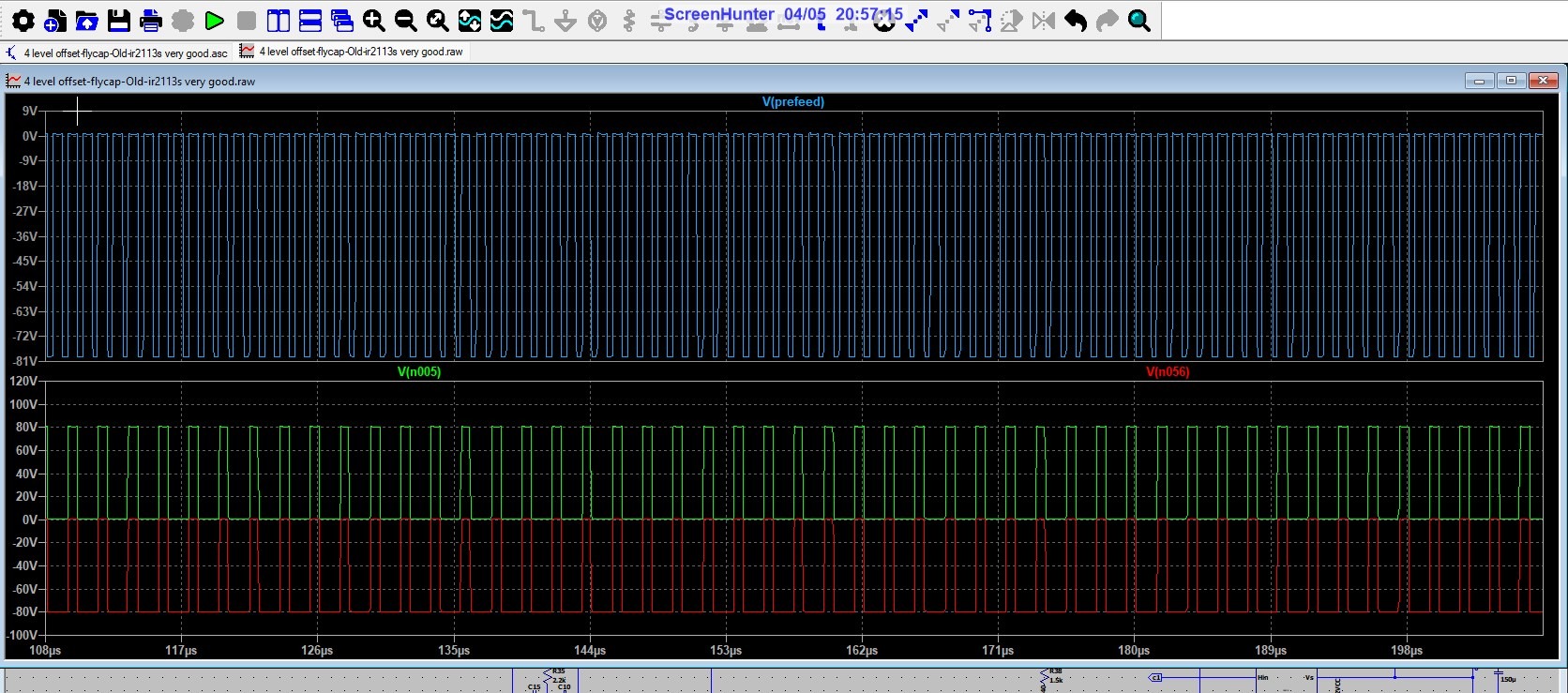

I did read this in a paper. With PSCPWM (fase shifted triangles) natural balancing occurs. I use this system.
Multilevel converters and flying capacitor multilevel converters in particular were presented. The paper proposed two methods for controlling the clamped capacitor voltages. The first controls the capacitor voltages by measuring them en choosing an appropriate switch state. The second makes use of the natural balancing characteristic of the converter, so the capacitor voltages are balanced without measuring the clamped capacitor voltages. This inherent self-balancing mechanism would ensure safe operation under most operating conditions. A harmonic analysis of the flying capacitor multilevel converter was developed and it was concluded that a clamped capacitor voltage unbalance is possible when the switching frequency is not much higher than the highest frequency of the reference voltage. The load impedance is of high importance and can be manipulated to enhance the effect of the natural balancing mechanism.
There are flying cap class d out there, even 5 level getting easy 2 Mhz switching. I have 1 Mhz from 500 Khz.
I have done some sims, one thing do I do see is strange, I get more shoot through when I set deadtime higher in
such a flying cap circuit.
Maybe this is because of the delaytimes in the mosfet driver ic?
I get with the used feedback circuit (two Pi opamps and forward feedback) nice low distortion.
And yes it is sim, trouble expected in real live, make it excited work.

What concern capacitor voltages I do use IC=volt/2 in multisim, when I do not things are bad, that is what
you did warn about. See pics, left is unbalanced and left balanced. Did balance in ltspice with IC=80 on flying
capacitor so sim start balanced.
