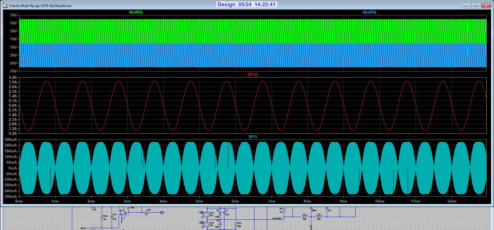

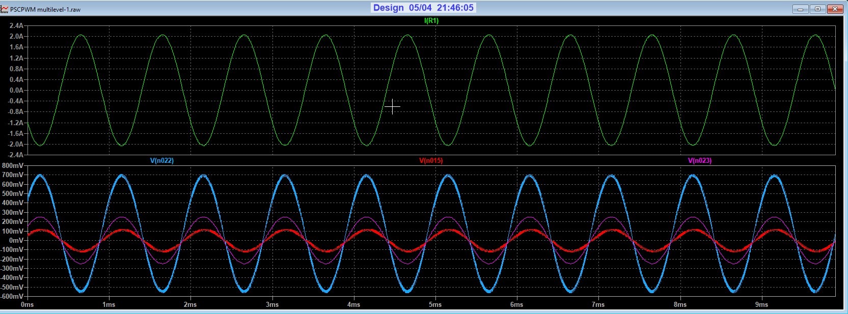

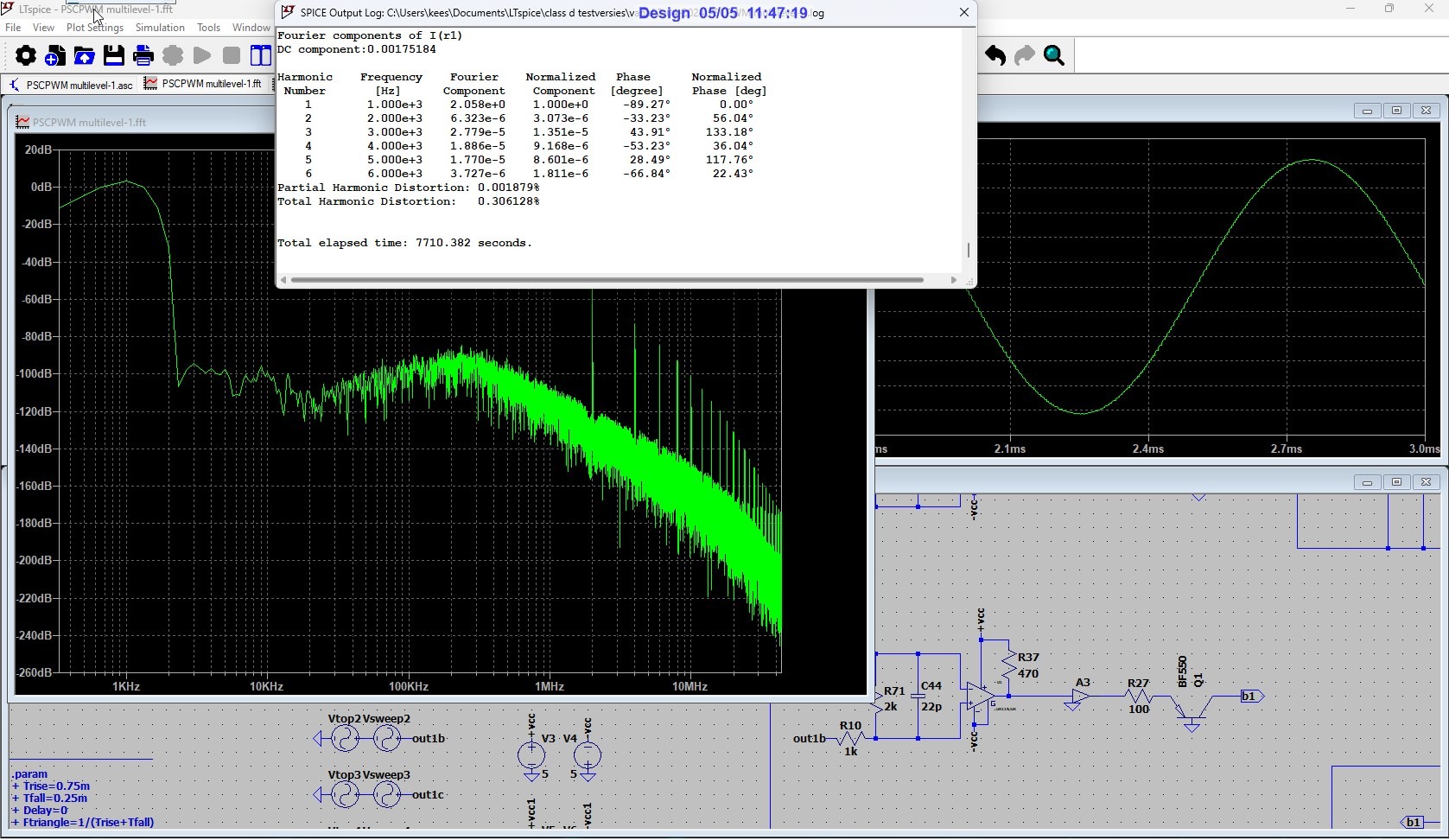

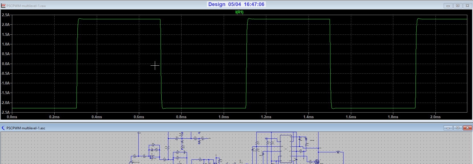

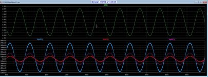

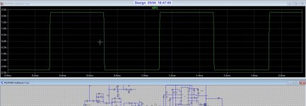

Here some tests from ltspice.
the feedback is a challence because the fase need to stay around 90 degree, the whole way up.
This I do from yesterday. Nice step test so low pass is nice correced. (postfeedback included).
also open output is stable, and clip.
Mayve I call it the LTspice class D.

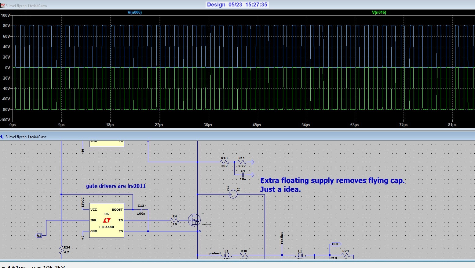

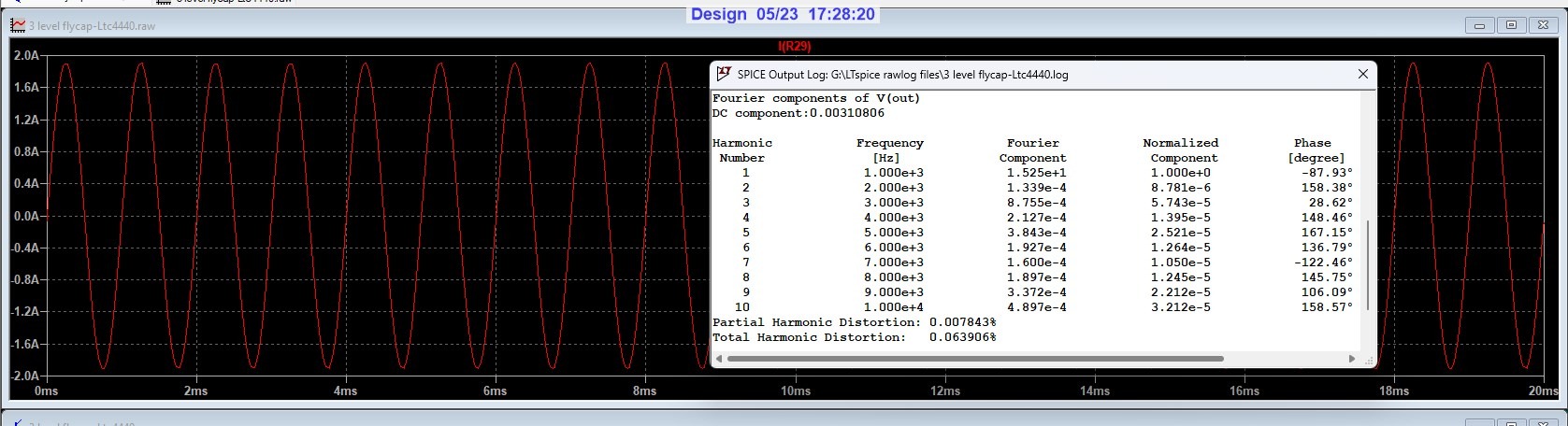

Hi newvirus.
I have did a test with one extra supply, removing the capacitor, that works also
when that supply is floating, no more trouble with balancing I gess.
Do not take to serious, it just came op in me think about cascaded versions who need complete floating.
Maybe I have invented a new way. ;-)

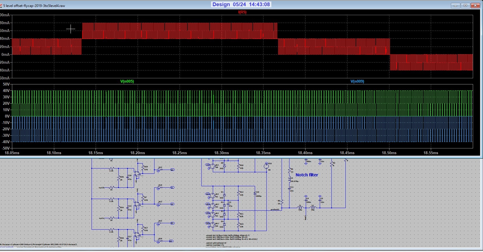

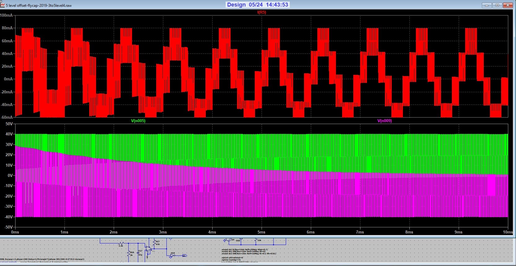

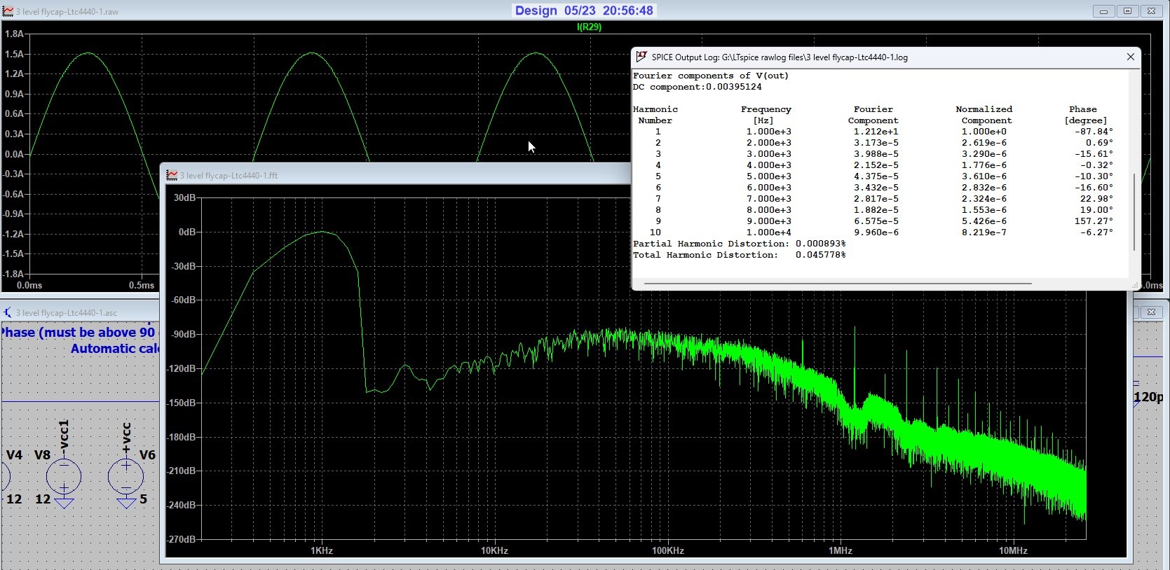

Here a test with cap and a notch, it does very will keeping cap balanced.
The other ways are as you said, need extensive circuits or is included in a controller
with software as most has, most grid invertors for sunpanels. The need is high because of
the high voltages involved, audio has much lower voltages.
design 189 is sim started with zero voltages, and 186 and 188 is when simulation reach stability after 10 mseconds,
I can lower the notch current a lot, if I use settle time of 100ms. resistor in notch needs higher in that case
lowering inrush (charging cap) current. charging current on lower plot 186. distortion on 183 single ended 3 level
flying cap.
