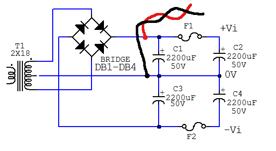

Wire on the way (Thanks for the suggestions Salas) and I think I have most of this straight in my head as far as making all of the connections. One thing I'm still trying to sort out is where to tap DC power for the inselect board from the DCSTB power supply board (DCG3 build). I've seen a few options, but I'm leaning on tapping from one of the capacitors on the board, I'm just not certain which one, and which terminal of that cap? Thoughts?
Thanks much all!
diyAudio Chief Moderator
Joined 2002
This way
