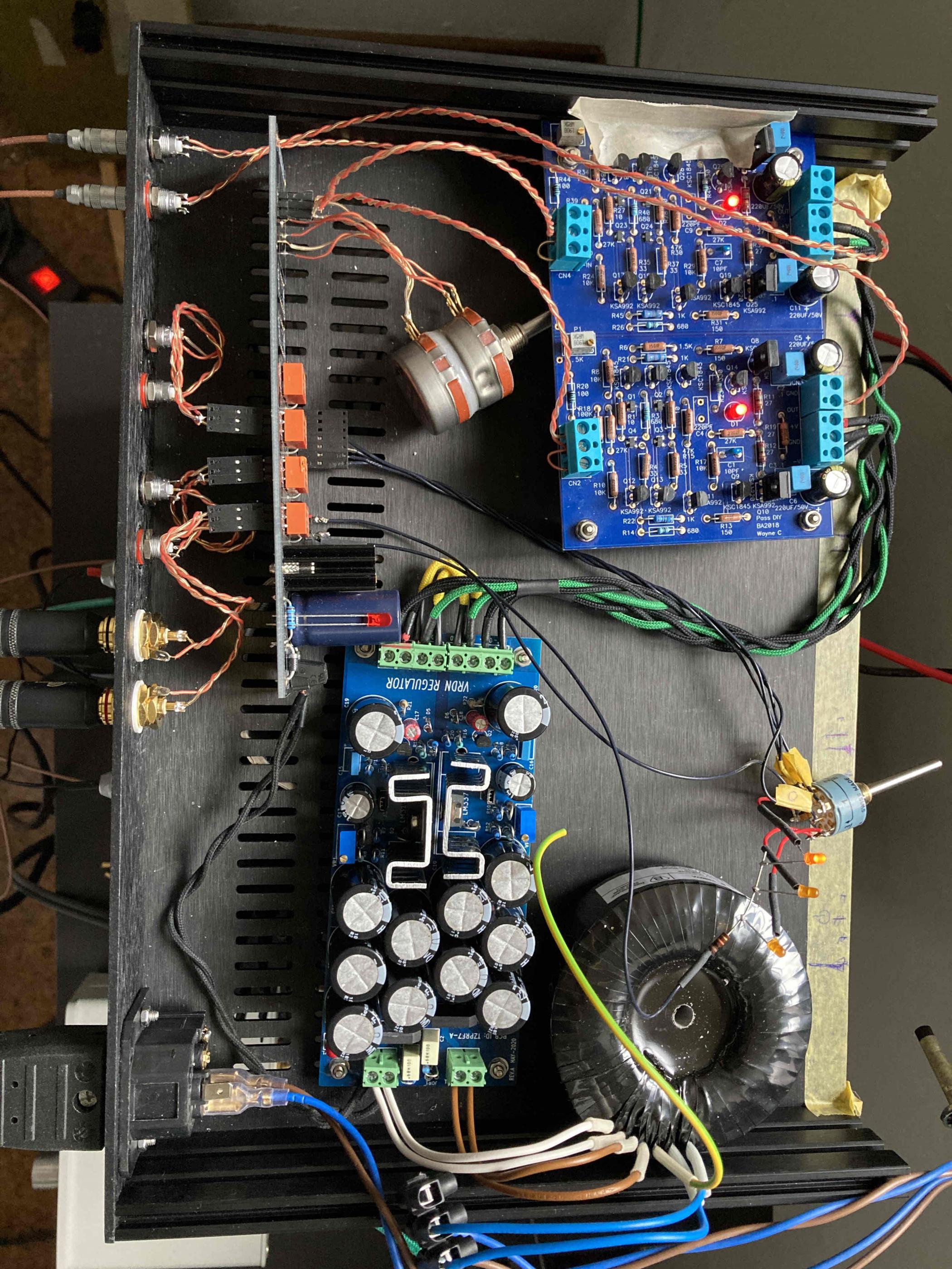

Hello
Step by step, I got my line-stage/preamp together.
It's
  • Wayne's BA-18
  • VRDN PSU
  • Toroidy 50VA
  • i-select
  • PEC pot (for now)
cinemag output transfos not yet built in (will I need it at all?)
I haven't put them properly (the boards are floating in the chassis and the wires are still a little too long, so it looks messier than it will be)
I would like to incorporate a elma relay-attenuator (replacing the PEC) with a "simple" encoder, no display/remote/motor, and therefor need some tiny bit of current (9VDC, 50mA).
i-select is fed 18VAC (from the toroid) and provides 12VDC out, feeding the selector-leds... It would be cool if I could have it feeding the attenuator-board too, but... can it? how do I get 9V out of 12V? (now you see how little I know :eek: )
If I understand the attenuator correctly, it's working in a "similar" way as the i-select: signal is routed through the relays, so the encoder and "current-provider" isn't so deadly important?
Thank you so much!

Many ways. A. RC cell for voltage drop and filtering if the relay attenuator has steady predictable current consumption so to calculate R for 3V drop. B. 7809 post regulator fed from 12V. C. 3V dropping blue LED in series that stands the needed current (if you can stand it's inside box glow). D. Many diodes in series. E. Low voltage Zener. Etc.
Yes, power controlling the relays does not mix with the signal they actually pass so a simple power line solution is adequate.
