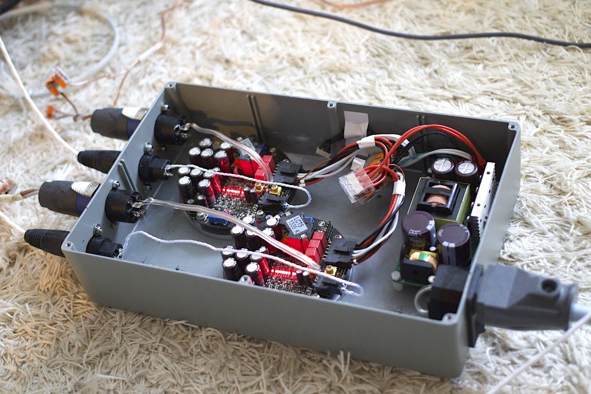

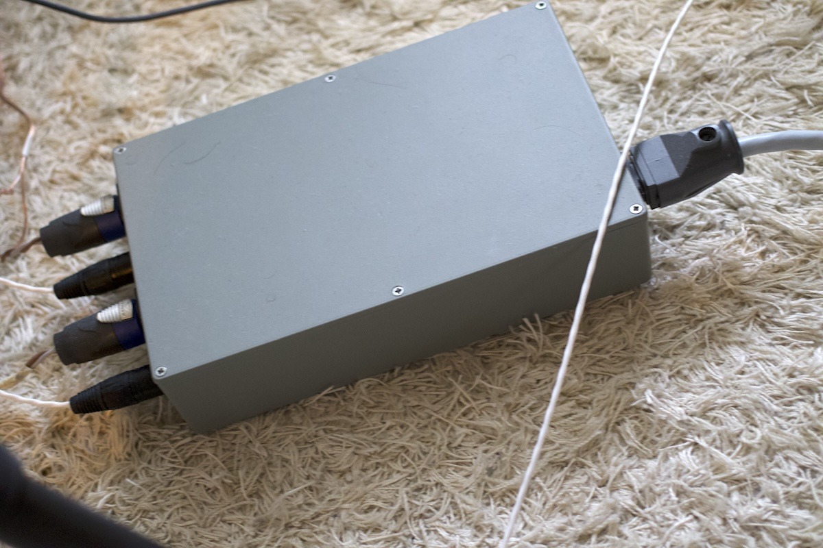

I must put in my log also that I finally caved in and broke apart my DAC/AMP box, reused the cabinet for an ASP1000 mono amp that Thor struck out last summer and built myself a new power amp. I managed to squeeze in two pcs. of Hypex Nc400 and a "CONNEX SMPS320RxE Power supply board 320W +/-36V" and made my own power splitting cable sets - should be enough for HF duties. So finally the HF is not a problem anymore but it apparently took the heavy guns to make it so. Done deal.
I'm now on the hunt for an other pair of nC400 so if you have a pair unused.... 🙂

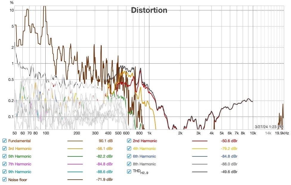

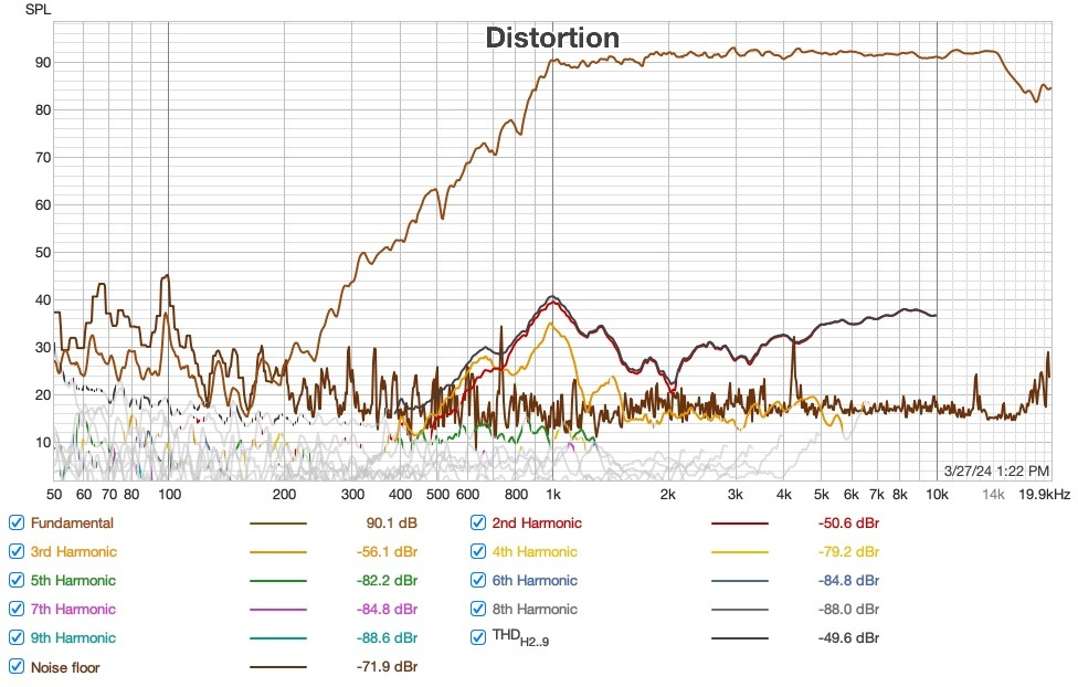

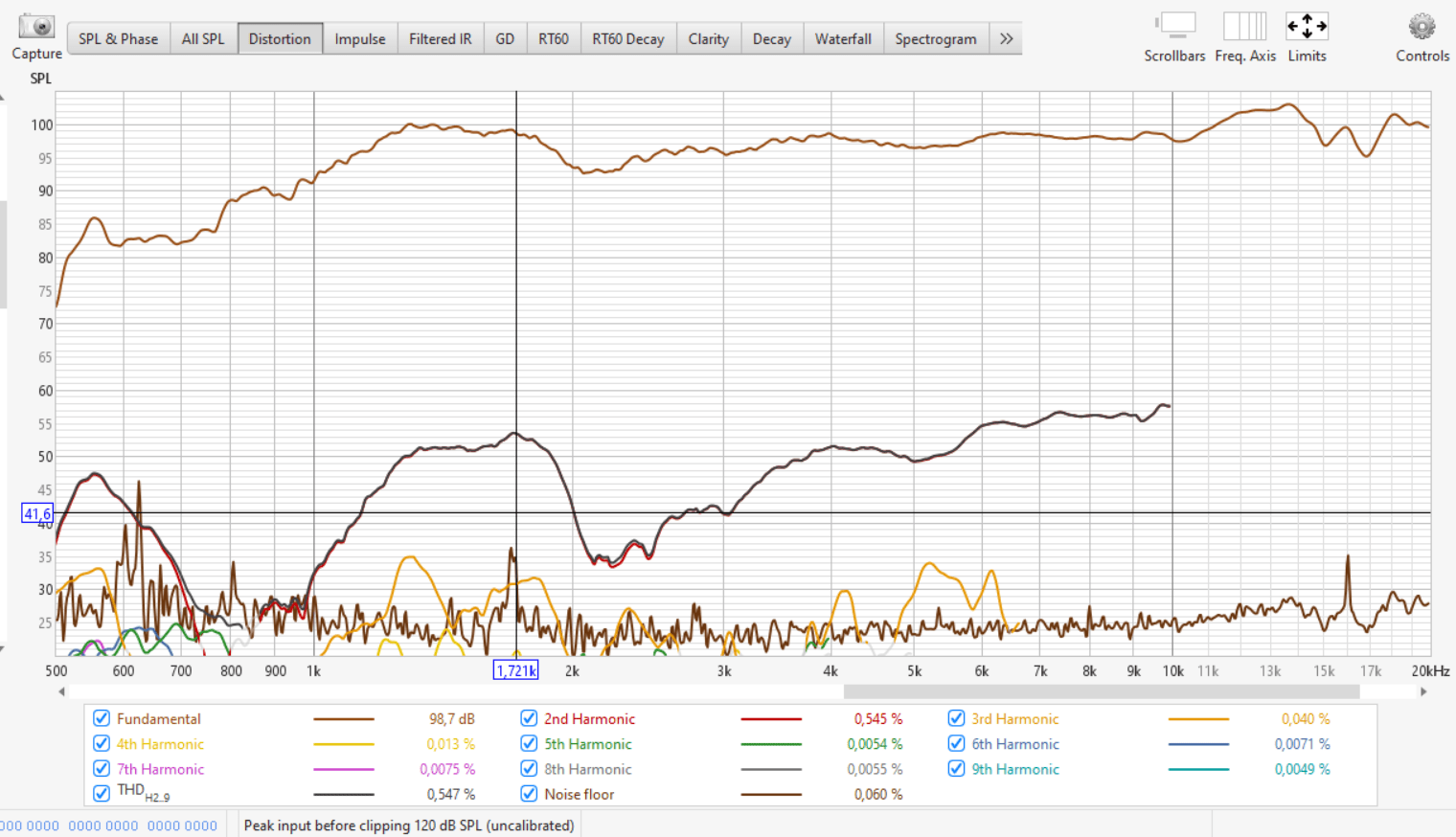

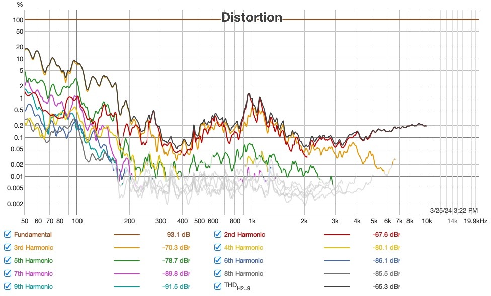

Distortion at calibrated levels:
Measurement setup: 70cm to WG mouth.
Low frequency levels are not surprising given that there is 4 pcs of 4" woofers in a too small closed box playing 🙂
Just to verify that it is not the HF part that is contributing
200 and up looks quite good ;-) but would lie to see 1k region drop to 0,1% ...

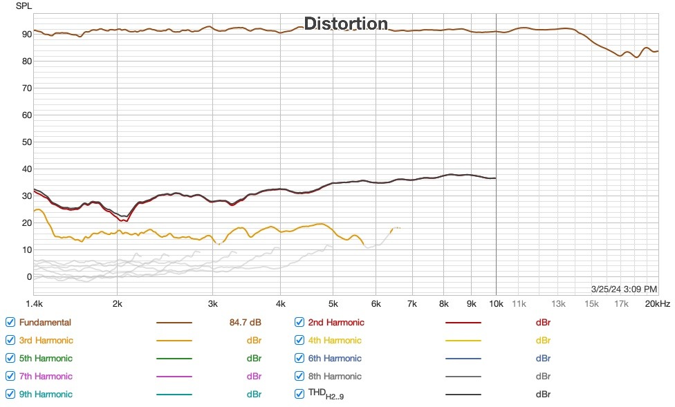

Why did you stop the HF measurement when the driver needs to play through past that point? What really matters most is likely the combined measurement but the Thd through the crossband is always interesting to see separately. I am interested to see if you are following through. Also if 90db is your max intended average, what does thd look like at +15db above that, interested to see if this system is transient accurate for that level or if a lower average is needed for accurate playback. To be clear, take separate, complete, measurements of each driver at average and peak levels.
Because when level is dropping from a XO, distortion measurement gets uncertain. The little SB driver has unfortunately this increasing distortion around 1k when level is rising. The analysis and cause for it is known. I play at 70-80 peek so no need. The system was never specified to play loud. I'm good.
"...following through"... ?
Yes follow through. In analysis of my crossover point, you were pointing out Thd that were -10db or more deep in the crossover... I thought it peculiar you did not subject yourself to the same expectations, You make excuses; "Because when level is dropping from a XO, distortion measurement gets uncertain." and hide your results from the thread. Your thd measure stops almost a half octave before the xo point and Thd is obviously starting to peak. I wonder how high thd gets on your tweeter through the crossover, and find it interesting you do no hold yourself to the same standards that you strictly implied to my crossover.

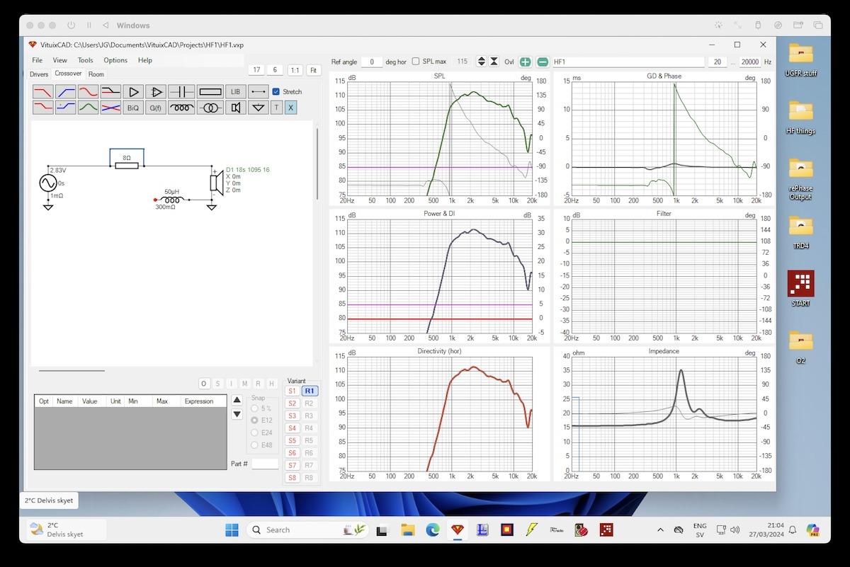

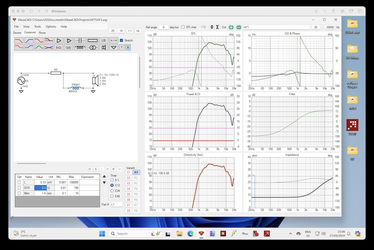

Hi, regarding HF distortion on your previous post, was that measured with 16ohm series resistor, opening post mentions it? if it is, try adding one high pass filter pole with inductor between resistor and the driver, parallel to the driver. This enables the driver to dampen itself at resonance, which should reduce that ~1kHz distortion hump. That's the fundamental resonance for NDS1095 according to datasheet, and a series resistor would reduce electrical damping, which allows the driver to resonate more, great excursion (also acoustic output of course), but the excursion distorts the whole bandwidth. Undamped resonance could likely react to external excitation as well, like sound from the woofers earphoned by the waveguide. I think electrical damping on compression driver resonance would really help with sound. You might find out the frequency response doesn't work with your plan now, but you'd be able to evaluate if it does and does the distortion matter there and so on.

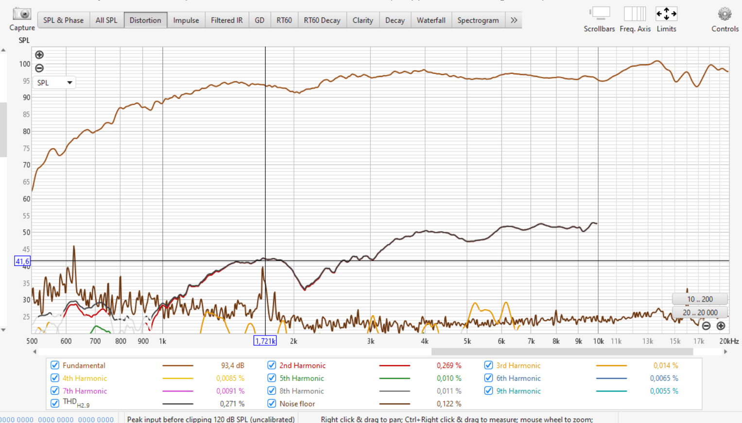

Here some quick measurements of my hf10ak driver, the other is with series capacitor and L-pad, and the other is series resistor and parallel inductor like described. I've got DSP to manipulate frequency response, but that was not used on these quick measurements so are not matched.
Was just a quick check if there was any difference, and it seems so. If you have time try it out and see if there is difference with yours.
hf10ak-with-l-pad-and-series-cap.pnghf10ak-with-series-resistor-and-parallel-inductor.png
Lowest resonance for this driver is around ~600Hz, and series capacitor and L-pad really reduce electrical damping visible as peak in frequency response as well as in distortion hump (2nd order!). At least that's my analysis with this quick test I did sometime last year, and why I think your's would reduce too. You could do a quick test without the series resistor (or cap or anything betwee namp and driver). https://faitalpro.com/en/products/HF_Drivers/product_details/index.php?id=502010110

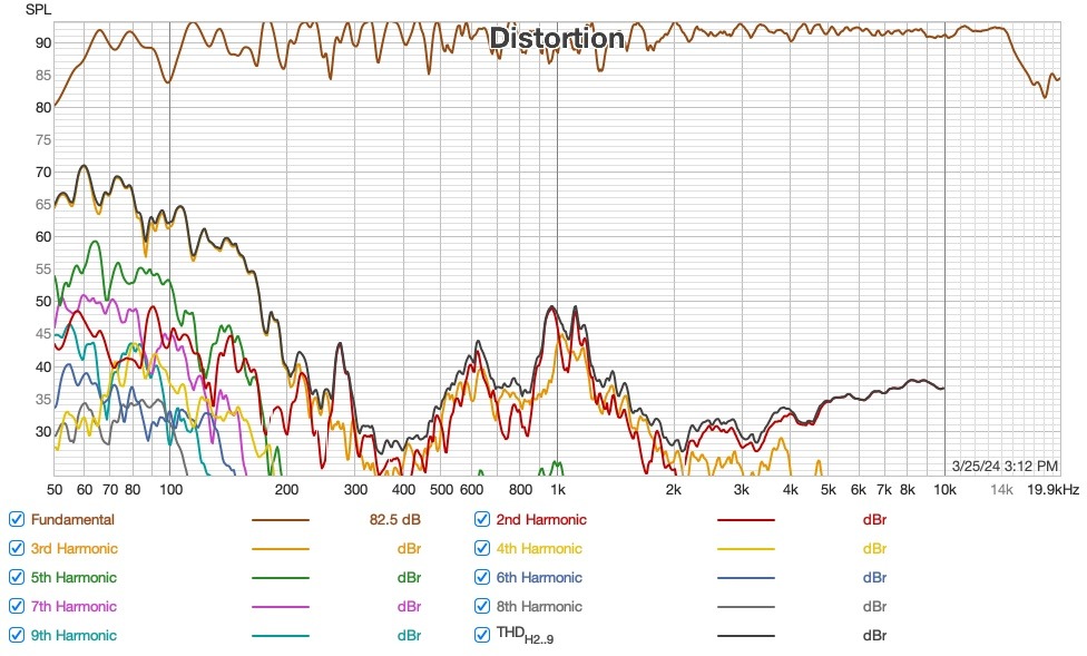

Looking at those measurements, are you certain that it is just the Sb at fault? Your tweeter measurement isn't far off from the combined thd measure. What does the 4" look like measured alone. This is all just for exercise, since you can't relate these to perception, and you probably have plenty of headroom.
You could load your data to vituixcad, impedance and frequency response, then play with simulation. You could check series impedance with the driver as well, try to minimize it around 1kHz. Adjust the R as you like, the 8ohm for example for suitable attenuation. The coil should be low ohm air core, adjust inductance so it makes plausible crossover which you can refine still with DSP. I really don't remember what mine are, need to pop up vituixcad later and check it out.
