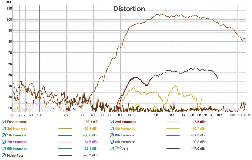

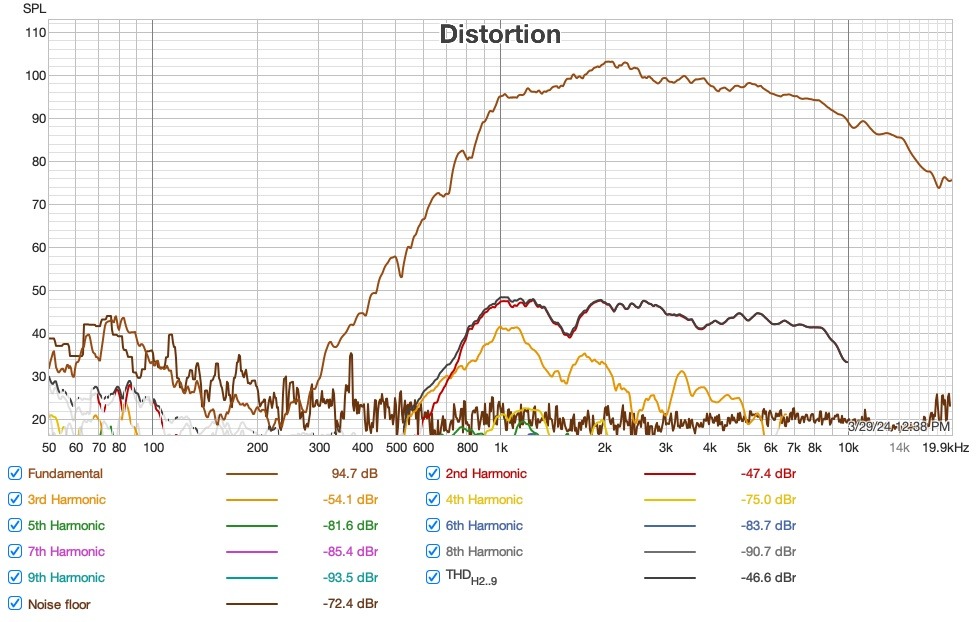

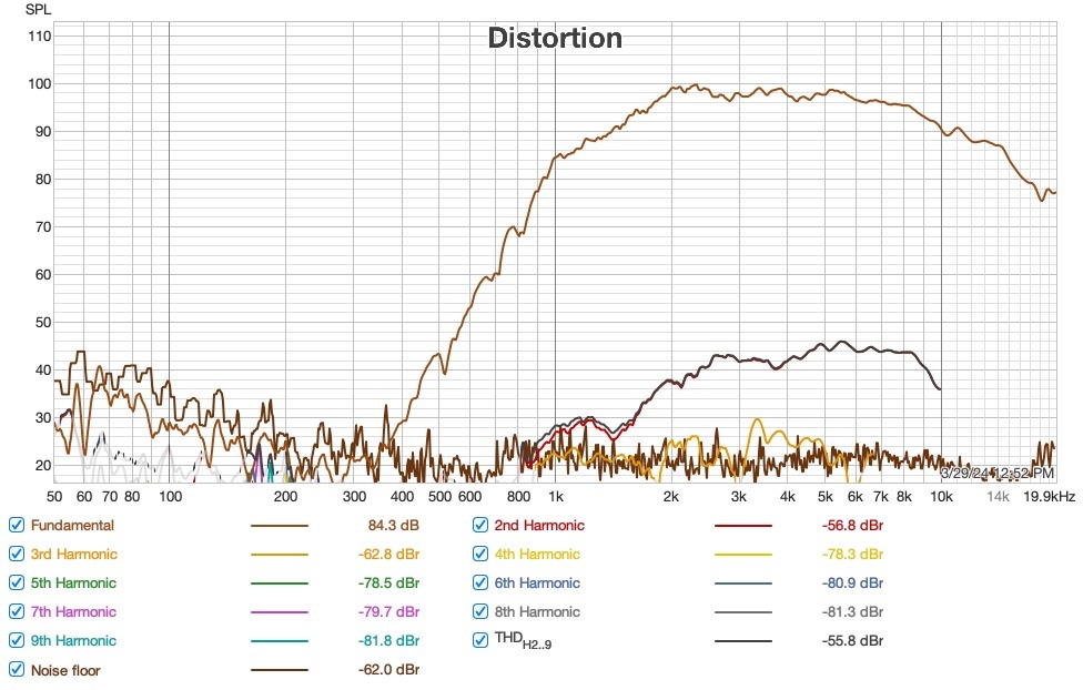

Made 3 new measurements on CD/WG; 1) no R nor L, 2) only R (R) and 3) with the above 8R/0,33mH filter.
70cm, calibrated levels. 800hz 4th HP in DSP for all 3 meas.
I had to do some FR compensation in DSP to get to the same output level at 1k - especially for the R/L filter one. I think here is where one can get fooled - its really important to compare the exact same FR and level or it can be misleading... I first got a really nice result for the R/L but then started to look at the FR and levels.. had to redo them all...
No R&L:
Only R:
R&L:
Comment on last: little lack of energy around 1,5k and more level at 5-6k... to be considered...
This is consistent with one of my guru friends that say that there should really not be any difference between using DSP and LRC filters..
I'm still unsure... but here it was not much in it... or?

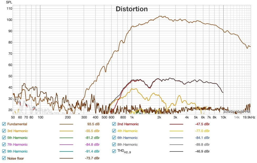

First "hooray" measurement looked like this after inserting the filter:

Please comment on this tmuikku... is the impact of a filter dependent n driver motor quality perhaps?
Hi, I don't know 🙂
On a compression driver excursion is very small, also Le is small and so on, so perhaps there is not too much difference as your results indicate, so in that sense perhaps driver motor quality is high, high enough for not much meaningful difference here. I would think it also matters how the driver and horn play together, if the horn/waveguide limits/reduces excursion it's also "damping" similarly as maintaining low series impedance to have electrical damping.
What I'm thinking with damping is that it prevents the transducer doing any extra movement at resonance, where it likes to move easily with any excitation. Any (low frequency) movement would distort the whole bandwidth of said transducer, and in this sense effective high pass filtering to reduce any unnecessary movement, especially one which maintains electrical damping, is very important in regards of distortion performance of any dynamic transducer if distortion is a concern in the first place.
Comparing the first two images, with and without R, everything seems as they should, but it's weird why on the third image with both R and L would have increased 3rd order distortion higher up and why the HF is louder, these HF stuff ought to look pretty much the same as in the only R case. Could there be some error? Regardless, what your results indicate all of this seem quite marginal in your case, and likely have no audible difference at all.
Swept distortion measurements aren't showing everything though, it might be that there is some difference in system context, if external sounds like bass hits affect the compression driver somehow (external excitation) and better electrical damping (with R and L) could make a difference. This is just theory and not sure how to test and is it audible or not and in which circumstances.
I haven't yet done similar test with equalized acoustic output, or any other extensive testing so all this is academic for now, from my part.

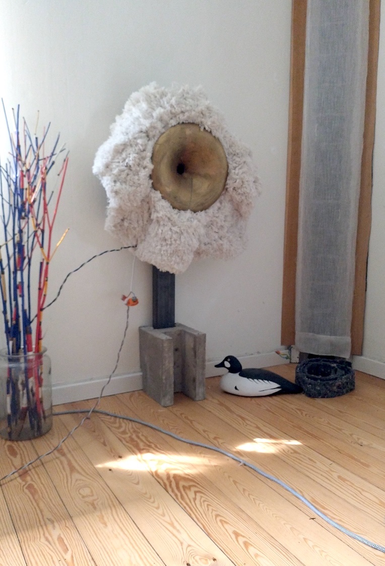

HF has been relocated to the summer-house and it is the first time I hear them placed as intended on a whole wall. It worked out really well and is a distinct improvement wrt. stage and bass capability. The 4-inchers impress and surprise ;-) despite the mushy old paper walls here... bricks would be better!
