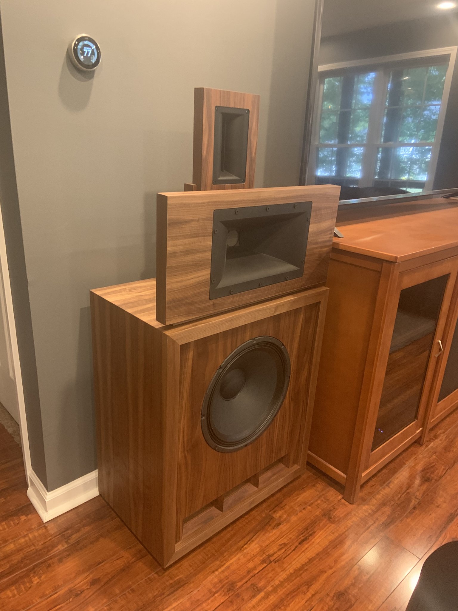

So are there any options if one doesn’t want to use DSP?
Beyond physically moving the mid and tweeter to try to compensate for the path length of the folded low frequency horn and/or filter effects on timing?
Some Tannoy use an all-pass in the filter network for time compensation as I understand it.
However, that seems to be a very small adjustment as compared to trying to time align the LaScala horns. Maybe its not even possible. I certainly don’t have the skill or knowledge to even try to create such a filter.
So then we just live with it if we don’t want to use DSP or try to physically compensate?
Your comments above indicate that you likely haven't heard the difference between time alignment/phase flattened response and what it sounds like with its stock passive crossover filters. It's not close.So then we just live with it if we don’t want to use DSP or try to physically compensate?
The corrected (DSP crossover) sound quality is extremely neutral, while the passive version has a bit of a "whang" to the sound quality, i.e., it doesn't sound neutral. But more than that, the DSP corrected version sounds more "together", the soundstage is bigger, it has more apparent bass (subjectively), better clarity and snap, and is much smoother sounding as a result of musical harmonics not leading their fundamental frequencies, etc., (i.e., the harmonics are lined with the fundamental frequencies). It also has a more subjective sound quality of "listener engagement" that you don't get with the passive crossover version--especially if you've gone to the trouble of absorbing the near field early reflections within 1-2 meters of the loudspeaker positions and at the listening position(s).
Also note that there is one more issue with trying to time-align your tweeter to your midrange by physically moving the tweeter back: you get time alignment directly on-axis, but the more off-axis you go, the more the time alignment drifts off again to what you hear with the tweeter mouth fastened to the front baffle (without DSP time alignment delays). Think about it. This is just like having a good narrow-beam loudspeaker in the middle and two (or more) not so good loudspeakers (with equally narrow beams) on either side of the good loudspeaker. You can still hear that, even if you're on-axis.
So the price you pay for not using DSP and multi-amping is great, indeed. I wouldn't go back to using passives. (YMMV.)

I have been working on my LaScalas for a while now and just recently made two big changes: I am passively bi-amping them and I have physically time-aligned the tweeters with the squawkers.
I have a good digital front end ( PSAudio PerfectWave) and with the right data it is almost at the level of my turntable. The recent high resolution transfers of the classic Blue Note recordings are very listenable and as long as I don't break out one of my original vinyl discs the convenience is mostly worth it. CDs, on the other hand or CD resolution files are not really in the same league. I have thought about something like the Dayton Audio DSP-408 but I don't want to turn my high resolution files and thousands of records into CD quality data.
Just last night I redid my search and found there is now a miniDSP 2x4 HD available that runs at 96kHz. Not the 192kHz of the best stuff but a BIG step up from 44kHz.
My inclination would be to run the bass horns with the passive crossover and the line level 1000Hz low-pass filter that I'm currently using and then use the two channels of the miniDSP for the squawkers and tweeters. I would need two more channels of amplification but I have plenty, lol!
Has anyone used the HD version and/or compared it with the standard res version? Any other thoughts?

@THD+N
I’m considering starting with a passive that has been worked out for me (besides an AA) like the Universal or a derivative like yours for the PRV.
Is there some tolerance for values of the components?
For instance, the 80 uF on the woofer for the LaScala. Parts express has a few options for paralleling 40uF caps, but the most affordable option would be an 82uF Crosscap or Audyn.
Most other values can be obtained by paralleling a 1uF.
I do have some caps on hand that would get me to within .5-1uF if I used them creatively in areas like the tweeter filter.
I figured mist of these caps are 5% or so, but I should ask what the margin might be?

Chrome... The component tolerance of 5% is more than adequate. Most of the Dayton caps rated for 5% come closer to <2% difference when measured. Audyn caps are a great value for the price/performance.
Even the Dayton air core coils are great for the price.
For shunt type caps (especially across the woofer), a non-polar electrolytic is all you need, not some giant film cap.
For the tweeter filter, 2.2uf is common, but the second tweeter cap can be anything from 6.8uF~7.5uF with very little penalty.

I assumed the 5% tolerance was adequate.
My question was more directed at whether or not substitution of an 82uF in place of the 80uF on the woofer would cause any problems.
They have an 80uF non polar electrolytic. It is rated at 100V. Would that be sufficient?

Don't get overwhelmed by choices. The Dayton or Audyn polypropylene caps are perfectly fine for just about any build. Even though they are on the cheaper end of the scale, they are great caps.
The boutique caps may give you a little extra something, but you may want to explore those options after you dialed in other things first.
Again, if you decide to go with Dayton or Audyn, the 5% ones are good. No need to pay more for 1% when the 5% are almost 1%.
82uF is close enough to 80uF for the woofer.
