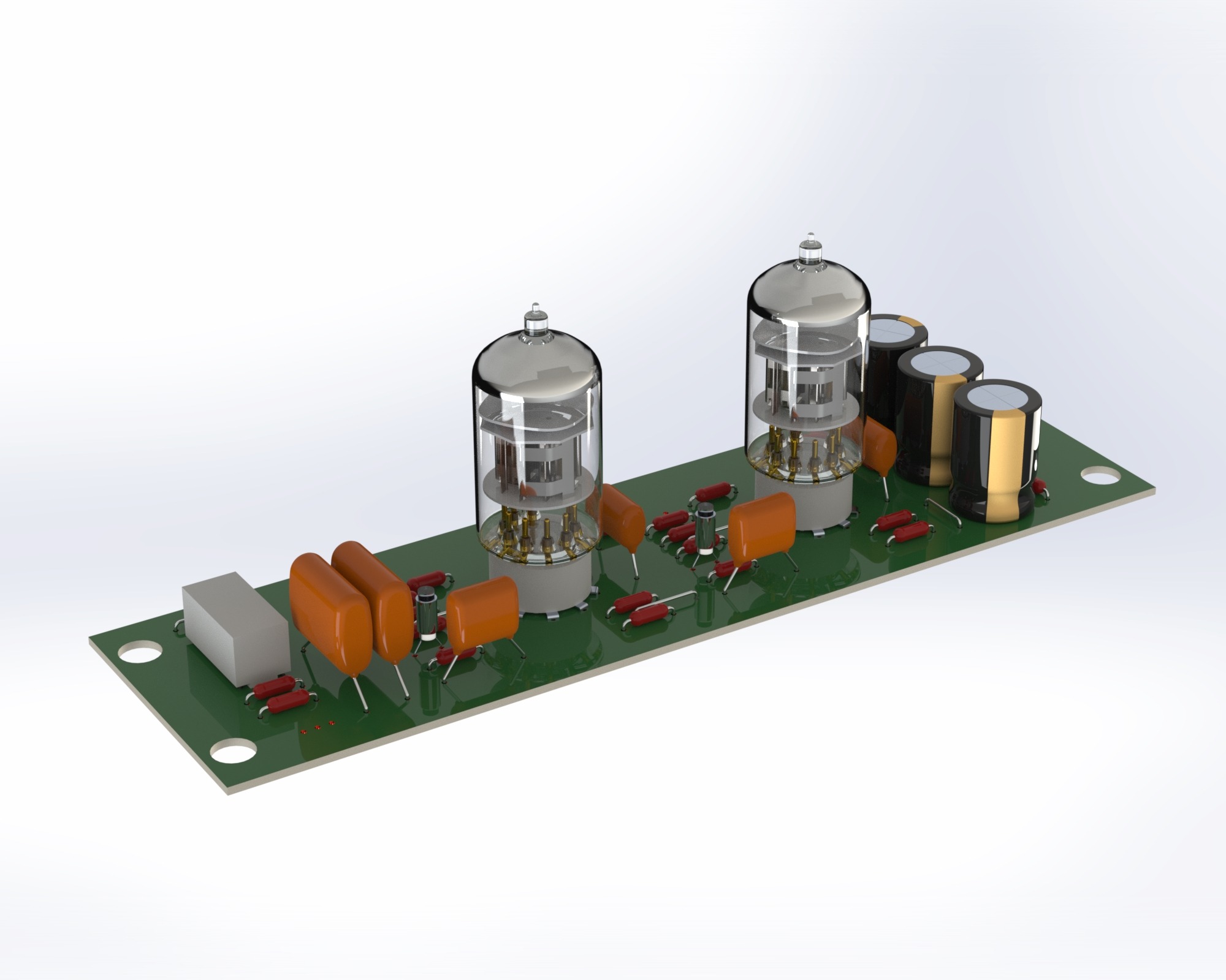

OK so 3D CAD is fun and the process is informative. I now understand why folks get teary eyed over mech quality, or lack thereof. However, it's also a really good for putting things in a box before any proper destruction has begun.

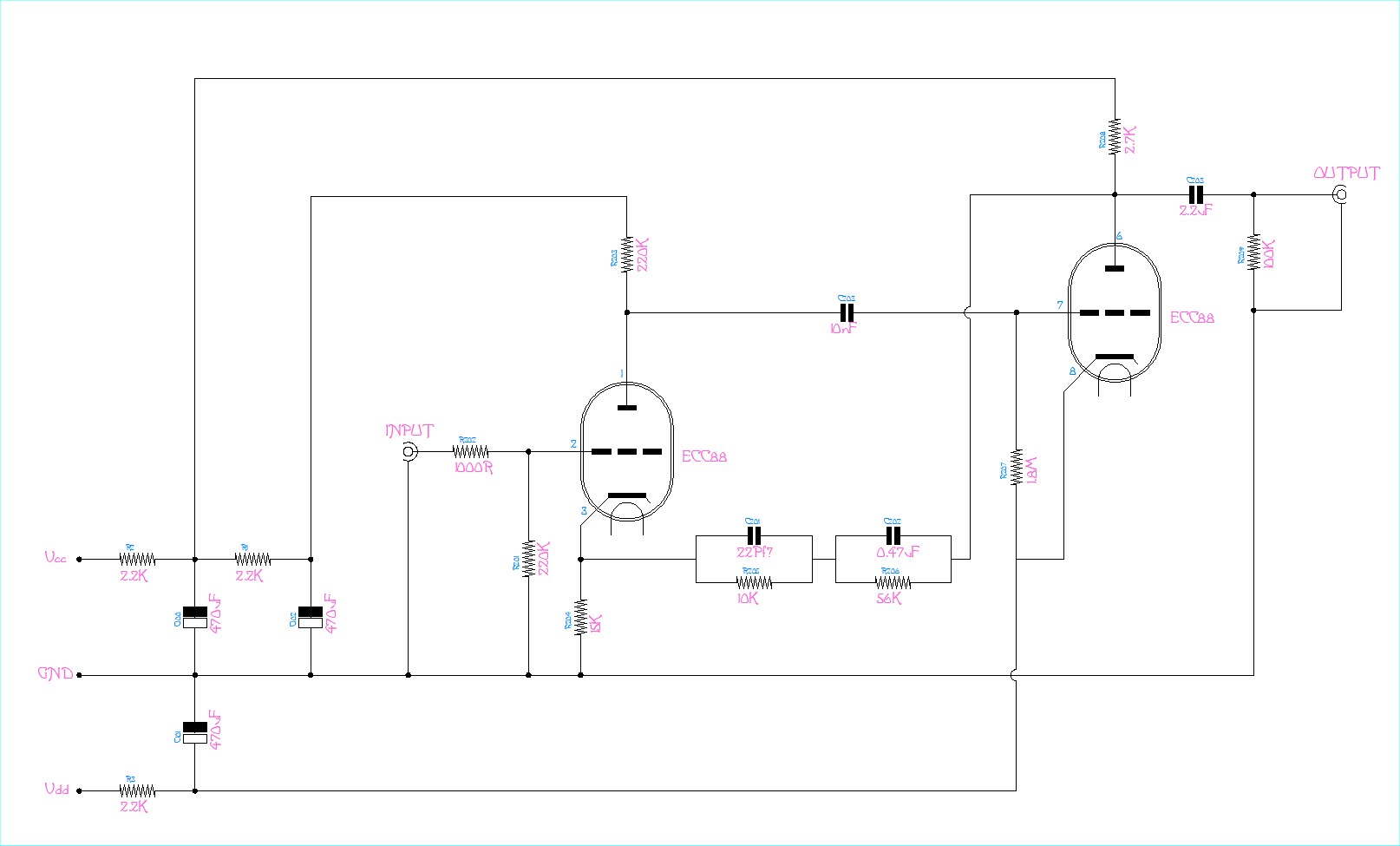

But some actual, useful, fiddling has intruded 😳🤔 and I decided to look properly at the FCD's valve output stage. It's not an X10-D well not exactly... (yes I'm well aware that the x10-d is electrically unremarkable, but its a reference - don't shoot me)
No voltage doubler, on this board at least, and a different (than the X-10D) approach to the B+ Supplies and grounding of the first valve section. Also it does have a relay grounding the output during start up but imagine that in the schematic if you need to 🙂
The PSU board needs more disassembly than I want to commit to, before I have a plan that reaches past tomorrow. I'll get there no doubt.
Next step is to measure some voltages I suppose?
Andy

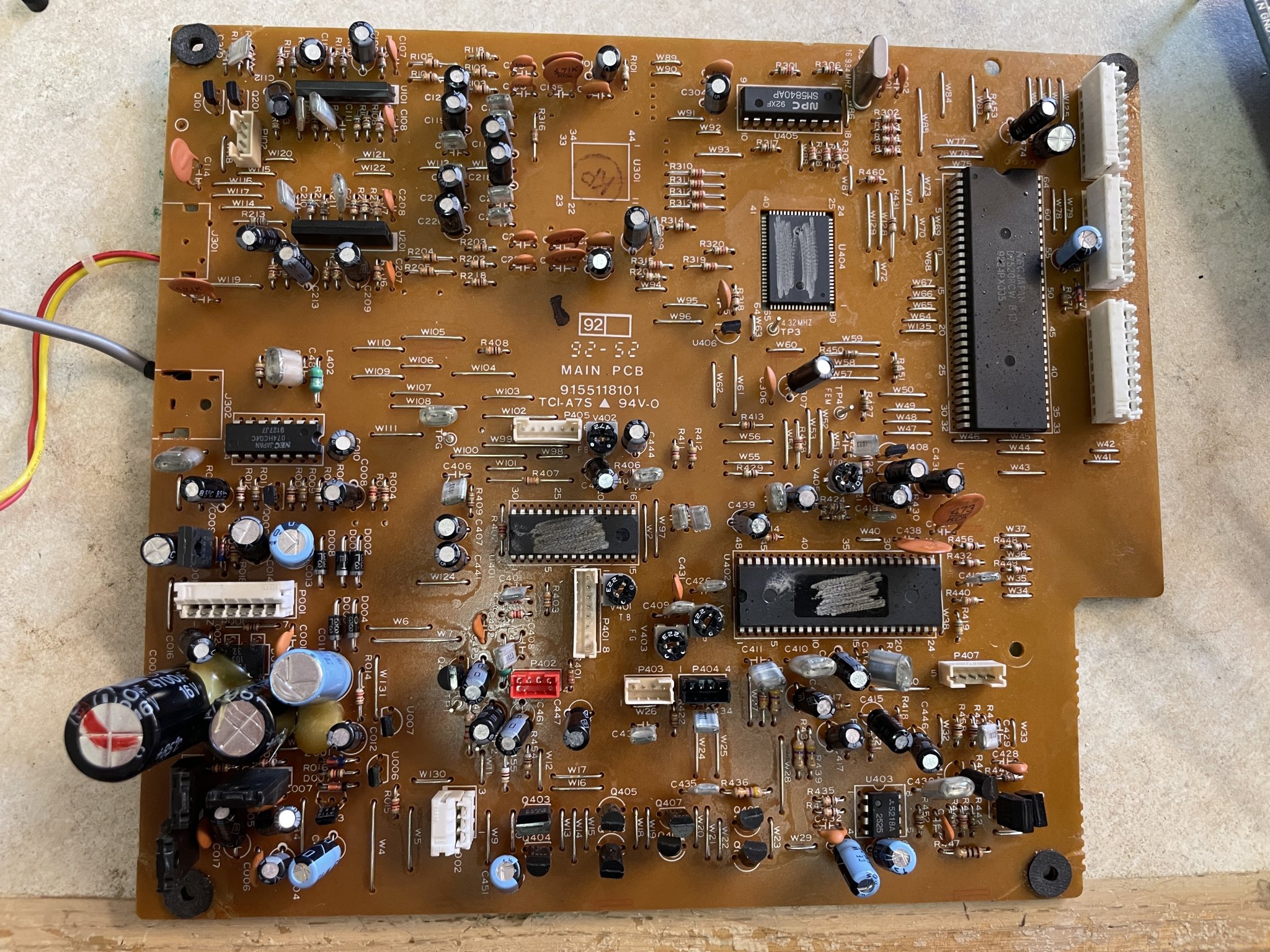

So last one for a bank holiday

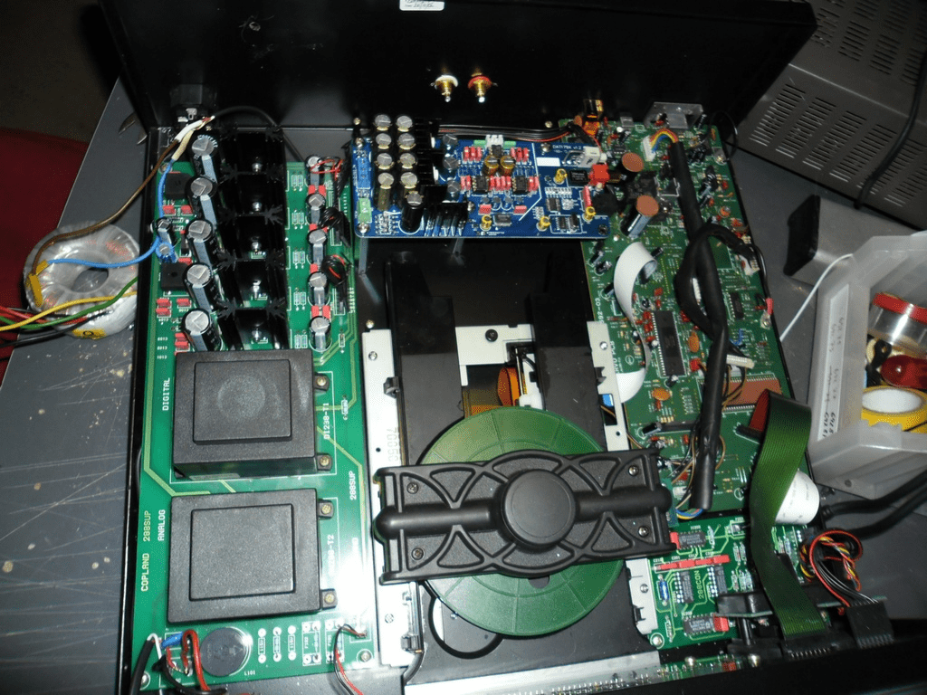

Lets 'take a dive' into the FCD main board, which I just realised (slowpoke) was easier to get to than I thought by just cutting the optical SPDIF wires. Not using them again anyway
Then a genuine LOL which I thought I'd share
See photo, yeah in todays money a £3K unit.... So Normally I have the greatest of respect for past engineers and the limitations of their time, but scrubbing out chip numbers 'so no one can tell' is the equivalent of kindergarten!
Funny - because its SO bad - automatic 'Hall of shame' for you! No matter whom you may be (and perhaps whatever you created next)
I will admit to a soft spot for M.F. as this thread attests, but 'FFS' did they employ five year olds? Was that allowed in the 90's?
Still chuckling 🙂

All I have done thus far is establish a 'childhood' crush is rather disappointing. "all fur coat and no knickers" if I'm allowed that.
  • CD board - TEAC CD3500 💩 < OK that's unfair it's not bad, just not, 'what I want'
  • Power supply - two transistor regulated for a +/-25v supply - way to low. Input the resulting circuit in TubeCAD and it politely tells you that there "must be some current to operate"
  • Buffer circuit, v1 of the X10d / standard buffer. So primordial 'meh'
So - to get the 80's references in - it's all gone a bit Steve Austin at this point.
The plan then: ("plan" ha ha)
  • Output: new buffer stage which for sentimental reasons will be based on a two tube layout and probably a 6DJ8. I contemplated doing something with the 5703 or 6112 or even a VFet (2SK79) but a 6DJ8 is hard to top.... At the moment and it fits the tube narrative
  • PSU - I'll need new transformer here (so that's gone too). Just going to be really simple and generate proper voltages, likely Maida regulation because it works and the LM317
  • CD player part (yep that's why we're here) VRDS9 might be a good donor if I can find one reasonably, but this is going to be on a whim. I like HDCD so that'd be nice to throw into the mix too
To be honest the last part is the biggest question mark. Its all solvable, but I do need to pick a victim, once I've done that the rest will drop into place.

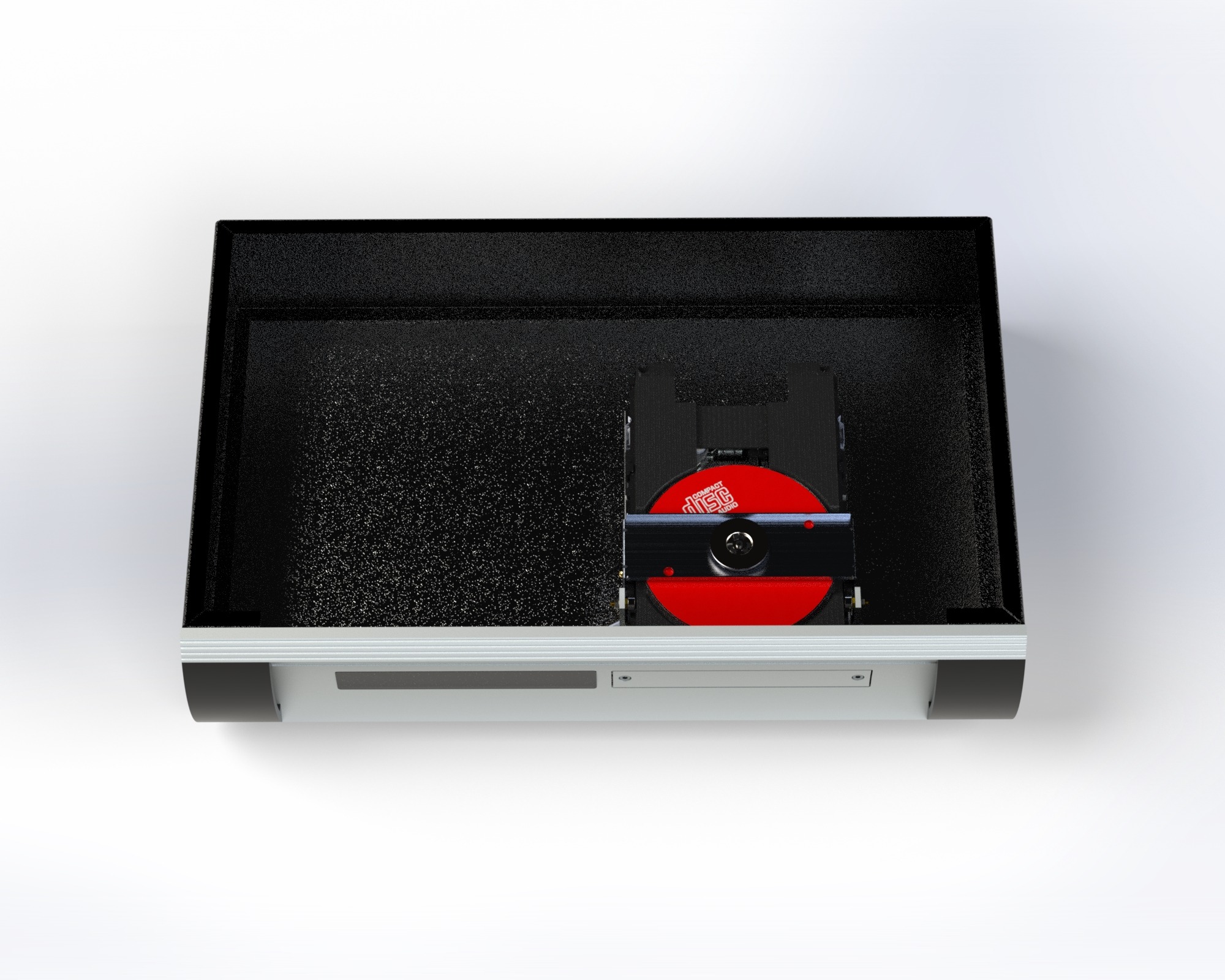

As far as chassis goes, the 3D CAD that I'm boring you with - opens the door to some very nice (?) mods that will stiffen up the base plate and arch of the KSL210 and so on... :smash: I'm some way off that, but it's on the list too

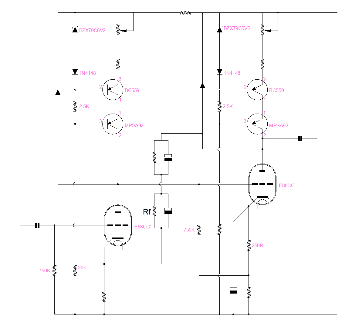

By the way: it the pcb in post #22 is the main board, I would guess the two long ICs in the top left corner is the output stage and filter (the ICs being dual opamps) .... then why does it need a buffer stage? Adding a tube buffer stage with 25V supply will for sure add a lot of distortion ... and I guess this is what is the intention .... I would see it it can just be omitted and thereby getting better performance 😉
.... sorry if I'm missing the point here 😉
@Baldin
Well if I'd seen that 12months ago there might be one more DVD player in the world 😢😢. One of the outcomes of this project so far is a much better understanding of how these loaders are put together. I doubt it translates but "Bother said Pooh" is on point, that is quite a shame.
The main board you mention is in-fact that, but its not a particularly good one. I keep saying that, but I'm starting to understand why it was chosen as a base.
The point of a buffer is sort of derived from the argument against a passive pre-amp in terms of giving the output op-amps a vanishingly low impedence to work into. But its in the same category as passive I-V stages, silver mains cables. NOS DACs, and all those "fairytales".
Probably its adding a bit of 2nd harmonic to warm up the sound, empirically (AKA no science) I have another player with outputs prior and pre buffer, I tend to prefer buffer, but that's x-10d based at +/-30v which is still low.
There is one buffer design that does make sense: SY's heretical unity gain stage. Deleting what's usually a large electrolytic (bipolar?) cap from the output makes sense. So obviously that's not what I've decided to do 🤣 see attachment - it's absolutely a work in progress and 175v B+
