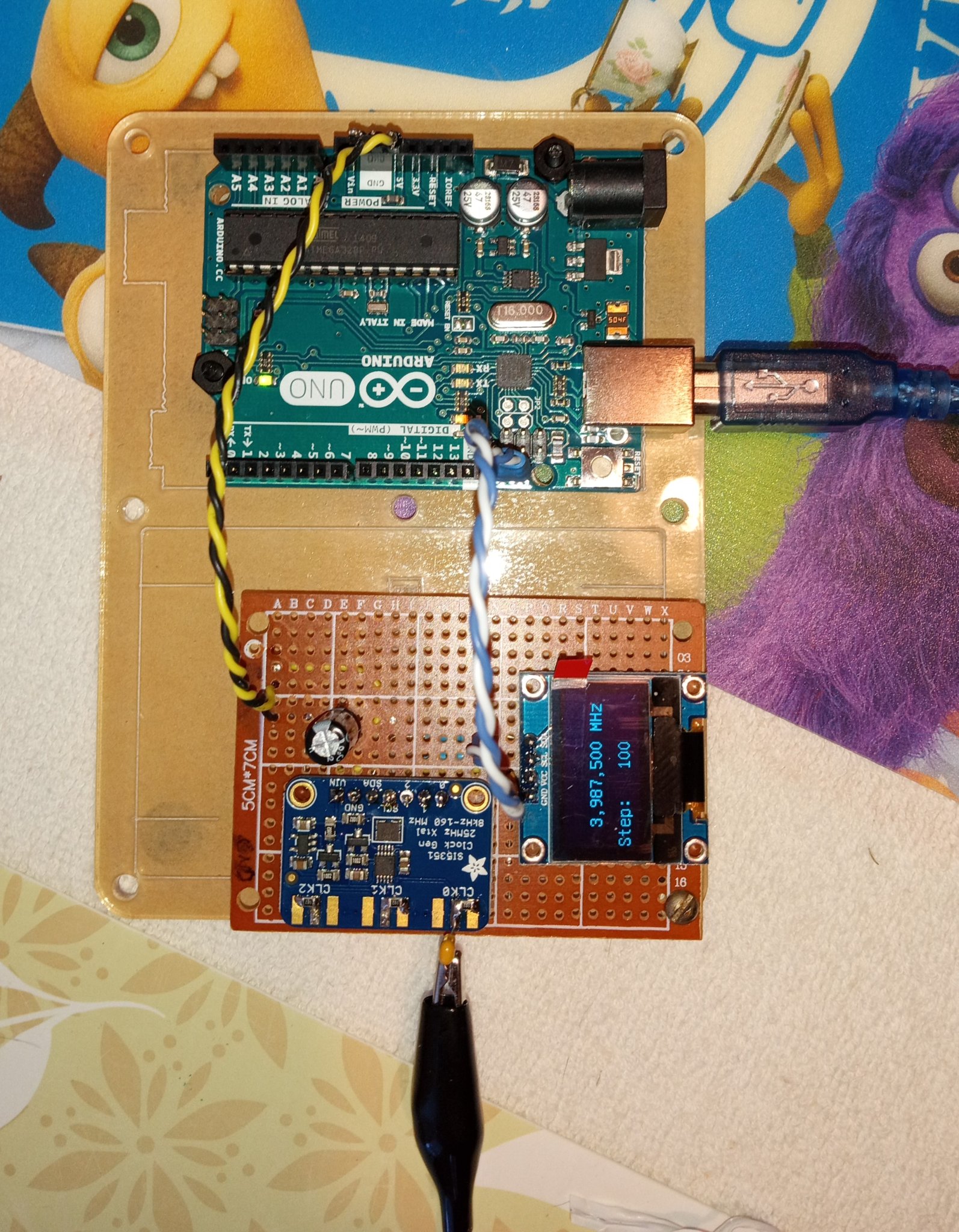

Over the weekend I put together a test jig to tinker with the Si5351 frequency synthesizer chip, or the Arduino, or maybe both - I've had the Arduino for six or seven years and never used it except to make the LED flash.
The QRP Labs Si5351 based VFO, and the DDS VFO used in the SSB transceiver, are well developed products at reasonable prices, so I don't anticipate, or even plan on trying, to come up with anything that would be a viable replacement for either.
Anyway, the clock 0 output seems to work although I have not hooked up an encoder yet. The 128 x 64 OLED display is ridiculously small (slightly less than an inch), but surprisingly easier to read than I would have anticipated. Second pic is received signal strength across the kitchen table on the broadcast receiver, using an ordinary test clip as an antenna for the Si5351, and the outdoor fifty foot wire antenna for the BC rcvr .

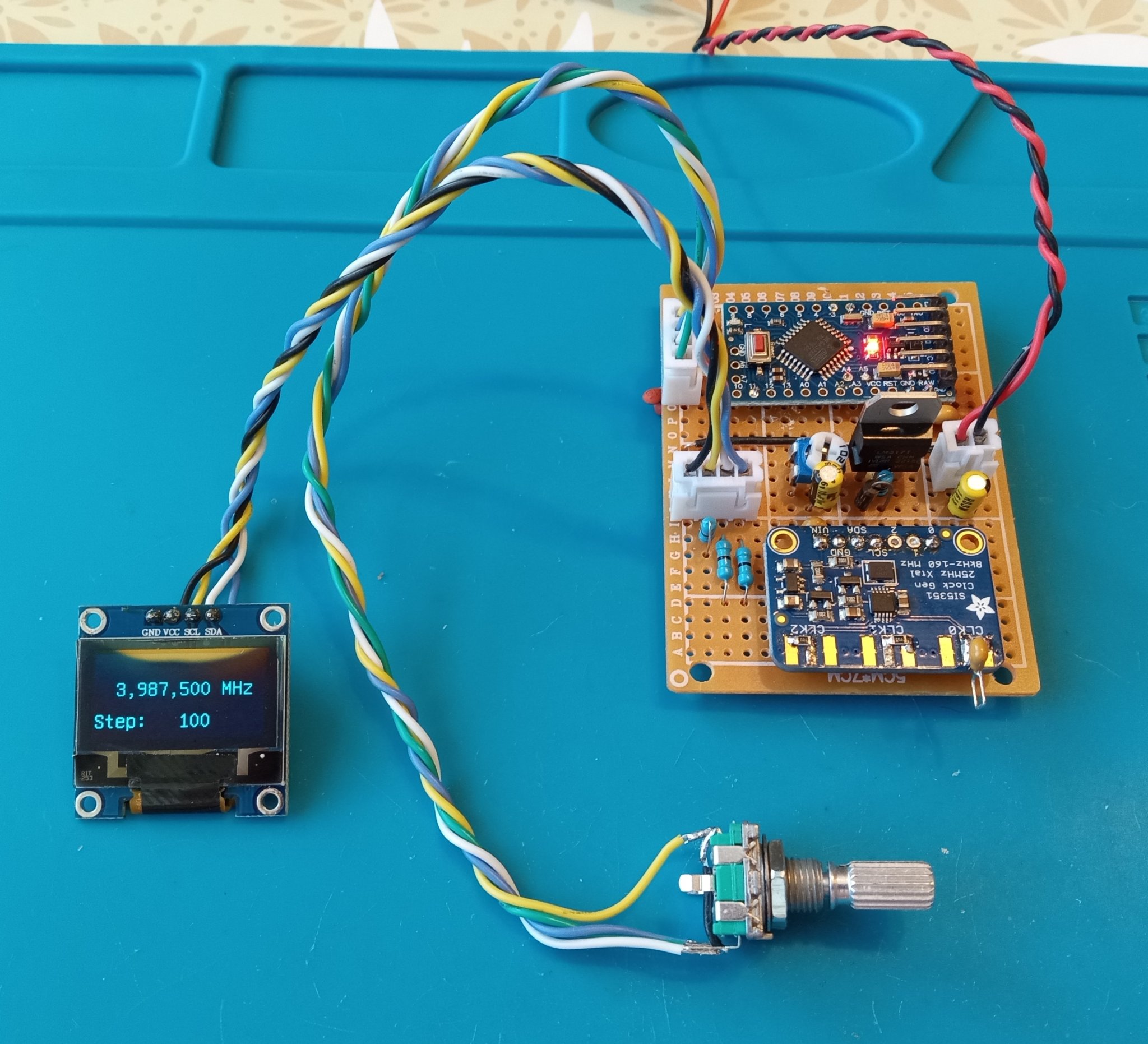

Revision 2 with a Pro Mini in place of the Uno, but otherwise completely unremarkable. I damaged the OLED display with my hot air gun removing it from the first PCB, and I thought that it would for sure be kaput, but the parts of the display I am using still seem to work fine.

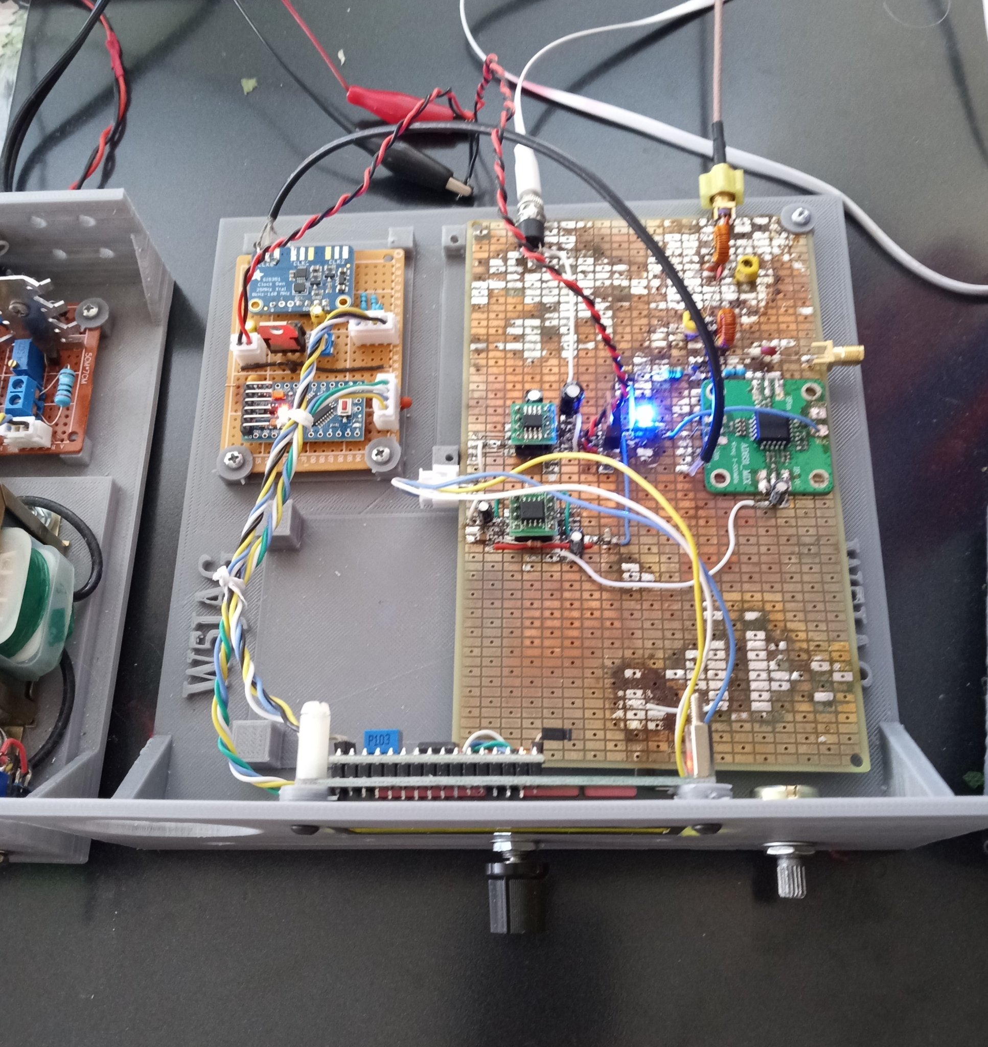

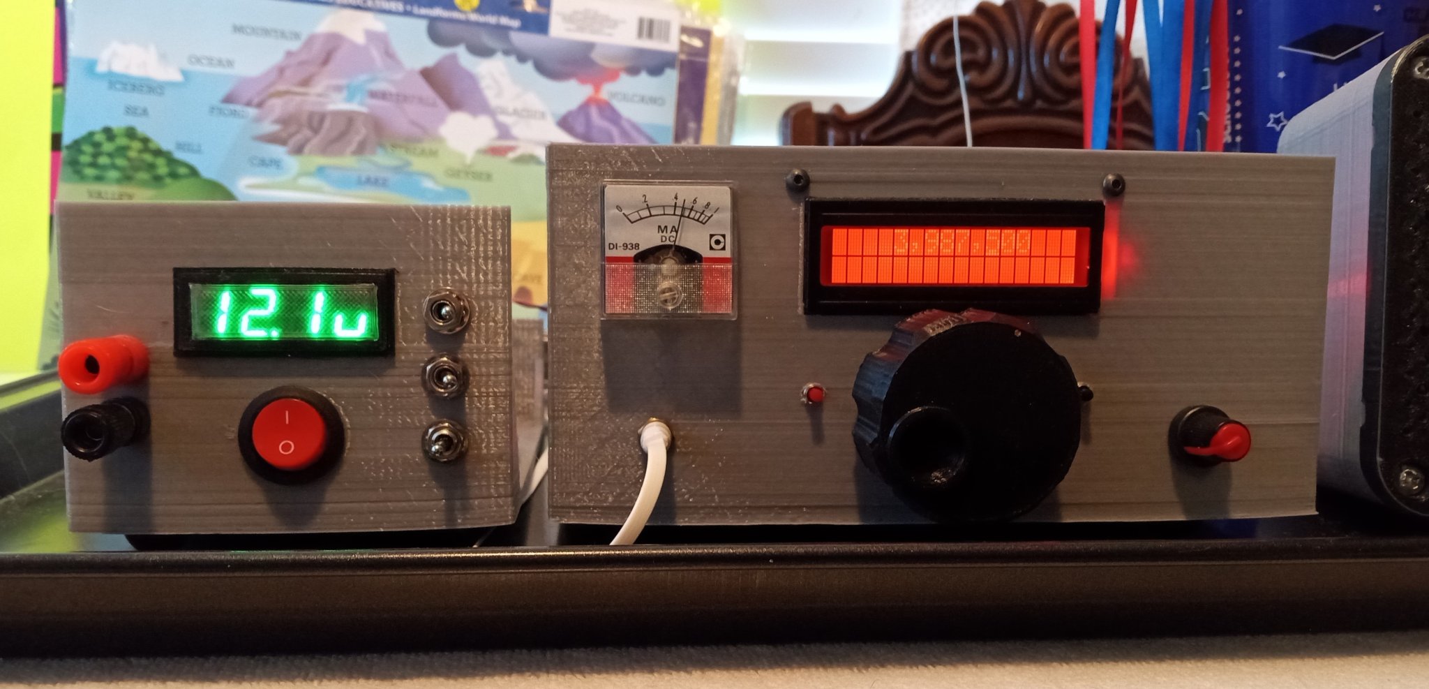

The SA602 product detector board / receiver was working okay, but here is revision 2 of the direct conversion (“DC” for the non hams) receiver; this variant using the AD831 mixer chip as the product detector. I thought this chip was interesting back when I was working on the SSB transceiver, but it wasn’t suitable for that project and I haven’t had a chance to use it since then, hence the use here.
The goals for this receiver are modest - I want something to have here at the lake house for comfortable loudspeaker listening to the local four state (AR, KS, MO, and OK) area 75 meter SSB nets, and CW on the low end of 80 later in the evenings. It is a kitchen table receiver, so comfortable listening means being able to hear it anywhere in the top floor of the house. For an antenna, it gets to use the same end fed wire the broadcast receiver uses.

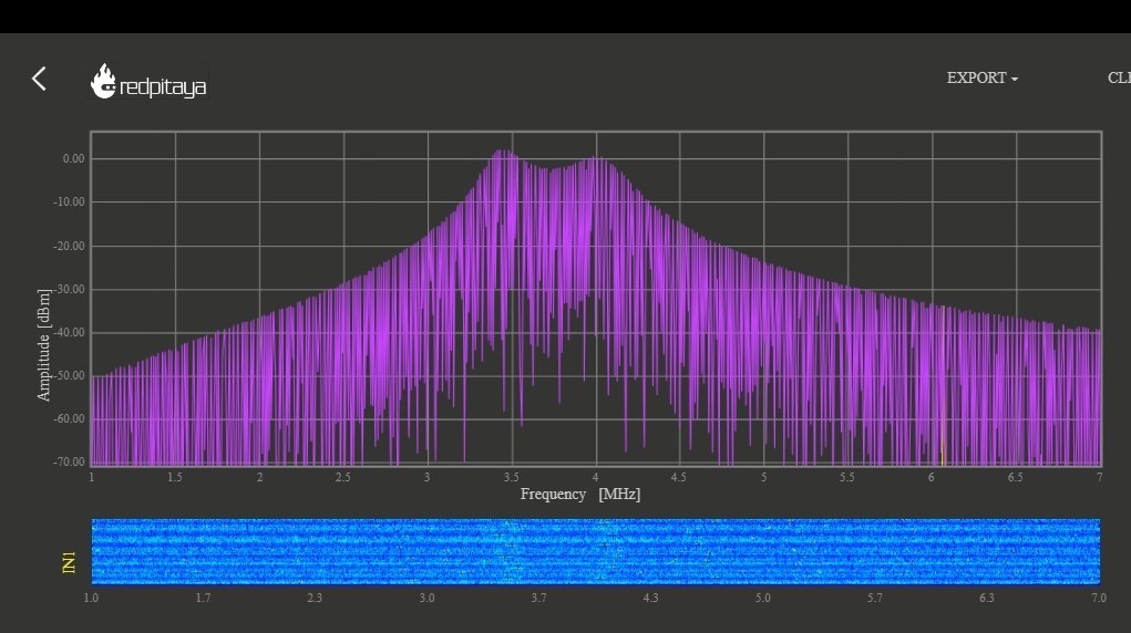

The front end is the ordinary double tuned, top coupled, bandpass filter. This one is pretty badly over coupled at present, as seen by the double peaks on the Red Pitaya FFT. I actually haven’t tuned it at all - the FFT is the "as wound" bandpass response; eventually I’ll get around to optimizing it, but it’s a low priority right now.
The AD831 evaluation board has had the 10 nF ceramic output cap removed and a 2.2 uF electrolytic substituted to make it more suitable as a product detector, but is otherwise unchanged. It is set for 10 dB conversion gain.
In between the filter and the AD831 is a Mini Circuits MAR-6+ MMIC as an RF amp which should be at least 22 dB gain, making the total RF gain 32 dB.
At present the AF portion is just a 741 op amp (30 dB) and an LM-386 (46 dB) making the overall gain 108 dB end to end. The two IC’s are of the 10 for $1 USD variety from AliExpress that, surprisingly, seem to work exactly like they are supposed to work. They are in sockets so they can be easily changed to better parts if this version turns out to be a keeper.
Everything runs off the same 10 volts the AD831 requires. I swapped out that insanely small OLED display for a 1602 LCD that is driven by one of the generic I2C convertor boards, but when get to the point that I need to print a dedicated chassis, I might go back to the OLED.
It is built on the first SMD board I used, that is really rough looking and missing a lot of pads, but on the good side the AD831 board covers up the worst looking part, and there is a lot of available room left for improvements. There is room on the top part of the board for more bandpass filters and an on board Raduino VFO, and on the bottom side there is enough room to make it into a simple superhet when I come to my senses and get tired of DC.
Next up is narrowing the audio channel bandwidth to a communications width, and then adding some sort of audio leveling so the guys on the other side of the state are more or less the same audio level as the guys in the immediate local area.
Other than the unrestricted audio bandwidth and unleveled volume from the output, it doesn’t work half bad. It is plenty sensitive for its purpose and gets plenty loud. It does not suffer from any of the usual DC drawbacks - there are no microphonics, no unwanted AM detection, no BCB or FM breakthrough, no hash from the Arduino, and no hum even when using and sitting right beside my homebrew AC power supply.
I just discovered, today actually, that Experimental Methods in RF Design for Radio Amateurs, has an entire chapter devoted to DC receivers, so I suppose I should probably read it. I’m sure I'll learn it’s a terrible idea to have that RF amp ahead of the product detector, and it might be a terrible idea to use the AD831 instead of a DBM, but the combination of the two seems to be satisfactory for now. Better than the SA602 I think, but the peculiar voltage requirement and high current draw of the AD831 are significant drawbacks.​

RF amp before the mixer makes it more prone to overload from local stations, so in a rural region the RF stage might be OK. DC receivers were "returning publications" so at work I had to design many. LO radiation to the antenna is a nuisance, so the best mixer for DC requires little LO power but nevertheless can handle strong signals. This might be interesting and applicable: https://vdocuments.mx/mixer-musings-and-the-kiss-mixer-mikrocontrollernet.html?page=1
The LO power at the AD831 is -10 dBm. If I am reading the data sheet correctly, the RF to LO isolation should be better than 80 dB, and the MMIC would block what little gets out.
I left an SMA connector at the filter output so I can tune it. I'll check the LO level at the RF port then.
As far as I can tell, these eBay evaluation boards are figure 10 on the AD831 data sheet.
Win W5JAG
The 80 dB isolation has to be related to the lowest signal that has to be received, and then 80 dB isn't much. So an analog switch as described by Chris Trask, with RF amp to improve isolation, might be a better solution and it certainly will use less power.
