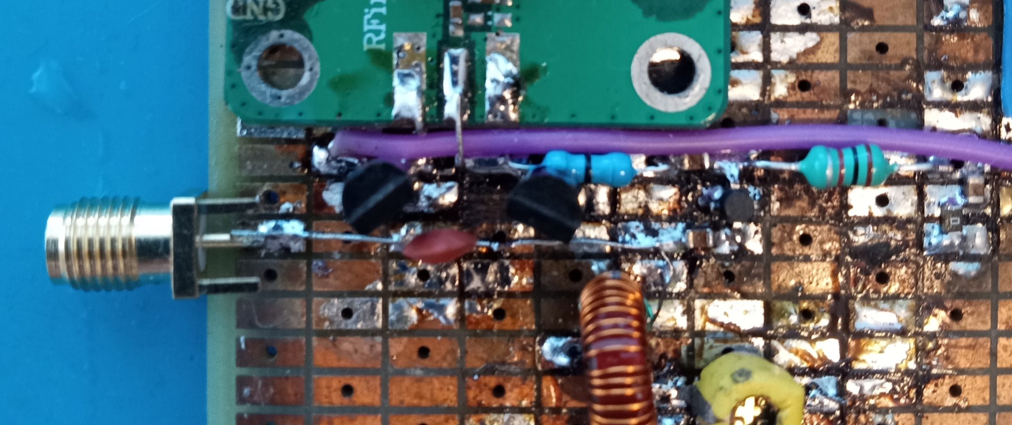

As can be inferred from the very small space between the bandpass filter and the mixer board, I did not anticipate installing an RF amp, but the NF on that AD831 is high, and after the fact I thought that if I wanted to use it above 7 MHz or so, I would need one. The MAR-6+ (barely) fits, and where it is placed, it will work with any filters still to be installed, plus the aux input.
Today, I added in a pair of the same may or may not be PIN diodes in an attenuator similar to that used in the broadcast receiver, so if overload becomes an issue, that should handle it. The board is in really poor shape in this area, but there was enough room left to squeeze them in. The AD831 board covers the worst part of it and is why it is placed in that spot. If I had thought more about project creep before I started, I might have done it different.
In addition to the attenuator, I added a 3 KHz low pass filter to narrow the audio channel, and generally cleaned things up around the audio strip, cut way back on the flying leads / sky wires, etc.
It works pretty well. It still needs something to level the audio peaks. It doesn't sound like it needs a whole lot - 20 dB gain variation might do it.
