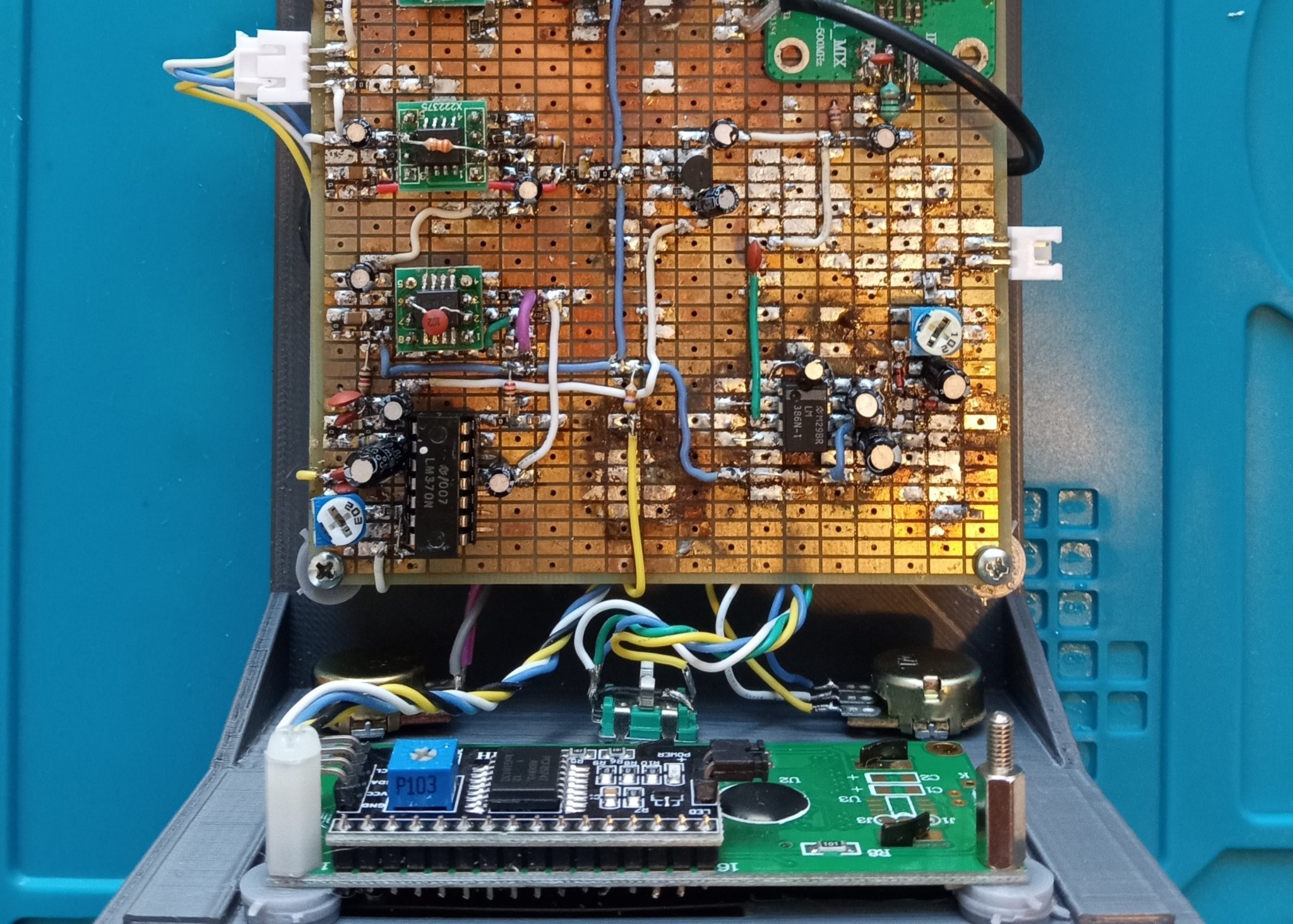

When I left town before Christmas, I totally forgot to take my loop antenna / base to try to rig it to pick up that VLF station in Sweden, so instead I spent my soldering time on an audio AGC system built around an LM370 subsystem IC. This took a good chunk of solder time because the data sheet circuit oscillated vigorously and was really tedious and time consuming to make stable. I wound up with the circuit fairly close to, but not quite identical to the AGC circuit in Linear Application Note 51 which is required reading for use of this device. It looks like heck, because I did not budget board room for all the extra components I wound up needing to stabilize the thing.
Anyway, it actually works well - I have a working, reasonably wide range audio AGC system for a DC receiver. I took advantage of the extra control input on the LM370 to put all of the audio gain, less the LM386, into the AGC loop. Since the LM370 provides a lot of extra gain, I turned the '386 back down to 26 dB to quiet it down.
For the last week, I've had the AGC threshold set to run at max gain from the LM370, but this morning I turned it down to about what I lost by turning the LM386 down, plus 6 dB or so. The overall end to end gain is about 82 dB AF gain, and 32 dB RF gain. This seems to be completely adequate. Right now I have the 50 foot end fed wire connected to the auxillary input and the receiver is happily listening to FT8 on 10 meters. The receiver seems to have more than enough gain for comfortable loudspeaker listening on any band. In fact the rcvr is on the kitchen table right now, and I'm listening to it in front of the TV in the living room area while I type this.

Hooked up the RF attenuator to verify that it was in working order. I haven't yet measured the attenuation, it sounds like at least 10 dB with the present 5K control pot and 3K3 current limiting resistor. It can be configured for more attenuation, I think, but I doubt that will be necessary. The HP MMIC RF amp is sufficiently quiet - even at maximum RF attenuation, hooking up the random wire antenna to the auxiliary input clearly increases the background noise in the receiver at 29 MHz. The overall end to end gain seems to be about right.

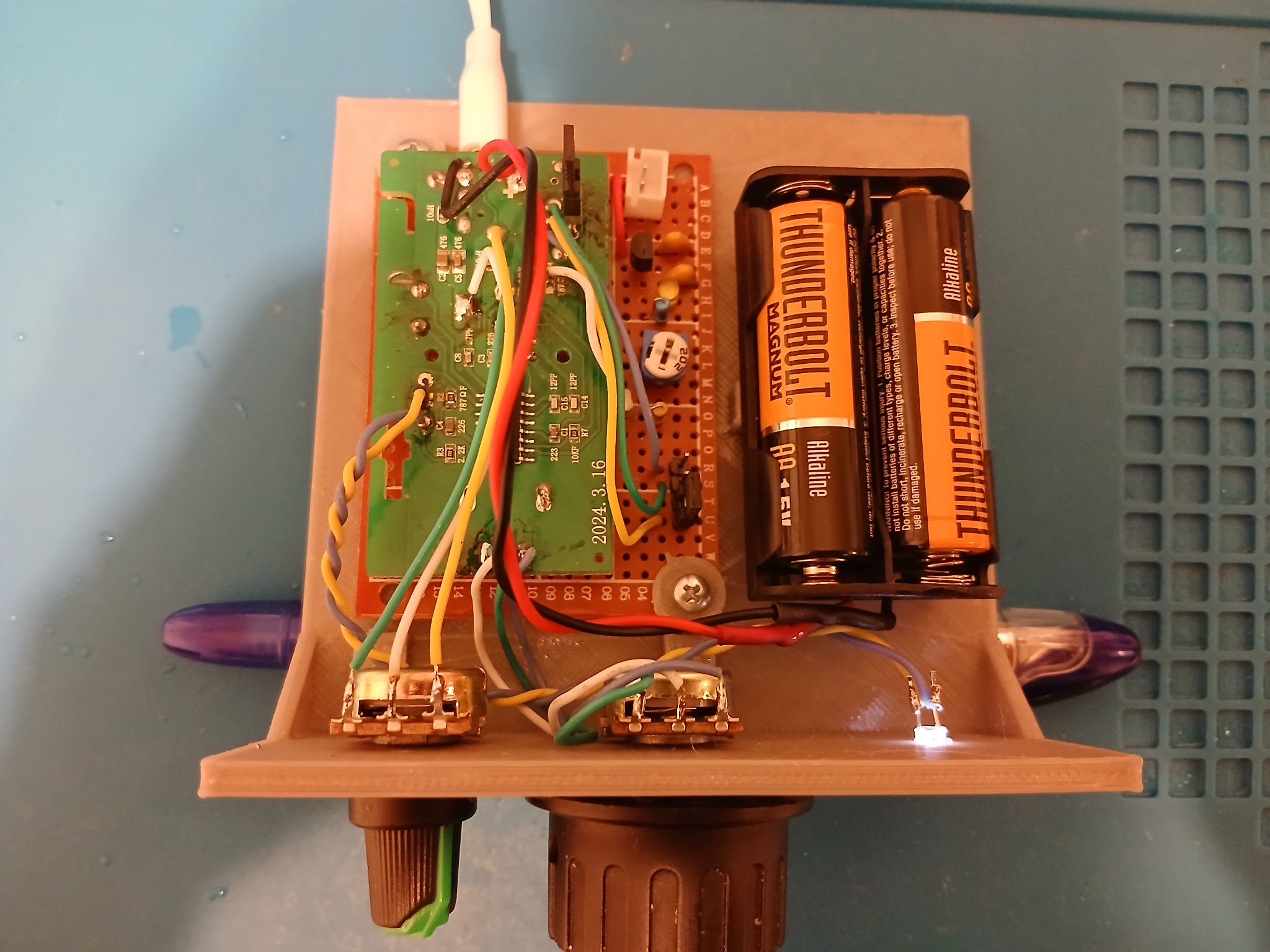

I had an XH connector for the RF attenuator pot but managed to rip it clean off the board. I didn't feel like replacing it right away. I made a new temporary breadboard to replace the broadcast receiver reject I had been using. The VFO is under the main PCB so the ground plane can (sort of) shield the receiver from the VFO.

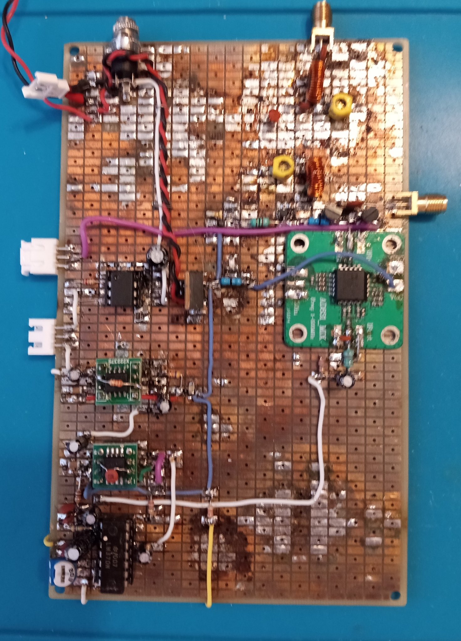

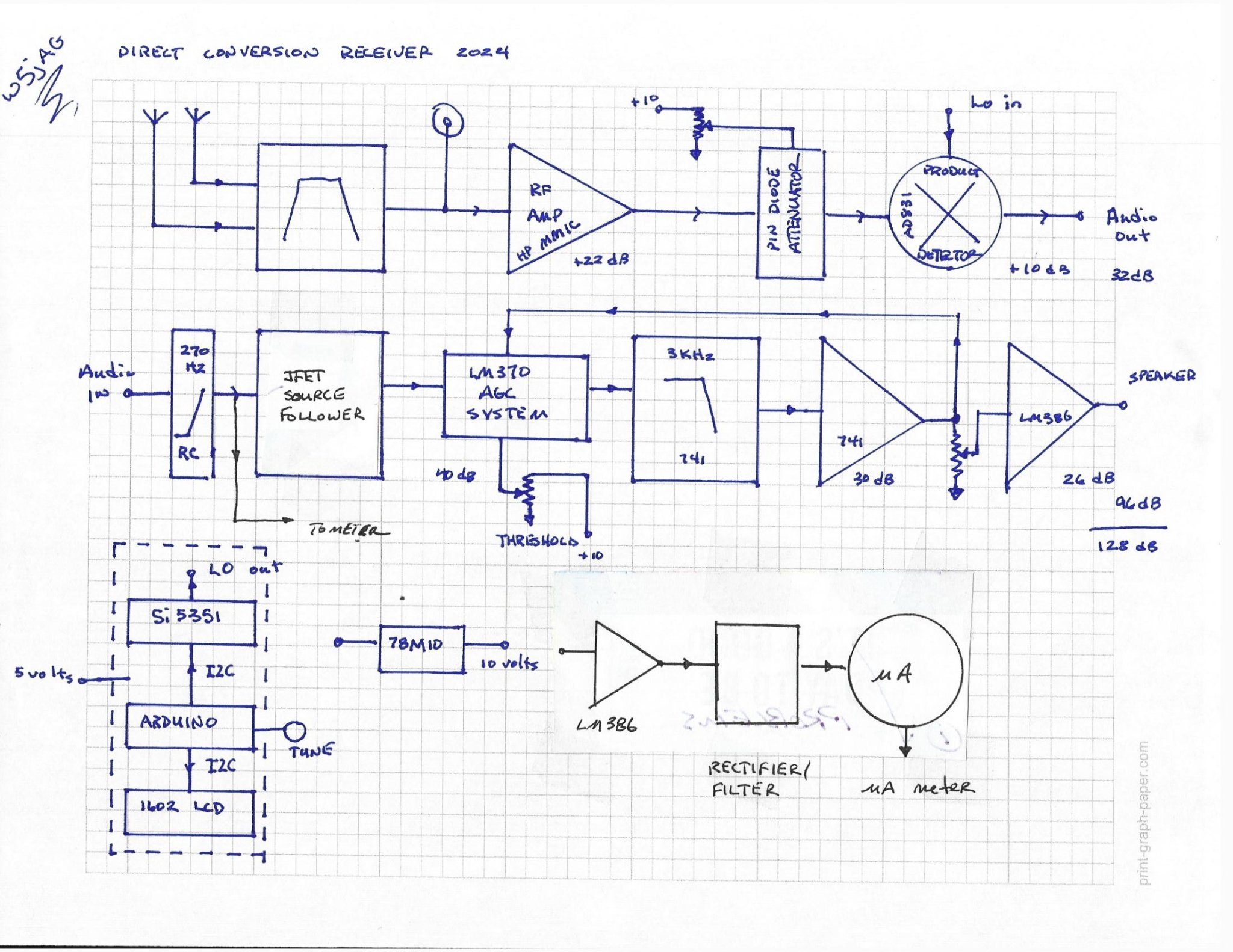

I added metering capability, but not without some wasted time and difficulty.
I went about it in what seems like the usual way - JFET source follower, followed by an amplifier, then a rectifier and filter, and a microamp meter. I used a leaded MPF102 JFET as the source follower, a 2N3904 amp, and 1N4148 diodes in the half wave rectifier. The meter is a cheap edgewise CB radio type, probably 50 uA movement. I connected it to the output of the product detector, which is at the +32 dB gain point in the radio. With disappointing results. As in, no results whatsoever. Nothing budged the meter.
To see if it worked at all, I connected it to the top of the volume control, which is at the +100 dB+ gain point in the radio, and simple background noise pinned the meter. I had to change the meter sensitivity pot to 500K to be able to adjust the meter sensitivity to less than full scale.
This gave me the opportunity to see how well the AGC works. When the meter is adjusted for zero on the background noise, only the very strongest signals would provide any positive meter deflection, and then only three or four needle widths, because of the strong AGC action. The better method was to adjust the meter for half scale on background noise. A strong signal would still only deflect the needle a few widths above mid scale, but when the station stops transmitting, the gain reduction (and signal strength) is readily apparent by how far the meter deflects below mid scale, before the AGC recovers and brings the receiver back to maximum gain. The AGC is pretty effective - it appears to perform just as the data sheet and application notes suggest. This was interesting, but not really what I wanted.
I decided I would reconfigure that first LM741 op amp that I was using as a 3 KHz filter, into a gain stage, and use that to drive the meter circuit. After using it a bit, I didn’t care much for that filter in that place - I felt it didn’t add much to either the AGC action or selectivity, and whatever it did add was outweighed by a propensity to ring at the high volume levels I sometimes need. That worked, but after some more thought I had an epiphany that this was taking a lot more effort, and using more parts than I needed, for what should be a simple task. The epiphany was that what I really needed was a separate audio strip dedicated just to driving the meter, and - drum roll here - since an LM386 can have its gain set anywhere between 26 dB and 73 dB ( if you don’t care how it sounds at the high gain end ), and since this would only be driving a meter, who cares how it sounds, one LM386 should easily do the job.
And it can. I connected the high gain AGC audio strip to the product detector through the source follower so it would be isolated from any shenanigans going on in the meter strip, and made up a minimum circuit using an LM386N-1 set to 46 dB gain, and connected that direct to the output of the product detector, and - it worked. I reduced the meter sensitivity pot to 2K to get a better range of adjustment in my particular setup. I didn’t even use an “expensive” LM386 - the part used here is one of the 10 / $1.00 USD types from AliExpress - undoubtedly some type of reject, counterfeit, or some other dubious origin, although all of them seem to work just as you would expect.
I think diodes with a lower junction voltage would give a better response on weak signals, so I will probably tinker some with that. That could lead to perhaps making the gain of the LM386 variable to adjust meter sensitivity in place of the pot at the output of the rectifier block. A smaller output cap might be okay, or even better.​

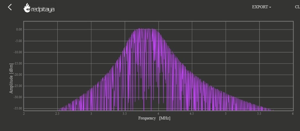

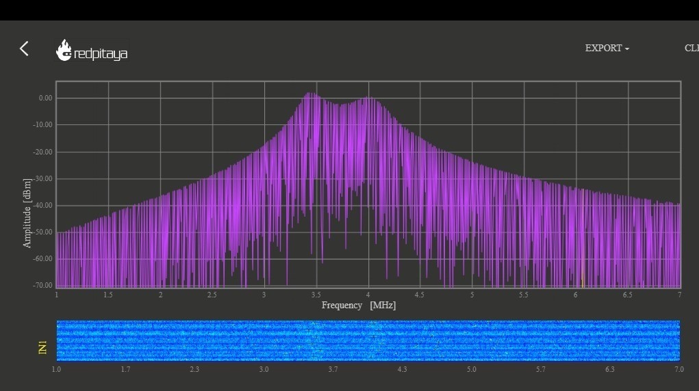

I was a bunch of software updates behind on the Red Pitaya, so I upgraded it to the latest firmware that can be run without upgrading the Linux version, and tested it out by tuning up the bandpass filter on the front end. Ultimately, it seemed like the best compromise for the top coupling cap was 22 pF. I started with 47 pF. the -3 dB points look to be about 3600 Khz and 4050 KHz and 3500 Khz is about - 7 dB. The receiver has plenty of gain to deal with that. Pics are before and after tuning it.​

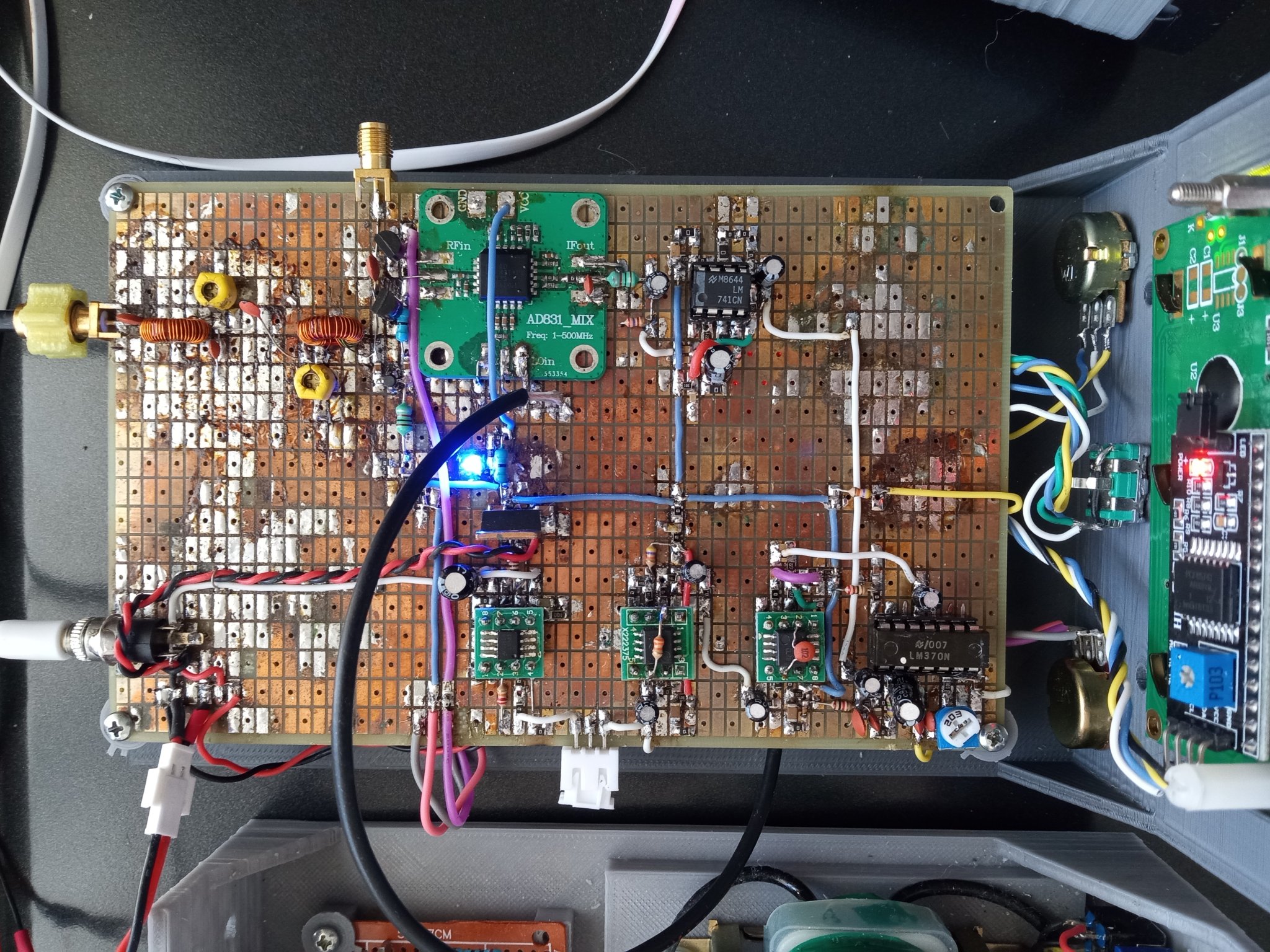

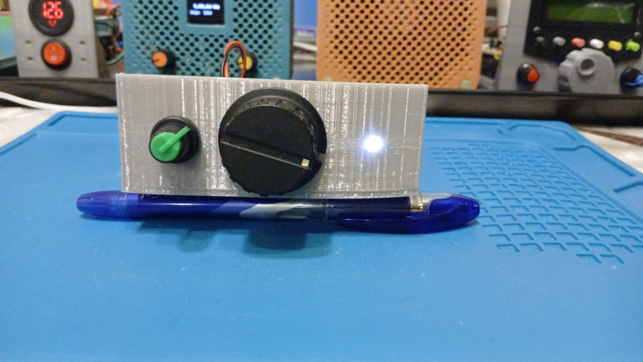

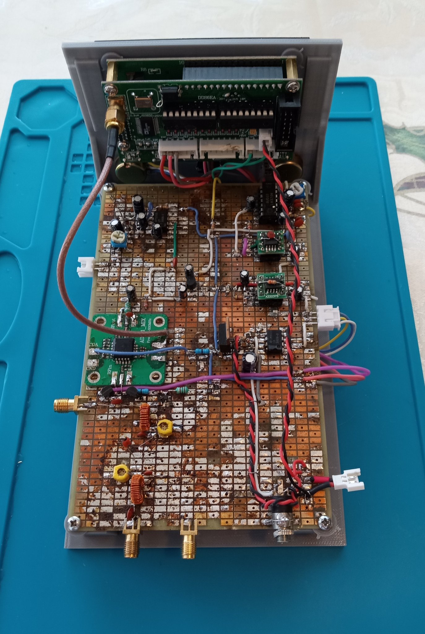

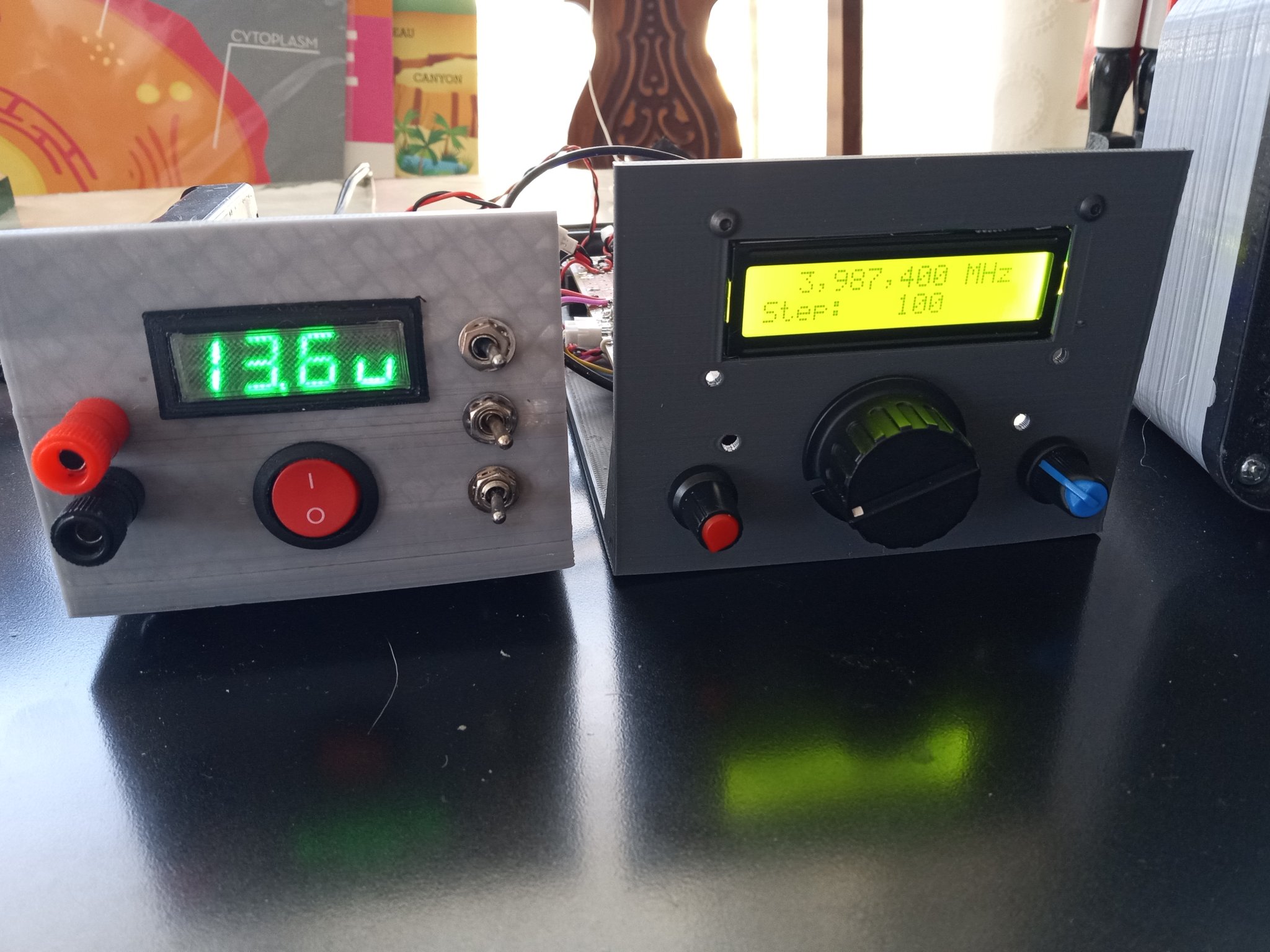

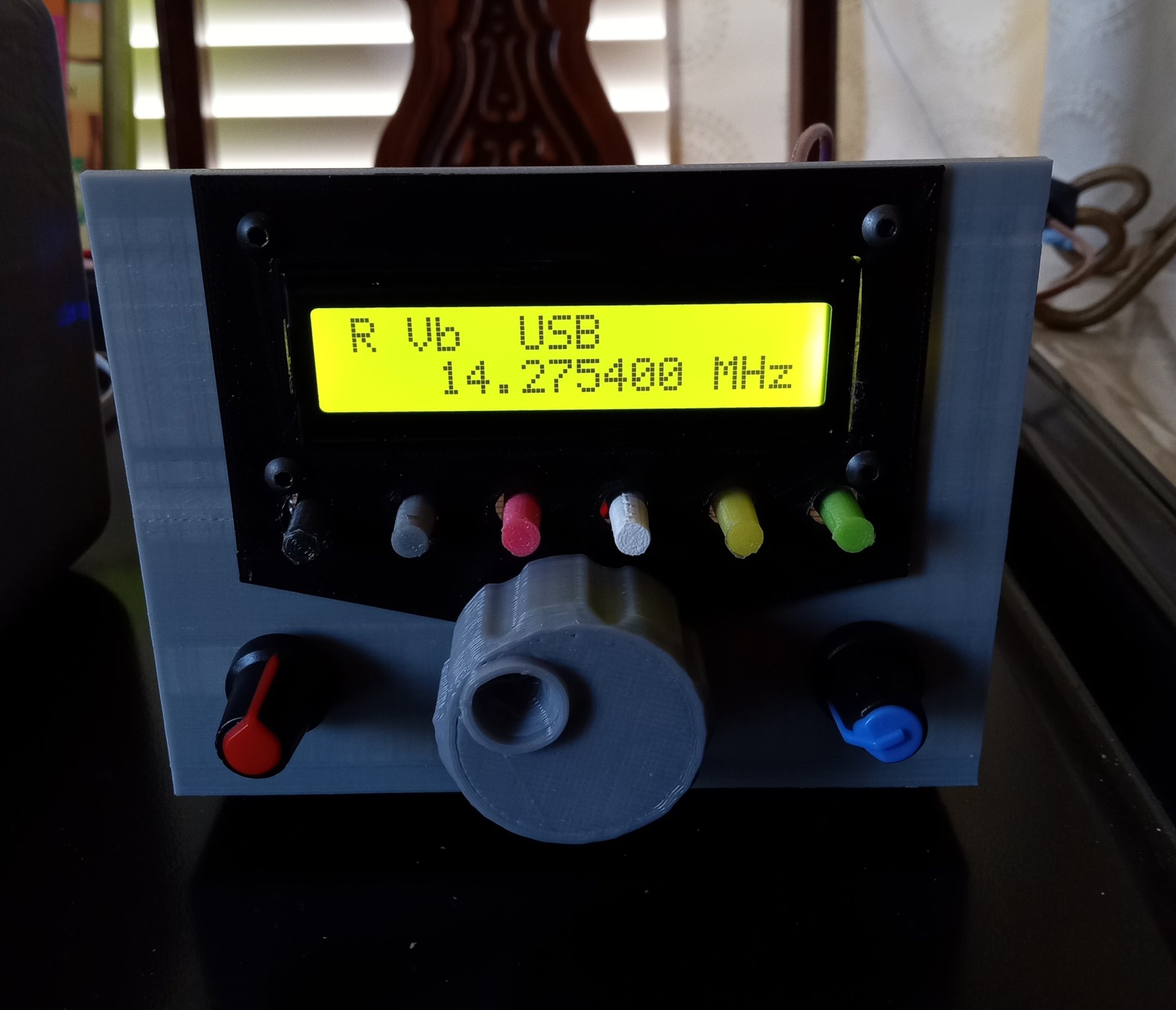

I changed the LO to one of those inexpensive DDS units, the same as used in the SSB transceiver, except, here, I just used the spindly pushbutton switches that come with the device.
The reason for the change is the remote possibility of a companion CW transmitter, and I figured the cleaner output of the DDS would make things easier. The dual VFO's RIT, memories, and offsets are nice, too.
These VFO's bandswitch, but the frequency at which they switch is not user adjustable, so it is not compatible with the bandswitch board I made earlier. For now, it still has only the 75/80 meter filter. Now that work outdoor wx is here, I am probably done fooling with it until fall.
It works pretty well, better than I expected, actually.
