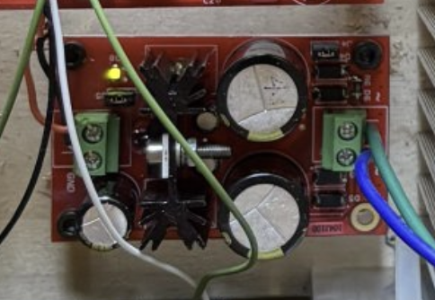

@NeoTheOne there are two of those, each is a 5Vdc power supply which power the JLSounds I2S over USB board, which per what I've read here is an improvement over powering that board from the USB port. Both of those small power supplies also come from JLS. Conveniently, there are jumpers that allow precisely optimized voltage for each side of the I2S over USB.

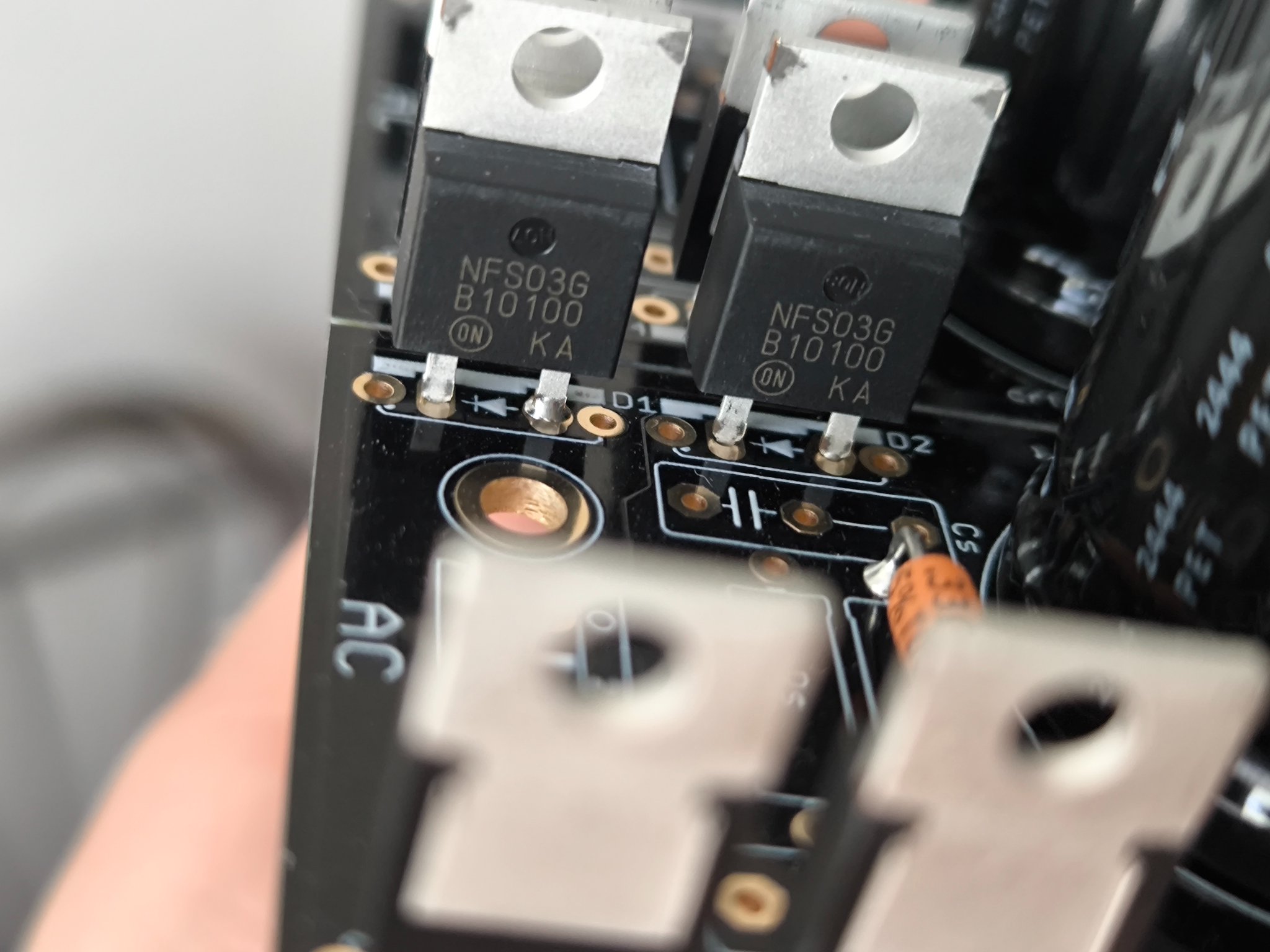

@JKiriakis what drill bit and tap do you use for drilling and tapping hole in the heat sink for to-220 Mosfets? What size nut and bolt to use ? I'm not able to nail down the right size on amazon.Largish common sink, needs to drill and tap, something relatively cheap like this: 120mm Amazon heatsink
Use insulation pads and nylon grommets for the Mosfets.
4/40@JKiriakis what drill bit and tap do you use for drilling and tapping hole in the heat sink for to-220 Mosfets? What size nut and bolt to use ? I'm not able to nail down the right size on amazon.
@NeoTheOne I opted to through bolt the MOSFETs with M3 hardware. To do that required careful measuring of the distance between the center pin vias on the PCB which equate to the FET mount hole and the gaps between the fins of the heat sinks. Distance between FETs fortunately land between the fins. I studied the CAD drawings of the sinks closely before ordering. And essentially guessed on size and dissipation based on observations of other members builds on the thread and Salas’ original write up. Big enough on my 30V BiB and larger than necessary on the 5V in my case with modest current requirements.
Recommend use of a drill guide whether you drill and tap or through bolt, I had issues with insulating the FET bodies from the sinks.

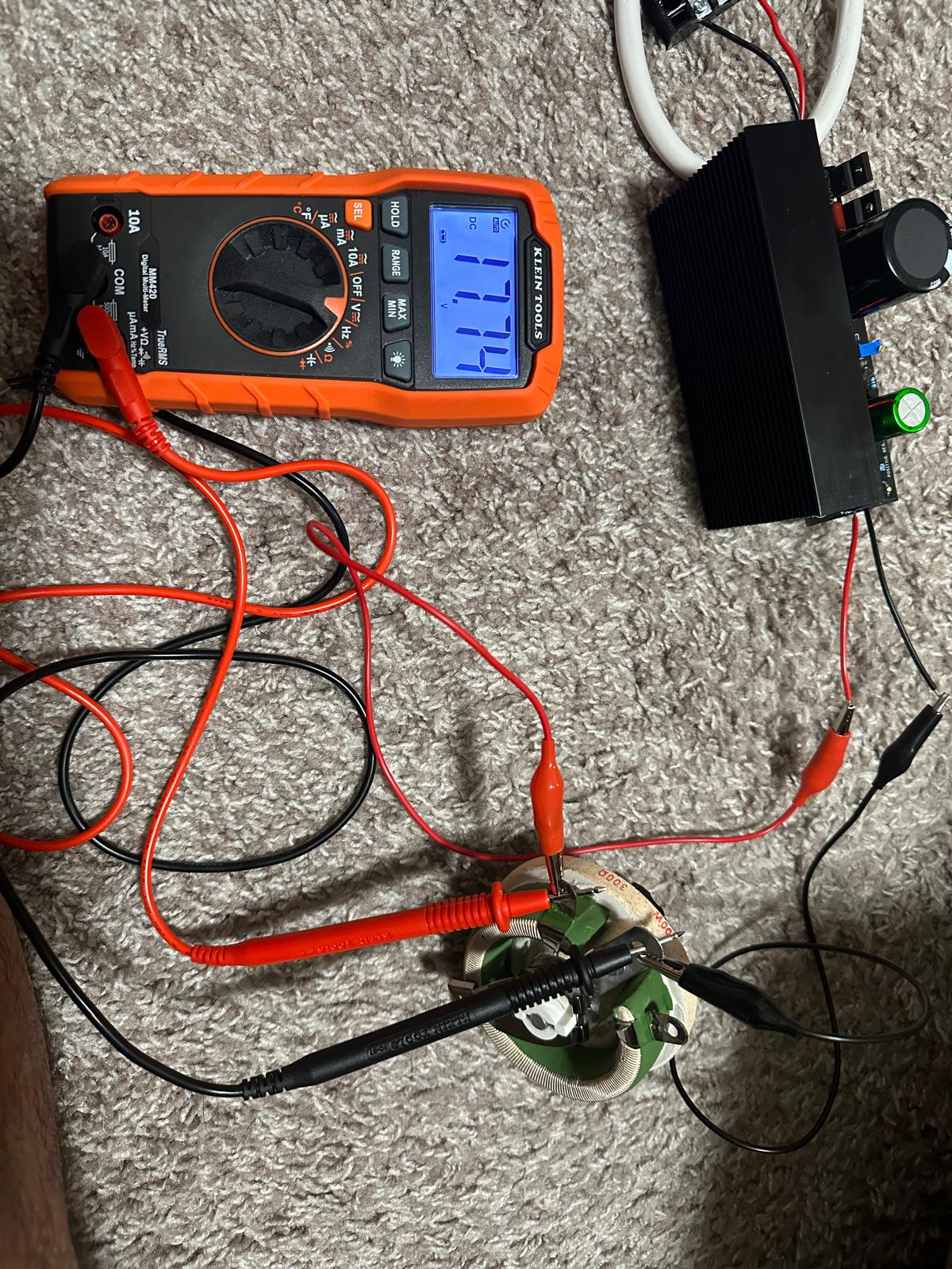

I replaced the resistor Rf and now the power supply is working but the output is 2.6VDC even if i adjust the pot. The input VAC=15Vrms
M1 runs hot but M2 is running cold though.
I am measuring 18.3VDC across C1. Also The LEDs are not lighting up either.Is there normally high rectified DC Voltage on the C1 big capacitor?

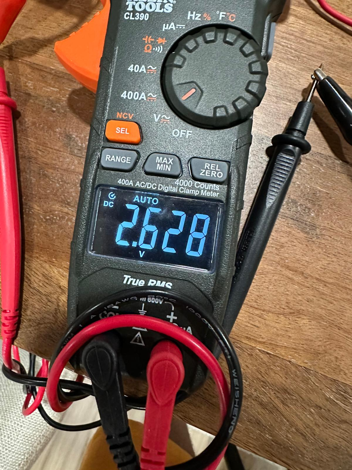

With what R1 value (2Ω?) and with what dummy load resistor value you test right now? To see if there is enough CCS current produced for this test first of all. Also, is there near 0.6V DC voltage across the R1 legs?
R1 = 2ohm. Dummy load reistor = 10ohm 25W. R1 Voltage = .578VDC.With what R1 value (2Ω?) and with what dummy load resistor value you test right now? To see if there is enough CCS current produced for this test first of all. Also, is there near 0.6V DC voltage across the R1 legs?
The CCS apparently works at 289mA (0.578V/2Ω). To reach 12V Vout on a 10Ω dummy load, takes 1200mA.

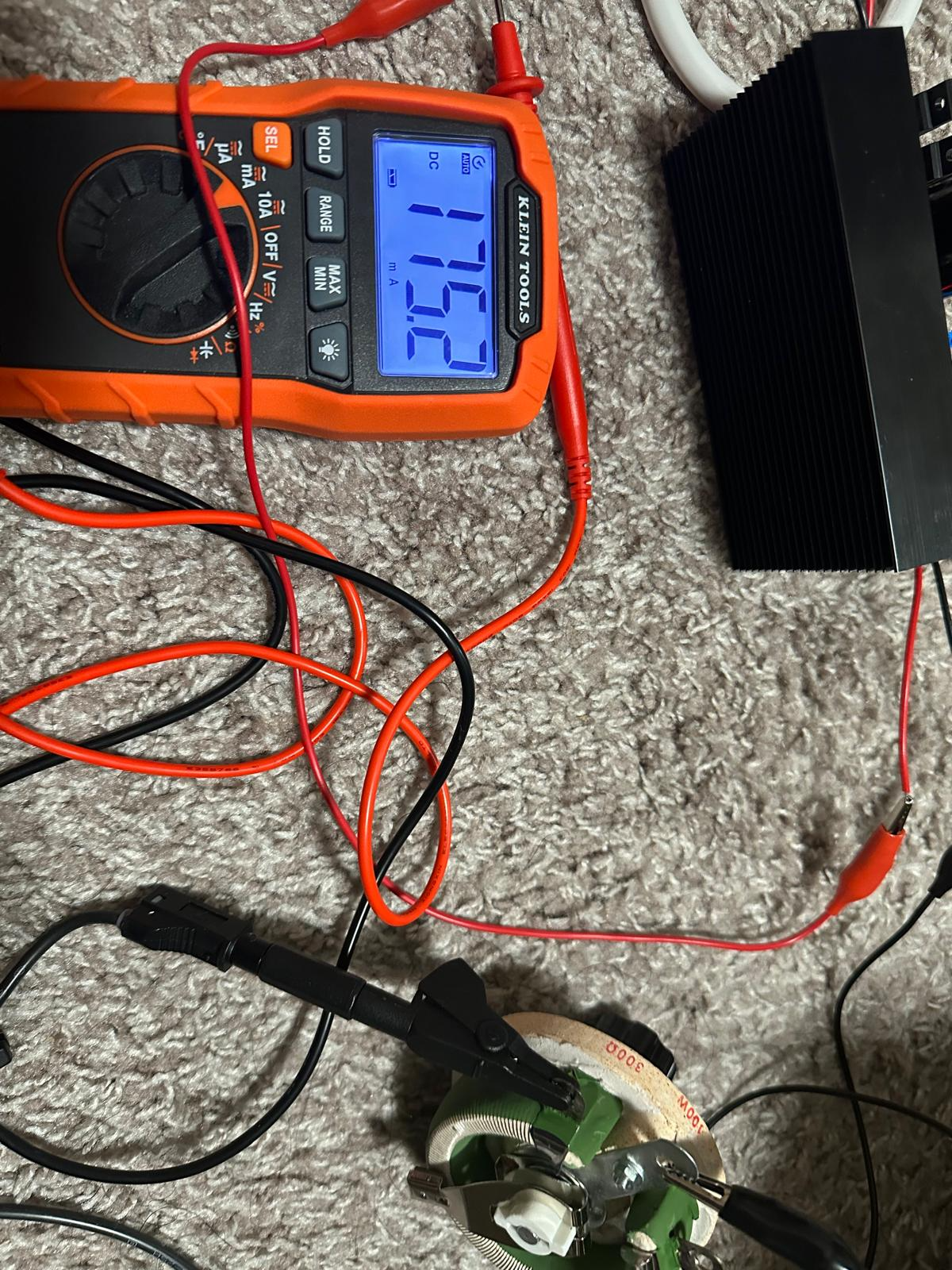

Pictured reading 2.628V/10Ω=262.8mA i.e. very near to the CCS calc. There can also be tolerances in R1 etc.
This dummy load overpowers the CCS and it naturally limits the output voltage to CCS ability with given load.
Use a 100Ω no less than 2W power dummy load resistor to see if your original 12V Vout goal can be reached.
If it can, see if it can also serve your real load. In case of current limiting and voltage loss again, use 1.5Ω R1.

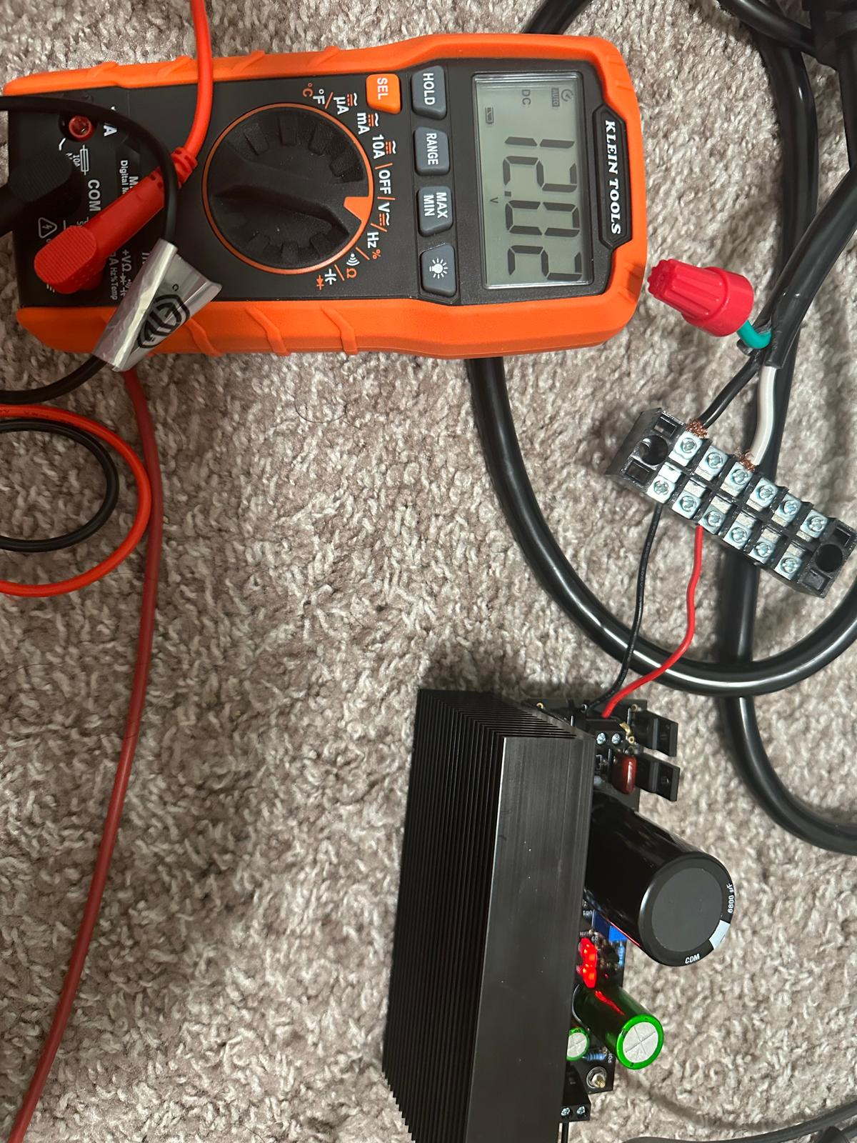

@Salas , I tested with 100 ohm resistor and also updated the heat sink. But still changing the pot value is not having any impact on the output voltage. In fact when I'm changing the output load the output voltage changes but remains constant.
Dummy load = 100 ohm 300W
Output VDC = 17.74 VDC
Output current = 175.2 milliamp.

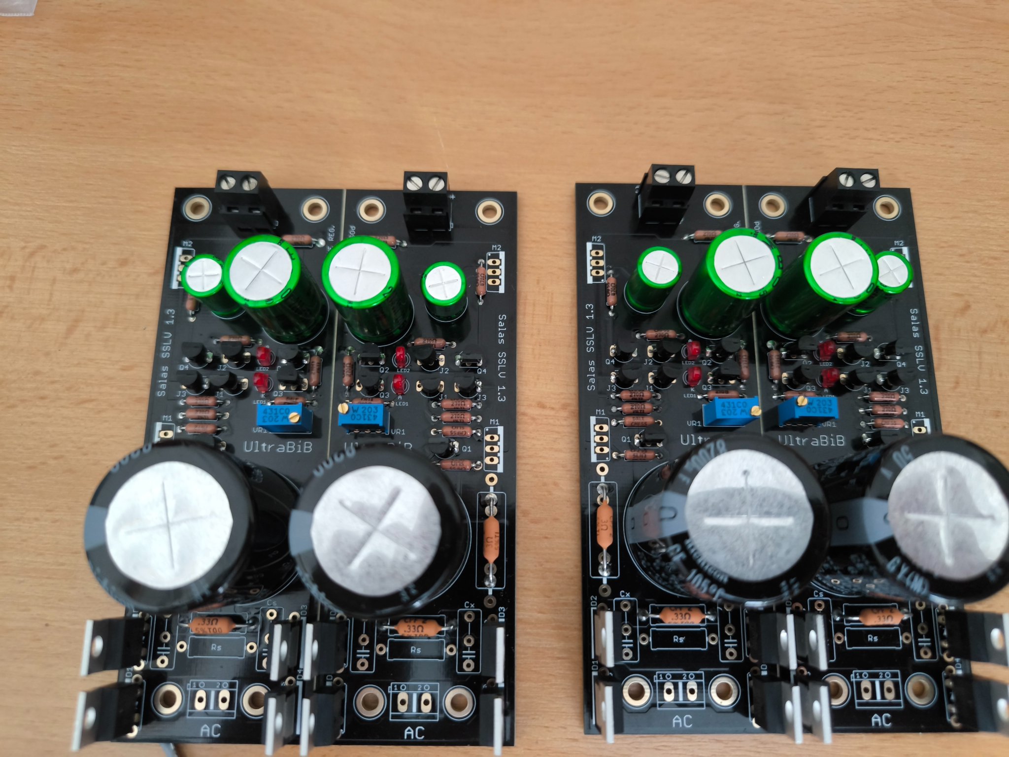

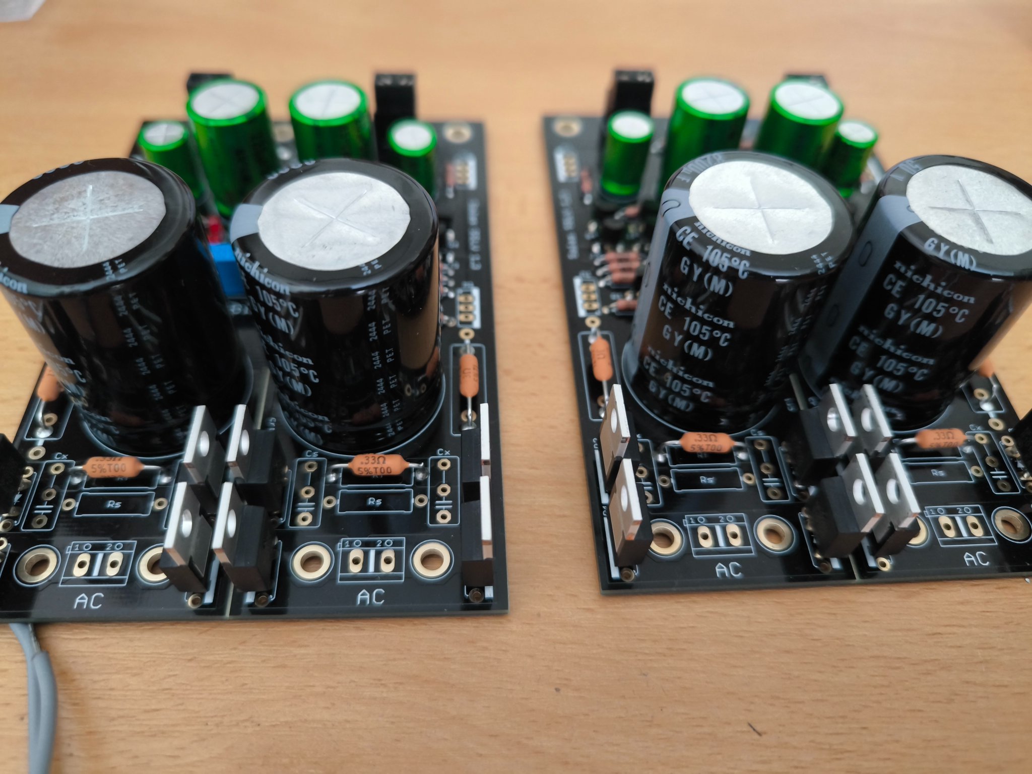

Hello again,
My UltraBiB sources for DCG3 are almost ready, just need to order small parts for quasimodo snubber, after tuning RS...
This week I'm just waiting for the delivery of 4 heatsinks which I finally ordered completely different than I thought, they will finally be SK 92 50 SA from Fischerelektronik. Since the UltraBib even with the massive heatsinks is quite large, and everything (UBiB, DCG3, transformer, smart ON/OFF, I-Select) doesn't fit in one box, I decided to go with the split preamp concept. In one box UltraBiB power supplies, transformer and intelligent On/Off module and in the second box signal part (DCG3, I-select). Both boxes will be from Modushop Slim Line 02/280 series.

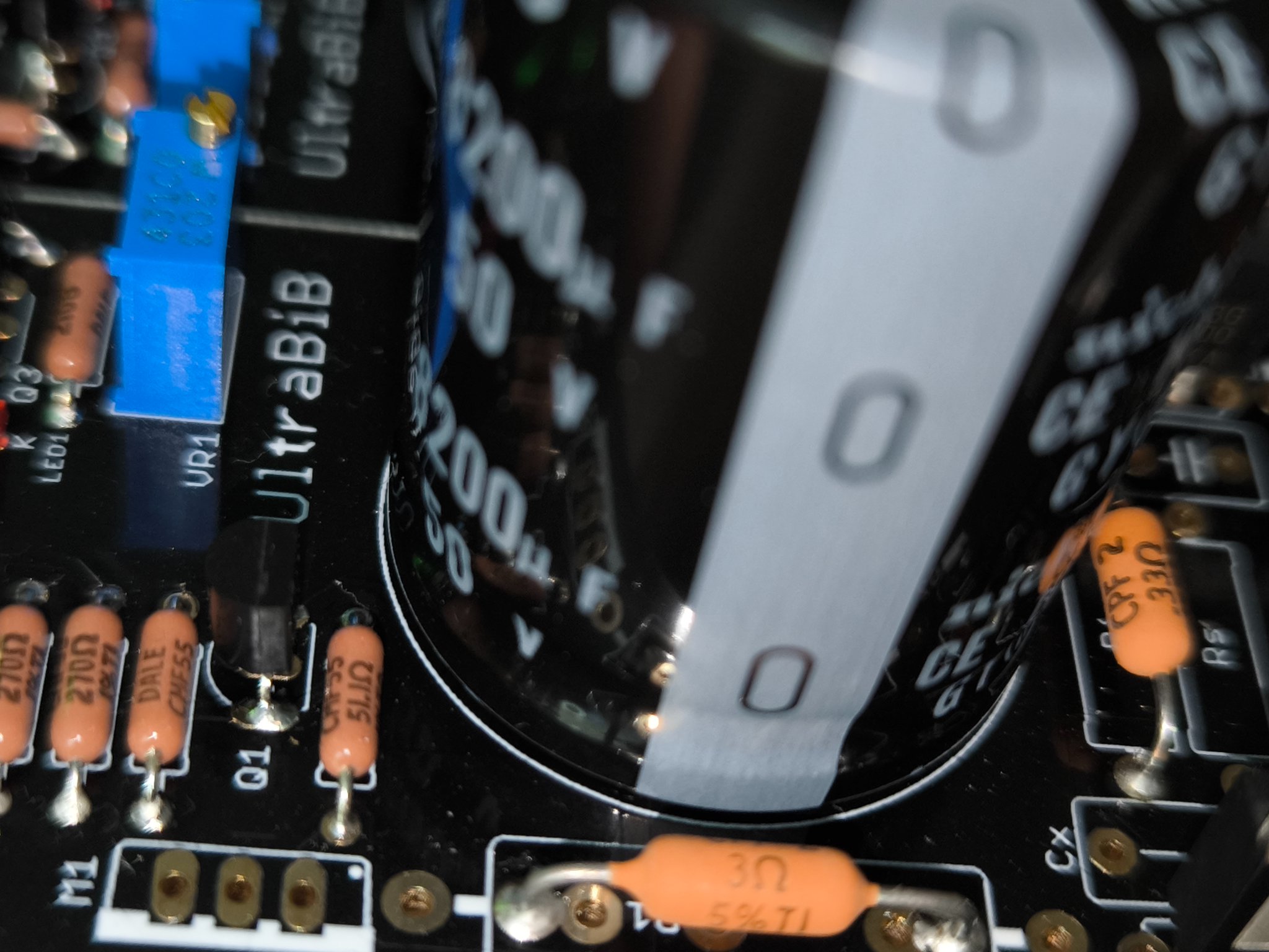

What is DCV on C1 when Vout is 17.74V? When the multiturn trimmer is wound fully counterclockwise (all turns), it still doesn't change Vout?@Salas , I tested with 100 ohm resistor and also updated the heat sink. But still changing the pot value is not having any impact on the output voltage. In fact when I'm changing the output load the output voltage changes but remains constant.
It did! Had to turn quite a few times counter clock wise. Finally getting 12VDC outputWhat is DCV on C1 when Vout is 17.74V? When the multiturn trimmer is wound fully counterclockwise (all turns), it still doesn't change Vout?
