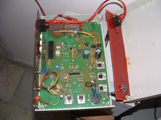

Tarun this is the PCB of my UPS that i used to make in 2004. Due to steep rize in steen and copper price i had to stop making them as there was not much of profit in that. Well some of ventures that i have been through in my life. For a medico person to venture into a field that is not familar to him is a rough ride. its not that i want to show off or " apne munh miya mithu" but yes i have been a person who once decided on somthing will keep on working on it until succed. u can call that stuburnness or anything but thats what has been behind my sucess of these two equipments that i made. the cautry was a sucess with the docs and they were very happy with the working till today not any of them has any complaints ( sold over 500 units) and so is the UPS. Didnt sell much( UPS) but it also has no complaint. I used the CRGO core that is grain oriented and is very strudy on power output and load handling. i know if i am some help is given i will suceed in the XO too thought i will loose some money on the parts but its worth, when u sit back and see the finsihed product it realy gives a satisfaction that is unexpressable.

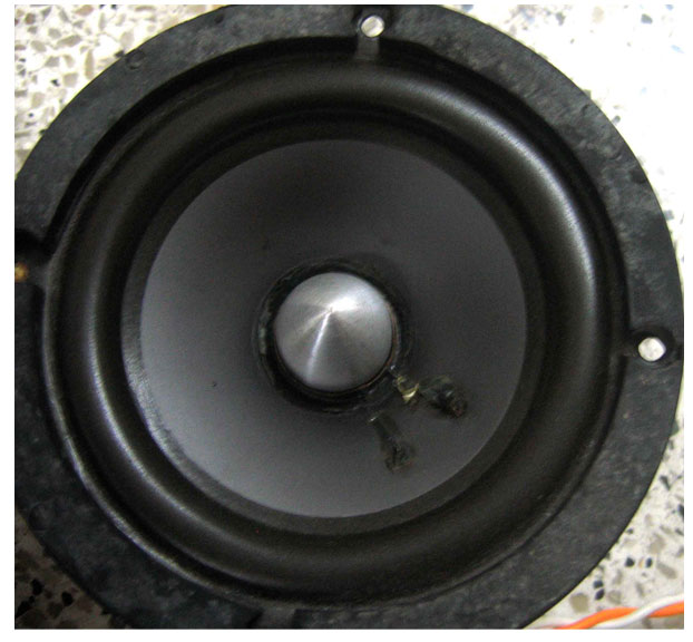

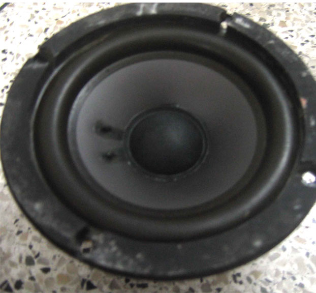

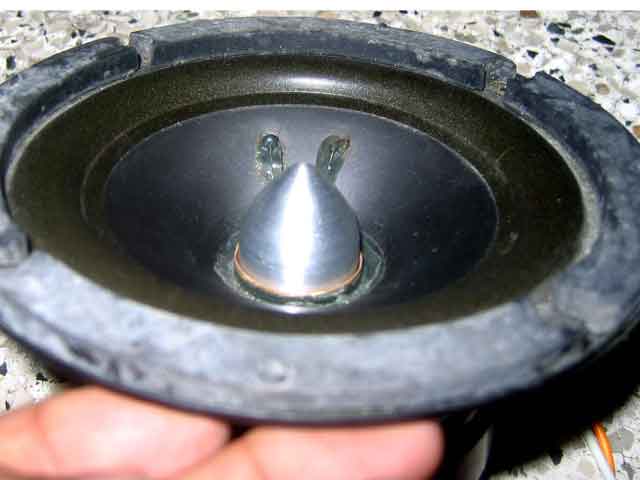

phaseplugged a bolton 12dw22
I have a pair of 12DW22 5 inch poly midwoofer from boltons lying with me for a couple of years .Prior to phase plugging the sound was very harsh after inserting the phase plug the harshness has gone havent measure the speakers .
http://picasaweb.google.co.uk/somakmaitra/SpeakerModification/photo#5232857992165855618
