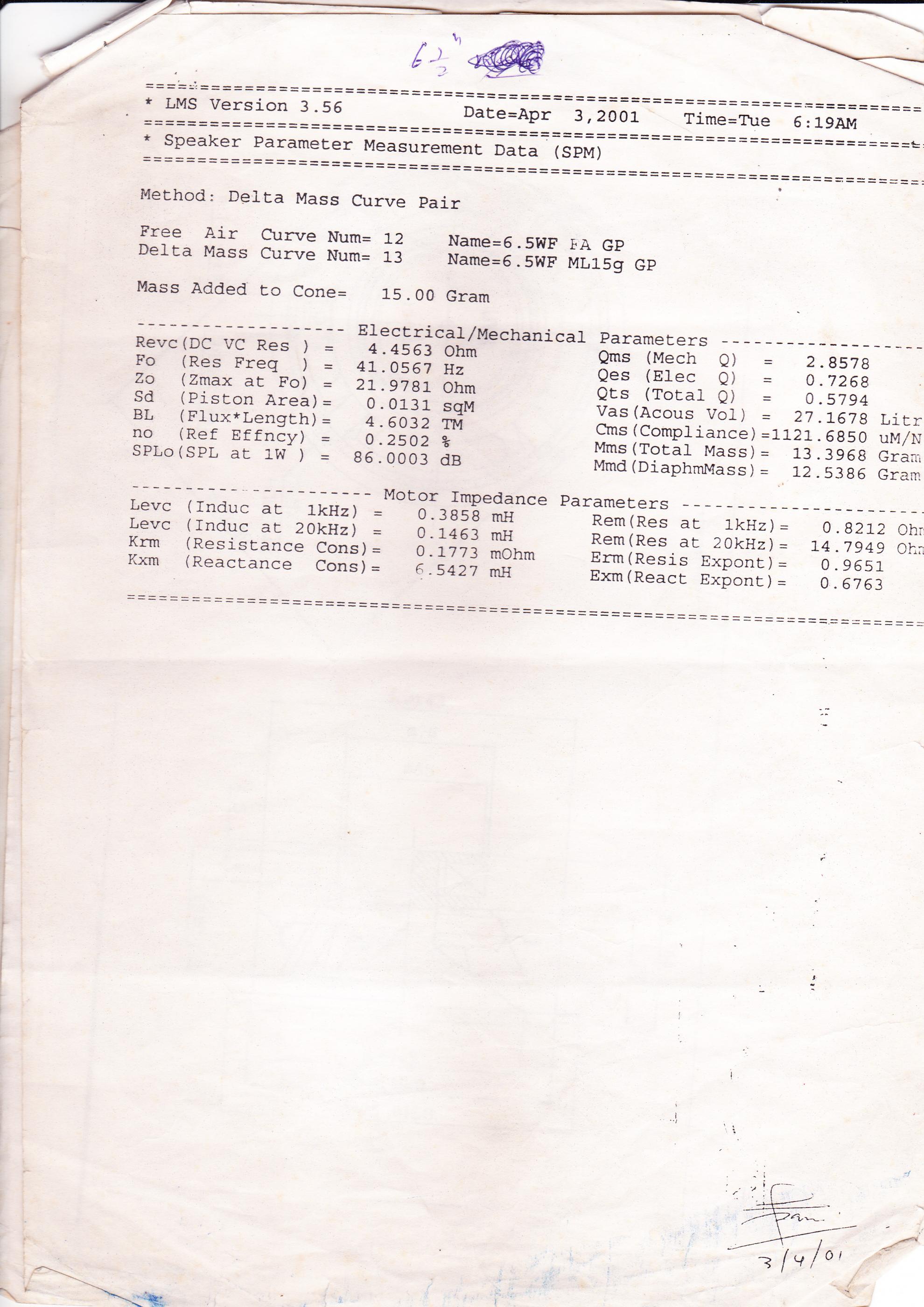

TS specification for JVC drivers available at chaudhary trading lamington road
Does anybody knows or measured the TS specifications of JVC 6.5 inch woofer and JVC 8 inch subwoofer available at chaudhary Trading(panda audio) lamington road mumbai?
I have a pair of both, and planning to redesign the cabinet for those.

Thanks Viki,
any idea about the 8 inch subwoofer? I do have a specification sheet for subwoofer but it does not specify Vas
VAS -23 Liters.
Port-3" x 3.5"
T/S parameters for the JVC 8 inch subwoofer which I have is
Qms - 8.8189
Qes - 0.9239
Qts - 0.8363
Fs - 53.0815 Hz
Zmax at Fs - 42.1823 Ohm
Re - 4 ohm
I used winisd to calculate the volume of cabinet using Vas = 23 litre
WINISD says 255 litres volume, this seems to be too large, is there anything wrong with the T/S params here?
