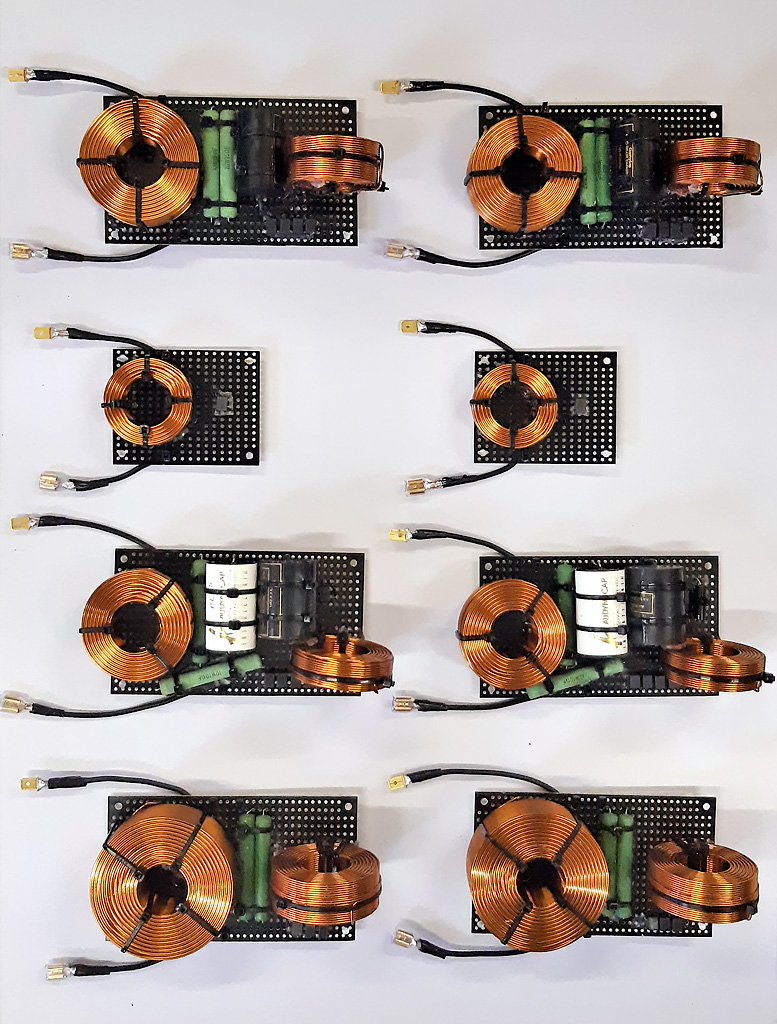

The filters that ended up in the arrays:
All done passively, as I want to keep using my favorite amplifier. Not pictured are 2 notch circuits per side.
So, yeah, I did use DSP in recent years and still do now. But also make use of passive means to get what I wanted.
