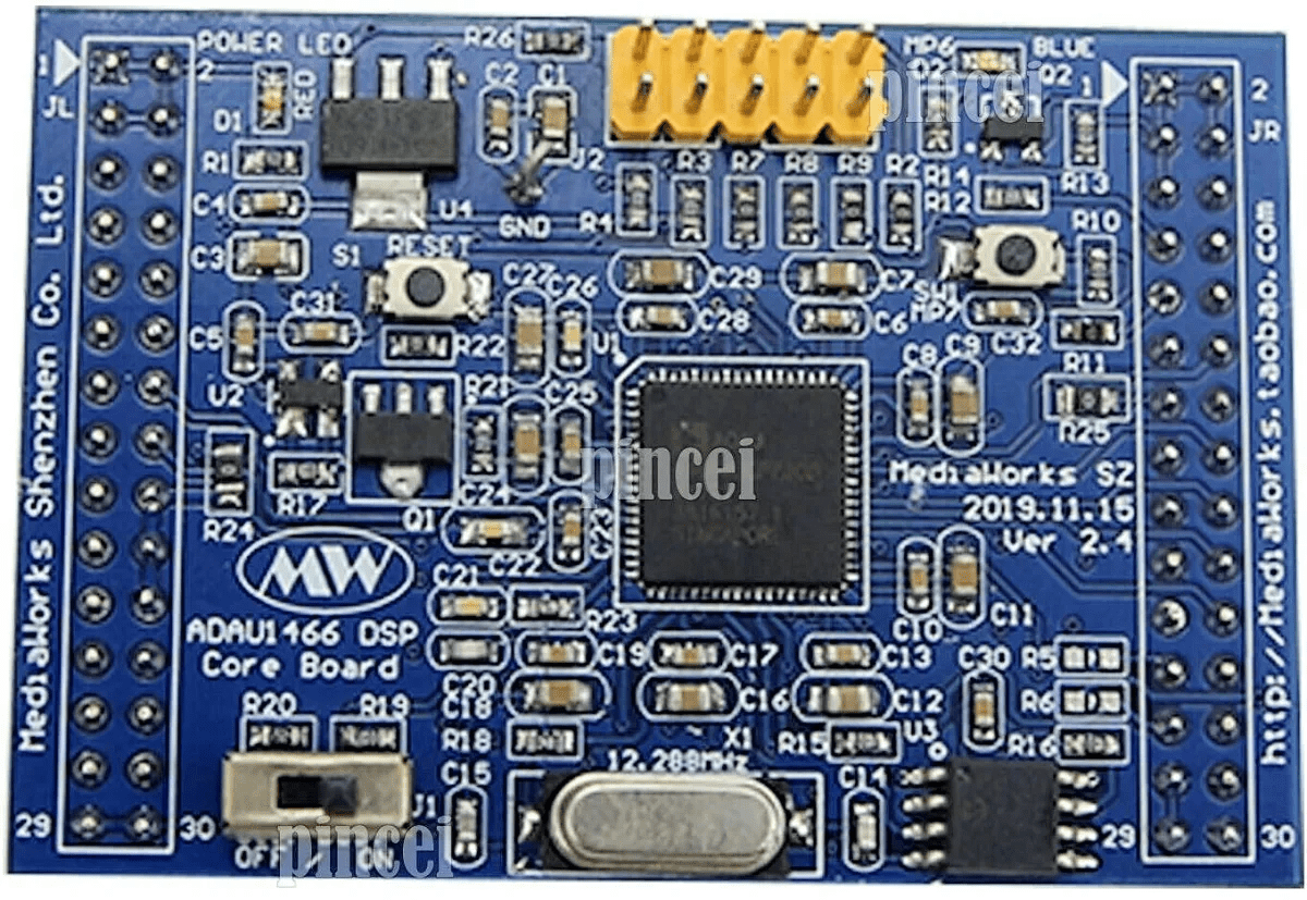

Also, that line array project you mentioned in post #6 is getting updated. Here is my $50 48-channel DSP:
That board looks great. I found it on eBay and may have to order one for myself. Is there any documentation?
My current solution is 3x 1u boxes of legacy dsp. 1 per line and 1 for input. Certainly would be nice to reduce that to a small board and include it in the amplifier chassis.

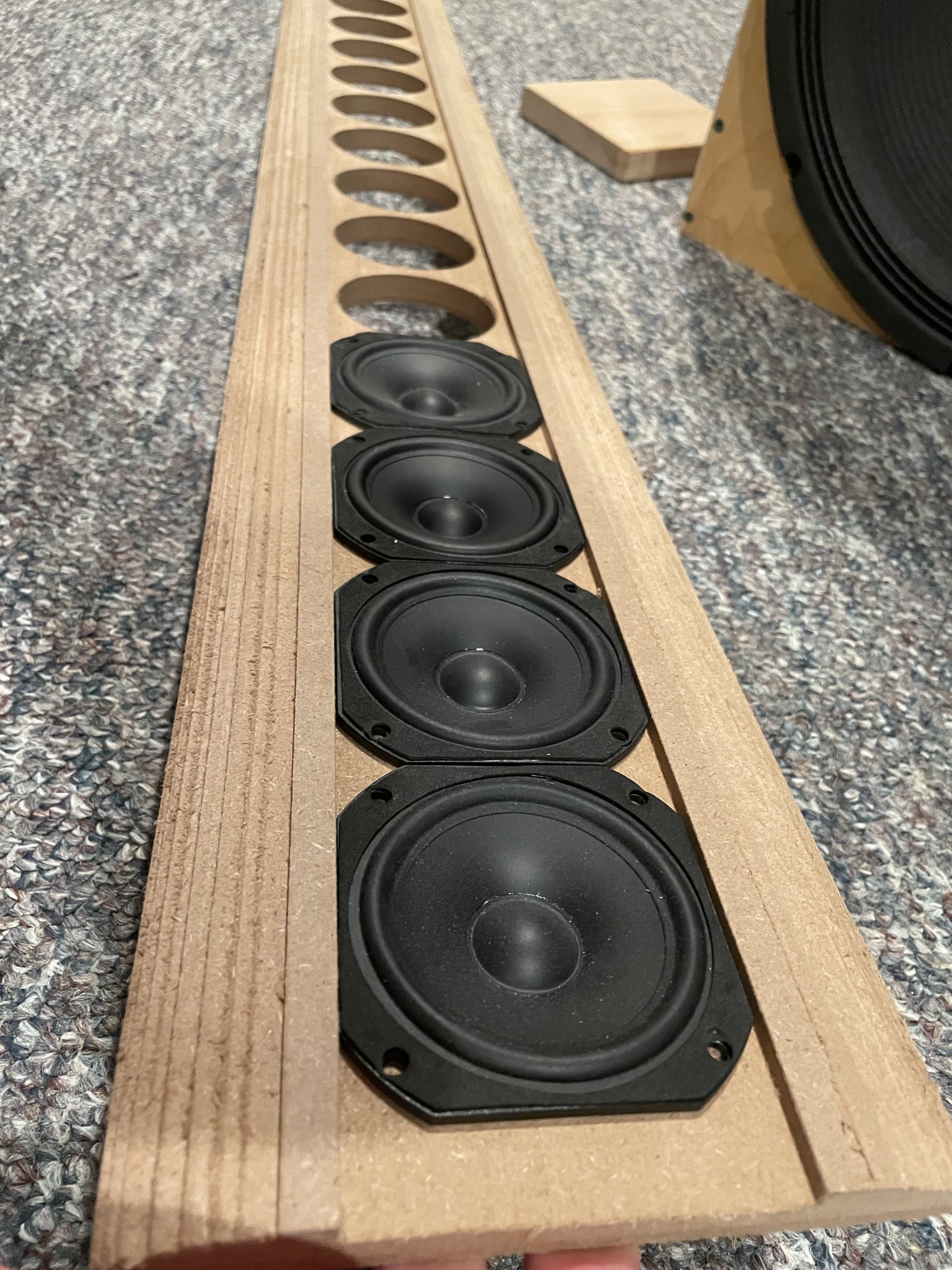

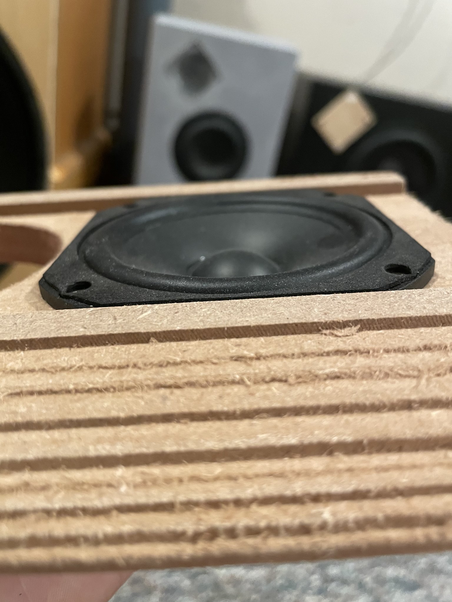

Thanks. ~60mm radius curve, once the steps are sanded and smoothed.

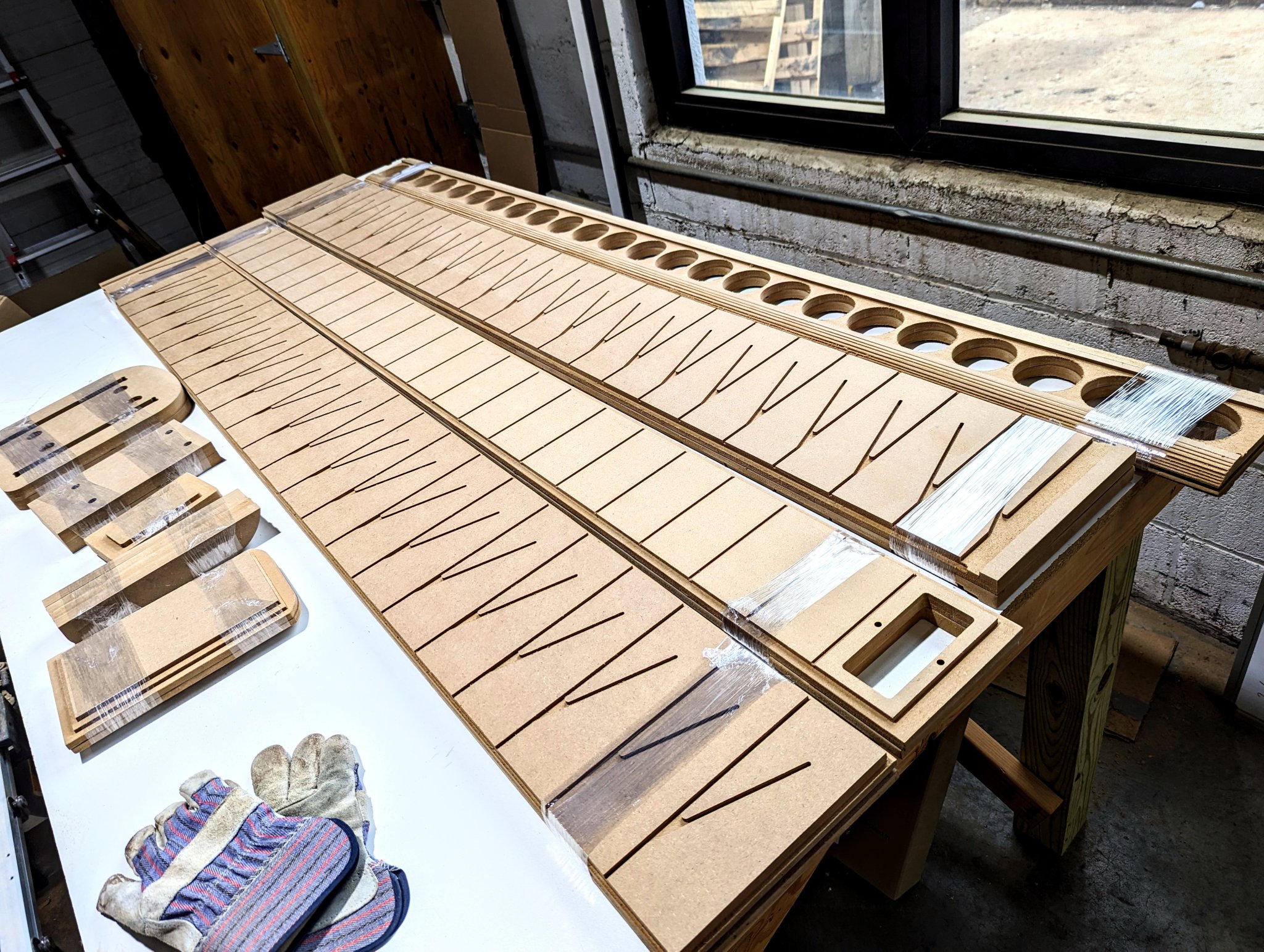

I'm picking everything up tomorrow from the sign shop. About $600 and 3mo to have it done.
I need to make a schedule for all the various assembly tasks. With my last project I got excited and glued it up before I should have, and made assembling internals super difficult.

I'd say, if this functions as well as a proper sanded curve, I'd be inclined to leave it as is?
I think it looks quite cool as is, especially in a soft or matte finish. It kinda looks "technical" .
If it isn't too much work, maybe it could easily be tested in simulation? That is, if you like the look yourself.
@fluid ? Would it be as easy as I think it would be? I'd say if the steps are small enough, and it does look that way, there's probably not much if any difference. Saving you time and making it "interesting" to look at .

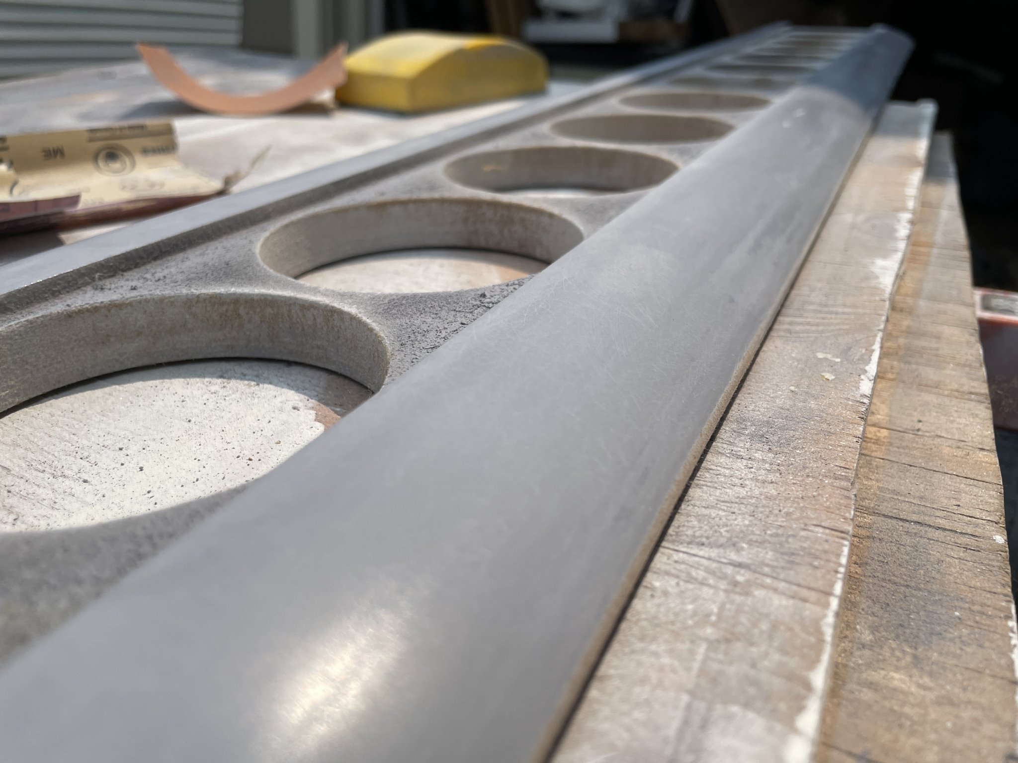

Very small steps won't make much difference in real life, it is tricky to model as the mesh resolution needs to be high and then because everything is completely reflective small steps will introduce diffraction like noise making it hard to see anything useful.If it isn't too much work, maybe it could easily be tested in simulation? That is, if you like the look yourself.
For the best diffraction performance sand it or fill it so it is smooth.
If you like the look then you are balancing aesthetic performance vs acoustic performance
my plan was to have a nice smooth curve- most important was having consistency over the whole thing. I worry the keeping the small edges will be revealing of any imperfections or dents.
Filler might be easier than sanding- I've had luck previously using a spreader made to match the desired shape. The filler will need sanding, but removing filler will be more forgiving-I can always add more.
Filled+sanded the first baffle with bondo and it’s very nice and smooth. Damn that stuff is noxious though- I can only manage working with it entirely outside.
I brought the second one in to test fit drivers. Perfect. Just great work from the CNC shop. They’ll be perfectly flush with the baffle once they have some seal putty behind them.
Lots more to do- but having the pieces here means it’s going to be real soon enough!

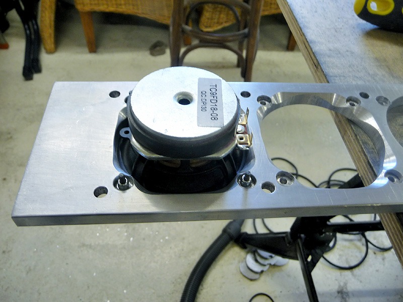

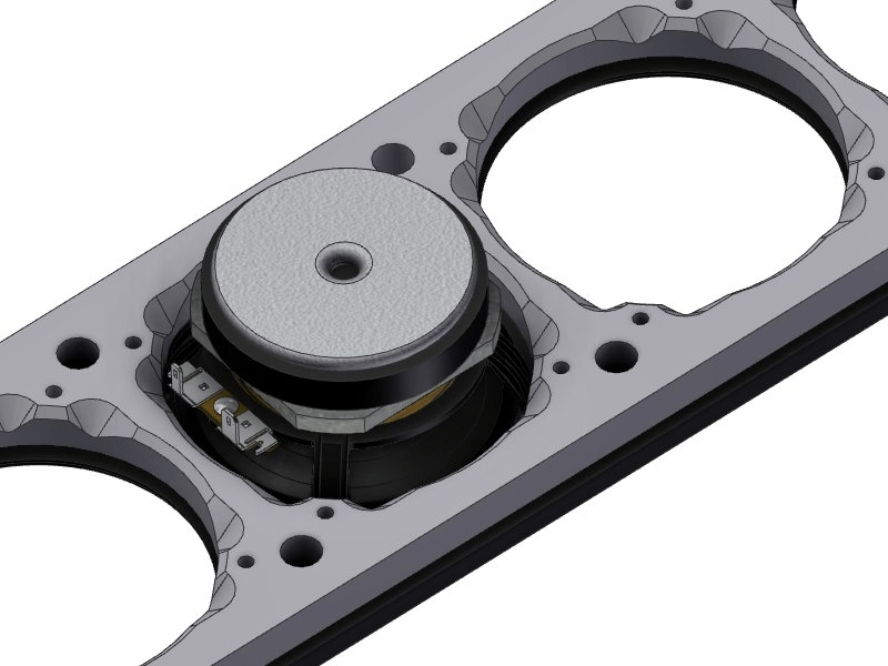

Don't want to be a drag, but if I see this:
All I can think of is putting a nice chamfer on those holes.... see: http://www.troelsgravesen.dk/chamfer.htm
Even though my (inner) baffle was only 10 mm in thickness, I still made sure the drivers could breathe...
P.S. if that's still planned but not yet executed, I didn't say a thing .
