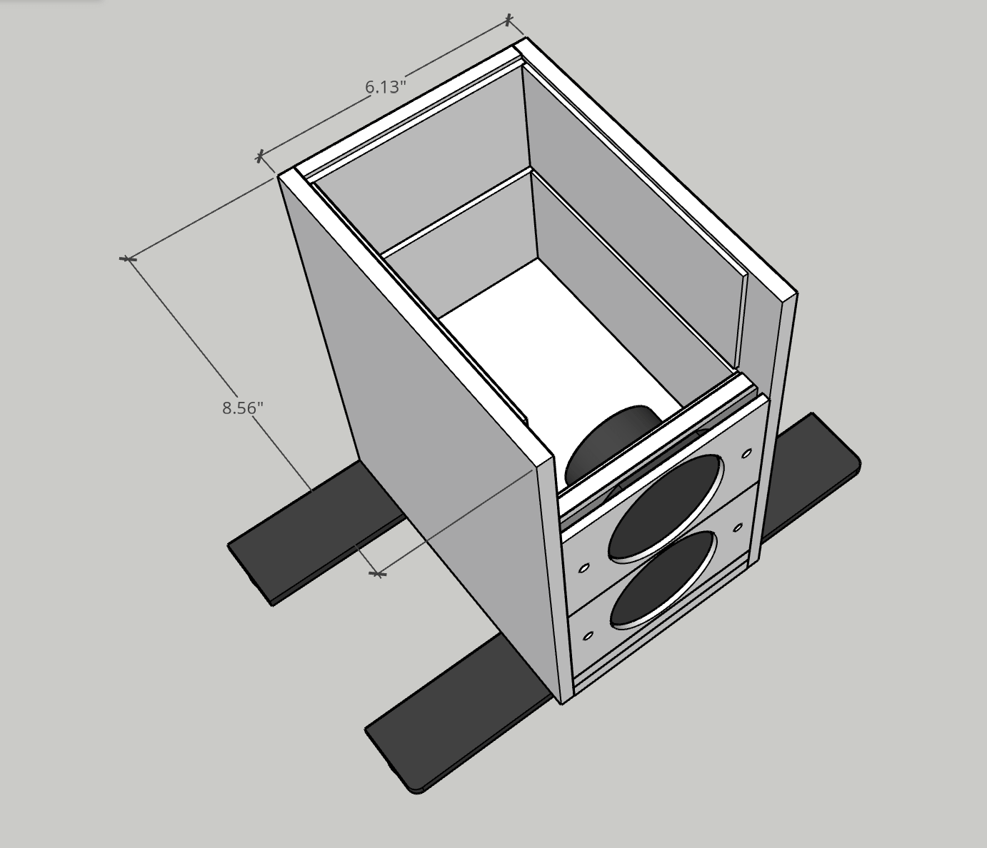

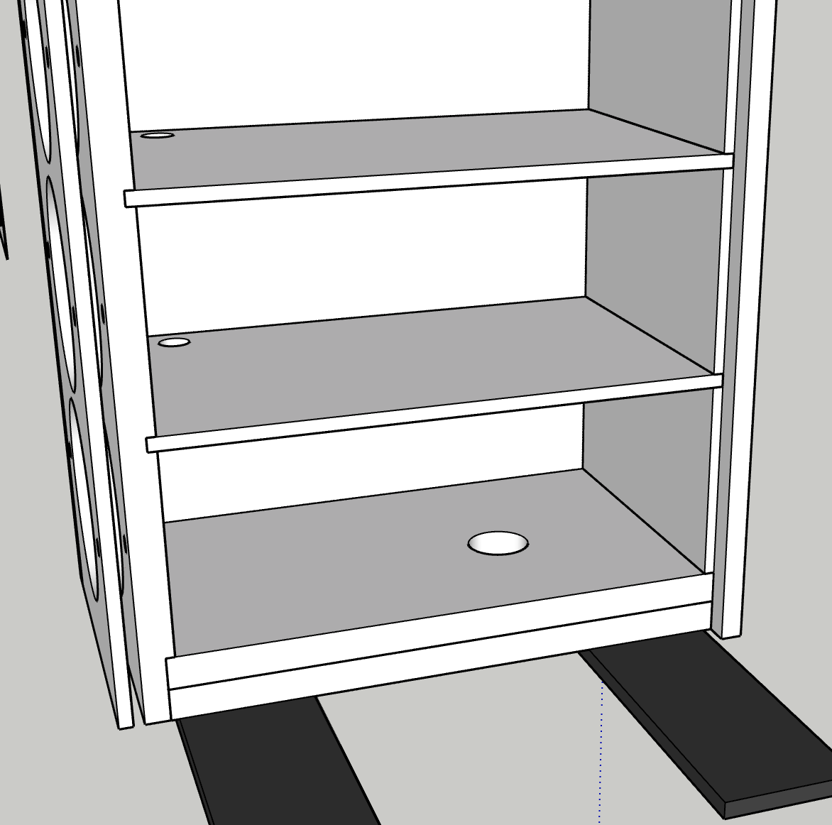

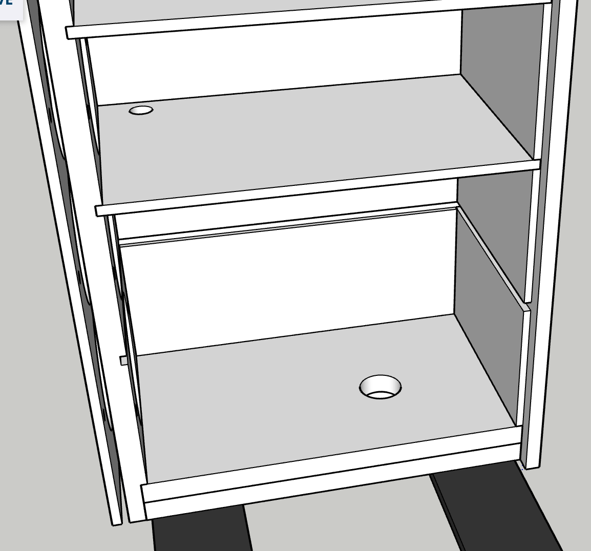

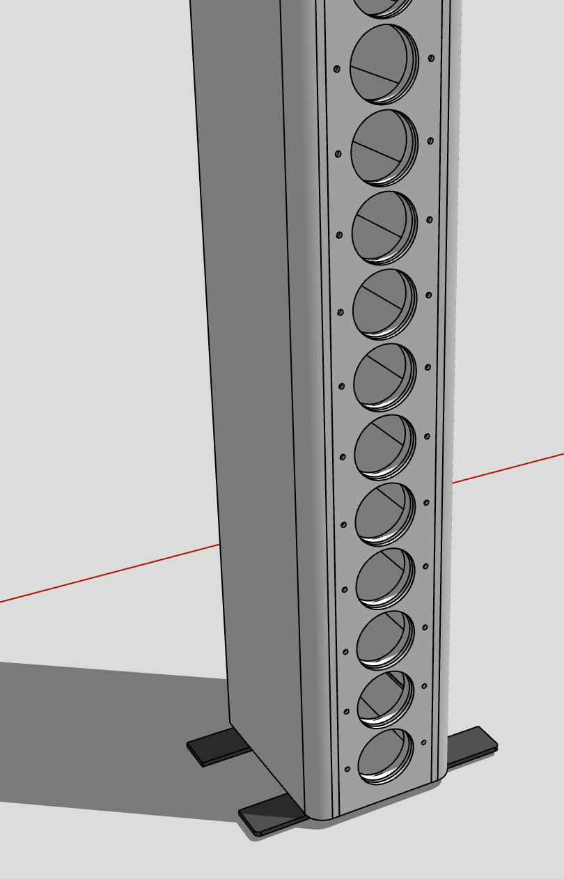

Yes, I'd opt for the second drawing, this one:
The hole needed for this is easy to seal with a rubbery glue and routing the wire is easy. That first option seems like a nightmare to route unless you do it as you build up the layers... i.m.h.o. that's not practical.

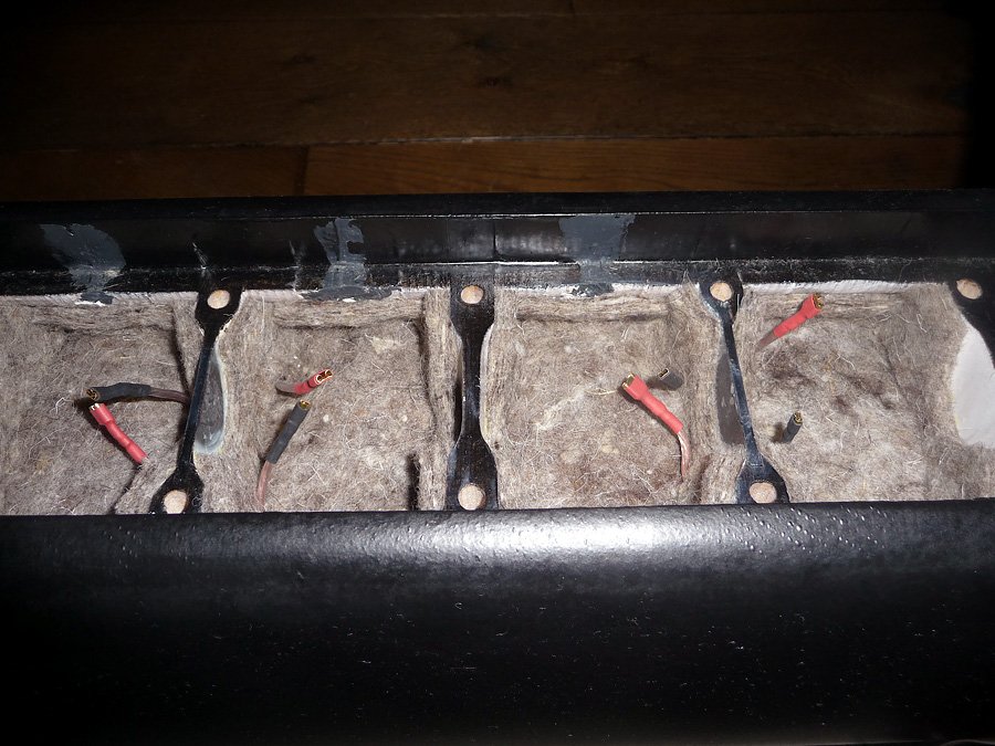

Personally I just drilled two small holes in each divider in my own arrays to be able to wire them, for practical reasons I put those holes much more forward, closer to back of the drivers so I could fill the chamber with damping material and route the wiring afterwards, next put a layer of wool felt on top to shield off the itchy fiberglass fill I used plus tucking away the wire run in the process...
I needed the headroom in wire length to be able to wire the baffle with drivers and mount the baffle to the enclosure afterwards..
In designing my arrays I've always kept one thing as a top priority: serviceability.
That's why I used certain materials and did not rely on wood screws etc. Everything is serviceable by bolting/unbolting without damaging any of the materials.

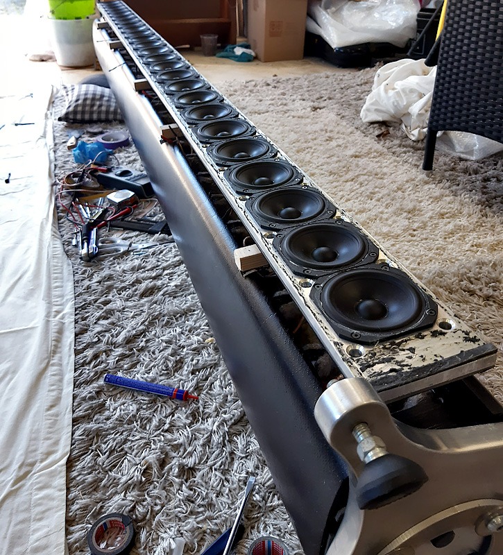

Sorry, aside from a limited Pinterest collection I don't have a master gallery. It's all in that huge thread of mine though. I started with a write up of all the assembly work on my site: https://www.vandermill-audio.nl/, maybe some day I'll find the time to finish that .

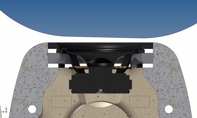

My volume per driver was about 2.1 liter. And I used plenty of damping material too. Wool felt on the walls and fluffy fiberglass in the middle. Making impedance tests to see it's effectiveness.
Outside baffle is 6 mm thickness, with an 8 mm fillet routed as driver cut-out. It used to rest on the top gasket of the TC9.
With the 10F I put a neoprene gasket on the backside of each cut-out that touches the driver frame. Where the bolts holding the baffle are, there's a thick neoprene seal and everywhere in between both baffles there's butyl rope to damp the vibrations of the baffle. Each bolt on the baffle has a neoprene washer.

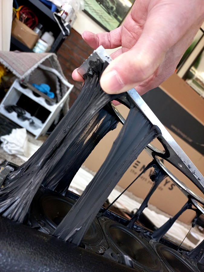

Here's what the butyl rope looks like when disassembling:
You can also see the neoprene felt on the back of the baffle. (in this case you still see TC9, but without their gaskets).
The idea of that small roundover on the baffle is to have the seamless transition from the cone towards the enclosure shape:
This shape is helping to reduce the negative effects of diffraction at off-axis angles. Simulation shows it is working quite well.
The shape of the enclosure together with that baffle roundover was my secret sauce to get better off axis performance than standard rectangular boxes (as shown in a previous post). And the reason for me to use translam construction to be able to create it in my limited workshop. I did consider using a fiberglass hull construction but the shape really was essential for me.
Another detail: the back baffle rests on the enclosure using another neoprene seal (on top of a layer of mass loaded vinyl glued to the 10 mm aluminium inner baffle). The drivers are mounted to the inner baffle without any seal. They resemble a floating construction between enclosure and outer baffle.
Hope that helps...

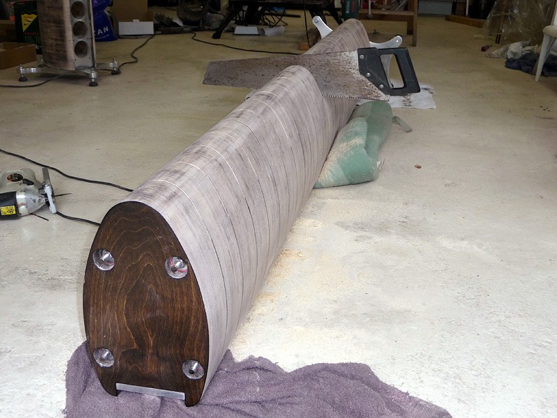

I had an epiphany last night and now have to revisit my trans-lam design. I realized I could still arbitrarily place the layer dividers, that it didnt need to rely on the layer thickness. By trimming 1/4" in specific layers I can add the dividers wherever needed. Much happier to be using this approach, not having the rounded baffle/body shape was really a compromise that I was unhappy with. For now the dividers are going to be made from a sandwich of 1/8" tempered hardboard with green glue between.
Be sure you control the thickness of whatever material you use for the trans-lam construction. I opted for birch ply over MDF due to my assumption the first would have less vertical movement. I still needed to do this:
But that has worked for the long haul.... it would be my recipe for a next time, if I ever would do it again, to have flexible layers at certain spots from the start.
And a nice coat of epoxy/glasfiber mat to top it off. I haven't had any problems since....

That's not quite right... the rods were somewhat free to move, I had rubber washers on the top and bottom, around every 2 layers there was a flexible rubbery glue in contact with the rods. The crack was contraction, the wood shrunk in size overnight due to a humidity change! It cracked on a few "ply" layers, not my glued layers. It happened so fast, the wood and glue didn't have time to adjust. It was with a big loud "bang". I didn't even realize what that bang was until it opened up further over night.
That flexible glue around the rods wasn't a great idea. But being that large a stack, it would probably have cracked anyway, I've seen other, smaller stacks crack without the rods. I think it's a good idea to have flexible layers of a proper thickness to solve this problem. Making smaller stacks, less overall risk.

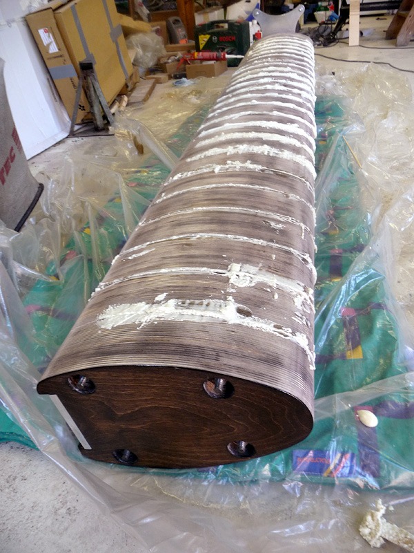

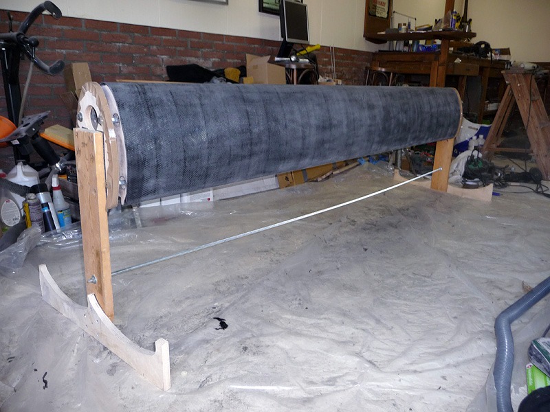

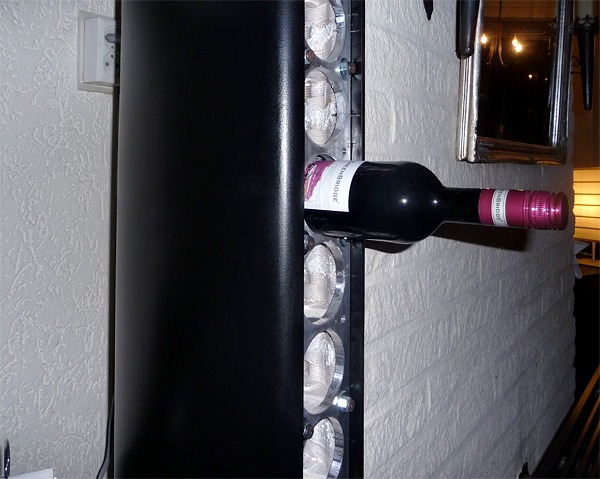

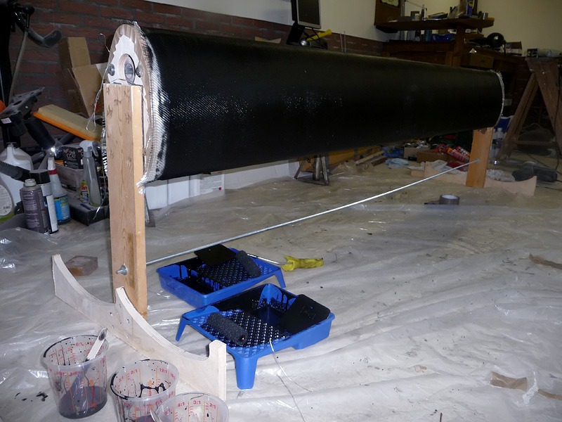

I've first soaked the enclosure in epoxy, and after that, while it was still somewhat wet, I wrapped the fiberglass matt around and soaked that, working up the layers wet in wet, look at a few boat building tutorials, I sure did. After it was completely soaked I wrapped it real tight in household plastic foil to keep it's shape. After curing I could cut off the excess matt and it stayed nice and tight following the curves. The outside was shaped due to the tight winded plastic foil... a bit rough and with folds from the plastic as an imprint...
I sanded it to get a rough structure for the next step.
Around that first layer, I used epoxy with microballoons (glass bubbles) to thicken the mix (much like creating a filler substance) and added a couple of layers of that till I got the finish I wanted. I used rollers meant for boat building, the regular foam rollers would implode when using them with epoxy (it heats up as it cures).
I won't tell how one of them fell out of my hands when exchanging the left/right arrays and I had to redo a cracked epoxy bottom end .
This was 2 layers, I think I did 3 in total. 2 Years ago, when I placed the filters in my arrays, I re-did 2 outer layers with microballoons.
Over the years the wood had left enough imprint to see the cuts etc. as can be seen in this post.

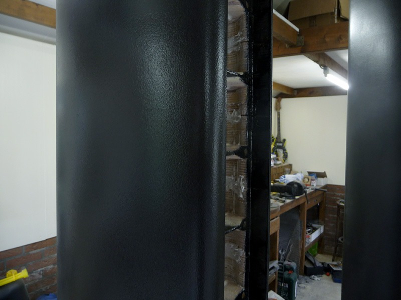

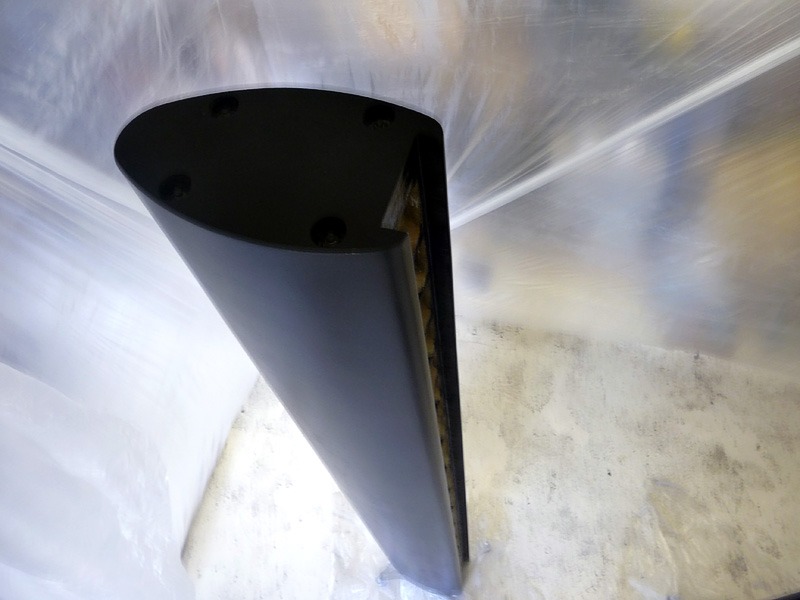

I used boat paint on top of the epoxy, to make it UV proof. A 2 part coat, at least 2 layers. (I used this both times)
Quite a bit of work, I almost forgot, one more note to add: I sealed the inside with epoxy too, at least 2 coats with white color added so I could see the coverage was good enough. The only picture I have of that is when I used it as a wine rack just before the Christmas season:
I finished them shortly after... the outside texture looking like this:
Depending on thickness of the epoxy/microballoon mix and the roller used. Even the speed of the application did have some influence.
I was after this look, as it would hide small imperfections. The paint is silk gloss. I did my subwoofers using the same paint treatment:

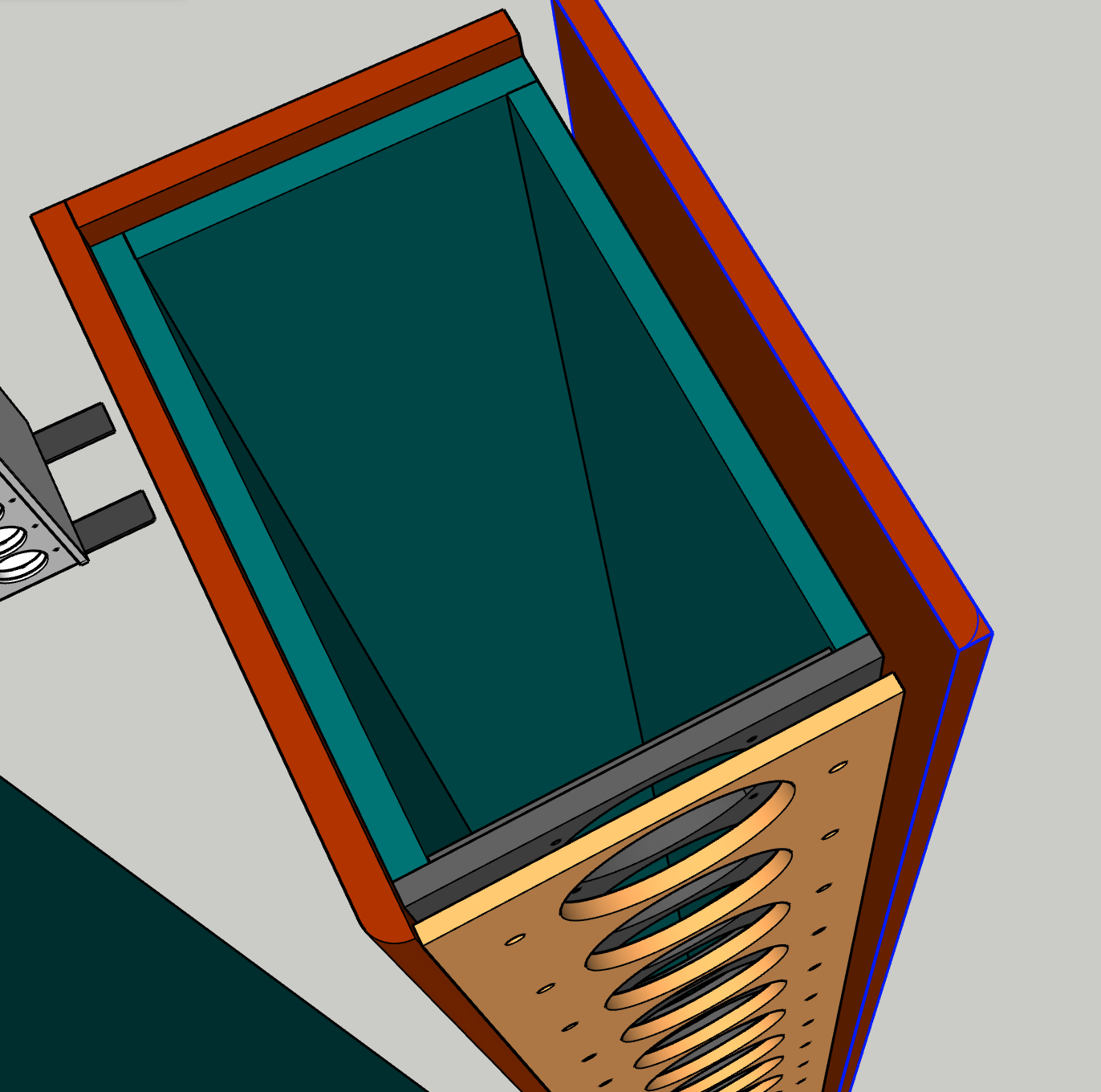

I had to go back to the box format. Just couldn't make the economics of the layers work, it would be more than double for materials and CNC time.
Here is a cross section of the final. First pic is the add-on panels for bigger roundover. Second and third show the box layers.
Trying to decide if I need more bracing, maybe triangle cuts along the corners?
Considering things like a layer of ram-board (thick solid flat cardboard like material) with damping glue lining the inside with felt lining then rockwool.
Also could add another 1/2" thick panel on each side to make the whole front wider, and have more roundover. Would attach it with damping glue. For now I'm waiting on an updated quote from my CNC folks.

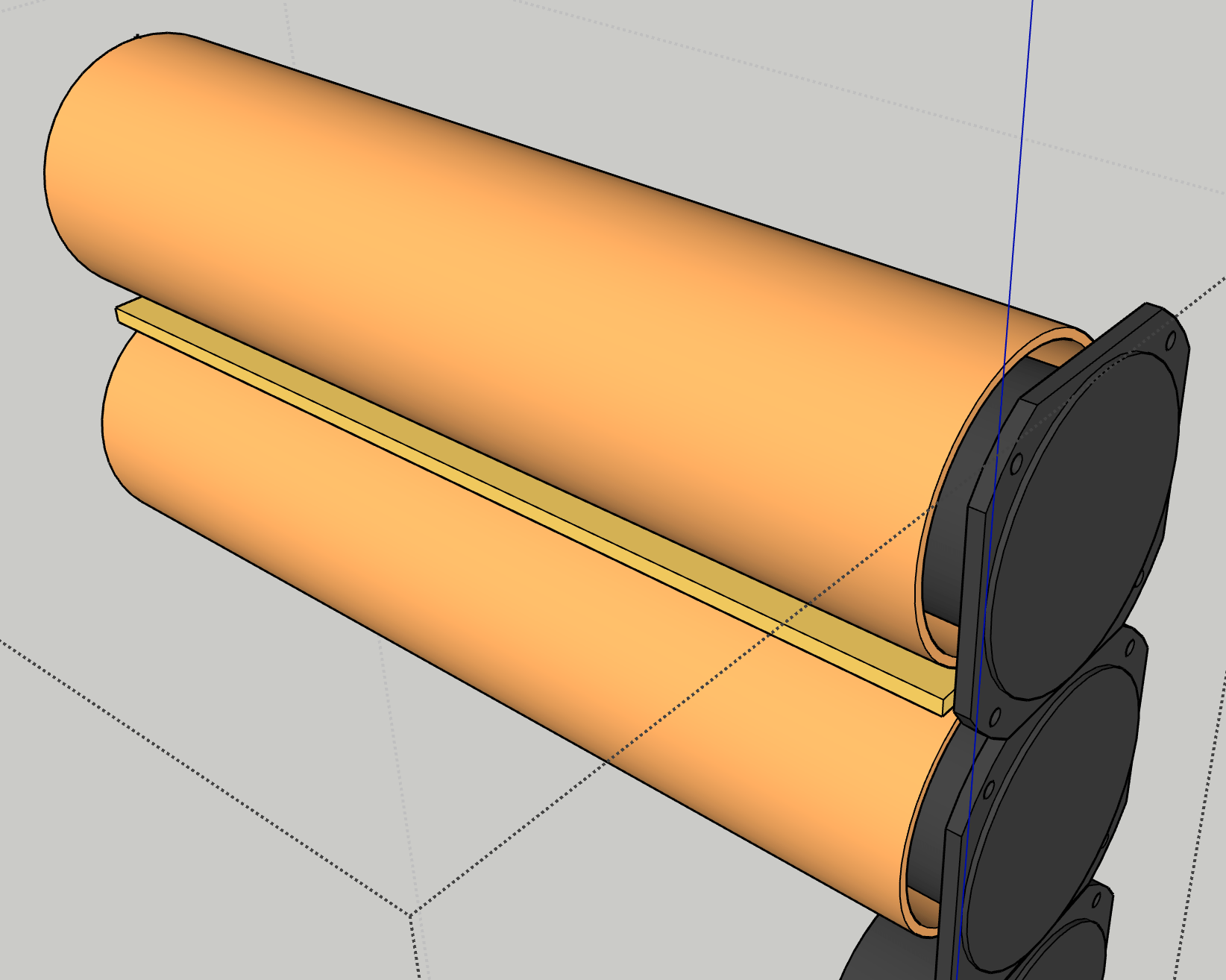

Anyone have thoughts about using thick cardboard tubes behind the baffle? I've found 3.1" OD x 12" tubes (0.1" thickness), which would yield 1.3L volume. The driver spacing is 3.3" CTC. There would be just enough space for a 1/8" ply spacer between them.
I'd line them with felt for the first 6" then progressively stuff them ending with some 4" of dense rockwool.
My understanding about cylinder shaped enclosures is the rear surface is the most problematic, but with enough stuffing wouldn't it be just a "black hole" with little to no return?
It could also be made aperiodic with a thick fabric instead of a solid material at the end, that would solve that resonance issue? Any thoughts? I've used this driver in the XRK style "dagger" 3-sided pyramid and it sounded much better than any box i've tried it in ever since. That triangle pyramid shape isn't feasible with the line array spacing.

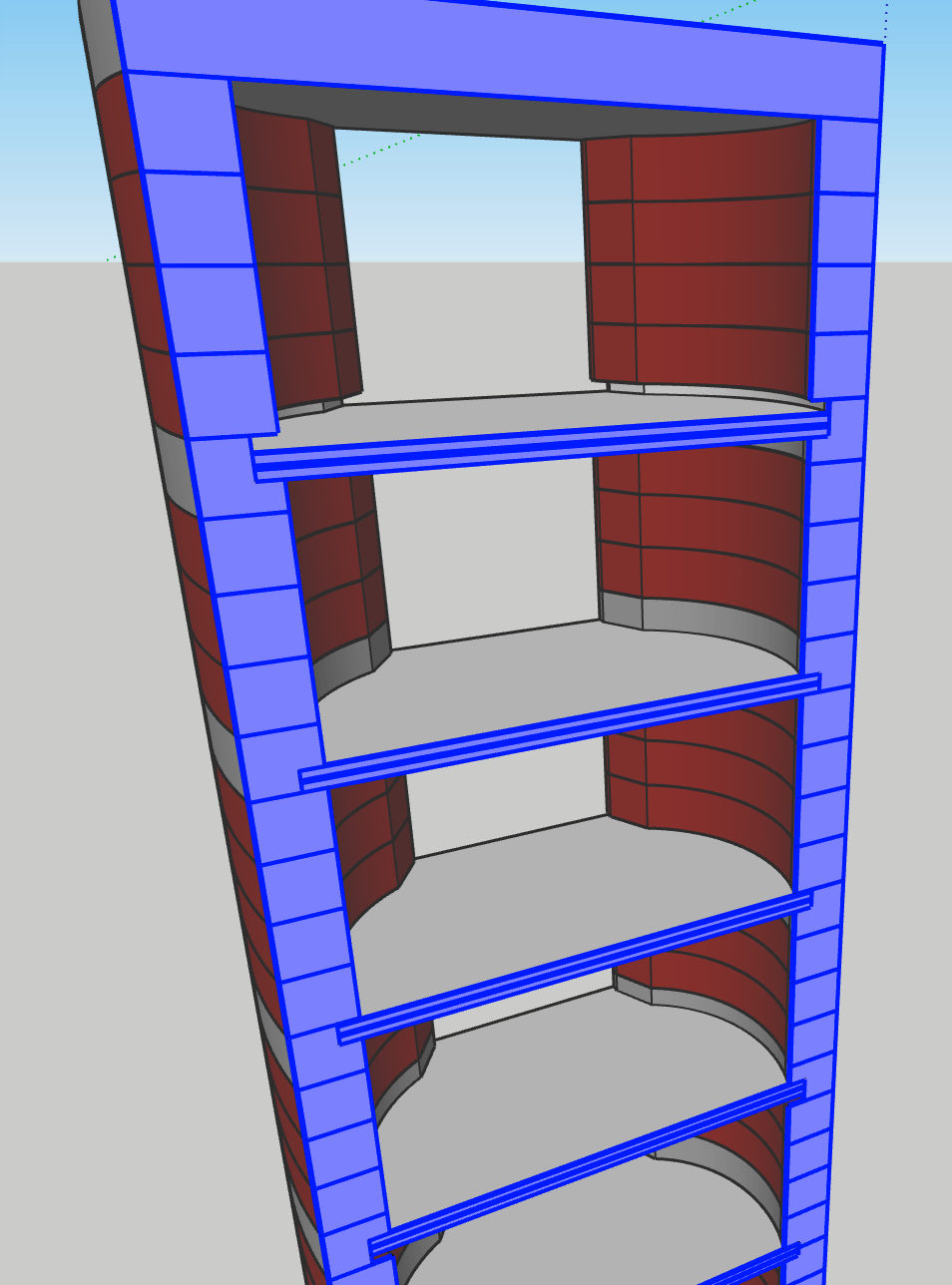

Ok, long dormant but I have cut some wood! Hoping to have the inner portion of the towers done today or tommorow and I'll post some pics.
Meanwhile I'm looking at whether I should try to include some form of "constrained layer damping" between the inside and outside panels (between teal and red panels). I've read a bit but its confusing as to whether elastic silicone adhesive will be sufficient, or whether I'll need to seek out "GreenGlue" Other places have suggested a layer of plasticine/plastilina clay, which is a non-drying modeling clay. I found some at michaels and its similar to what we used to call "fun-tack".

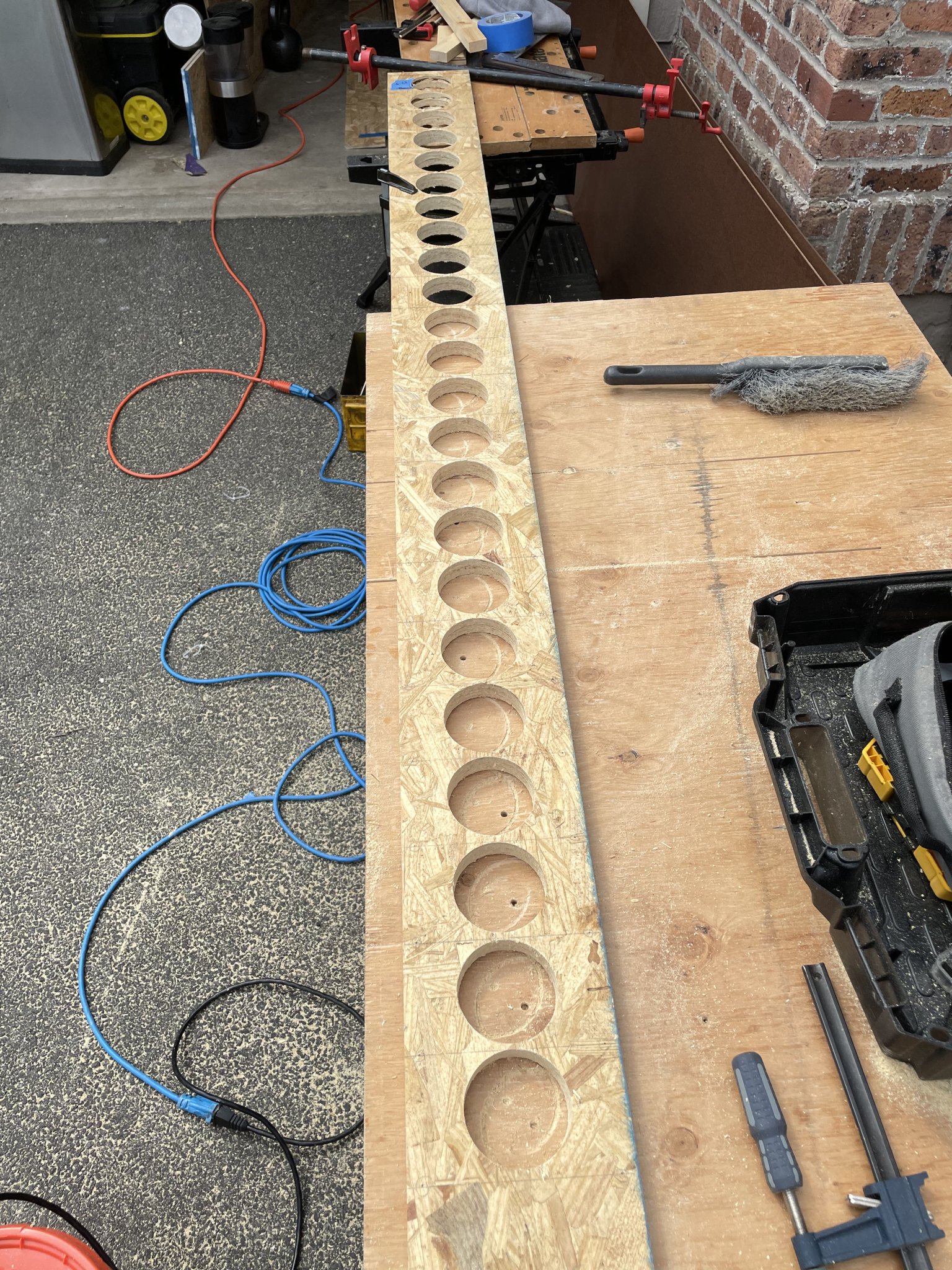

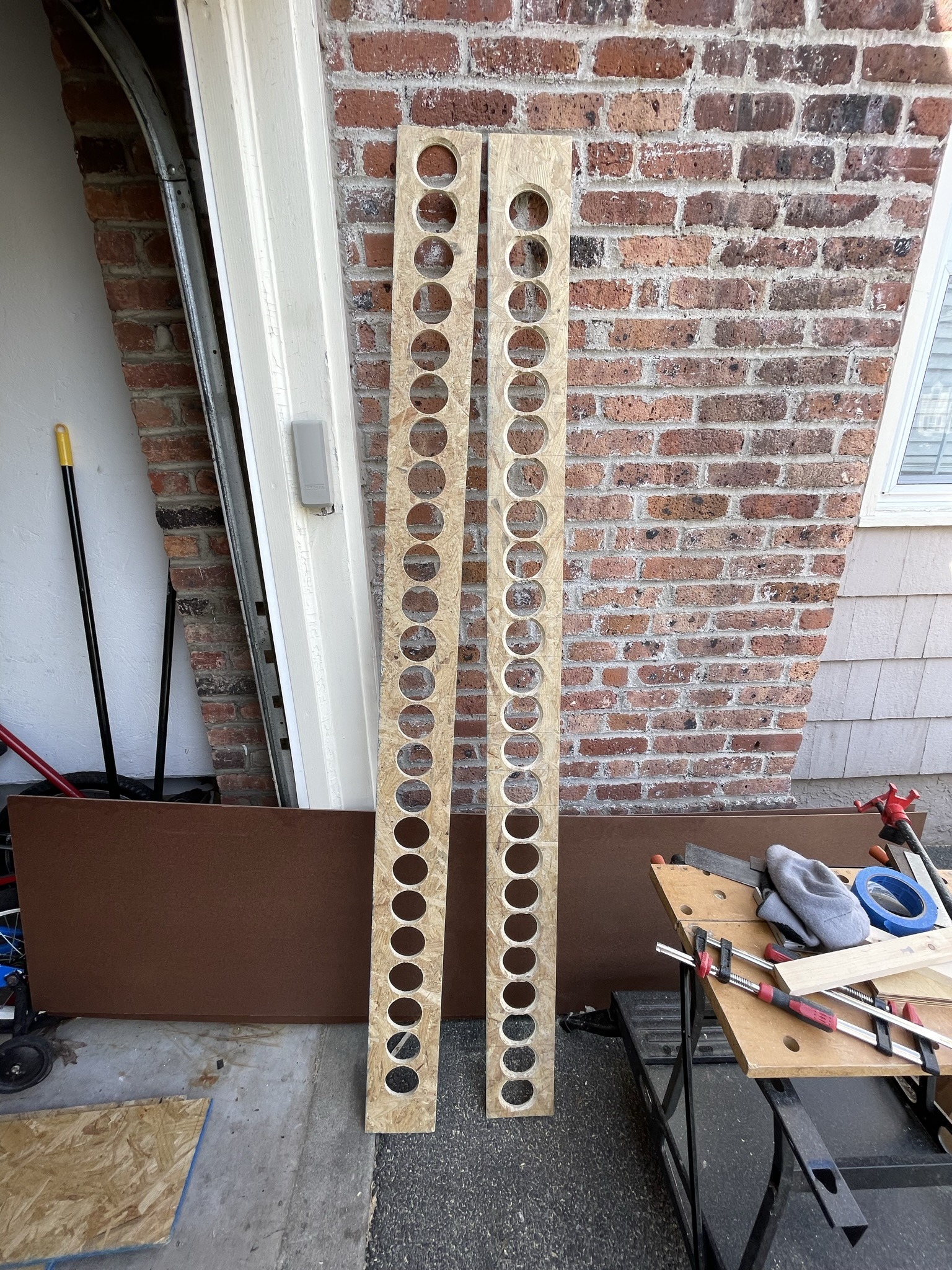

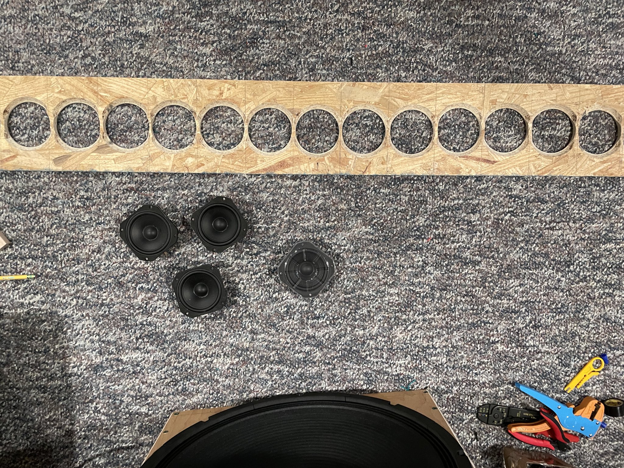

Wood has been cut. Inner layer and inner baffles are cut. Checked fit with one baffle, only 3 spots where I’ll need to fix the cutout by 1/8”. Honestly much better than I was expecting.
Next steps are chamfering the second baffle cutouts. Then routing slots for the shelves on the inside walls.
