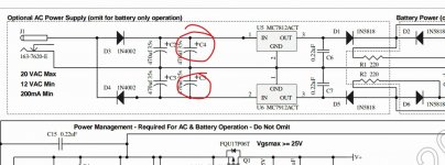

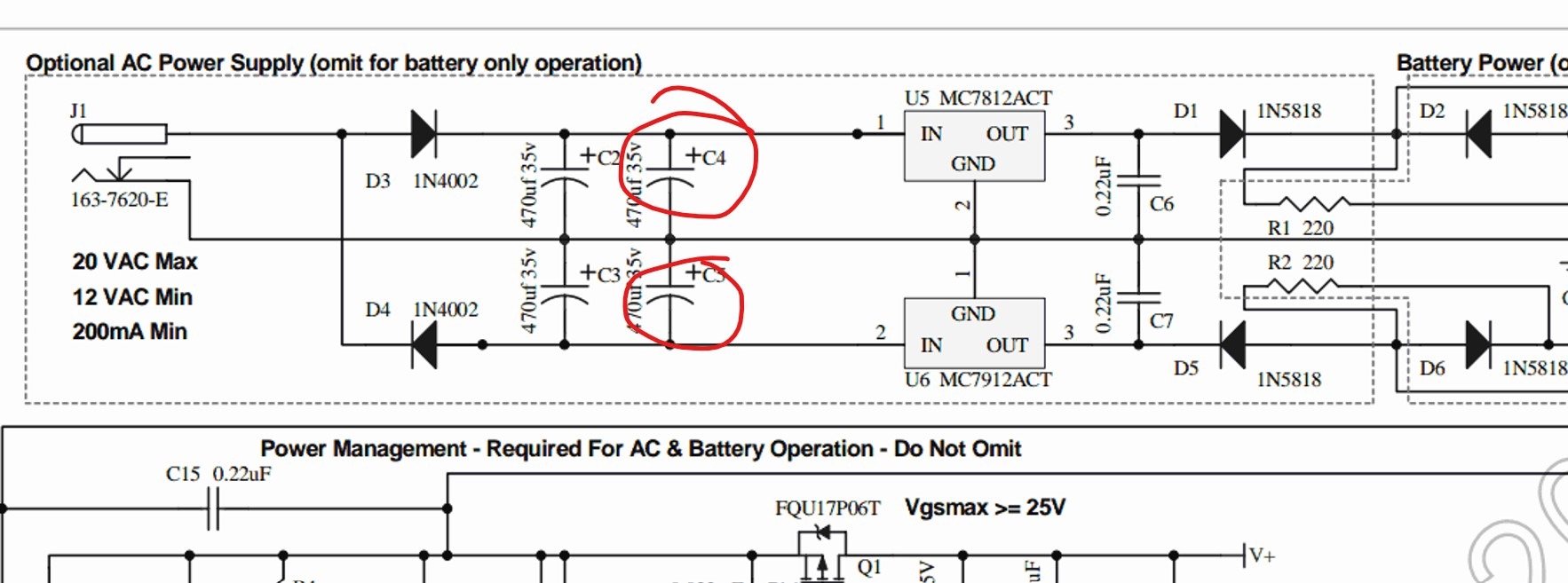

If the pins were touching it is more likely something in front of the regulators has been damaged. Check the voltage across these caps first. You need at least 18 volts DC across each.

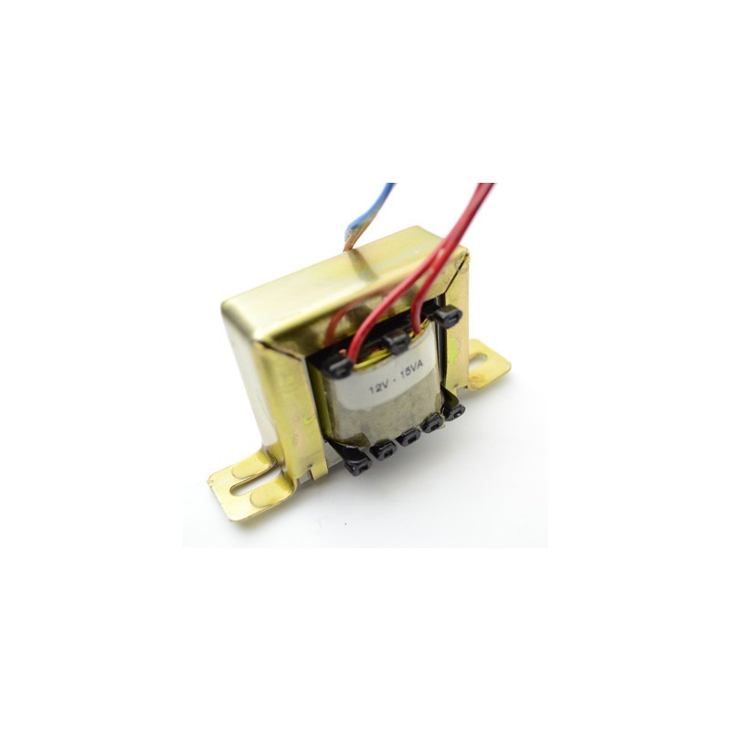

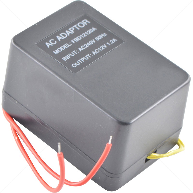

I use 12V AC adapter salvaged from old an Creative speaker.
12V AC after rectification and filter gives 12X1.41 gives approx 16.91-0.8 = 16.11V DC which is well above the 2V drop requirement of regulators. Usually, 12VAC gives output above 13V AC at no load. O2 presents a very light load to any transformer

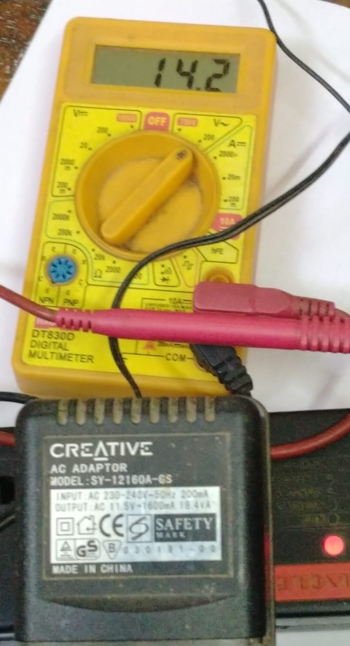

Please see attch., 11.5V AC old dusty Creative adaptor, but actual measured voltage is 14.2V AC. I have many such salvaged 12V AC trannies with o/p no-load voltage between 13-15VAC. 230V AC is standard in our country, but actual measured voltage is between 235-240V AC
