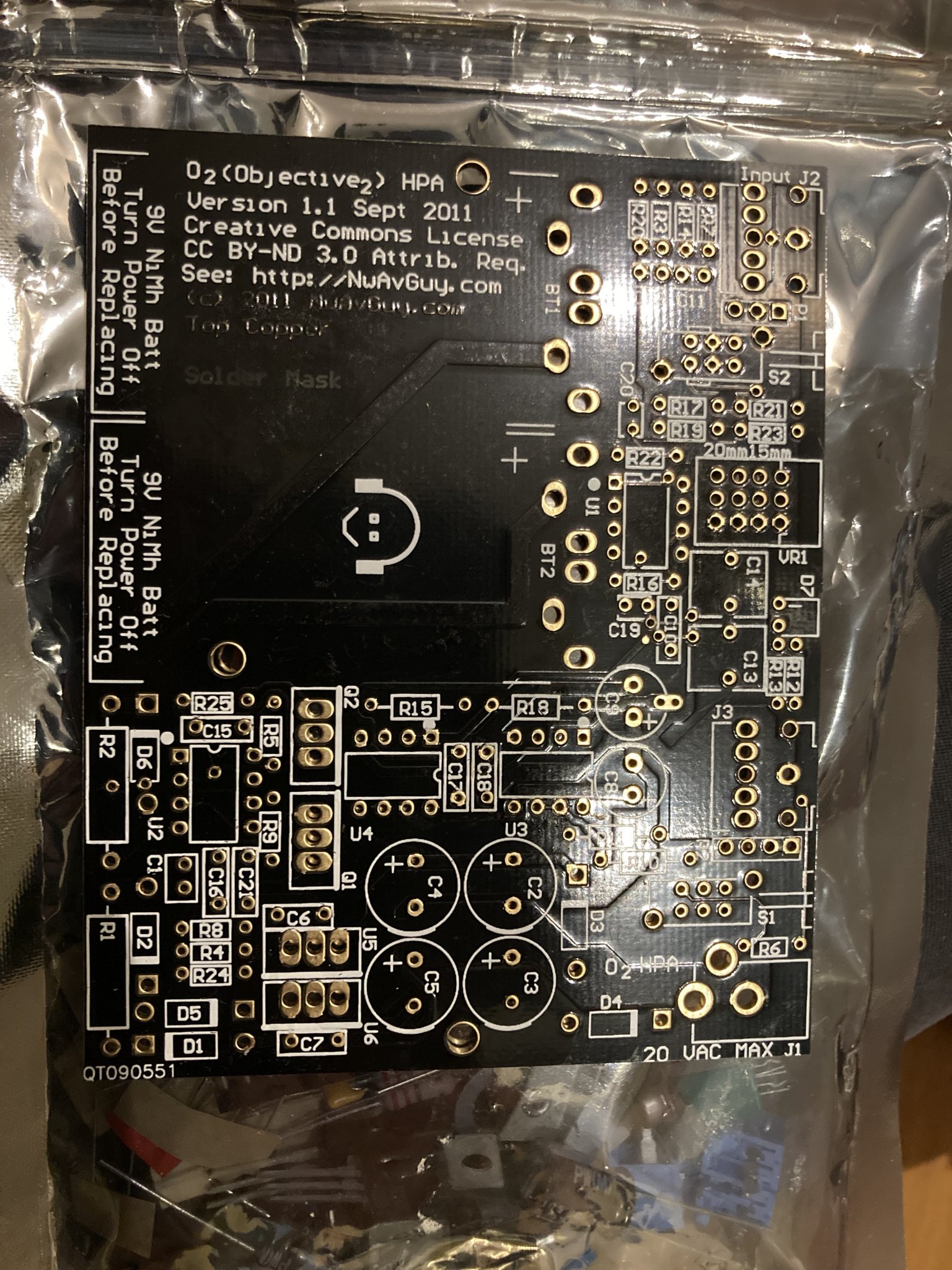

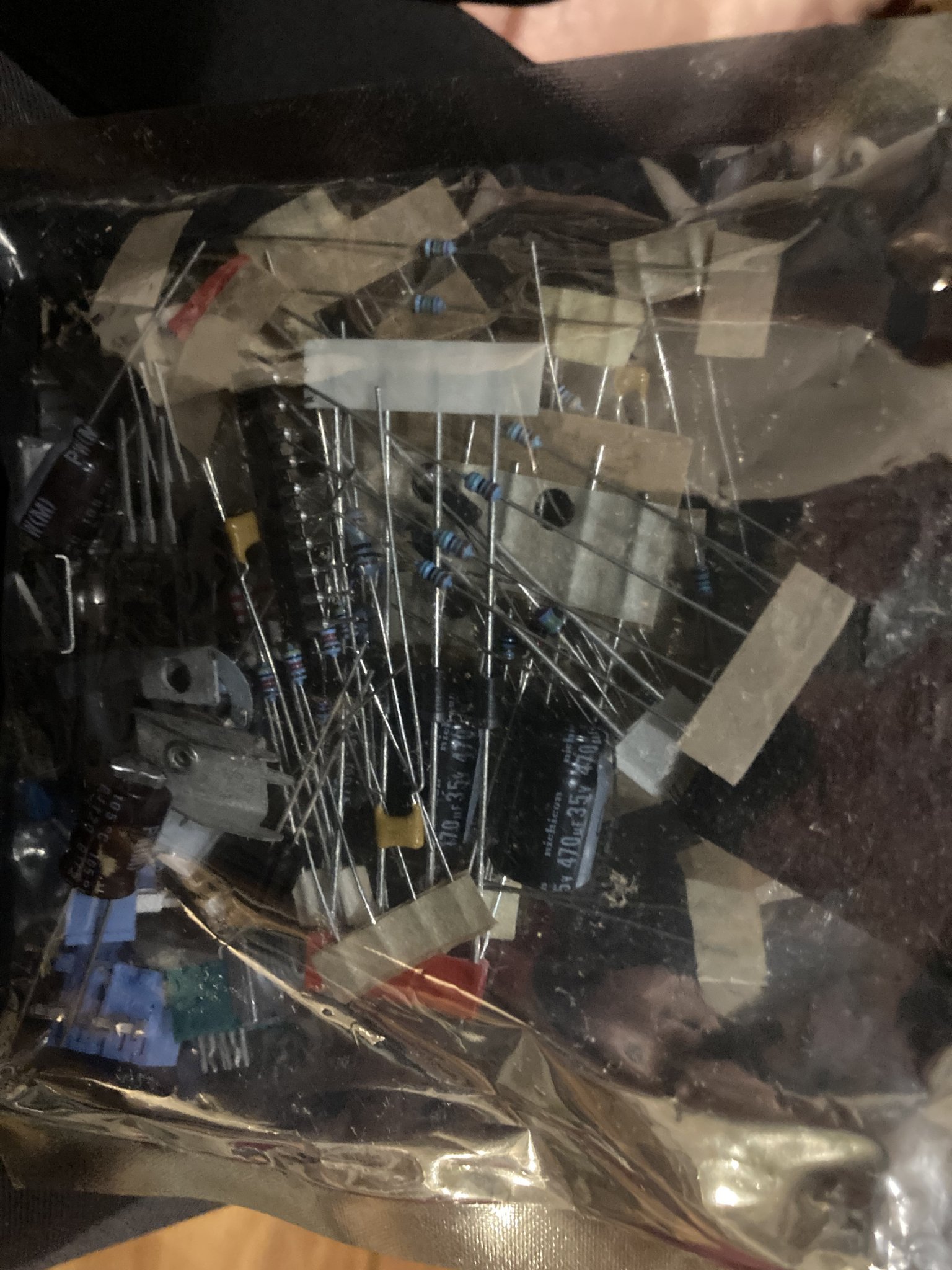

I was rummaging through my parts bin and found an OG set of parts and v1.1 PCB!
I had bought 3 sets of everything and built myself and a friend one of these amps and then forgot I had another set.
This was back when Nwavguy was still alive and kicking and I think the PCB has had some changes since.
Is this worth anything? I still have my original and it still works a treat with my HD600s
