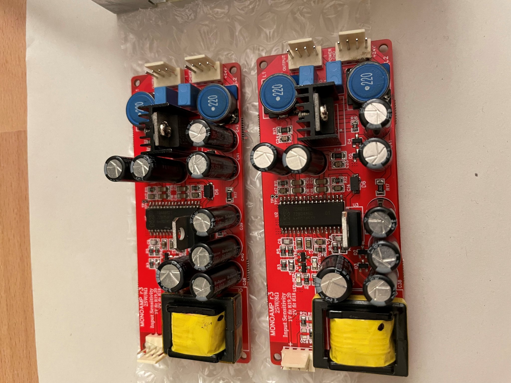

I've finally been able to assemble my mono amps r3.😊 And what can I say, they sound really good. Not at all like other Class-D chips I know. Very warm sound. I can really recommend these things. Many thanks and respect first and foremost to Richard for your efforts. But also to everyone else who provides support and Ideas here. Shipping and packaging were very good!
I would like to use one Meanwell SMPS per amp. A DCDC converter should then be attached to one of the SMPS, which should supply an ADAU1701 board with 5VDC. Signal source would be a Iphone5s. Now to my question: Should everything have a common ground? Or should I use an isolated DCDC converter for the DSP? Signal ground has to be connected anyway...

With transformer isolation as at the input to these amps, there could be hum if the primary is allowed to float with respect to the amp's 0V. So I would say don't bother with the isolated DC/DC. a normal buck regulator will be fine.

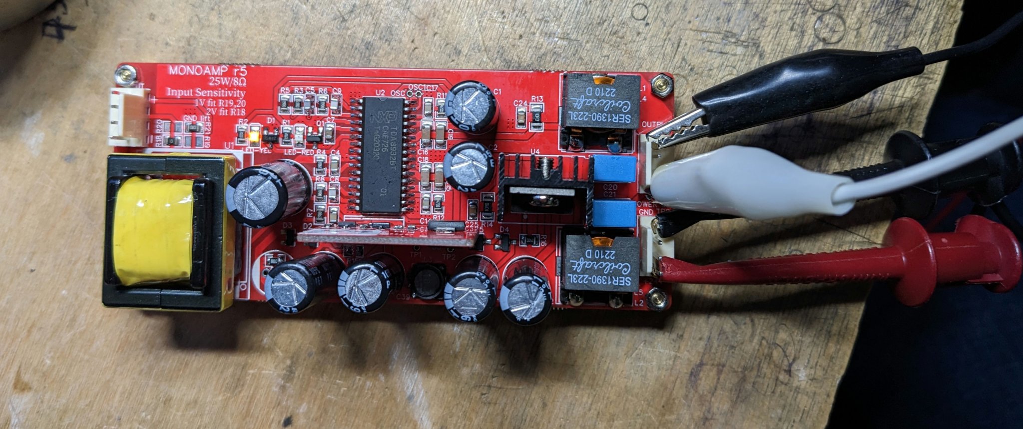

Hi everyone...a little late to the game here but assembled the two boards and did a power on test with an 8 ohm load on outputs and 12VDC then 24VDC powering the board. Using the shunts instead of LM317s. Yellow lights on both boards! Waiting for a chassis to get them fully assembled and test with music. What a fun little amp build. Hoping for not your typical Class D sound. Thanks Richard!

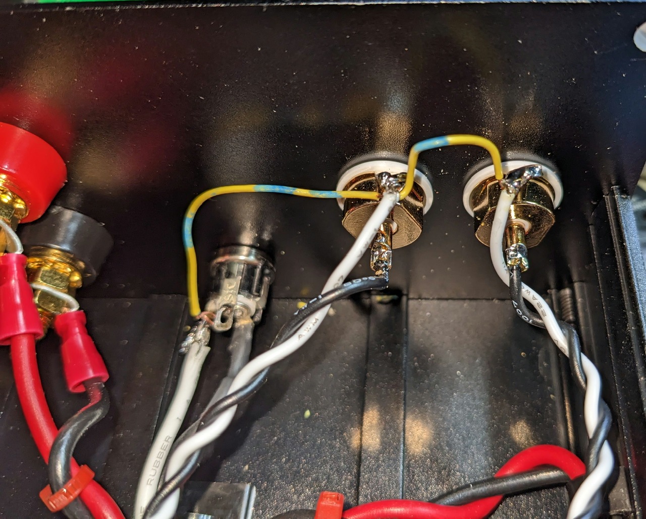

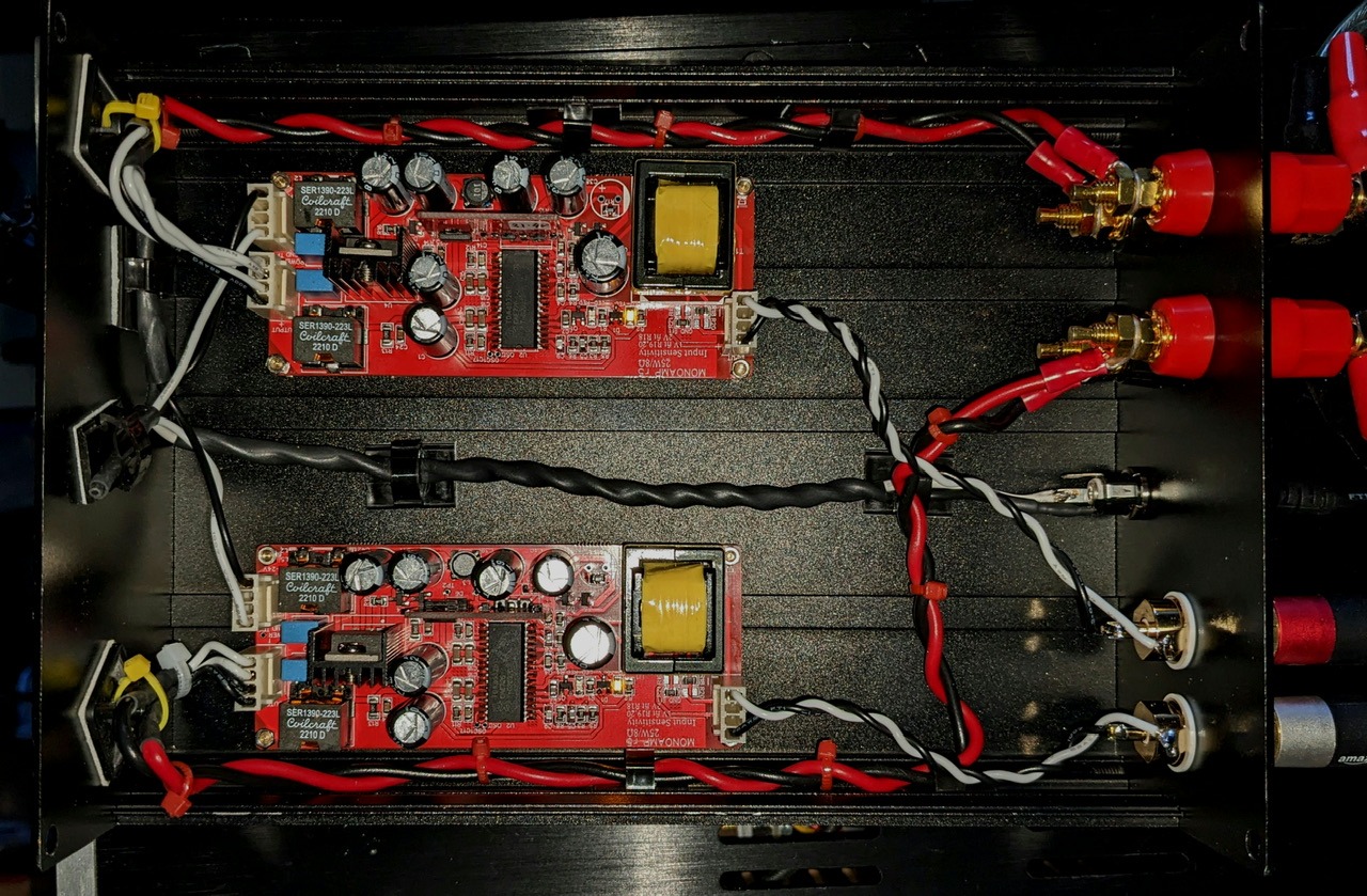

Finished assembling boards in the chassis and powered it up with a single 24V 2.5A power brick. No hum or obvious noise out of the speakers. Didn't measure any appreciable mV DC offset out of the speaker outputs either. Listened for 30 min then grounded the signal input grounds to the 0V of the power input. Might have made the HF signal a bit cleaner but that could be a biased observation. Very nice soundstage with no muddiness even with my preamp that only has a 10uF film cap as a DC blocker on it signal outputs. An airiness to classical music not heard with any other Class Ds but we'll see after I hook it up in my main listening room. I'll keep it on the test platform for a few days yet.

Pictures aren't uploading for some reason. Will try again later
