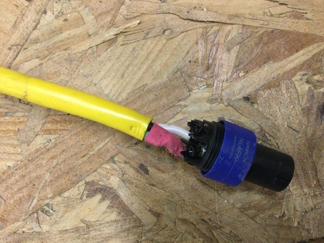

I use #12 extension cord in violent florescent colors for my speaker wires. I use a 4 pole speakon.
I connect the third wire to the 2+ terminal of the speakon. That way can wire a speaker internally +1 to +2, and then set the amp to bridged and it will work.

That’s still a valid use for the extra conductor - ease of use without swapping in the field. Wire them that way and have three (or 4) jacks on the cabinets. One wired for 1+/2+ and the others 1+/1- for non-bridge and/or daisy chaining. It’s not like it sitting in there chopped off and no use at all.
IR drop is a concern or you would be using 16 or 18 gauge wire. You simply deem a single run of #12 “good enough”. It is, but if that green wire isn’t doing anything else I’d rather drop the R that little bit more.
I use 4 pole speakons on my #12’s because it doesnt fit thru the backshell of an NL2FX. #14/3 does, and I have plenty of #14’s too - in fluorescent colors because often those fluorescent extension cords are on special sale cheap - and color coding bass, mid, high makes sense. I wire everything 1+/1- back at the amp rack so the cables are universal, even if the setup changes. When I build a big amp, I put on another pair of speakon jacks wired for bridge. I run little patch panels from the red binding posts to speakon jacks for bridge mode on store-bought amps. You just need a convention and stick with it, whatever it is.
At 90 feet, I am not worried about the IR drop of a #12 vs two in parallel on one leg. The 2+ leg allows all my cables to be used for any speaker, only a cab defined for bridged use will connect to 2+. Granted, if the amp is configured stereo, the sound coming out of a bridged cab will be rather interesting.
As you say, define a convention and stick with it.
The primary reason I bought the wild florescent cords was to prevent confusion over who owns it, being #12 was my minimum requirement for neutrik 4 poles. The sound guy at work only had black cords.
