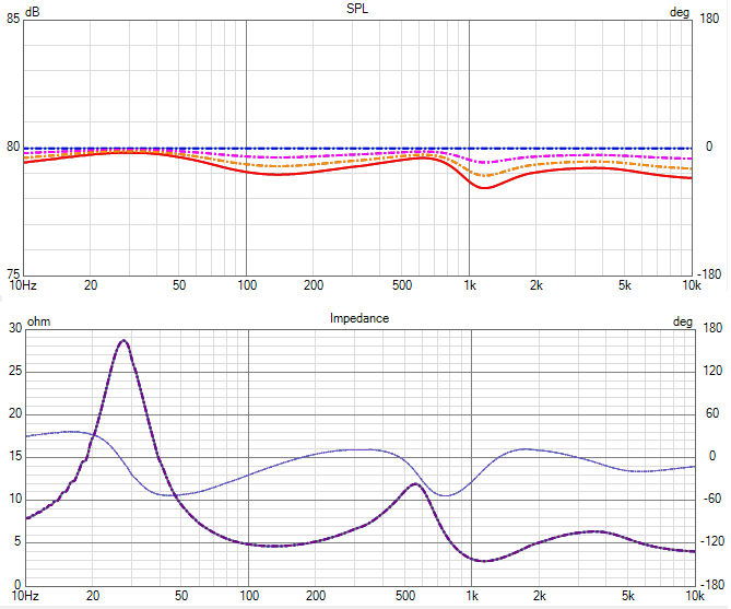

A random example, response deviation for source resistance up to 0.6 ohm.

Well I did try, but my reading was zero; or more accurately the same as the resistance of my shorted test leads, 0.3R
Book resistance of domestic flex of this size and length is nominally 0.05R and I am assuming this is negligible and it's only going to take 380 Watts maximum and that's too loud to be pleasant anyway
If it's copper and it's thick enough (as domestic mains flex is), then the reistance of the cable is indeed completely negligible.
