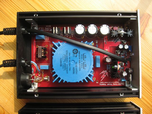

Encouraged, I built the PPA project with a Young-Jung power supply. The enclosures for both the amplifier and its power supply are from modushop.
On first power-on the amp oscillated at 12 MHz when connected to headphones. The oscillation was inaudible but clearly visible on a scope. A quick look at head-fi.org showed that PPA instability is not a new problem. I reduced the value of R11 (see PPA's schematic), which eliminated the oscillation and improved the sound. I replaced the recommended OPA627 with LME49710.
