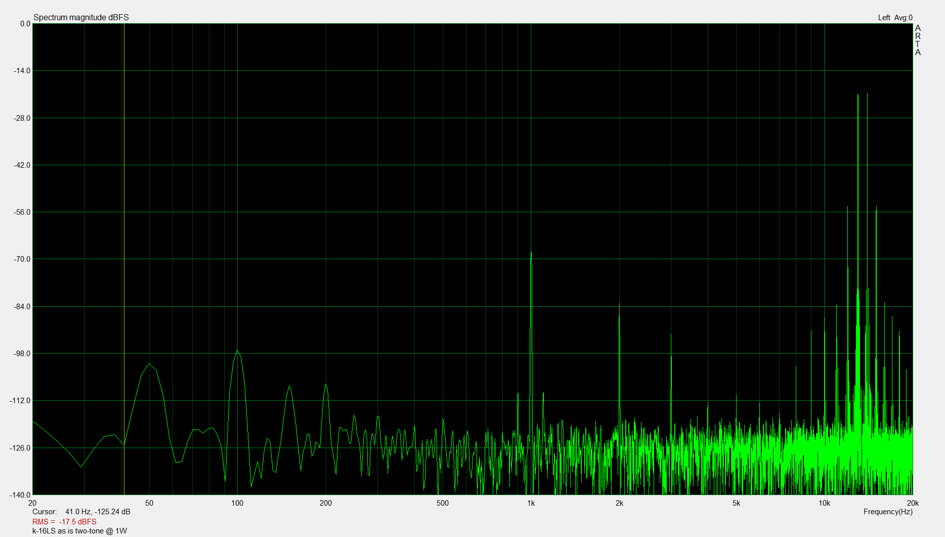

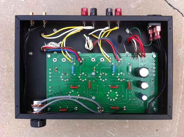

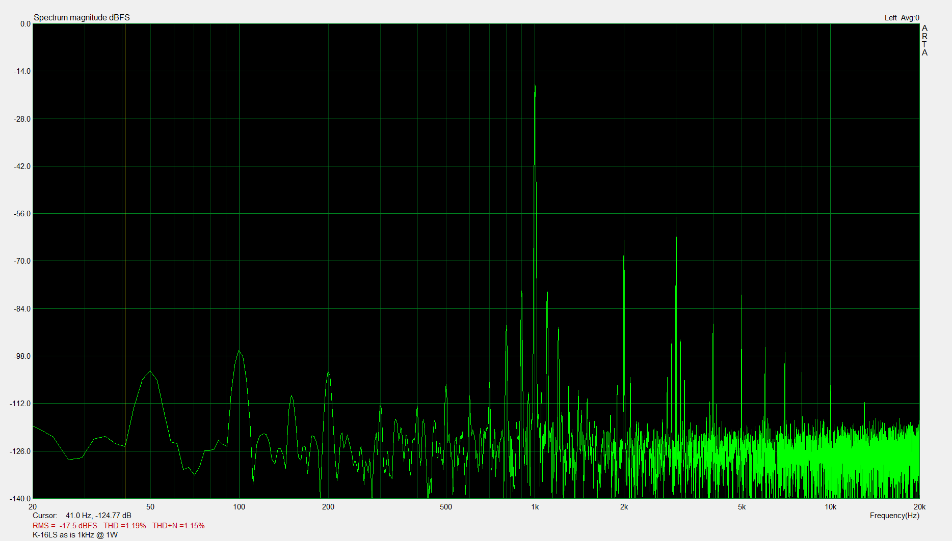

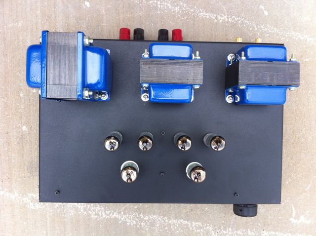

S5 Electronics "L" series tube amps
Posted 12th August 2010 at 04:52 PM by alexcp (My DIY projects)
Updated 5th May 2015 at 12:38 PM by alexcp
I started with a Model 8LS stereo amp from S5 electronics. Later I put it into a Hammond enclosure and replaced the tranformers with Edcors.
Separately, I built a Model 16LS, which is the same thing with a doubled output stage, giving a very similar sound. Both use a 5670 double triode in the voltage amplifier and phase splitter, and 2x6005 (4x for the 16LS) in the PP output stage.
Both versions are very easy to build, nice with vocals, but not quite HiFi - see the FFT charts. Matching tubes and the resistors in the split-load phase splitter circuit helps to reduce distortion.
