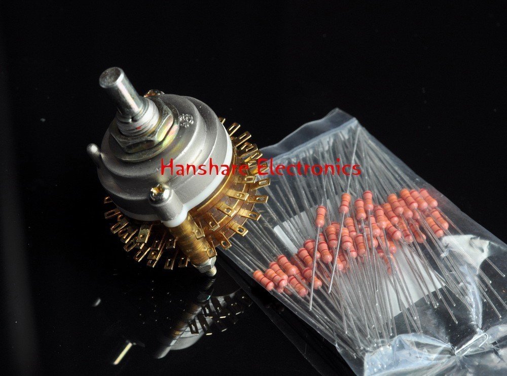

I bought a stepped attenuator (actually, two of them) from ebay seller hanshare-electronics. As always with eBay, I was a little worried about what would show up.
I'm happy to report that this is a nice job. The included resistors are clearly labelled, and the documentation, while spartan, is sufficient.
The only negative is the rotary switch is a bit "clicky". Better quality units I've seen are more damped.

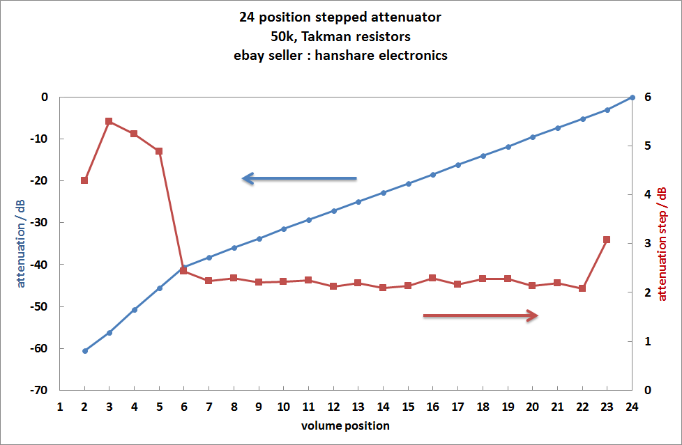

On the positive side, though, the resistor values are very elegantly selected, to give a smooth response of about 4 dB per step from -60 to -40 dB, and 2 dB per step from -40 to -3 dB. Having been-there, done-that, I can say that I'd happily pay the asking price to get those resistors sourced and sorted for me. Next time, I'd also pay to get it assembled. Soldering was more painful than I imagined it would be, and the pre-assembled units much neater-looking than what mine ended up as.

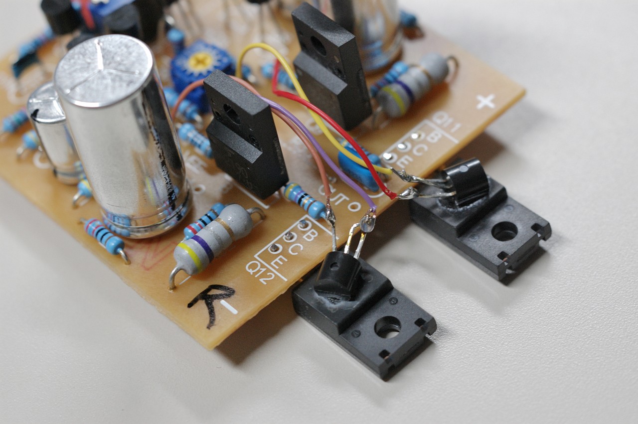

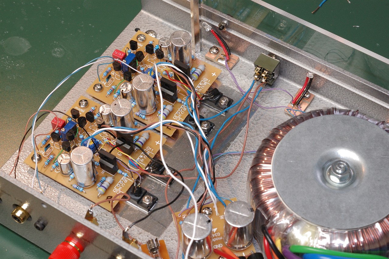

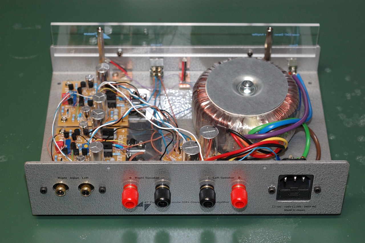

And not even sure what a tribulation is, but I'm sure I've had at least one building this amp.
Like the 0247 it's not so much difficult as it is painstaking hard work. The output transistors have to be mounted "just so" so the boards screw to the case properly, the wiring of the thermal protection transistors and gluing them to the output devices is tricky and easy to mess up.
I triple-checked and was rewarded by, it seems, error free boards. I messed up and wired the mute switch incorrectly though (the photos show it wrong, in case you come across this blog post looking for help) and I think the switch has a fault somehow as L and R channels appear to me mixed together. Taming the offsets gave me considerable grief but I think its all OK now.
Tomorrow I'll hook it up to the speakers and see what happens.
