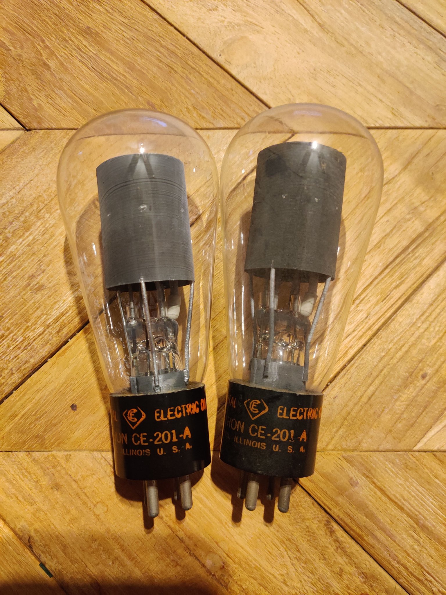

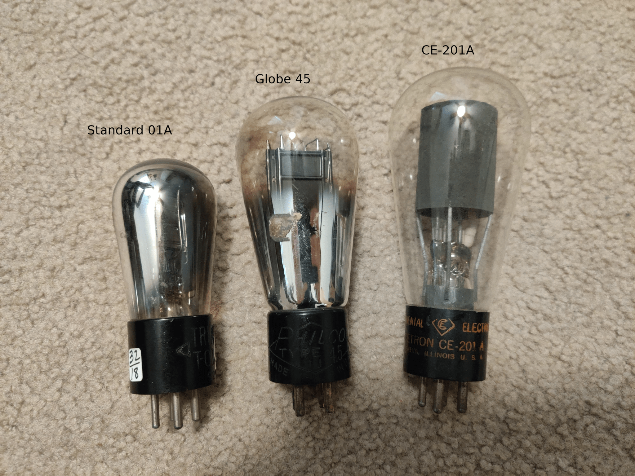

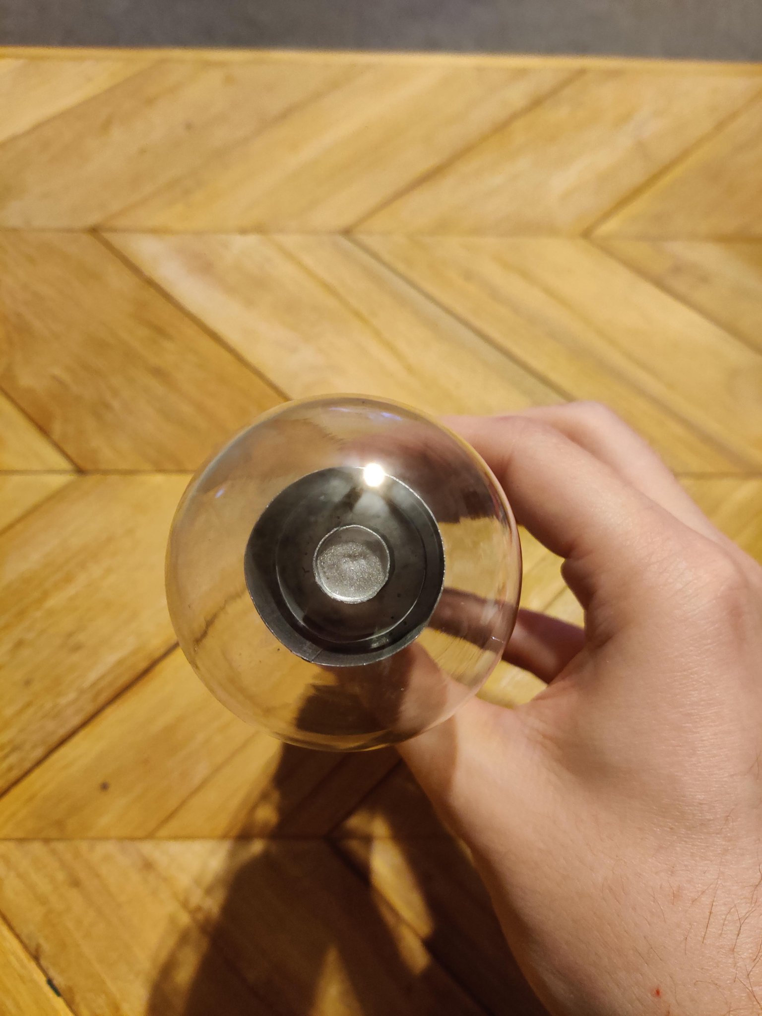

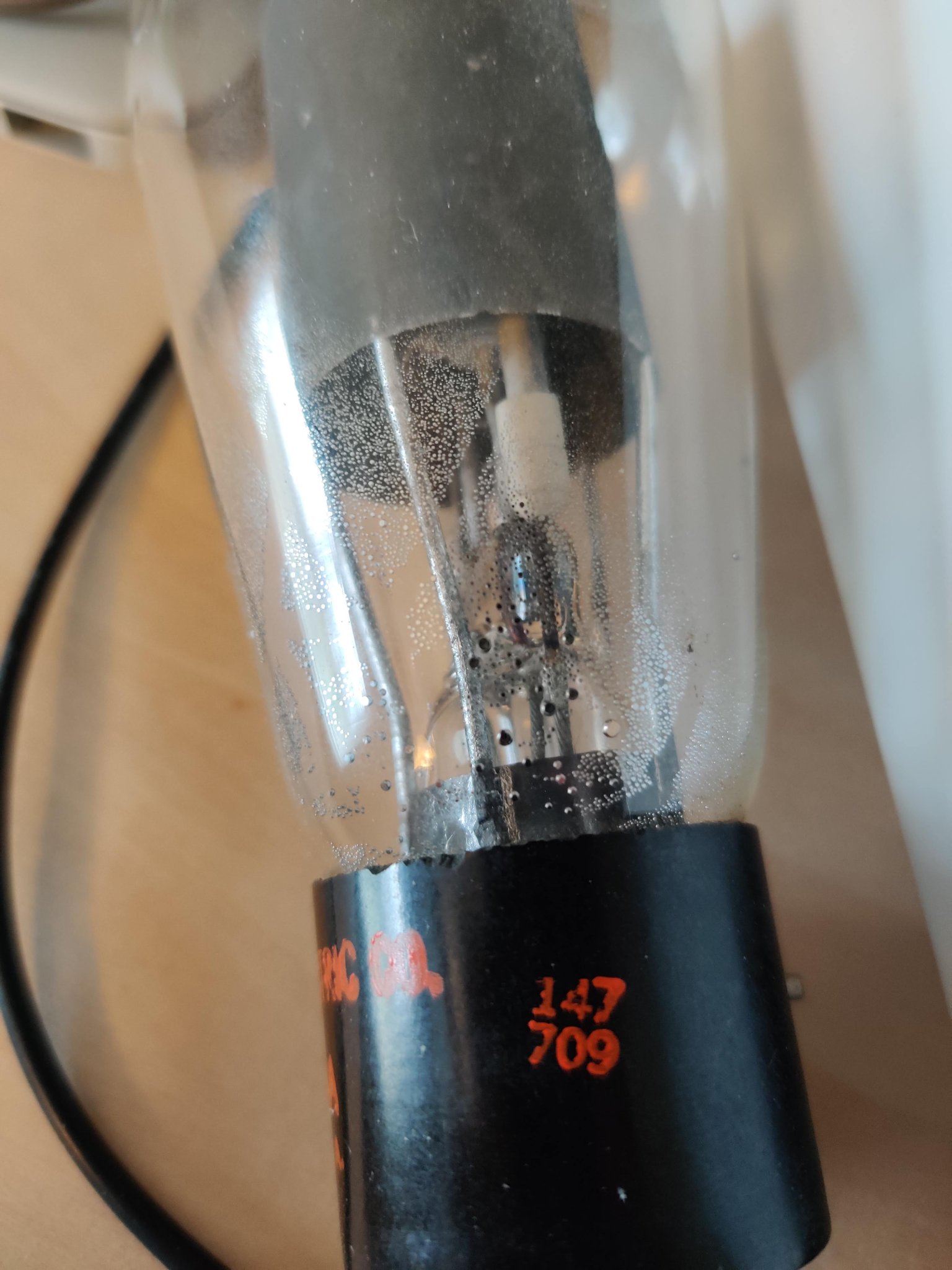

Hey all, I have a question akin to the original question this thread was created for. A while back I bought a tube lot that had a pair of the weirdest 01A's I've ever seen. They are labeled as "Continental Electronic Co. Cetron CE-201-A". They are globe shaped, but are MUCH larger than standard globe 01As. They are even larger than my globe 45 tubes!
They also looked like they had condensation inside them, so for a while I just assumed they had a crack somewhere and were dead. However, looking at them again, that "condensation" is actually little beads of metal. I can get them to detach from the glass if I flick the tube. If I didn't know any better, I'd almost say that these are actually mercury vapor rectifiers. But I can't find anything online about these since they're labeled as 201A, and the only results I can find are for standard 201A tubes.
Attached is a few pics of them, as well as one comparing it to a globe 45 and standard globe 01A. Does anyone know for sure what this is?
IMG_20221222_082337_labeled.pngIMG_20230326_084404.jpgIMG_20221222_073539.jpgIMG_20221222_073605.jpg
You can do a couple of simple test to determine if they are or not vers of 01A.
Need a LV PS of abou 6V, One Amp. On the heater / filament terminals apply LV thru some kind of limiting restor
You can do a couple of simple tests to determine if those tubes are or not some vers of the 01A. Or DOA.
You will need a LV PS of about 12V, One Amp. I keep a discarded but still good auto battery under the bench for these kind of tests.
On the heater / filament terminals apply LV thru some kind of limiting resistor like 50R. If the filament is 5V, 0.25 A a VM across the filament terminals will settle at something like 3.5-4V. If the VM indicates much lower the tube is probably gassy & can’t warm up. Or might be a Hg rectifier.
If the tube passes that test, then apply 5V thru a suitable resistor to the filament. To check for gas apply ~100V thru a current limiting resistor of 100K to the plate while the grid is tied to the filament. If a VM connected to the plate settles at 8V you have a gas rectifier. Something like 50V might be a good indicator, you’ve got a tube that works.

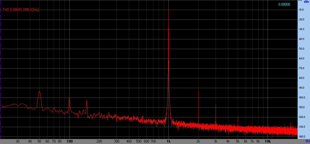

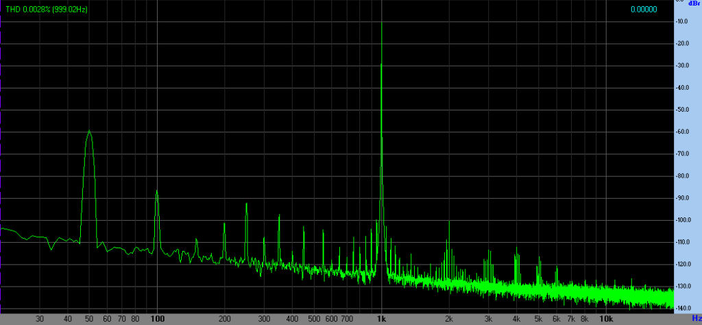

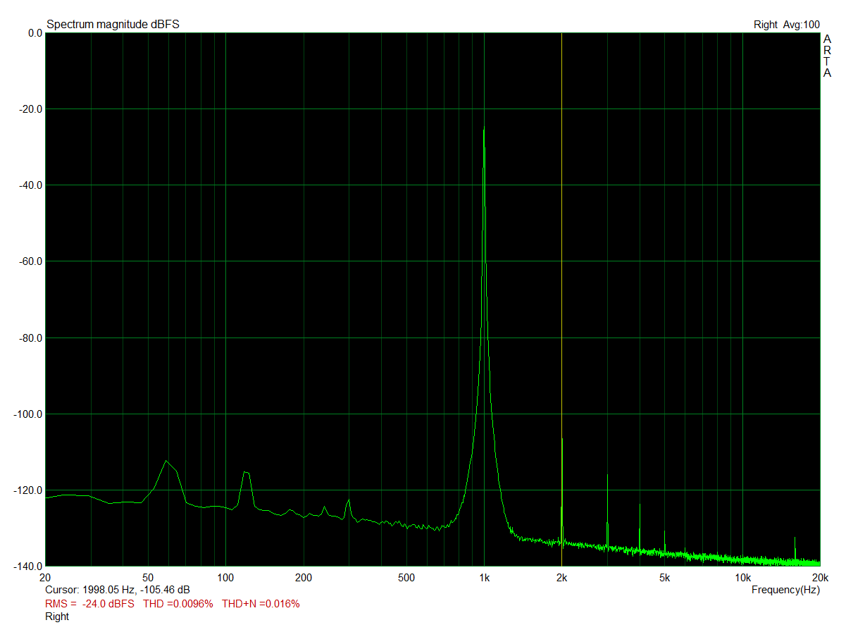

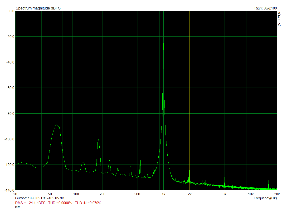

I recently purchased a spare set of RCA UX201A tubes and installed them. Both tubes seem very good and adjusted similarly, but I cannot understand why the Left one pictured shows such a high 60hz peak. All the other tubes I have do not exhibit a peak like this and show up similar to the FFT of the Right tube. Switching positions between left and right makes no difference. If I shield the tube wiith my hand in a certain way THD+N seems to improve a bit.
Appreciate your thoughts.
Thanks. nash
Thanks Euro21. I see you have run into something similar.
With no music and amps on max volume I hear no hum from the speakers; just the tube rush same on both sides.
Would this show up when I play some low bass music such as double bass? Practically, is it of any significance? Orchestral music played loud sounded just fine. BTW that is a 2v output FFT if that matters' comparing the height of H2 to the 60hz spike.
Any speculation as to why this tube is so sensitive?
nash

In an effort to understand and isolate the 60hz spike issue with that tube I put an aluminum beer mug with a glass bottom over the tube, completely covering it. Kinda looked neat but unfortunately made no difference to the spike. Then I tried putting one of those copper/stainless saucepans over the tube. No difference.
BTW the tubes I have are the late manufactured ones with the nickel pins and shorter black base; I believe made before the switch to the ST type.
nash
I wrapped some foil around a cardboard tube and slipped it over the tube. That made no difference. However, when I grounded the foil, as suggested by you, the 60hz spike disappeared! From a peak of -88db to -114db. Same result when I grounded the aluminum beer mug.
I have two switches on my power supply. The first one only supplies filament power. Switching this on causes most of the spike, switching on B+ increases it a bit more. Moving the tube to the other socket with a separate supply gives the same result. No other tube I have displays this behavior. So it is this tube specific.
Since most of the spike comes when the filament supply is turned on, where is this 60hz radiation from? Is this tube somehow hypersensitive to the very small AC from the filament supply and radiates it? Raw Power supply to the filaments is in a separate box connected by shielded umbilical.
