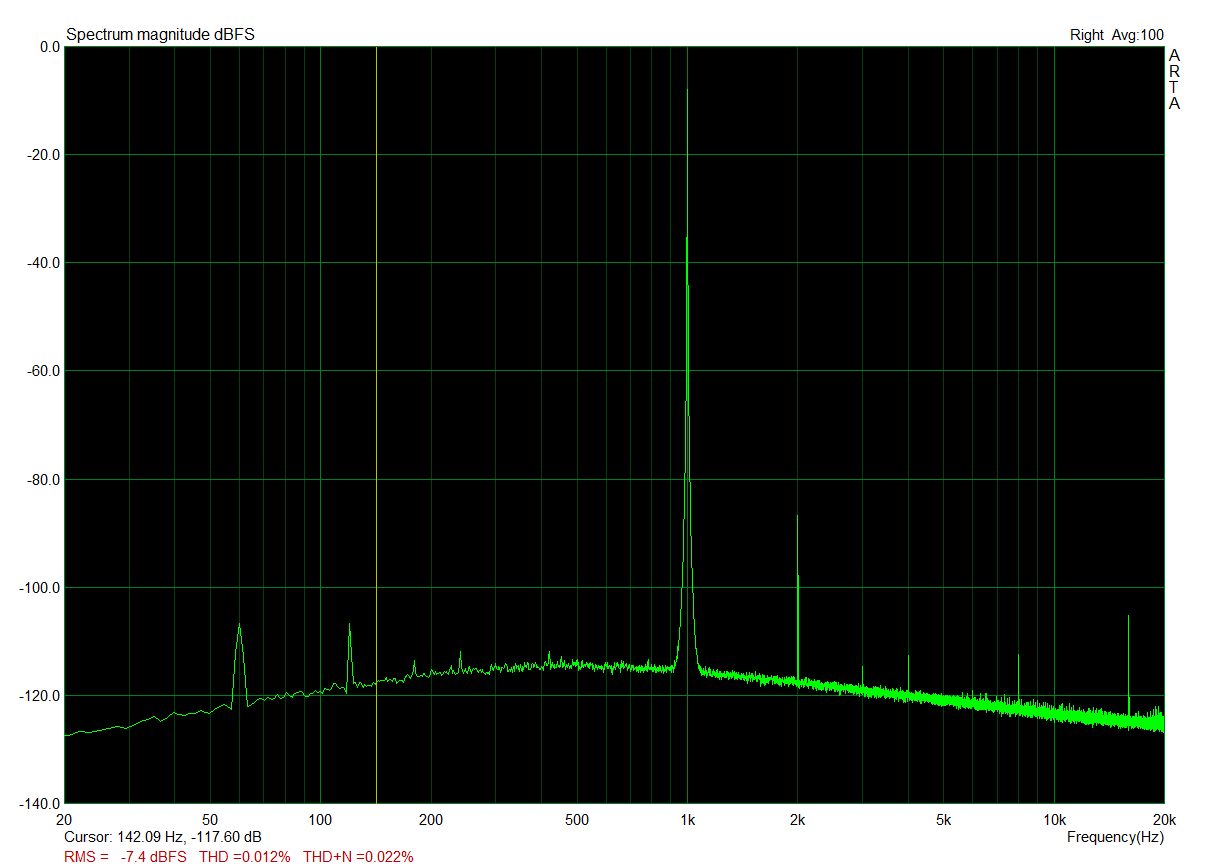

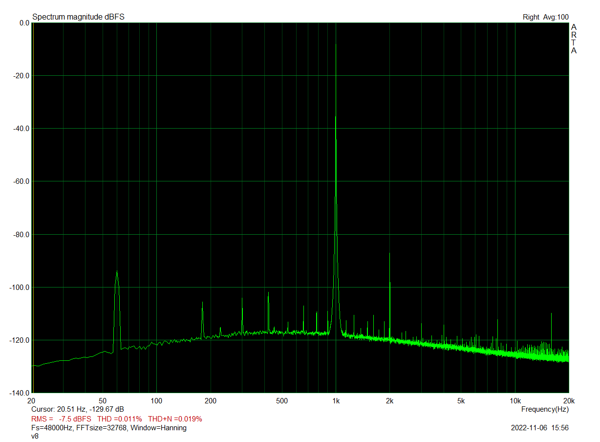

Rod Coleman DHT heater V8 vs. V9
I finally got around to updating to Rod's latest V9.
On my first listen to a violin concerto I felt that there was some kind of change in the presentation of the staging. Subsequently, I realized that the hall/venue appears larger than before, not that the musicians are sitting any farther apart, giving a much more realistic presentation.
Piano notes appeared to have more body and weight and there is a general increase in resolution throughout, without any sense of "showy detail". I noticed the improvement in timbre when listening to a wind quintet where I could more easily discern differences between the oboe and flute and the basoon and horn. Cello sounded better too. Orchestral works had more impact. I sense greater liquidity and ease in listening.
Overall, I am very pleased and pleasantly surprised by the improvement in sound.
I have attached two FFT's. Of significance is how much lower the 60hz spur and its multiples are in V9 vs V8.
Great job Rod! Thank you!
