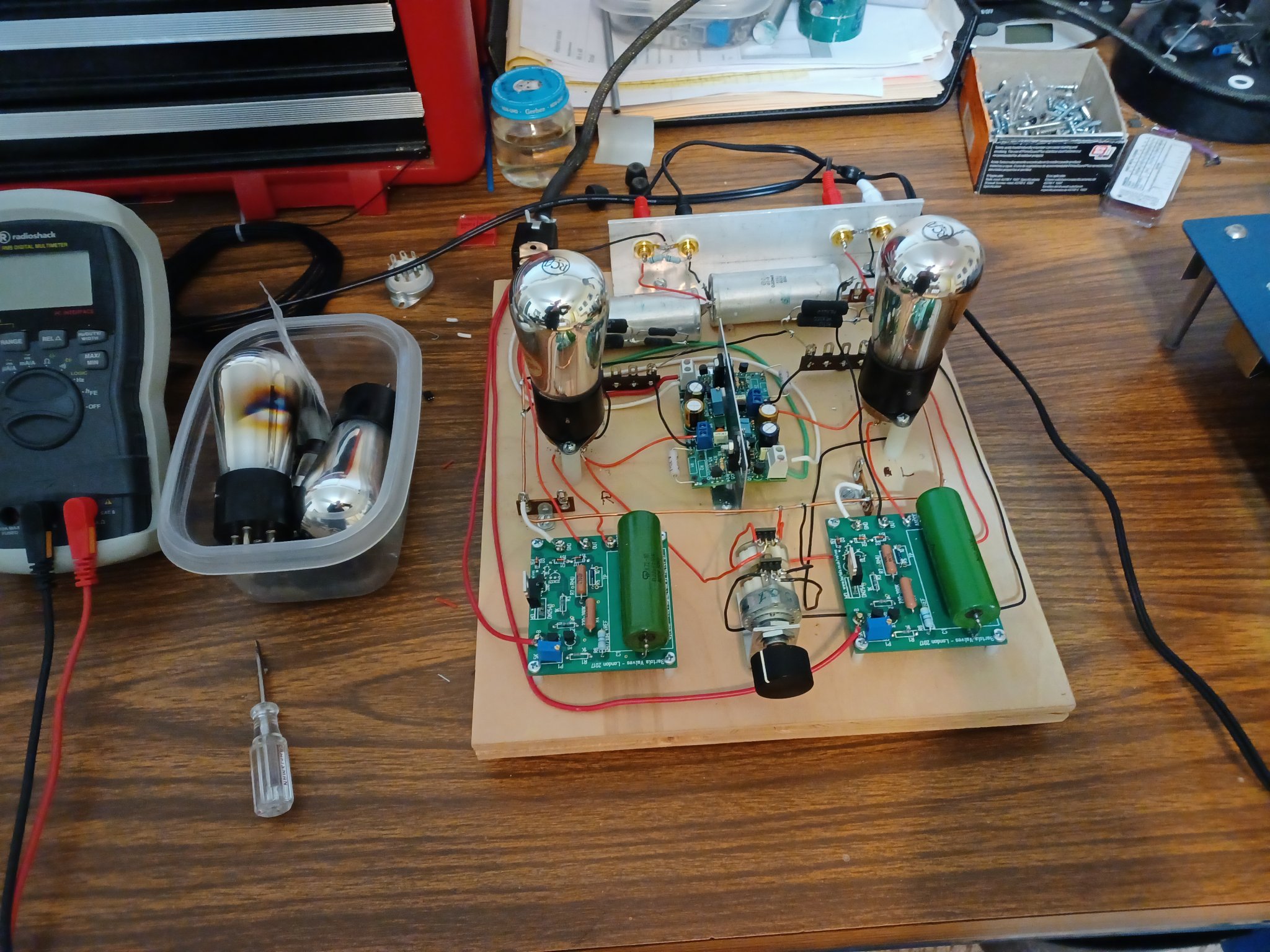

I was looking at the gen 2 schematic and think the 4 was 4 volts not pin 4 of the heater.😒
I adjusted to 5 volts on the heater.
I think my dvm is not measuring milamps . It glowing in the tubes and playing music right now in a test set up and sounds pretty good.
Thank you !
![20220226_070854.jpg 20220226_070854.jpg](https://www.diyaudio.com/community/data/attachments/937/937366-eed50f554ee842320d0c1461db6f5b2b.jpg)
I am back in the corner with the dunce cap on.
I had one of the filaments grounded incorrectly.
I now have both channels voltages correct.
I finally snapped to it after seeing my DMV had a negative on on and positive on the other.
