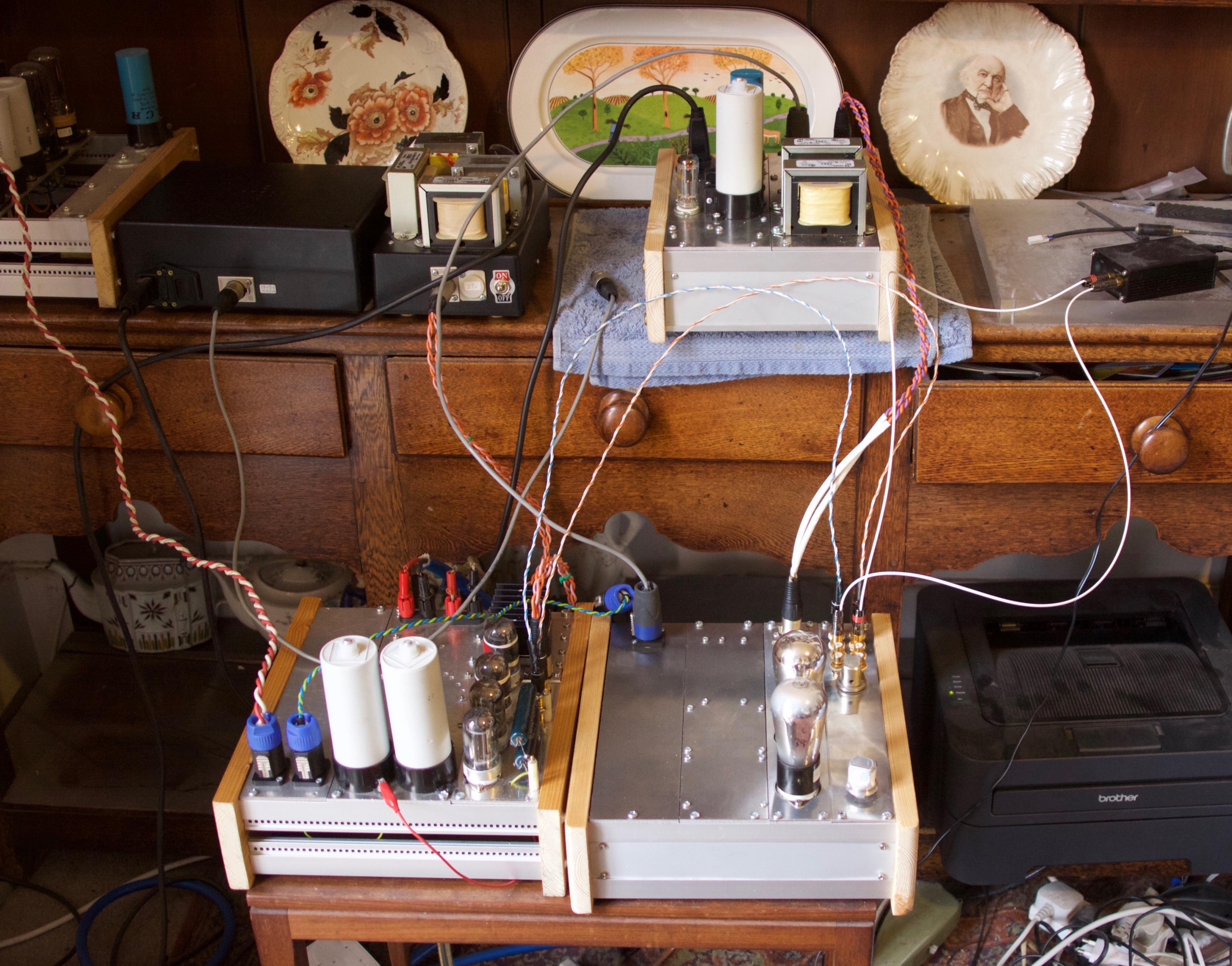

Back to 01A preamps. Just built a nice sounding version of Ale's Gen 2 preamp.
Filament supply worked out nicely - 50VA 18+18v transformer into Hammond 159Y 600mH, 750mA, choke input. Gives exactly 15v into Rod Coleman boards for filament bias. I'm a believer in choke input here - smoother sound.

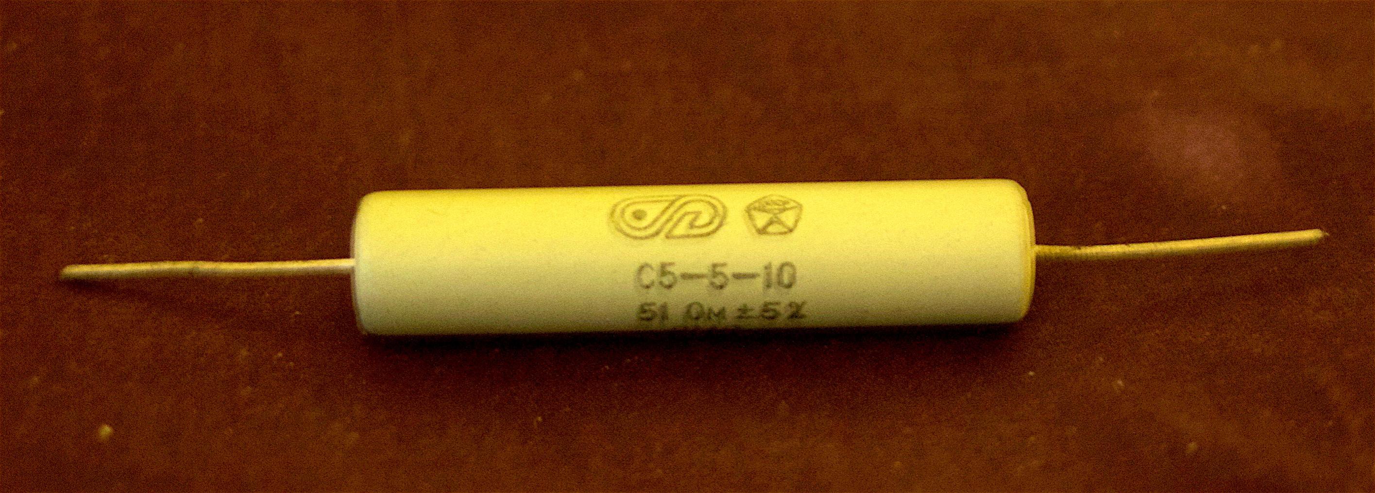

3. Russian 51R marked C5-5-10. These are 50mm long in the body and I assume 10 watts. They look ceramic. I paralleled two with a 3W 82R wirewound of good quality. The sound in this case was the most mellow, smooth and pleasant, though the treble seemed to be all there without being compromised. Gut reaction was positive. Nothing edgy here. i missed some of the positive qualities of the Welwyns. Safe choice.

No obvious conclusion here. I've left the Russian wirewounds in for now. Slightly more "likeable" to my ears and in my system.

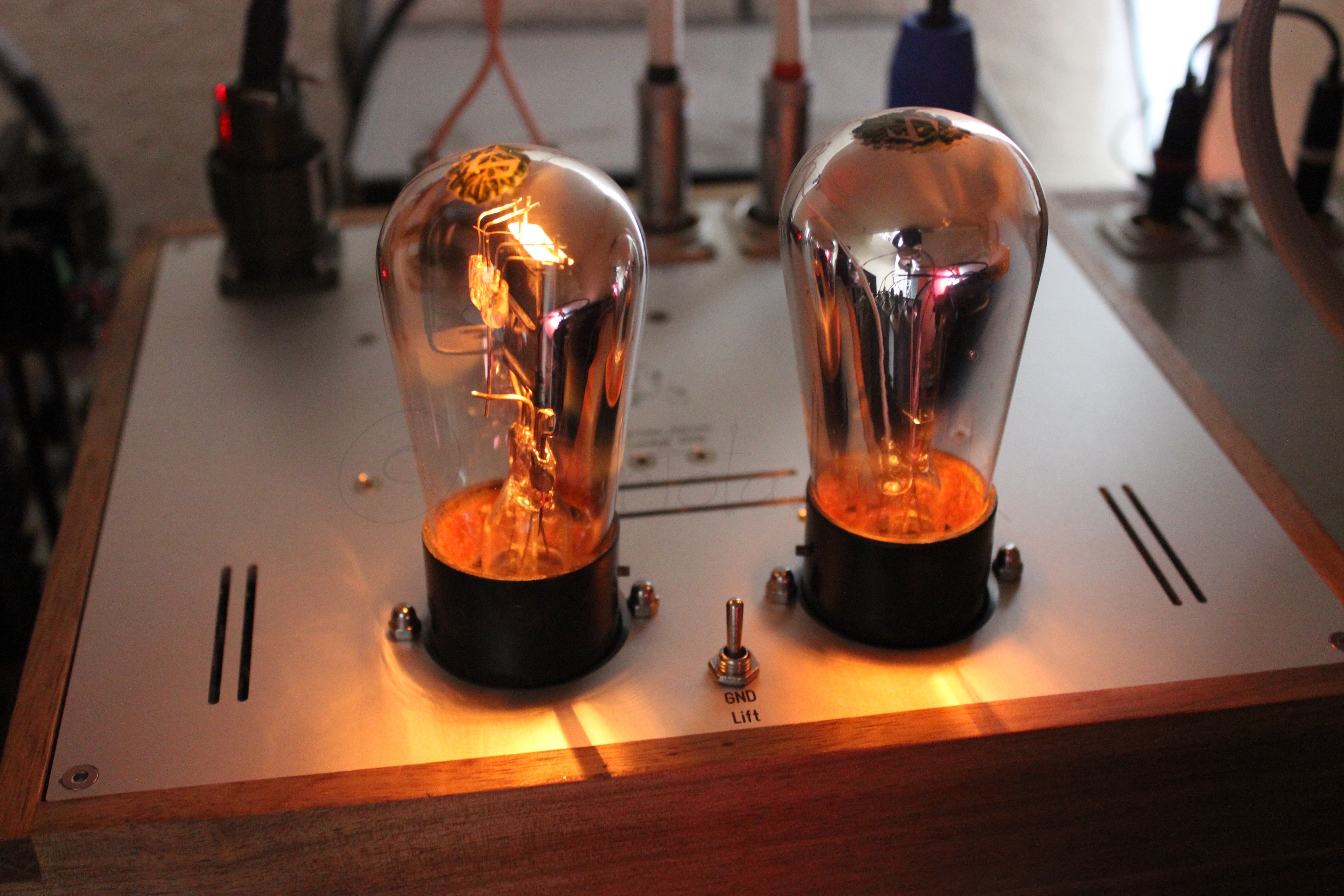

01a Gen2 - new build
I built another 01a preamp with slight modifications on the components:
The gyrator FETs are DN2540+BF862. Filament bias is changed slightly to accommodate the Russian NOS wirewound that Andy recommended. These sound amazing. We did a comparison with a set of alligator clips with Andy and they do sound better than other wirewound in our opinion.
Output caps are teflon FT-3. Rest as usual.
![01a-gen2-preamp-Bartola-Valves.jpeg](https://www.bartola.co.uk/valves/wp-content/uploads/2017/01/01a-gen2-preamp-Bartola-Valves.jpeg)
