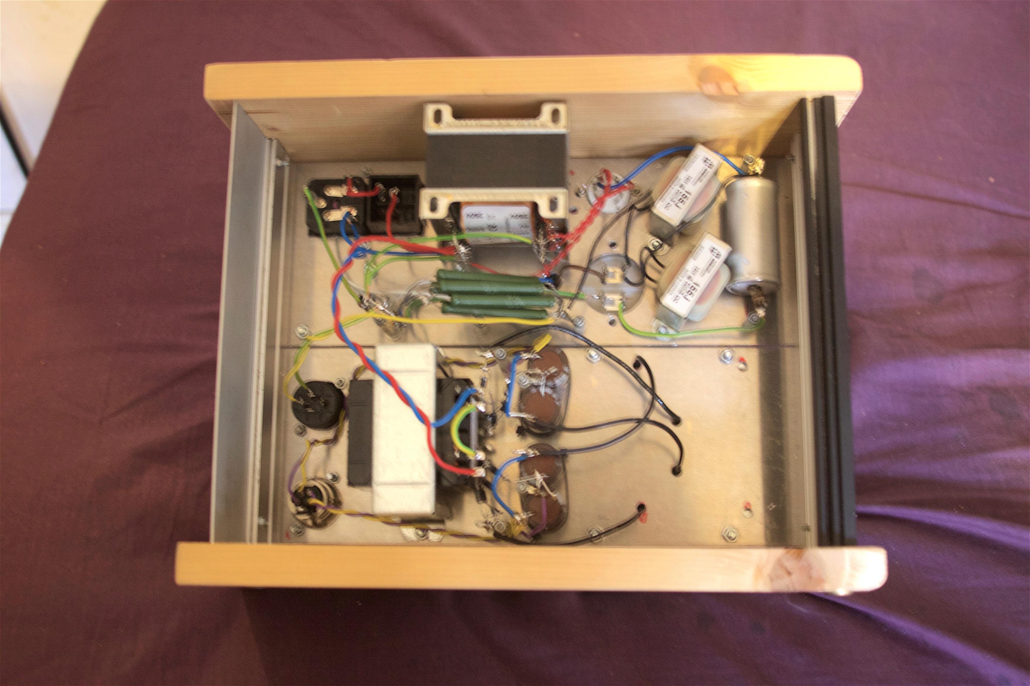

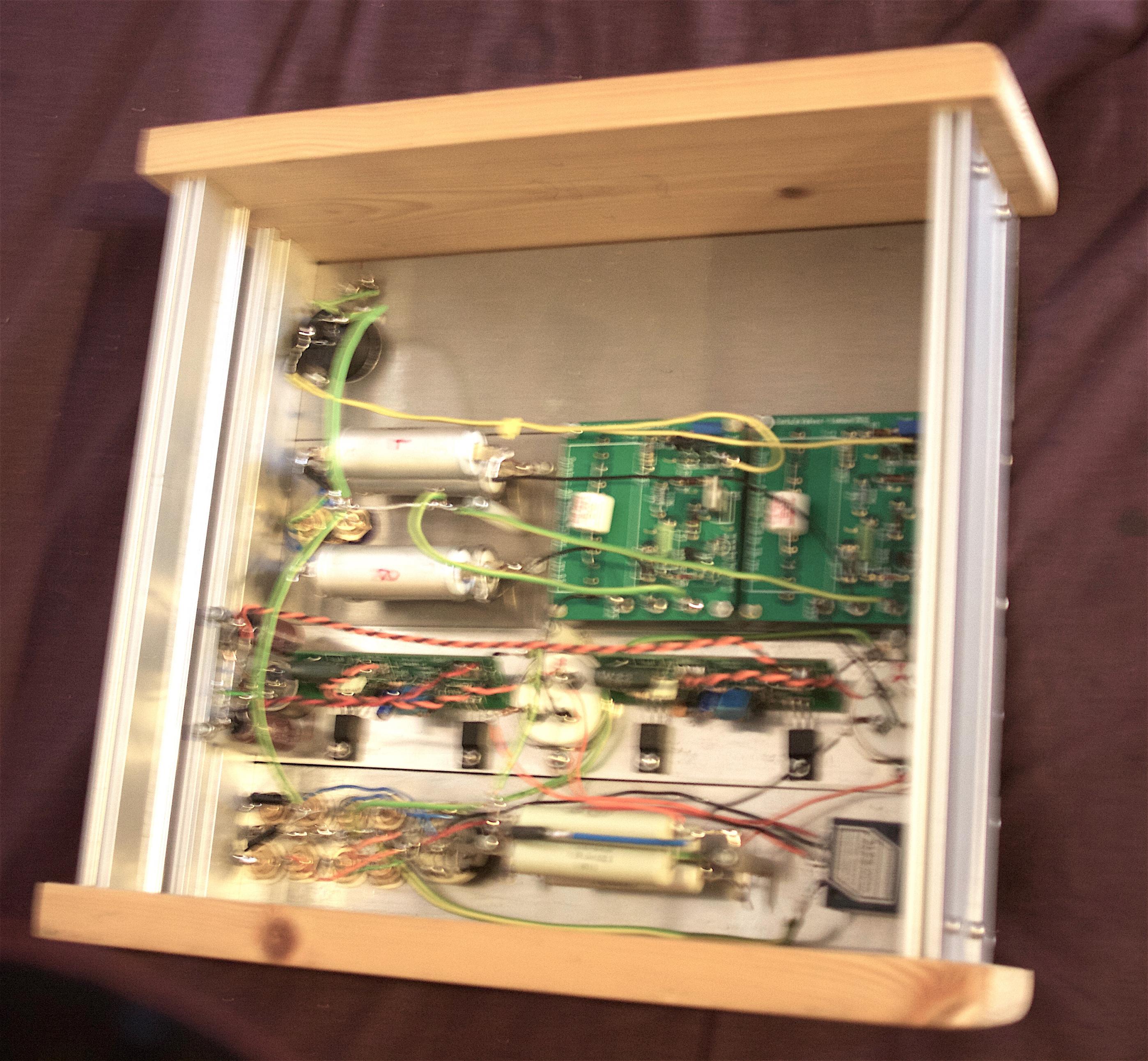

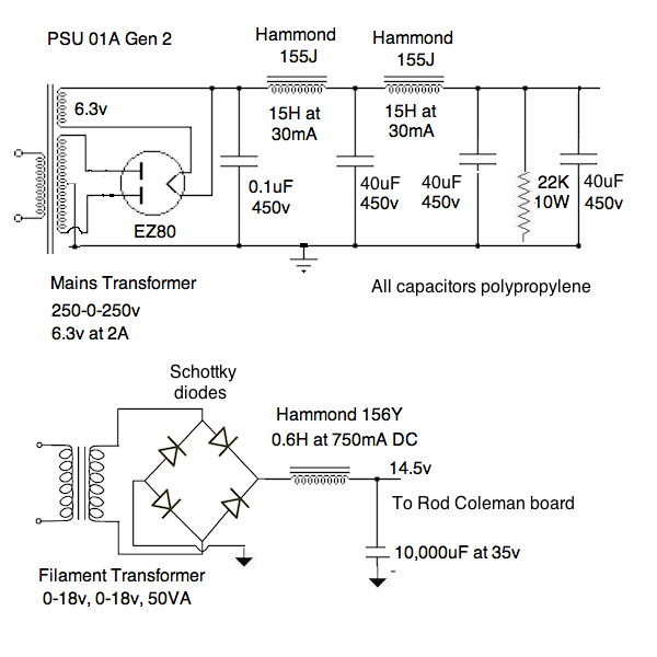

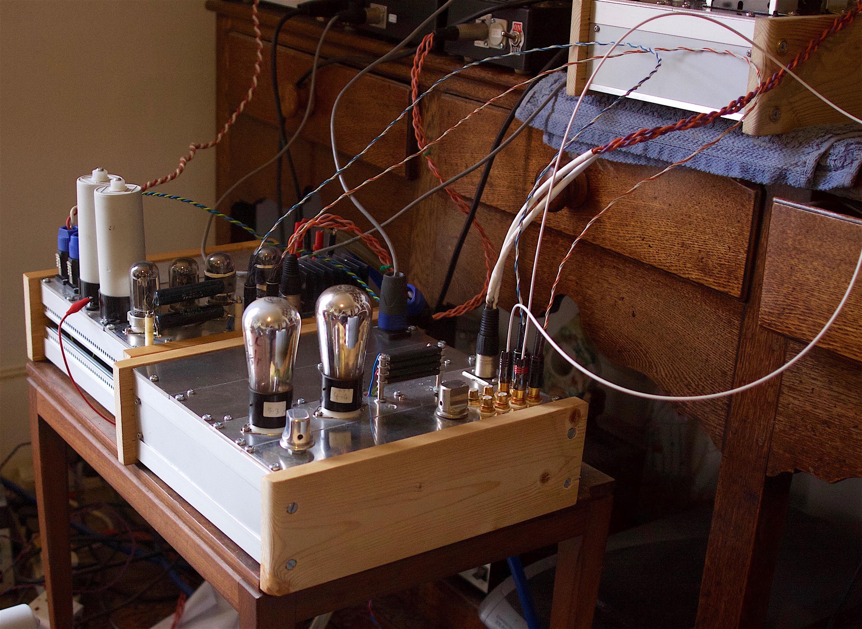

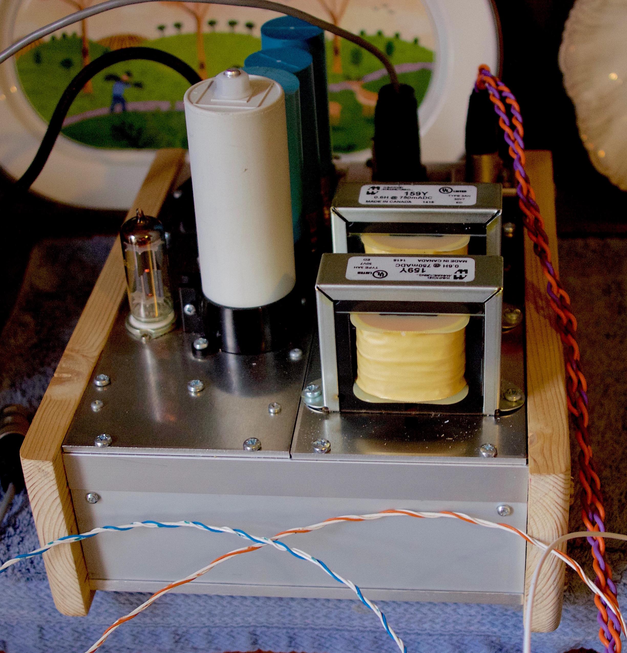

Here's some photos of a recent 01A Gen 2 build for a fellow enthusiast. It shows the 2 chassis design - signal chassis and PSU+filament supply. One photo shows the preamp feeding my 4P1L PSE output stage. I just use these 2 stages from my DAC to the Altair 10 speakers. Sorry about the slightly blurry images for a couple of photos.

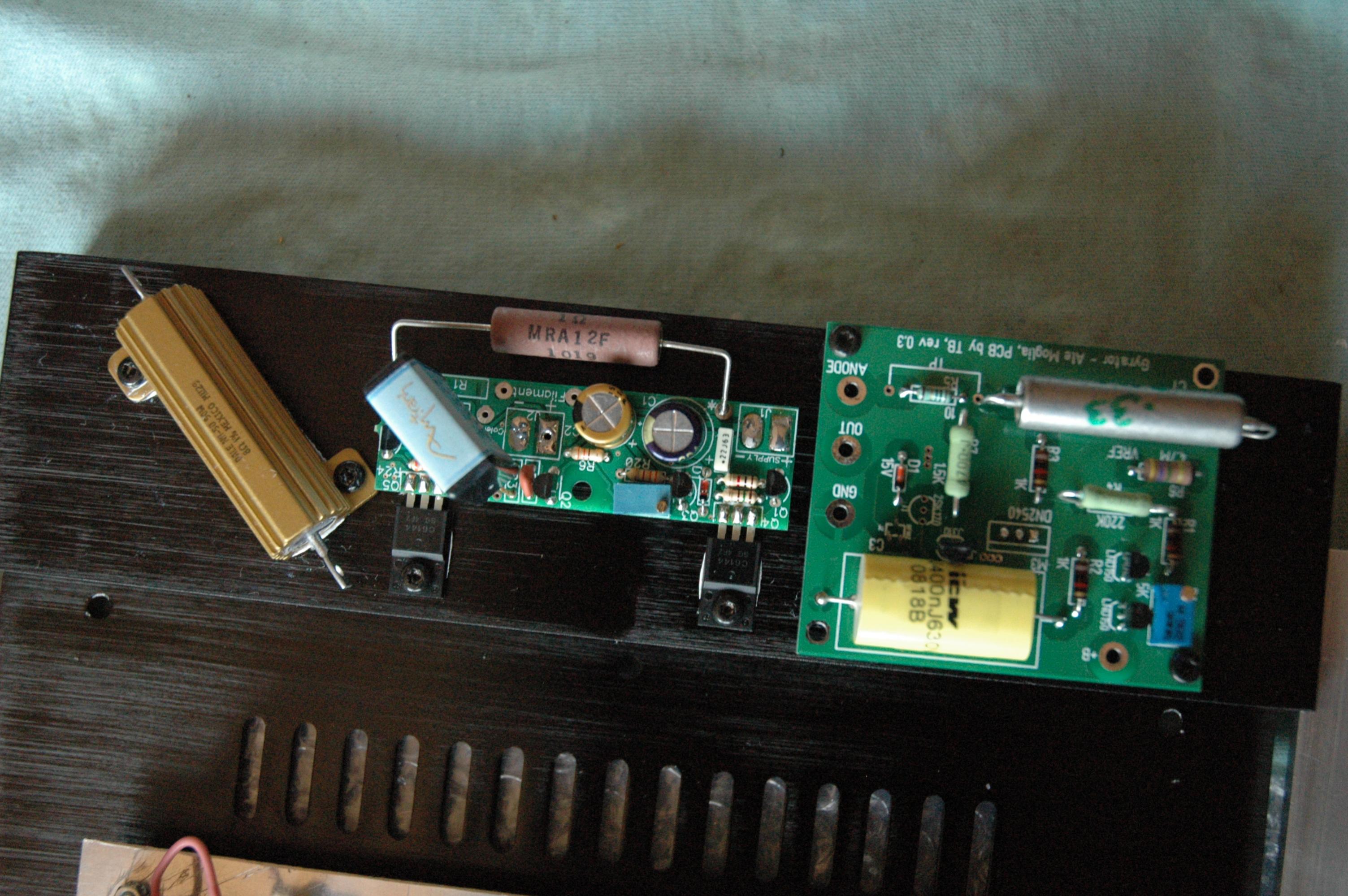

My gyrator boards arrived from Ale yesterday. I thought he hadn't soldered the SMD devices to it, but they are so small I had missed them! :rolleyes:
I and another builder have started a thread over on HiFiWigwam where we can throw ideas back and forth, but I suspect here is where most of the answers will come from. :D He has just built a 4P1L pre with PCBs he bought, but his 01A will be hardwired, like mine will.

Can one of you gents tell me what size sensing resistor you are using on the Coleman regulator board for the ux201a or similar 01a tube? I'm in the process of converting my 4p1L linestage that is an OT design and filament bias to Ale's 01a gyrator design to see what all the fuss is about. I have a few Cunningham globes on the way!
TIA,
Jim
3R9.
I use Mills MRA5, MRA12 or Welwyn W23, W24.
I'm using 4.7R with a pair of V4 regs, given that the 01A is starved. I'm just building some V7 regs - don't know if it makes a difference. I was sizing the resistor for .9V through it.
W23 and W24 are BIG! There's only about 0.25 watt going through the resistor - 3W like W21 would surely be well oversizing the resistor! Maybe a good thing if there's space.......?
