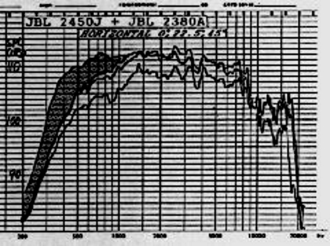

I got interested in this after I acquired some of their old, long snout drivers:
Vol.1, No.21 - JBL’s New Optimized Aperture Horns and Low Distortion Drivers
"When the JBL 375 compression driver was designed during the fifties, it was based on the exit geometry of the original Western Electric 594 driver.
Subsequent variations, such as the JBL 2441, 2445, and 2450 family all maintained the original exit geometry and were designed to work with four decades of horn hardware with 50 mm (2 in) throat diameter."
...which means my 2445 drivers (made in the 80's) were updated copies of a 1930's driver. Their slowly flaring exit geometry is a great match for the big old Western Electric horns, or the Inlow horn (which is 90cm long) - and not a great match for most modern (short) horns.
Thus, the "four decades of horn hardware" bit is interesting:
The JBL 375 was originally mated to an adapter + fairly big radial horn (2350). Their combined depth was about 60cm. OK.
By the 80's, JBL was mating these drivers with much shorter horns, like the 2380 (only 23cm deep). That's a big mismatch between the flare rate built into the driver's snout, and the flare rate of the horn.
That's why some Japanese added an throat extension to the 2380A.
The effects are visible in the shaded part of the response curve below.
In the second plot, EQ-ed response shown compared to the raw response (below).
With DSP the response could be improved.
The 2380A isn't a bad horn, provided it's implemented properly.
The entry angle of the 2380A is actually wider than one might expect (ca. 25°), therefore they go well with many pancake compression drivers.
This raises the question: what's worse, a severe throat angle mismatch, i.e. 0° angle exit connected to a >20° throat entrance,
versus a better exit-throat connection with a diffraction slot at the end of the throat section?
What if compression ratio is also taken into consideration (vintage versus modern drivers)?
