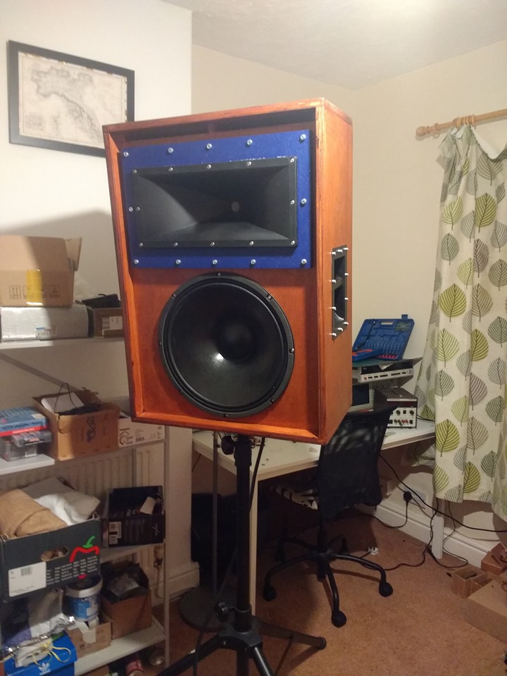

A quick update. I ended up going with a 3 way solution, crossover points 500Hz, 1.5kHz (4th order acoustic). Drivers: Beyma 15 CM V2, 4xFaitalPRO 3FE25, P-Audio BM-D446. The mids and tweeter are attached to a P-Audio PH-4220 horn in a synergy style arrangement. A passive crossover is used on the mids/tweeter and the bass/mid crossover is done actively.
Sounds great, still need to properly characterize its performance. The bits I have written about can be found here:
BM-D446 on PH-4220

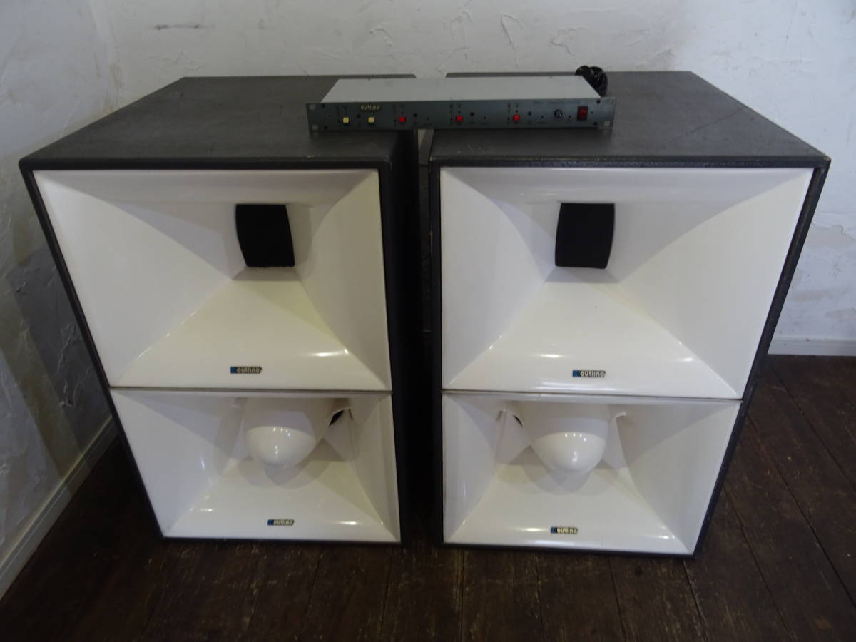

![mf-2-2__45556.1551366744.1280.1280.jpg](https://cdn2.bigcommerce.com/n-zfvgw8/4qh99/products/8715/images/23208/mf-2-2__45556.1551366744.1280.1280.jpg?c=2)
.. In monetary terms it's not a fair comparison though. You buy almost 2 pairs of M2s for 1 MF-2 Monitor.
CHF 28999.00\1 piece, passive Strauss Elektroakustik SE-MF-2 - MusiX CH
Would be interesting to know what the drivers and horn compliment is in the MF-2... Like you say Rob, would be interesting to see a comparison to the M2, even through the MF-2 appears to have higher directivity with the 90 x 40 (2380A?) pattern versus the 120 x 100 pattern of the M2 waveguide.

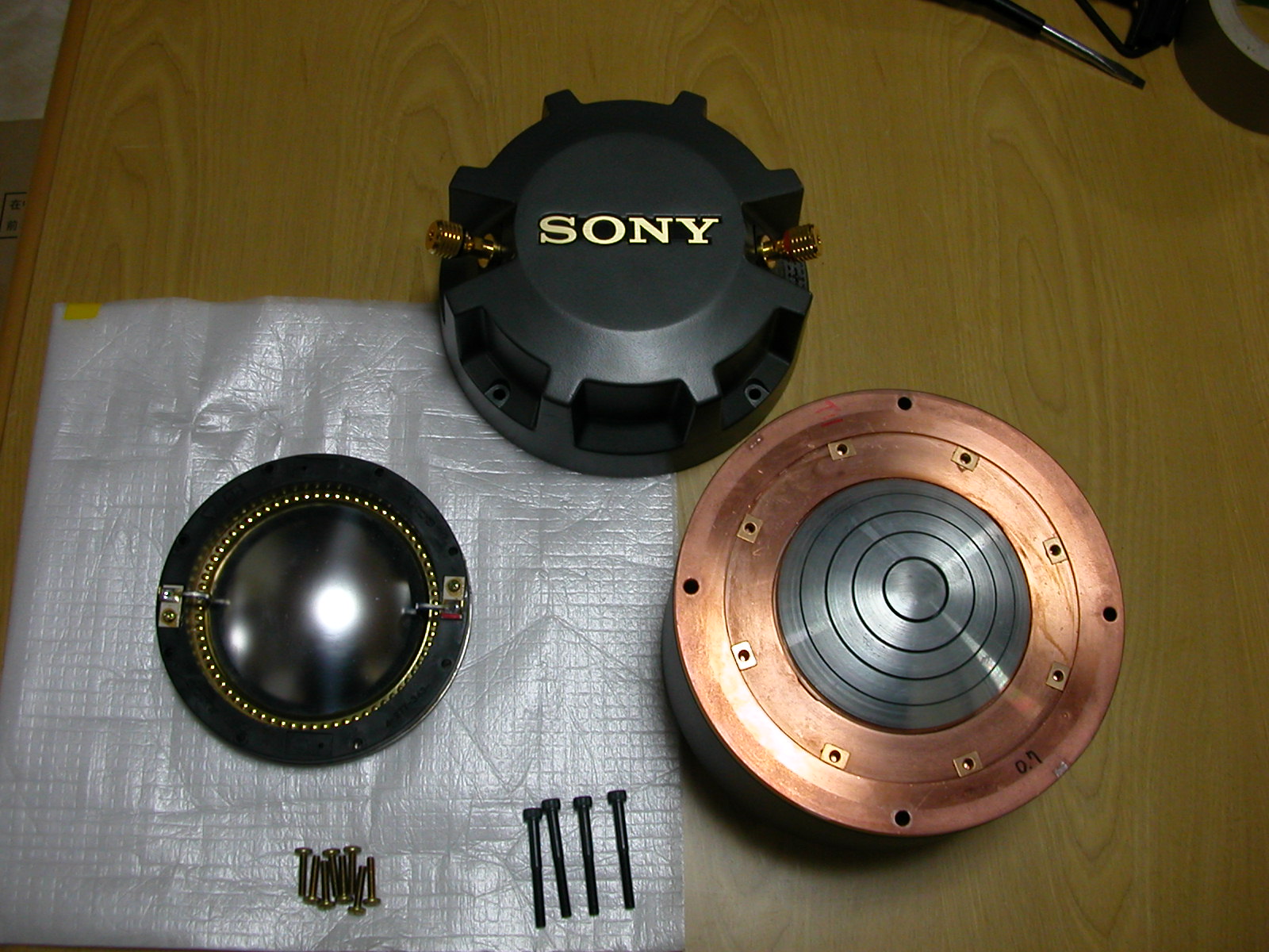

The MF-2 is used in many larger studios throughout Europe and in the Sony Music Studios.
At least the early versions were fitted with a TAD TL-1601a and the Sony SUP-T11 (Aluminum diaphragm).
There are also MF-2s with an additional AMT on top.

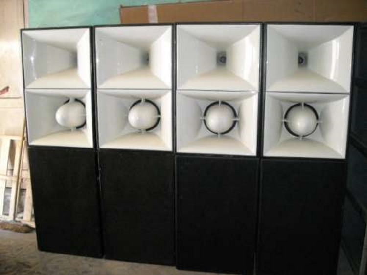

An Italian brand offered 2 types of horns for a PA stack in the 1990's.
These were used with ferrofluid cooled BBC/B&C 3" diaphragm, 2" exit drivers.
The 60x40 horns look suspiciously similar to the Celestion Horns.

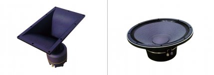

Celestion actually offers 2 horns for the Axi2050.
Specsheets:
Ah, cool. The 90 x 45 version is likely to have pattern flip though since 90 / 45 > 1.6x.
If they wanted to sell more horns in general, they should also make a 1.4" version. But I can see that is not likely to happen...
The Axi2050 is 2", but Celestion may want to develop 1.4" horns for the CDX-143.. series.

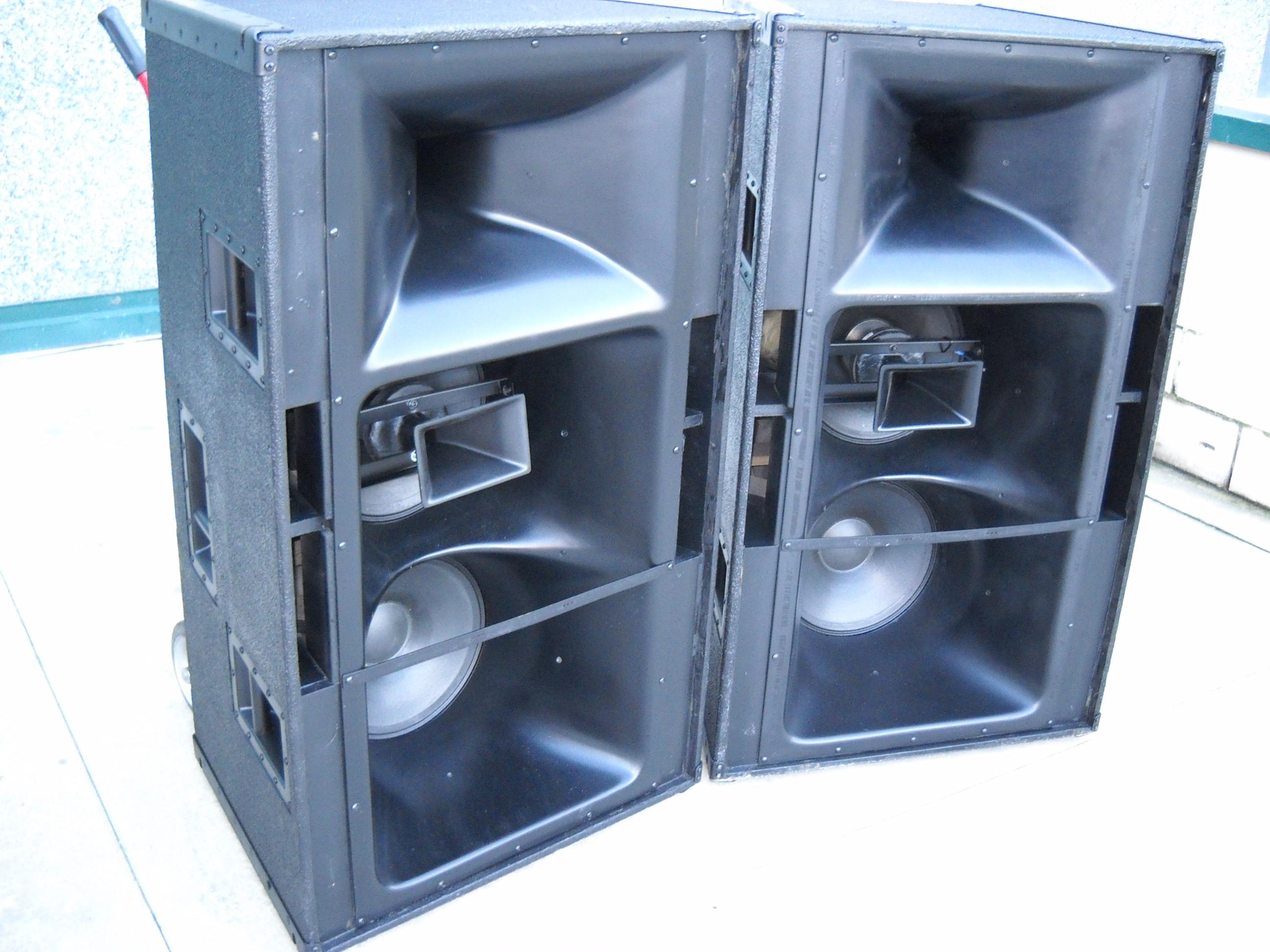

The mid horn in these RS-880s is the mother of the above horns.
It's one of the best sounding fullrange PA loudspeakers ever.
