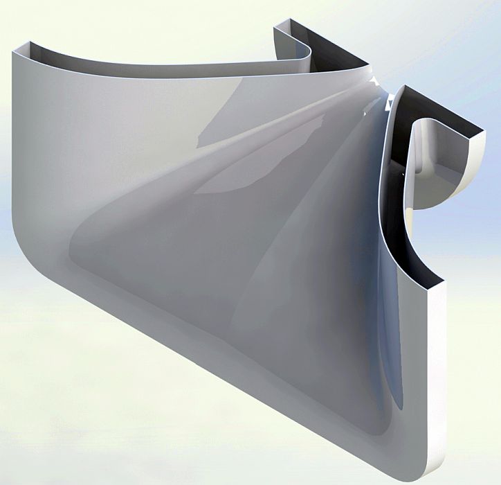

I would like to make test print on 500x400x400 bed. This will be 1mm wall skin with foam inside. Please deceide on waveguide/horn type you need.
Why not have a go at Marcel’s horn but 80x80º, 1.4" (35.6mm), 3° entry angle.

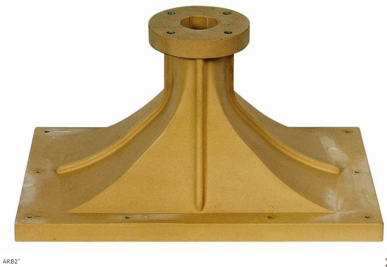

Just bought these JBL 2380 clones for 10euro each.
ARB2" - Bsacoustic.com
With the Radian 760neo bought at a super price from one of the inmates here, it souds super good crosssed at 500hz to a FaitalPro18hf500.
No eq no filter, 30cm measurement.

I don't know if I need the third way yet, I ordered some Beyma supertweeters but as they are now, 2 way sounds great, my hearing is done at 14k4 anyway.

We are trying find solution how to make waveguide with minimum set of points and should be ready till Monday.
