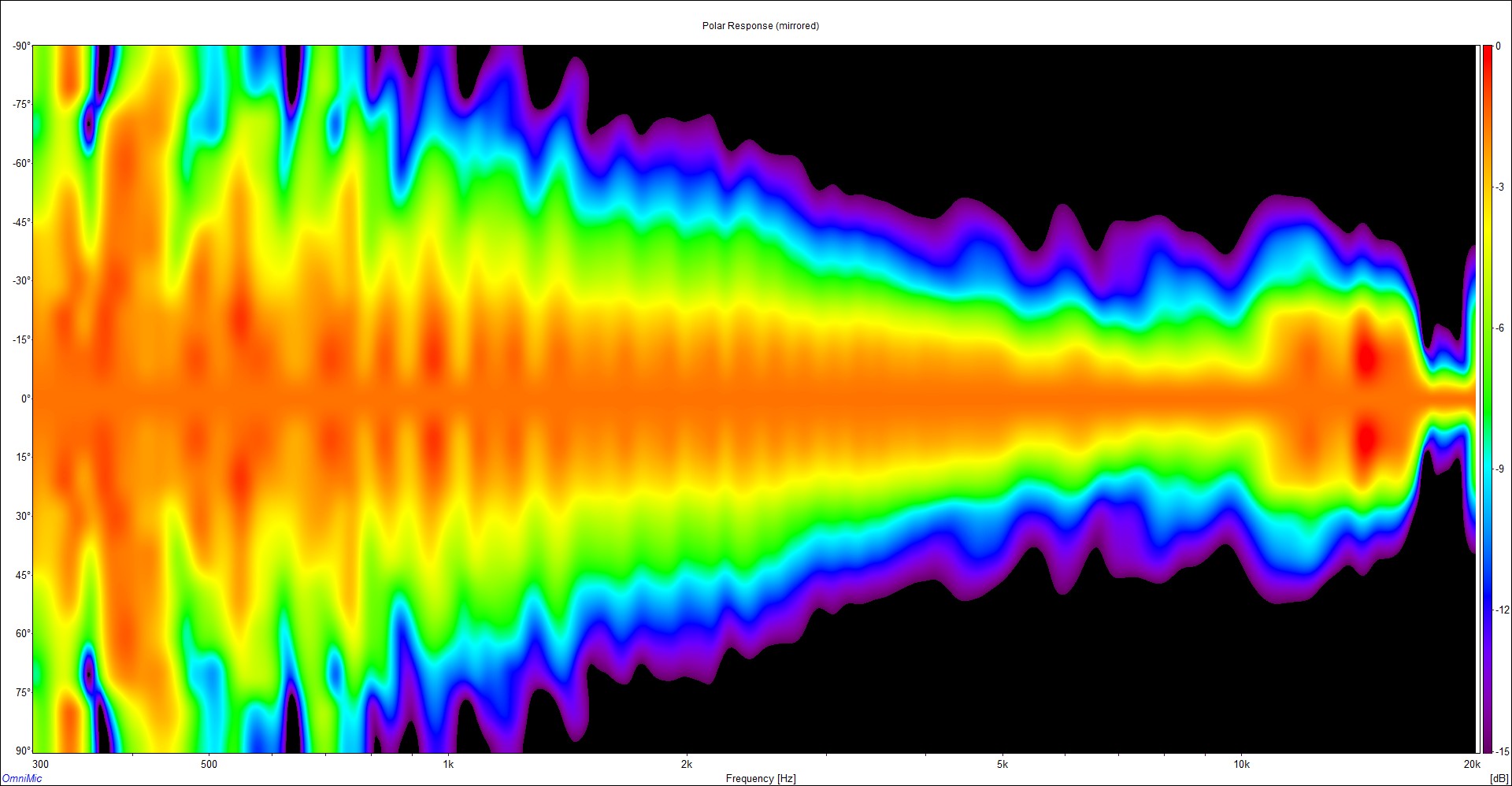

First horizontal:
Then vertical:
The polars of the BMS 4592ND will be the even better up high (10-20 kHz) due to the absence of diaphragm breakup that the Klipsch K-69-A exhibits in the plots linked just above.
The K-402 used with a BMS 4592ND is superb. Here is an on-axis SPL/phase plot of the MEH version of that horn with dual 15" Crites cast frame woofers. Pay particular attention to the difference between the minimum phase trace and the total phase trace. (A hint: it's the best I've seen in a full-range horn.)
Chris
Actually your projects with the k-402 waveguide were part of the inspiration for this when I saw the great results and wide frequency range you were covering. I have no idea where to source a k-402 waveguide though as apparently klipsch will only sell them with an expensive driver attached?
Do you have a normalised version of those polar plots? (IE what they would look like with flat on axis frequency response)

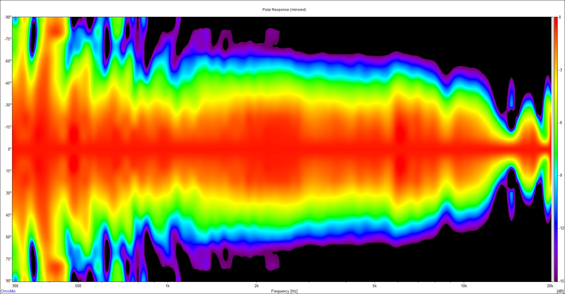

Here are the normalized plots of the ZXPC horn. First horizontal:
then vertical:
then vertical:
