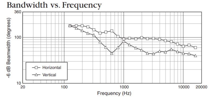

I thought you wanted a uniform directivity. Vertically the 2384 looses its directivity already below 2500 Hz. Horizontally the directivity is fairly constant to 1000 Hz.
By the way, people seem to forget the vertical beamwidth.
hmm as the specs of all the horns are presented in different ways here I'm getting confused about the relative merits so I'm going to have a go at converting them to JBL style -6dB contours for comparison.

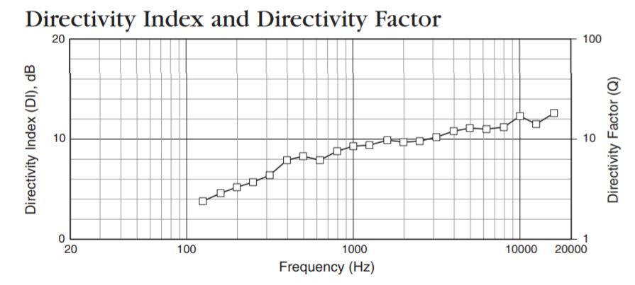

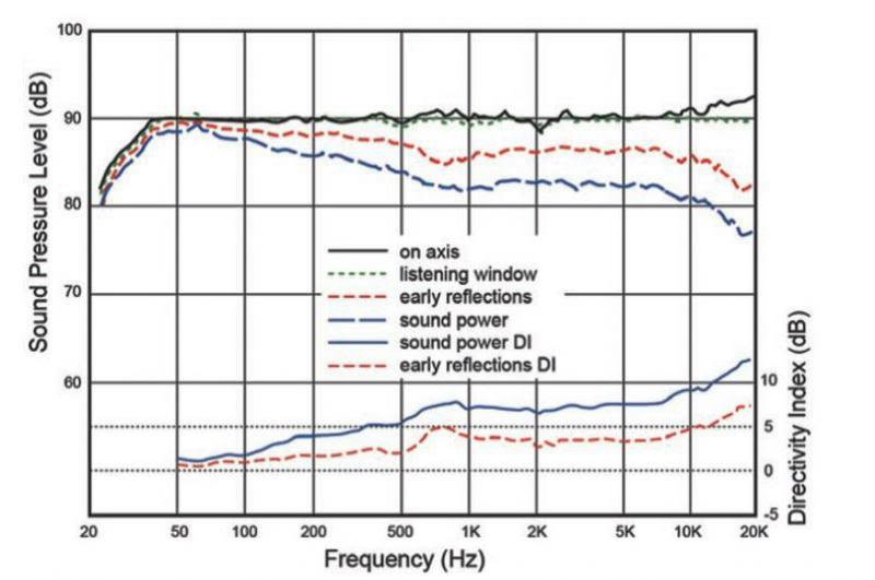

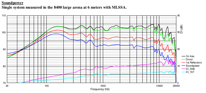

From JBL's specs:
And a spinorama of the sound power both on and off axis:

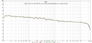

Other than a blip at 1 kHz on the vertical directivity, I don't see or hear any issues. It is a 90 x 50 asymetrcial waveguide and I have been listening to it for a while. Sounds pretty good no matter where I sit on my couch. With the 1.5" exit drivers, you are going to see some ripples in the frequency response beyond 10 kHz, but depending on which CD you are using will vary and if you are using DSP, can be corrected.
I tried several XO points, but found as I moved away from the recommended 630 Hz biamp point, the image would shift up more towards the waveguide. The 630 Hz active XO point blends perfectly between the bass cabs and the waveguides and the image is dead center between the top 15" woofer and waveguide.

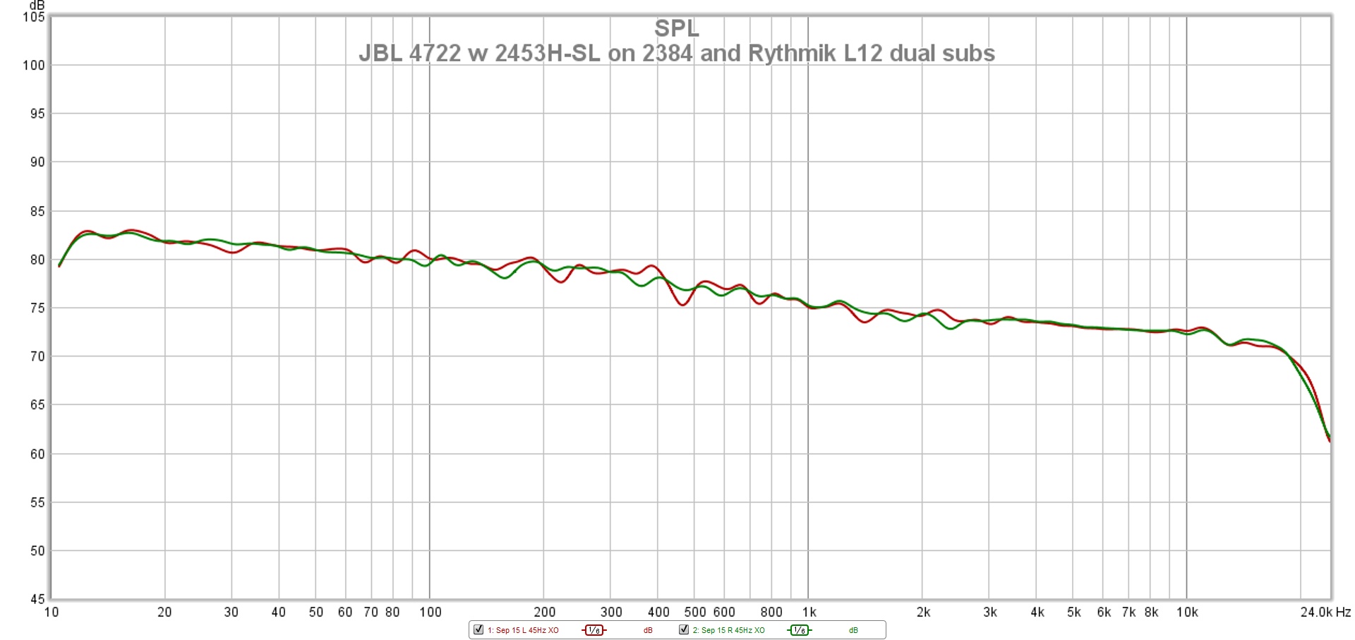

@kipman725, I wrote a couple articles using DSP for a biamp and then adding subwoofers. I am pretty happy with the overall system response, measured at the LP:
If wondering why the downward tilt, there is good research on what a good in-room response looks like based on anechoic measurements. Also, there are plenty of other measurements on the 2384 using different compression drivers on this long thread at: Just purchased a pair of JBL 4722n speakers. - AVS Forum | Home Theater Discussions And Reviews

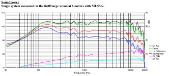

From JBL's specs:

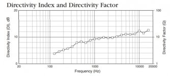

The beamwidth and directivity index you showed are just confirming what I said. It also shows the horn has a closer to a 100° horizontal coverage. The vertical is all over the place and not constant. The horizontal uniformity is also a clear step back compared to some of the old JBL biradial horns.Omholt, not sure where you are getting your 2384 measurements from... Can you share? What CD was used? Btw, the JBL D2 on the 2384 is a poor match.

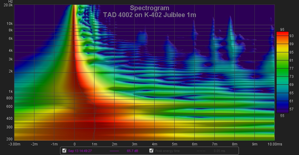

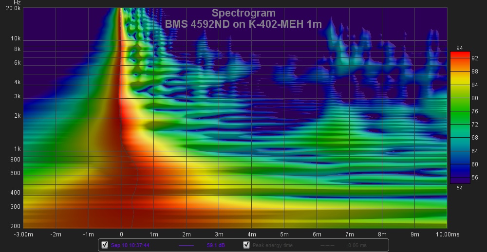

I believe that two plots will tell you a lot more: impulse spectrograms on a K-402 horn. First the BMS 4592ND (biamped and time aligned):
then the TAD TD-4002:
Now the real question is: how much of this difference is audible? For me, it's not. I cannot tell these drivers apart. (That's saying a lot, trust me.)
In terms of the theoretical differences--the BMS dual-diaphragm driver should beat the TAD on high frequency FM distortion (because it breaks the ~400-20000 Hz pass band into two parts, thus avoiding the widely spaced FM sidebands).
The TAD clearly has better dial-in characteristics, only requires one amplifier channel, and the spectrograms look better in comparison. I don't believe, though that this is worth 3x-4x the price, however, since I've already mentioned that I can't hear the difference.
I also need to state that you need to bi-amp, time align, and apply several PEQs per channel with the BMS 4592ND--at least the version that I just bought new this fall. I've dialed in another set of 4592Nds for another guy on K-402s. These drivers are considerably older--more than 10 years--and they required no time alignment...strangely.
As far as other 2" compression drivers: all of the others that I've heard have audible signatures above 10K that give them away (however slight that difference might be--and it can be very small).
I've not heard or measured a Radian 950BePB, however, which I would expect to be a duplicate of the TAD 4002 performance.

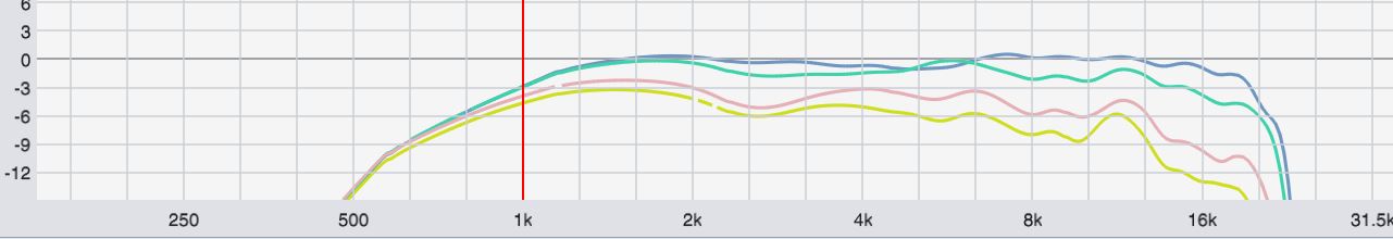

For 1.4", I really like the bms 4594 with xt1464.
It's supposedly a 60x50, but it sounds narrower to me. I know patterns are quoted at the -6dB point, but I think there is also an order to the rolloff at -6, just like the order on crossovers.
The 1464 cuts off fast at pattern edge.

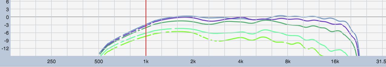

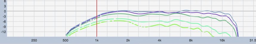

Here's some off-axis mag plots.
First is horizontal. 0, 10, 20, 25, and 30 deg.
Then vertical 0, 10, 20, and 25 deg.
