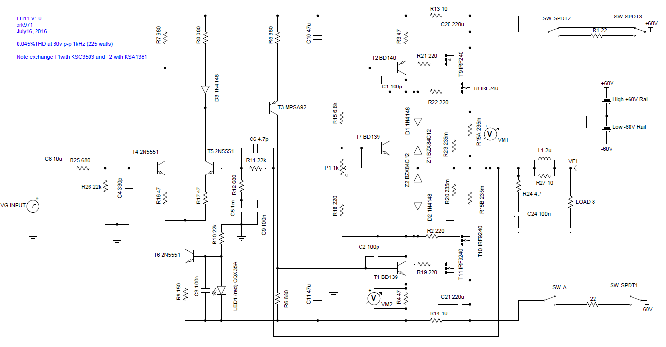

After you provided me with all data, I can do it rather easily. There is only one thing, I don't have: a schematic which can be edited. xrk971, you must have a schematic from u simulations. Ofc I don't know in which program u did it. Maybe u can tell me the program and provide the working file? In case, the schematic is in eagle, it would be great!

The simulation is in Tina format.

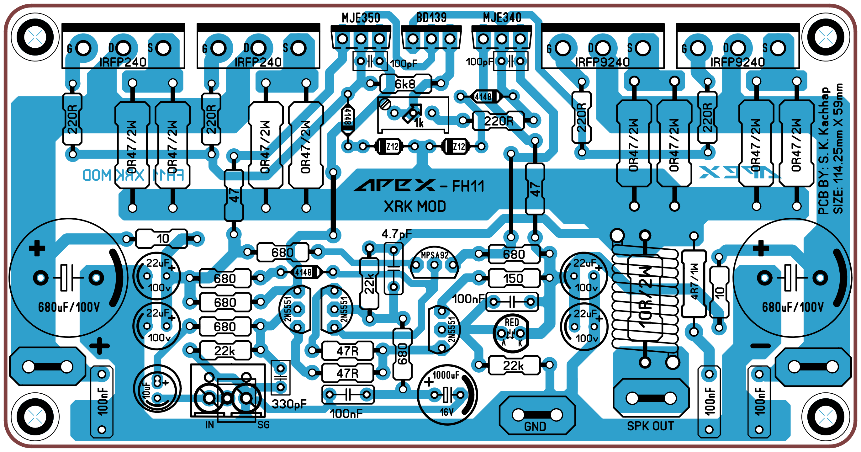

This is the old layout that Sonal is working on to correct the flipped electrolytics on. I am looking at it and can't find any other errors, and do see that it is a beautiful layout otherwise. If one was in a hurry, this could be used with a manual (note to self) to flip power rail electrolytics and it should work. It's a surprisingly compact and simple 250w amp though.

Sprint file for FH11. Pdf files will be shared after andrewlebon has tested it.
@andrewlebon If you use with voltage rail of 55v or less then use 1000uF/63v instead of 680uF and 47uF/63v instead of 22uF.
There was one more mistake MJE340 was in place of BD140 and MJE350 in place of BD139.

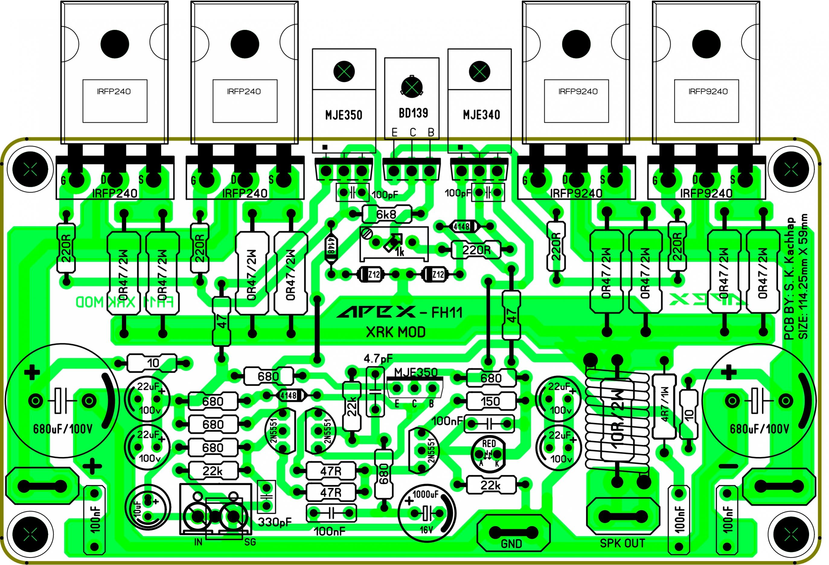

It's very convenient that pin outs for BD139/140, KSC3503/KSA1831, MJE340/350 are the same. Note that on VHEX+ amp, vzaichenko drives a pair of IRFP's with a single KSC/KSA just fine so it may still be suitable to use those drivers. I believe they may have slightly better noise/performance figures over the MJE's.
I have both so it's not an issue - just wondering which will give best performance.

Then you should get KSC2690A/KSA1220A.

Nice pcb but it can be resize to 100x60mm.

When I was making layout I visualized mounting holes on all corners. But with 100x60mm, pcb mounting hole at top is not possible.
I'll make two version.

I wouldn't dare ask to make it smaller
If it helps, I am using 1W 0.47R supply resistors in F9HV and they are not even warm. I also don't need/use screw holes on the edge with the OPS.
Beautiful and very builder friendly design though. The 100mmx60mm will mean qnty 10 for $10 from PCBWay
I would like to mention that MPSA92 transistor will be getting quite hot when using high voltage rails and it will require a heatsink, which may present a challenge to some, since it is in a TO-92 package. An alternative would be to use a different transistor in a bigger TO-126 package instead.
Hmm... KSA1381?
