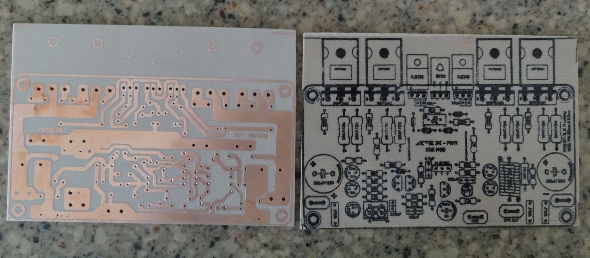

Yeah I'm going to stick a little sink on it. Just didn't want to spend too much time changing Sonal's layout. I just wanted to test them.
Nice work Terry! You are way too fast. Good luck populating it.
I have to get me some of that Dollar Store iron on transfer backing paper...
:cheers:
Btw, do you have one of those micro drill presses or just a regular 1/2in chuck 8in workpiece drill press can be used to do the holes? I have the bits but keep thinking my regular press is too big and not precise enough.

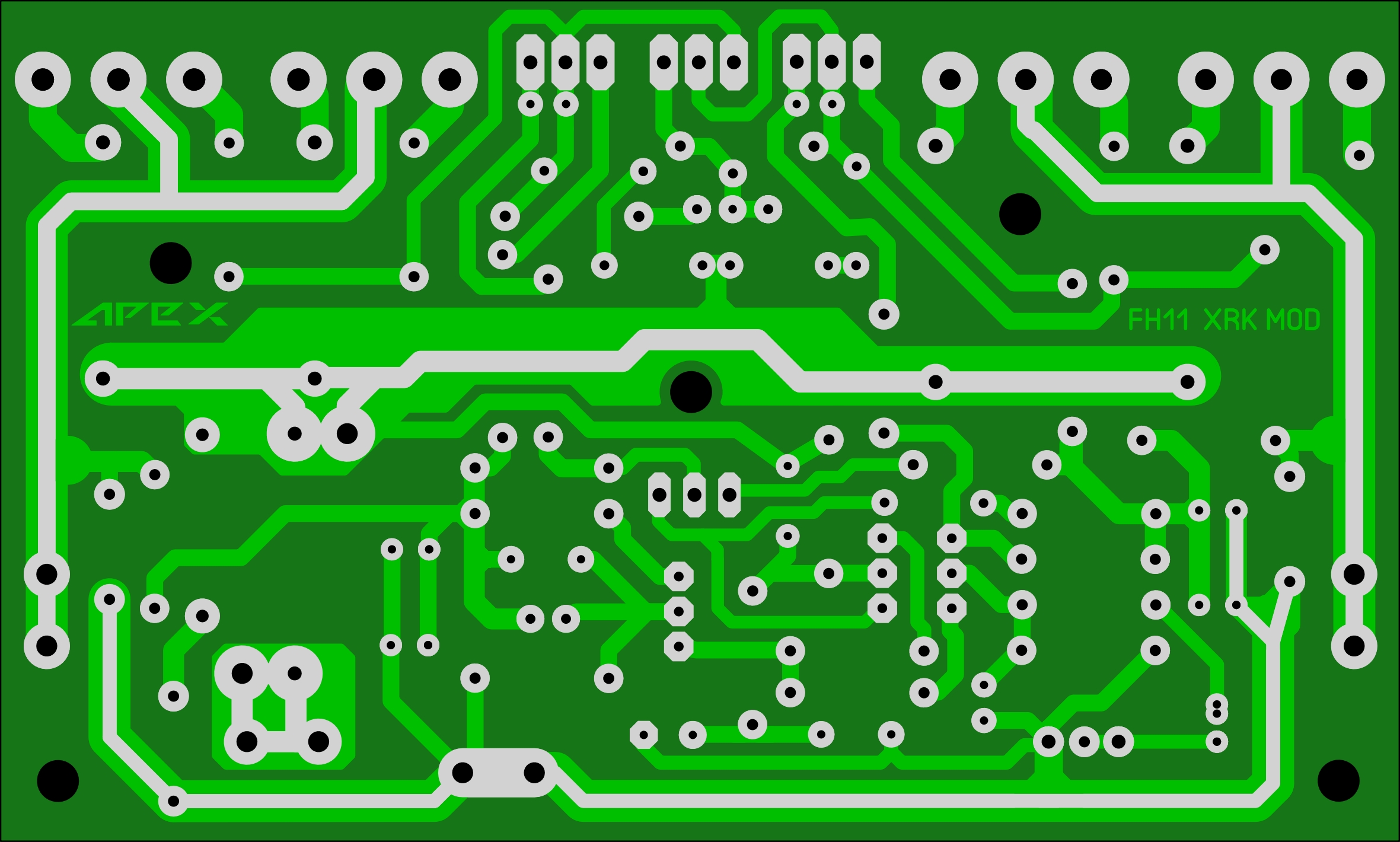

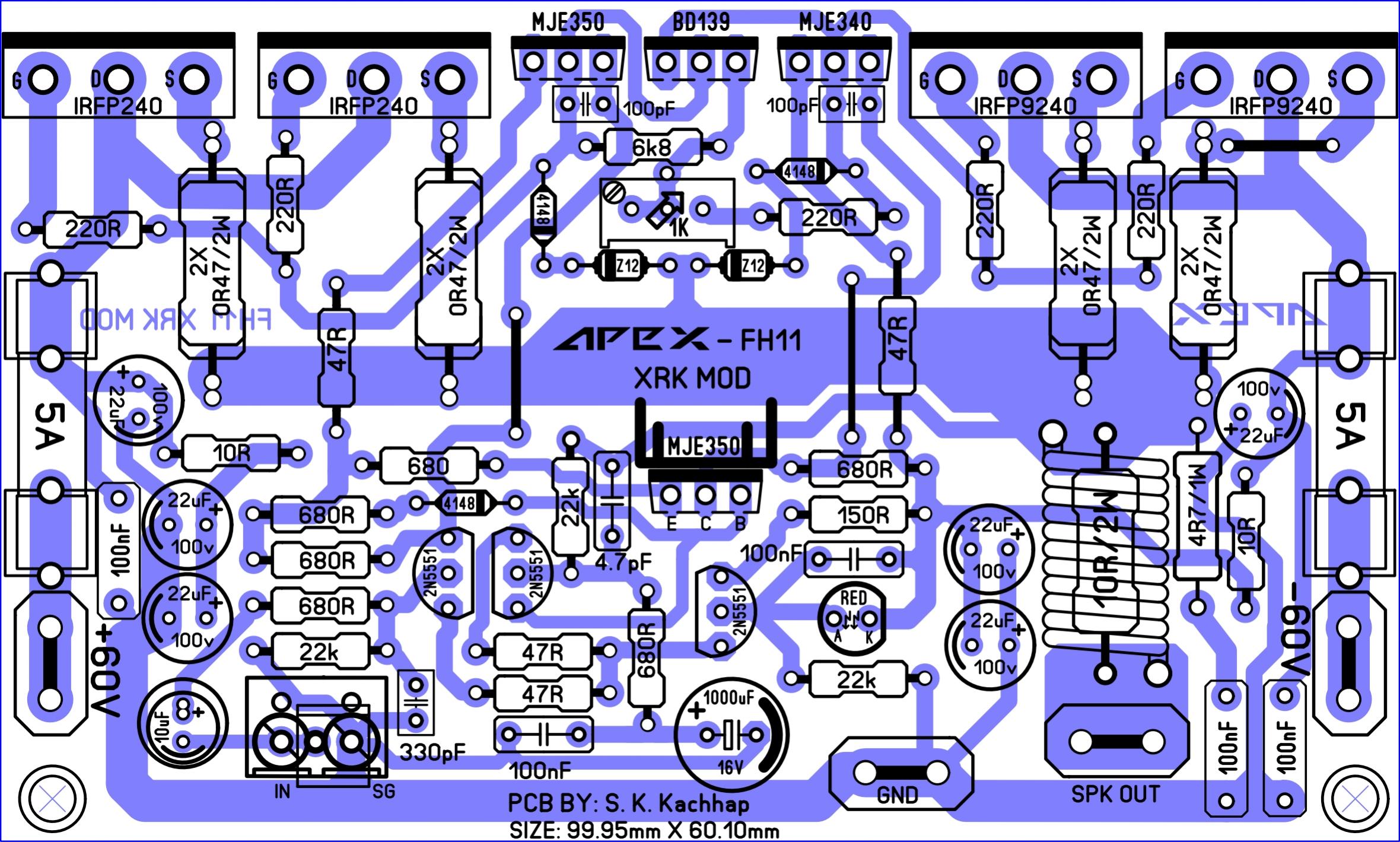

FH11 in 100mm x 59mm layout.
Rail caps 680uF must be ? If have 10.000uF per rail from PSU
680uF is there for local decoupling. You can use smaller value, it depends upon how much space you have on layout you are designing and compromise you make for value of capacitors. Look at orignal AX14 pcb from Mr. Miles it has only 2.2uF capacitor.

Are these comparable or better than the KSA1381E/C3503E?
I noticed the KSA1220/C2690 have higher collector current and higher gain for the "Y" type.
Thanks...
the low current, low Cob, a1381/c3503 make good VAS and pre-driver transistors.
The high current, high Cob, a1220/c2690 make good driver transistors.
They are not interchangable. Their parameters are very different.
