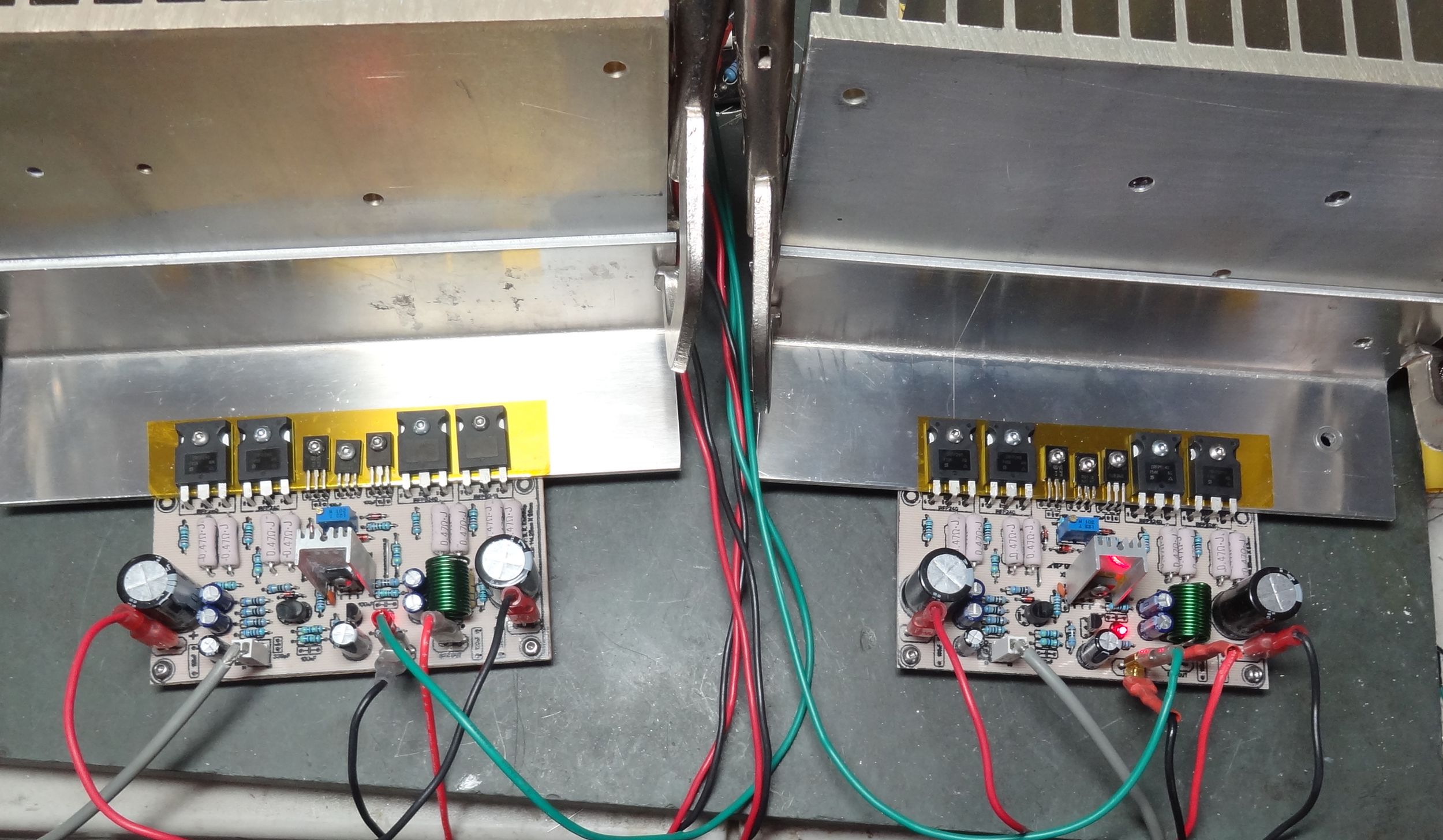

I found some time to hook it up to a +-59V PSU, 20,000uF per rail. The sound is very good as expected. Square waves look beautiful It clips at 32vac into an 8 ohm load for about 128W.
Things of note.
The MJE350 runs very hot. The little heatsink is uncomfortably hot to grasp.
The offset is very high at turn on but settles fairly quickly. There is a noticeable sound through the speakers until this happens. I would say a speaker protection with delay would be in order.

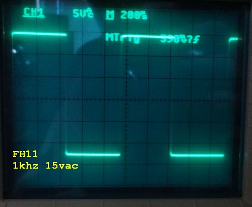

Did you happen to snap a photo of the square wave? What frequency did you take the square wave at?

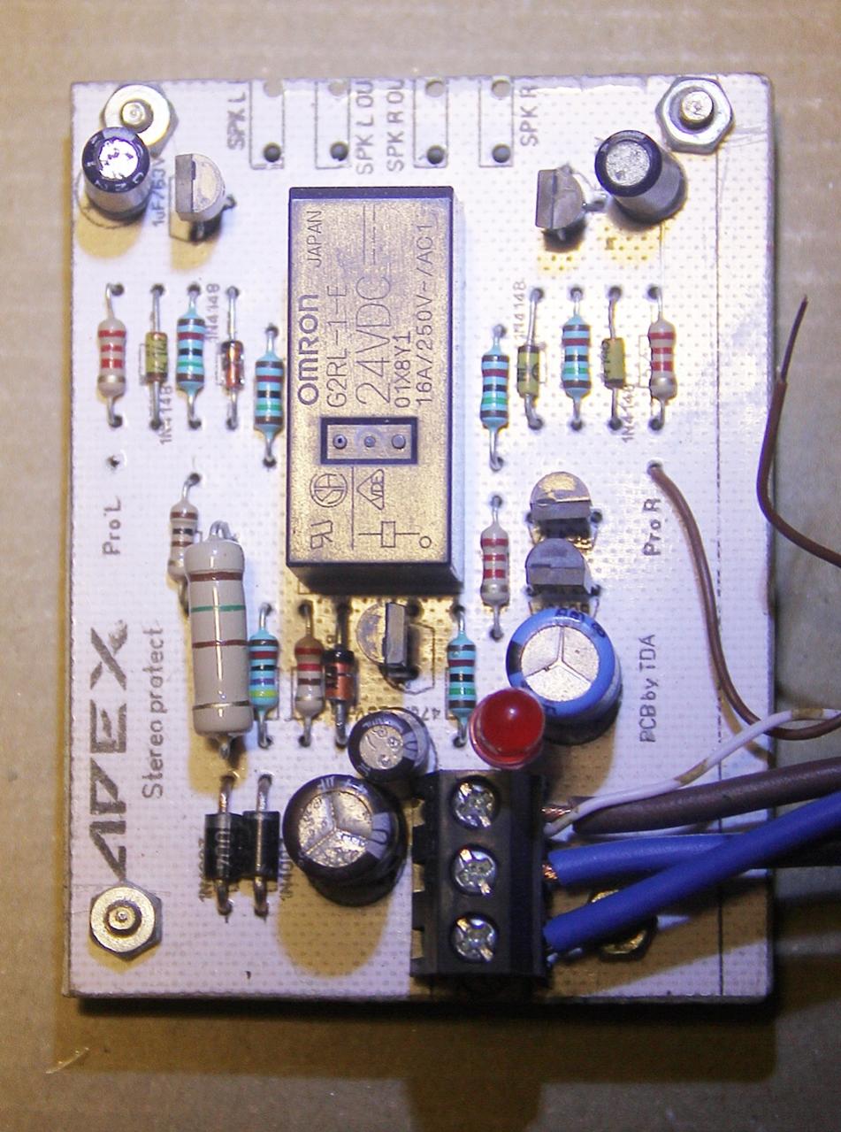

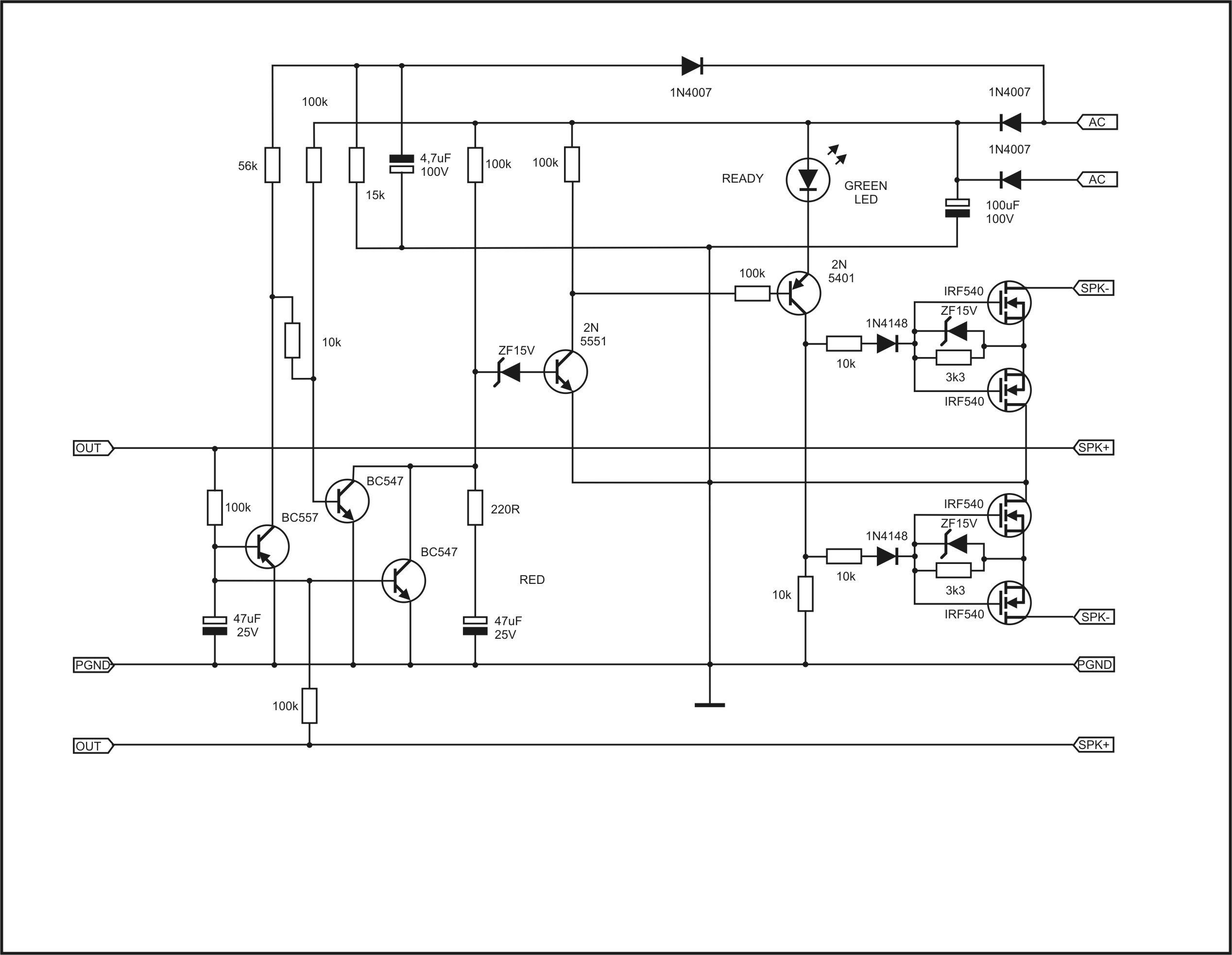

I suggest this stereo protect with over current, DC and anti klik (delay on)

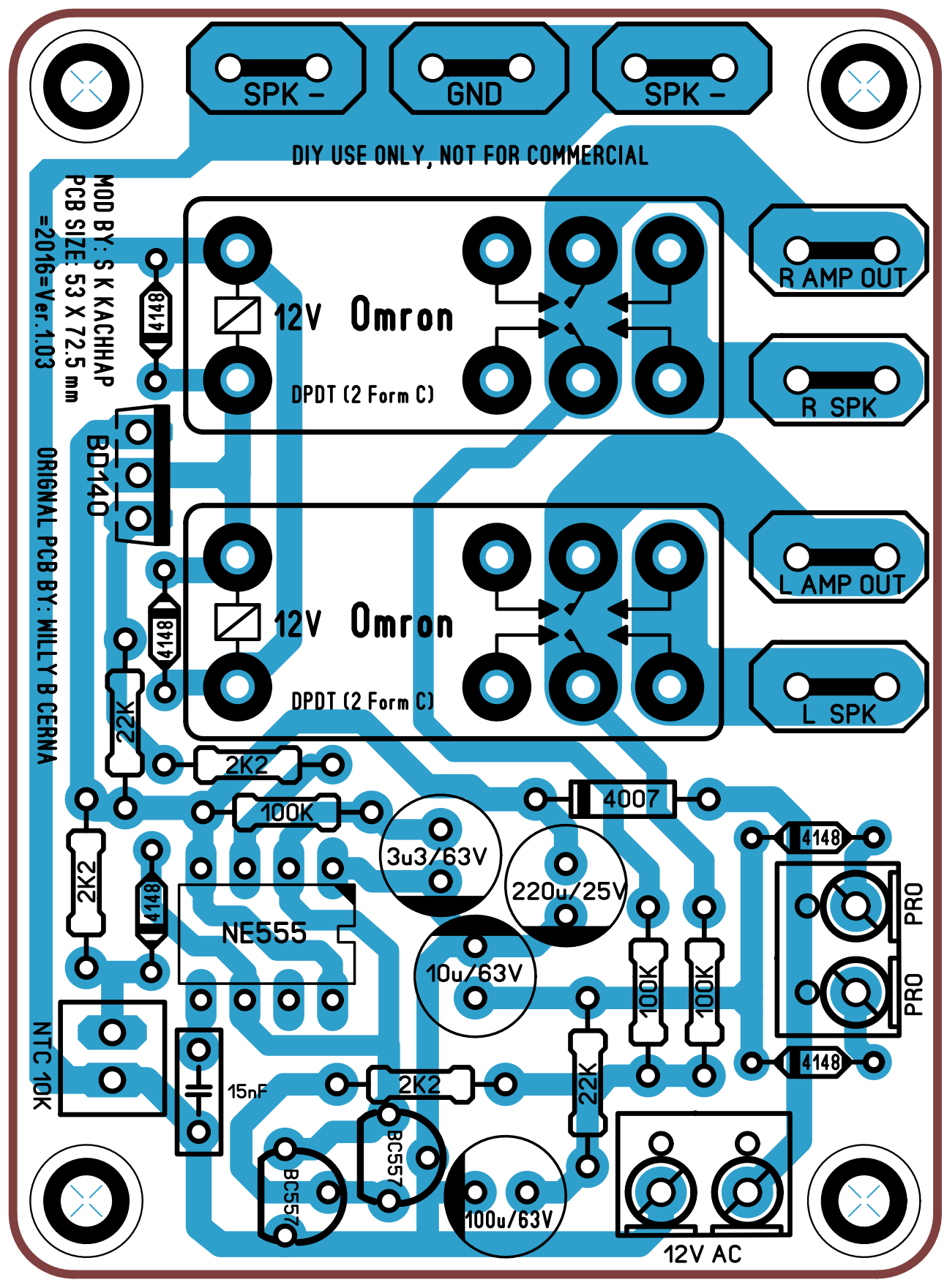

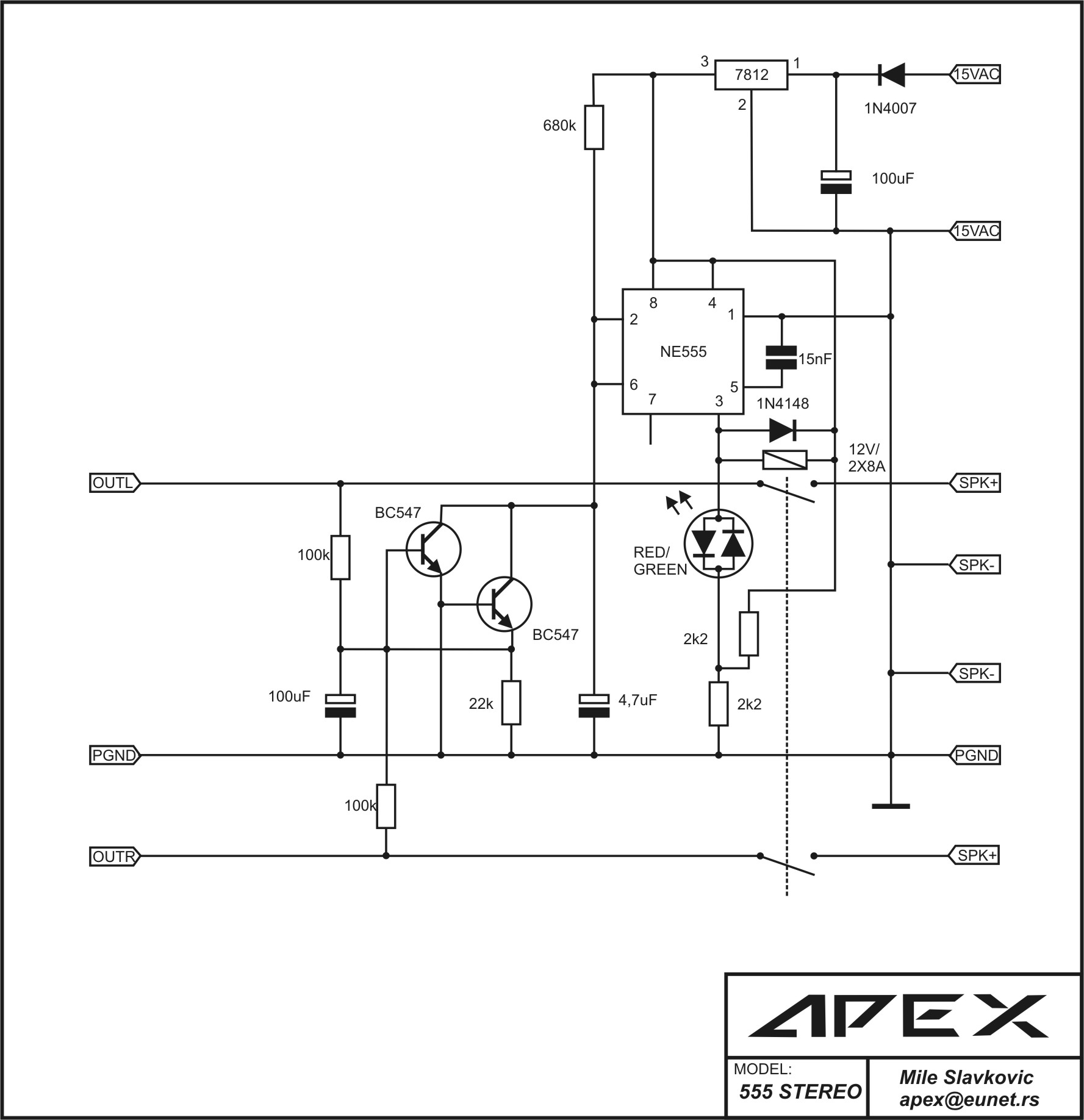

Mr. Mile, is there a schematic of the protect PCB for mono version (for subwoofer-high power)?. Also if pro is not connected, will still function with DC detect and start delay? or should i use NE555 mono protect without pro. (willJJ PCB) available somewhere in the middle posts of this thread.
reg
Prasi
I have modified willy's NE555 pcb. Is there any changes needs to be done.
Hi Sonal,
as usual very nice pcb. if i understand correctly, there is a small daughter board that goes along with it, which will enable pro- pin on any BJT amp . that consists of a couple of transistors and 4-5 passives. not sure if it can be adapted to FH-11 2-pair here.

apex stereo protect
APEX SST Protect.JPG hi
Mr apex,my first attempt ,please check for any mistakes ,i have attached the schematic,eagle brd file,screen shot of the brd file. only changes i have made is added parallel irf 540, as done by rensil in the post 7692,thank you

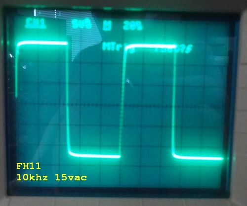

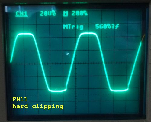

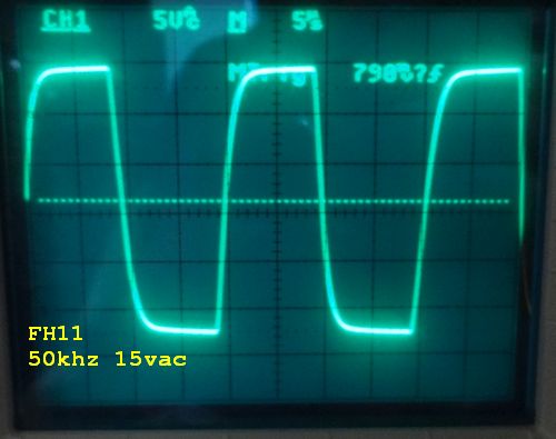

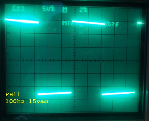

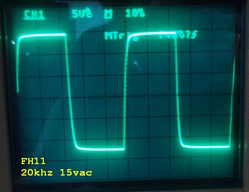

Here are some scope shots.

I'm sure you are right about the large feedback cap.
Probably a larger heatsink would suffice.
Thank you! Wow - that does look pretty clean, no ringing at all, and not too shabby up to 20kHz given the whole lack of a low impedance driver for the gates.
I can see why it sounds good. :)
Having never used a protect circuit - what do the connections mean? Speaker "+" vs "-" and "out?
Out goes to amp?
