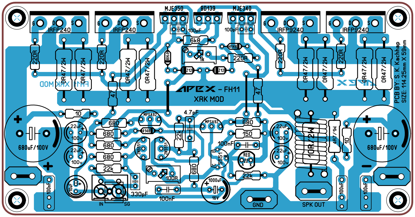

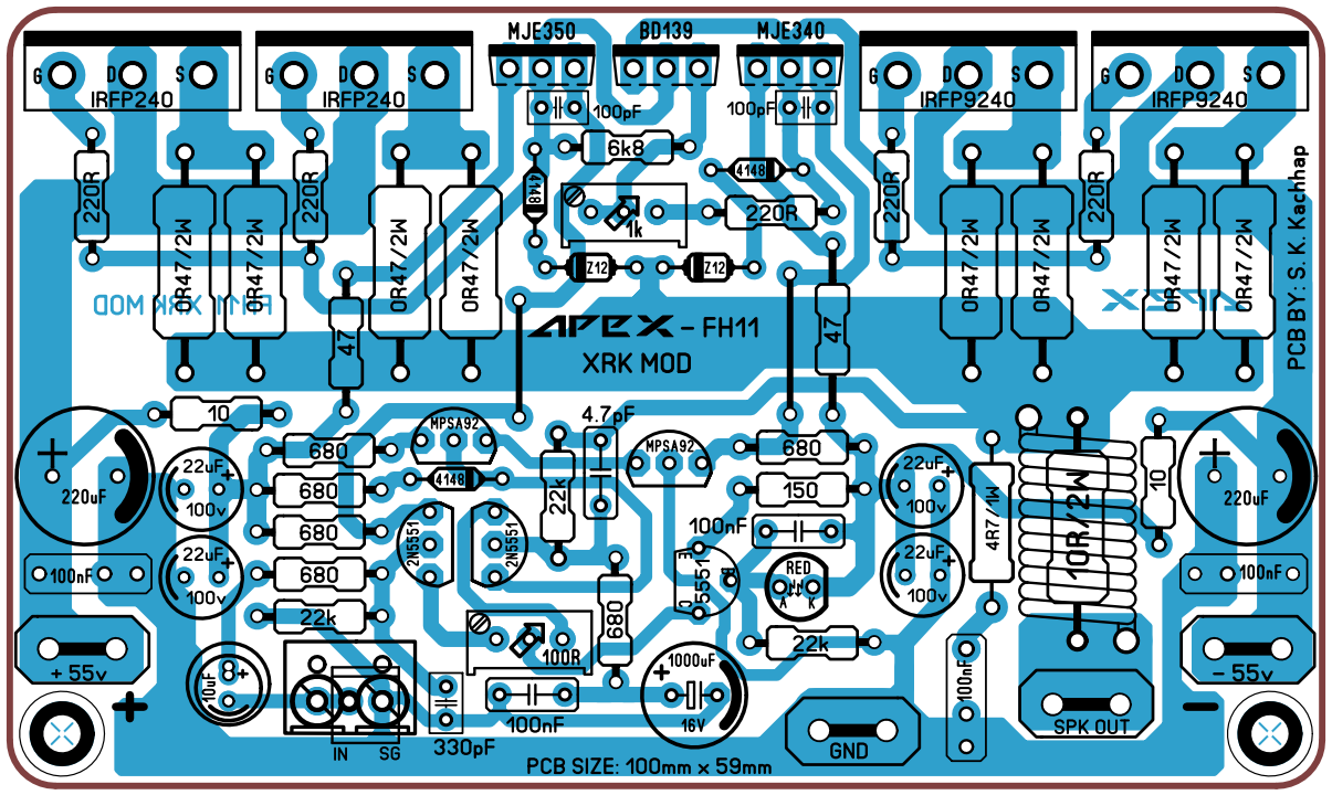

VSSA, DX Super A, SKA GB150. Held its own. It's a nice amp. I think if I was to do a layout for it I would put the MJE350 on the main heatsink or make room for a good size one.

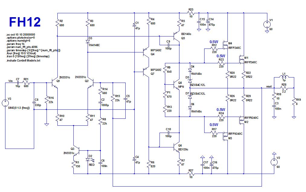

Use two MPSA92 instead MJE350 like on this schematic.
Neat. So just adding one in series like that helps to cut the dissipation on one? Can you please explain how that works? To my untrained eyes, it seems that the same current would pass through both, thereby doubling the dissipation?
Current is same but now we have only half voltage per transistor.
Duh!! silly me, Ohms law....

FH11 with modifications suggested by Mr. Miles.
@XRK, could you update schematic with modifications.
@Bangla H, I use sprint layout easy to use but more likely I make mistake while drawing layout. But it's fun once you get hang of it.
I started with eagle and still use it for digital layout.
