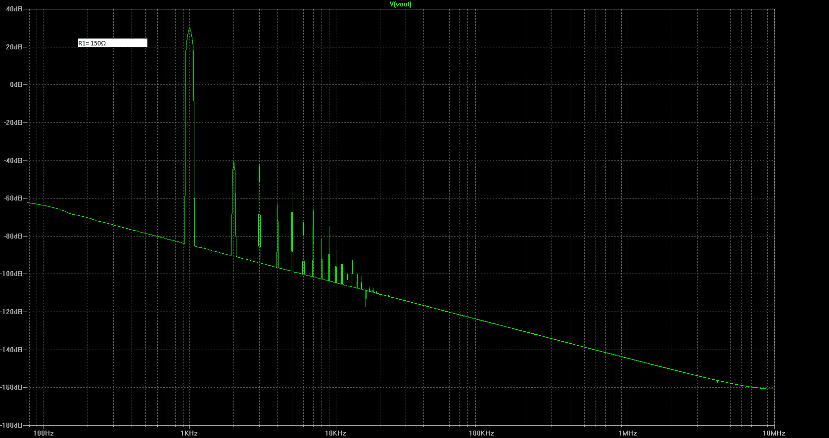

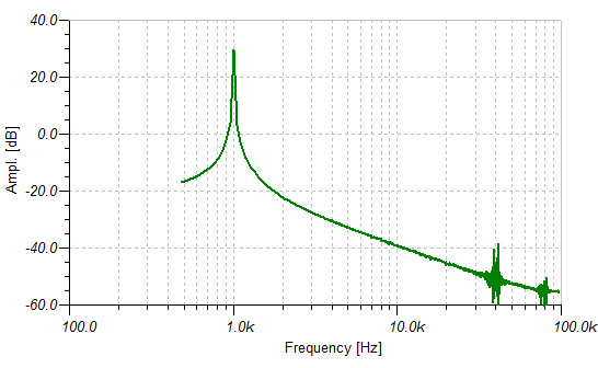

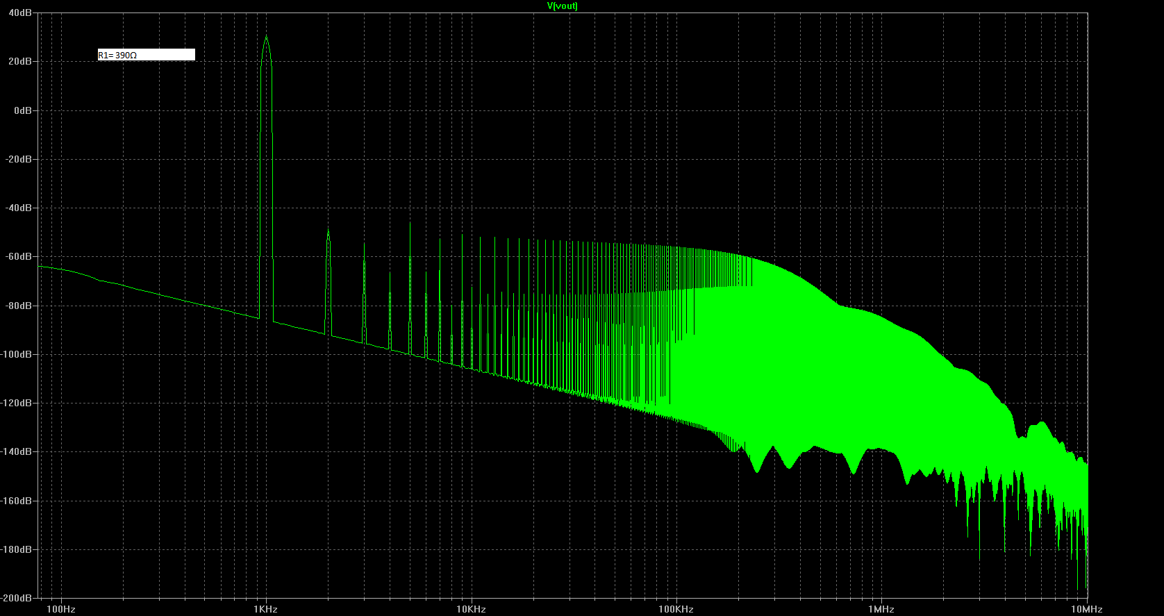

FFT of FH11/12 with R1= 150Ω and 390Ω.

Yes, good catch. I may have other things not quite right. The THD is quite high,
My sims of FH11 in Tina had THD of 0.04% at full power. That was with a single transistor - I am not sure if adding another active just to reduce power dissipation is worth the complexity and pushing the number from FH11 to FH12. A larger heatsink would have sufficed as Terry said.
Is the grass in the 390r fft due to the reduced LTP current and reduced VAS current, or due to a change in the way you asked the question of the model?
If the grass is real distortion, then it shows the odd harmonics above 3rd increasing badly.
If this is the case you need to separate the two current changes and only change one current at a time. See which current needs to remain high to get the left hand simulation fft.
Then find out how low it can go before the distortion takes off.
Finally you need to look at compensation to find if there is instability that is causing the big increase in distortion when the current is lower.

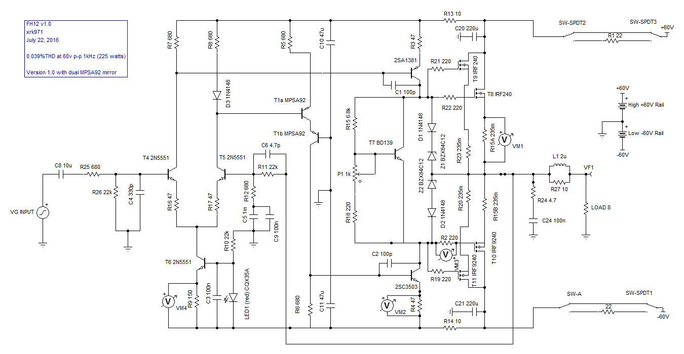

FH12 model in Tina
FH11 with modifications suggested by Mr. Miles.
@XRK, could you update schematic with modifications.

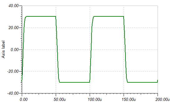

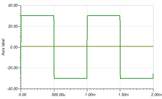

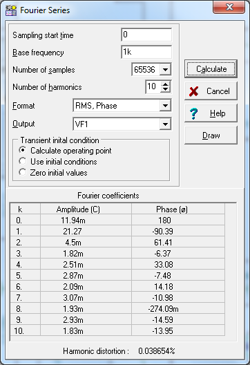

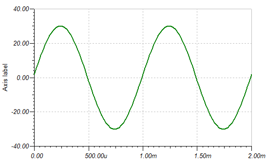

My model of the dual MPSA92 mirror seems to work pretty well, in fact, the THD even went down a tad from 0.044% to 0.039% for 1kHz 60V peak-peak output. I am using KSC3503/KSA1381 for the VAS. Current at LTP is 5mA and current at VAS is 20mA. The sims on Tina seem consistent with measurements of clean square waves and listening impressions of good sound (not high harmonic distortion).
Schematic:
1kHz Sine Wave 60V p-p:
1kHz Square Wave 60V p-p:
10kHz Square Wave 60V p-p:
Spectrum with 1kHz input:
Calculated FFT HD components with THD=0.039%:
