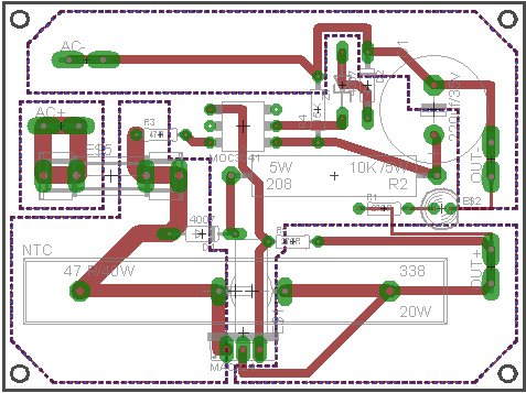

Mr Mile and others can i substitute the 47R 25watts resistor in the soft start with NTC of appropriate amps as shown in the attachments
what you are planning to make here is a dangerous ckt with mains voltages. please read more on how to make layout for mains voltage or follow some tested layout.

What am I missing? What do you consider to be dangerous about this layout?
the clearances between the edge of PCB and holes from copper is less;+live and neutral very close i think. A good guideline on proper PCB design is given in http://www.infineon.com/dgdl/Infine...s.pdf?fileId=db3a30433d1d0bbe013d20e0cbf017fe
I dont know if the above link works , but there are some online calculators that show the clearances and also precautions to be taken when dealing with mains ckts and min clearances as per standards.

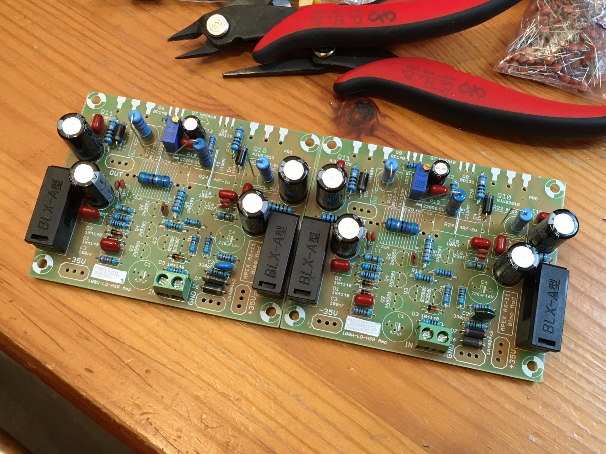

AX11 Bimo progress. Everything but transistors and some terminals and caps. 70um thick copper is nice to work on. So much more durable. Build is pretty easy. I can't believe I don't have a 220R 0.5w or 180R. I substituted 200R for 180R. Also just using 2W 0.22R emitter resistors. I have 5w white cement ones but their pins are a bit too thick for the supplied holes. I think I will play and see how hot it gets. Can swap out later if a problem. My experience says that a 0.22R here won't get that hot and 2W is fine.

I am not trying any new layout just copied willis layout of apex softstart which is attached as PDF,just added two legs for NTC parallel to 25w resistor and want to know it's ok , others will correct as per advice

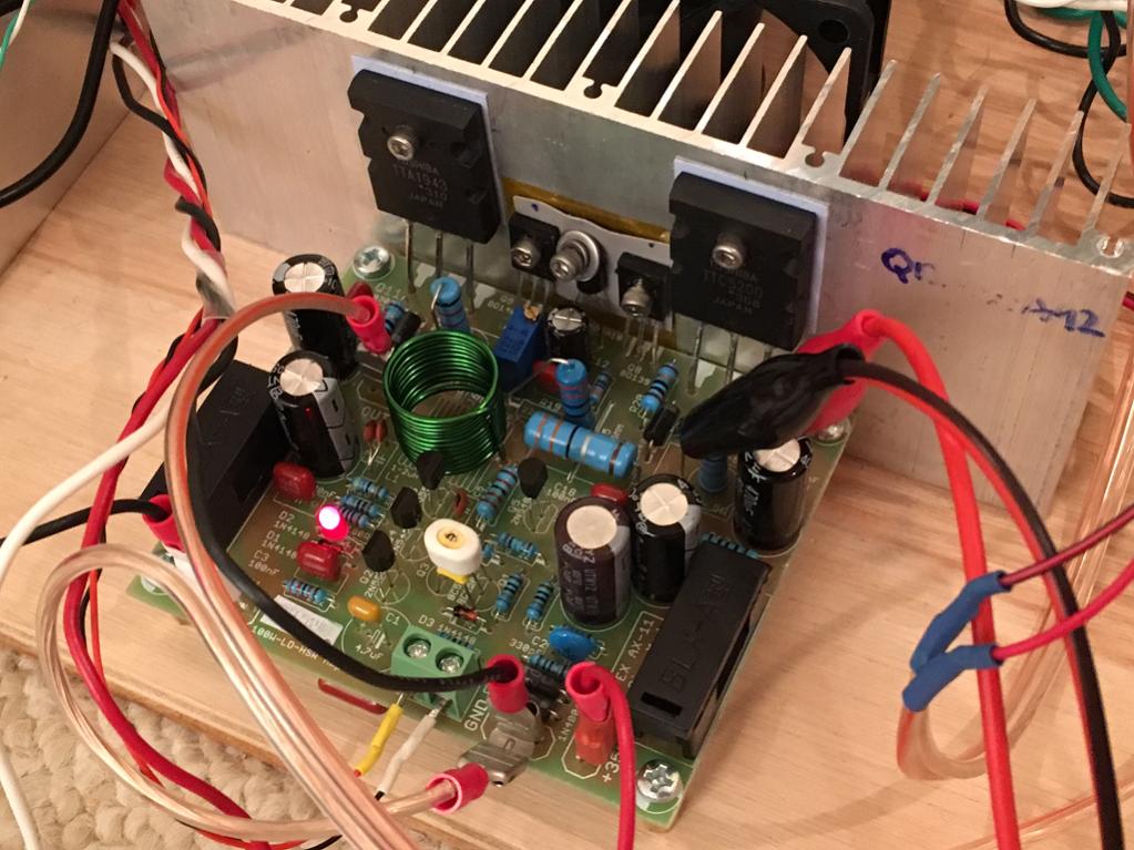

I couldn't wait for the NJW's to arrive. I had some 2SA1943's and 2SC5200's lying around (genuine Toshiba). So I proceeded to install the outputs. I swapped one of the 1N4148's (D2) with a red LED for power on indication. It is singing now but the bias adjustment on the Vbe multiplier seems to be off. I can adjust bias current but it bottoms out at 486mA (as measured with probe at R22 - the 0.22ohm, emitter resistor). So it is sort of running class A with lots of heat output so I added a fan. I am using BC546C as the temperature compensation Vbe multiplier. What values of resistors do I need to change out to get the range to go lower?
Currently running 35v rails. Bias is rock steady at - so the BC546 clamped to heatsink seems to be working. DC offset is -23mV (even though I matched the Hfs of the input BC550's).

the following was advised regarding this amp by Bimo and Andrew T.
Use Either of
1. D1+D2 (default)
2. Led+D2 (R4=TBD, R6=TBD)
3. Led+Jumper (R4=10k, R6=330)
So its better to use D1+ D2 or Led +jumper with R4/R6 changed.

Change R14, use 1k5 instead 1kI am using BC546C as the temperature compensation Vbe multiplier. What values of resistors do I need to change out to get the range to go lower?
Doesn't R14 and R13 control the bias adjustment range as those are the upper and lower resistors in the Vbe multiplier? R4 and R6 control the CSS current - which, I am not sure if that affects the bias current.
ok, i just saw the red led being used and i remembered the advice. may be b Mr. Mile or Bimo can advice on suitable values for R13/14 for the BC546.
