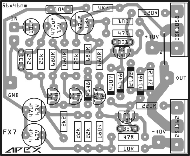

FX7 Pcb

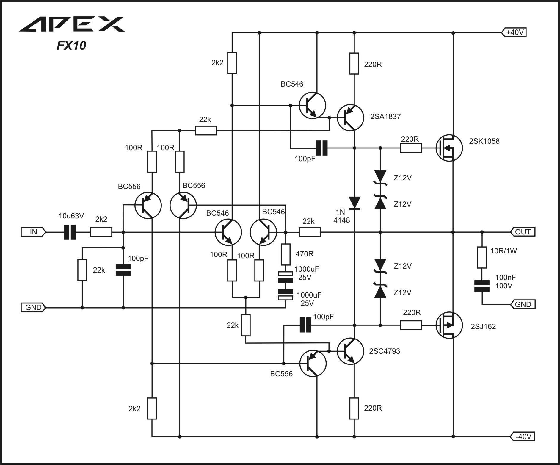

Nice simpler is better design... is there a schematic that goes with this?
my version of layout in post # 7297 http://www.diyaudio.com/forums/soli...imate-fidelity-amplifier-730.html#post4697718
